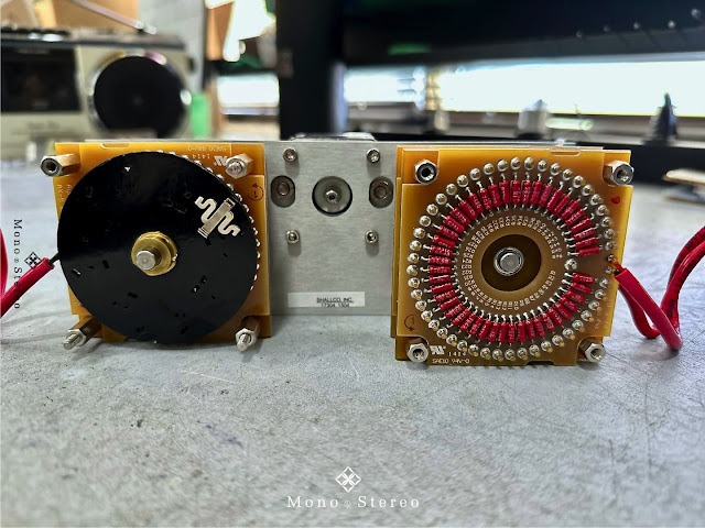

Ayre Acoustics use a discrete resistive latter tapped by solid-state switches ....
Am I right in saying that the KX-R Twenty is there current reference class preamp ?
If yes, are they not using mechanical rotary switches for attenuation ?
What am I missing ?
https://www.monoandstereo.com/?p=1068
