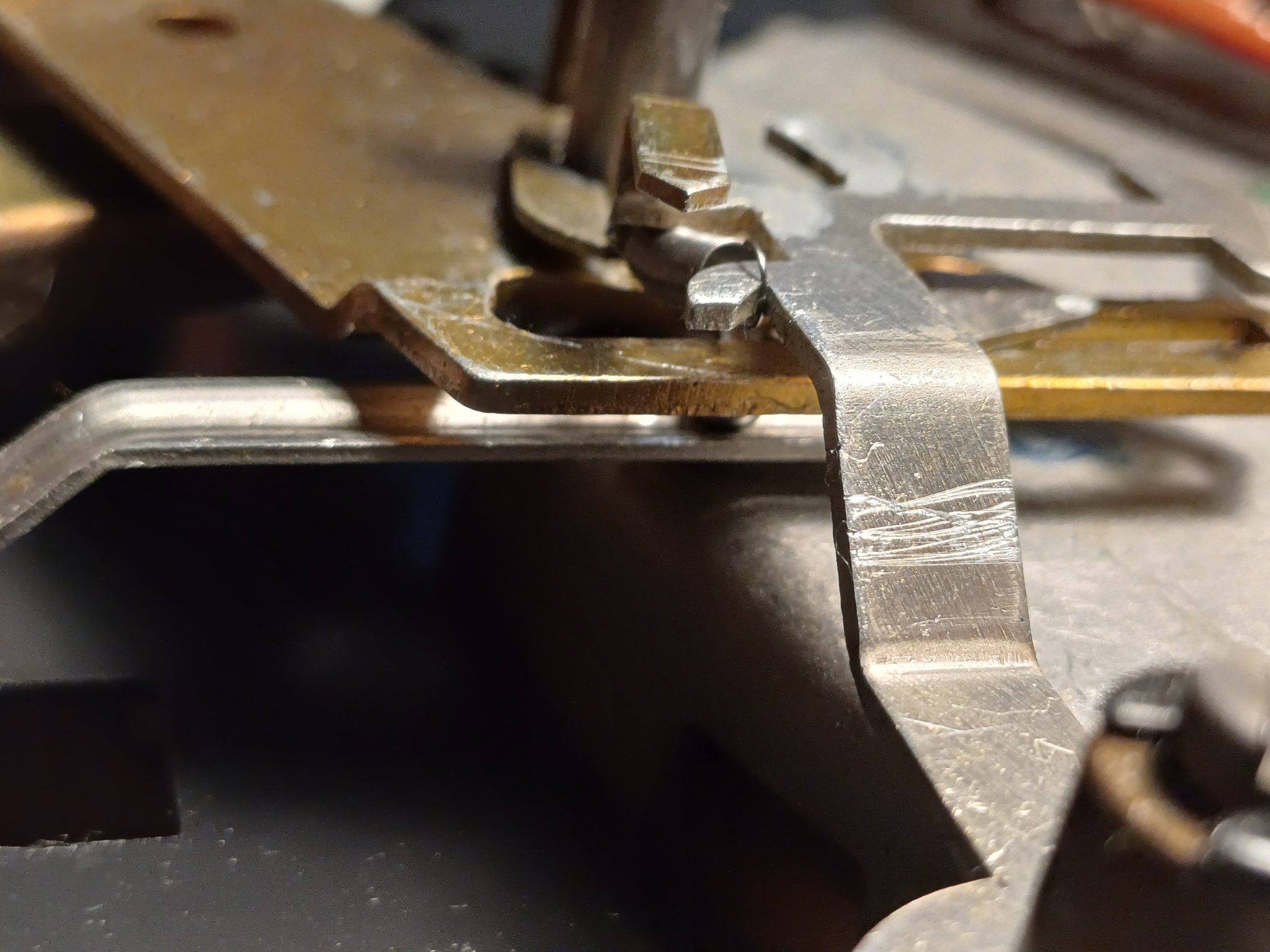

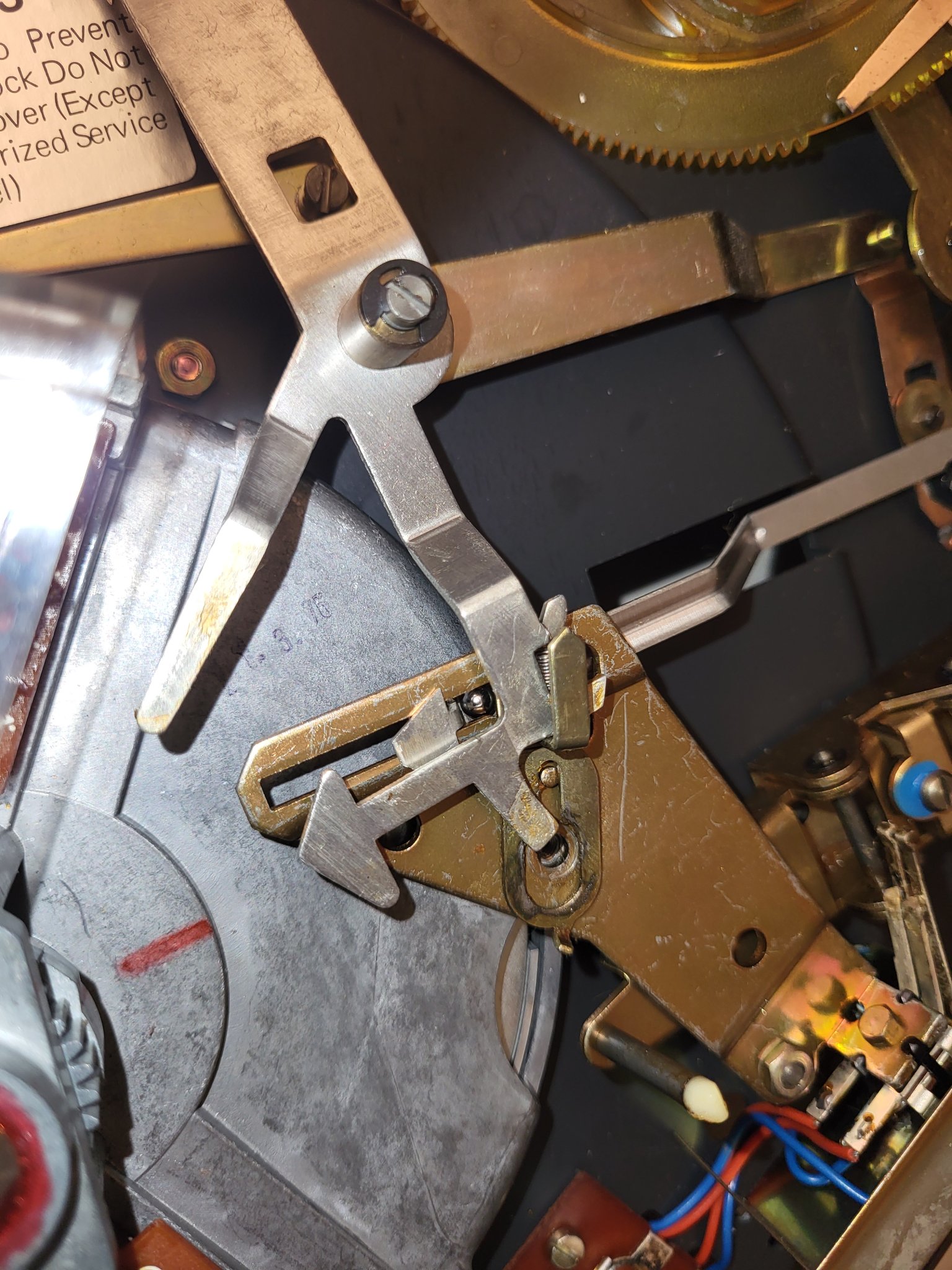

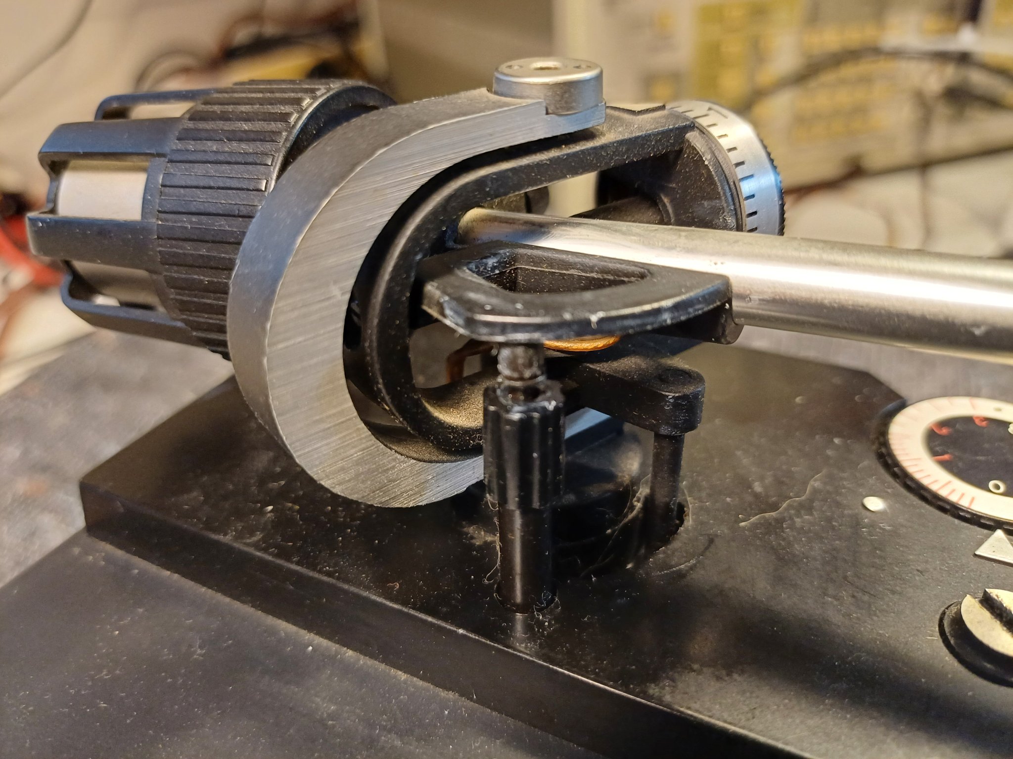

I got it. The tang end of one of the levers was hung up - almost like as shown in this photo from earlier in the thread.
Anyway it looks like back I am back up and running. Now to do some listening tests..

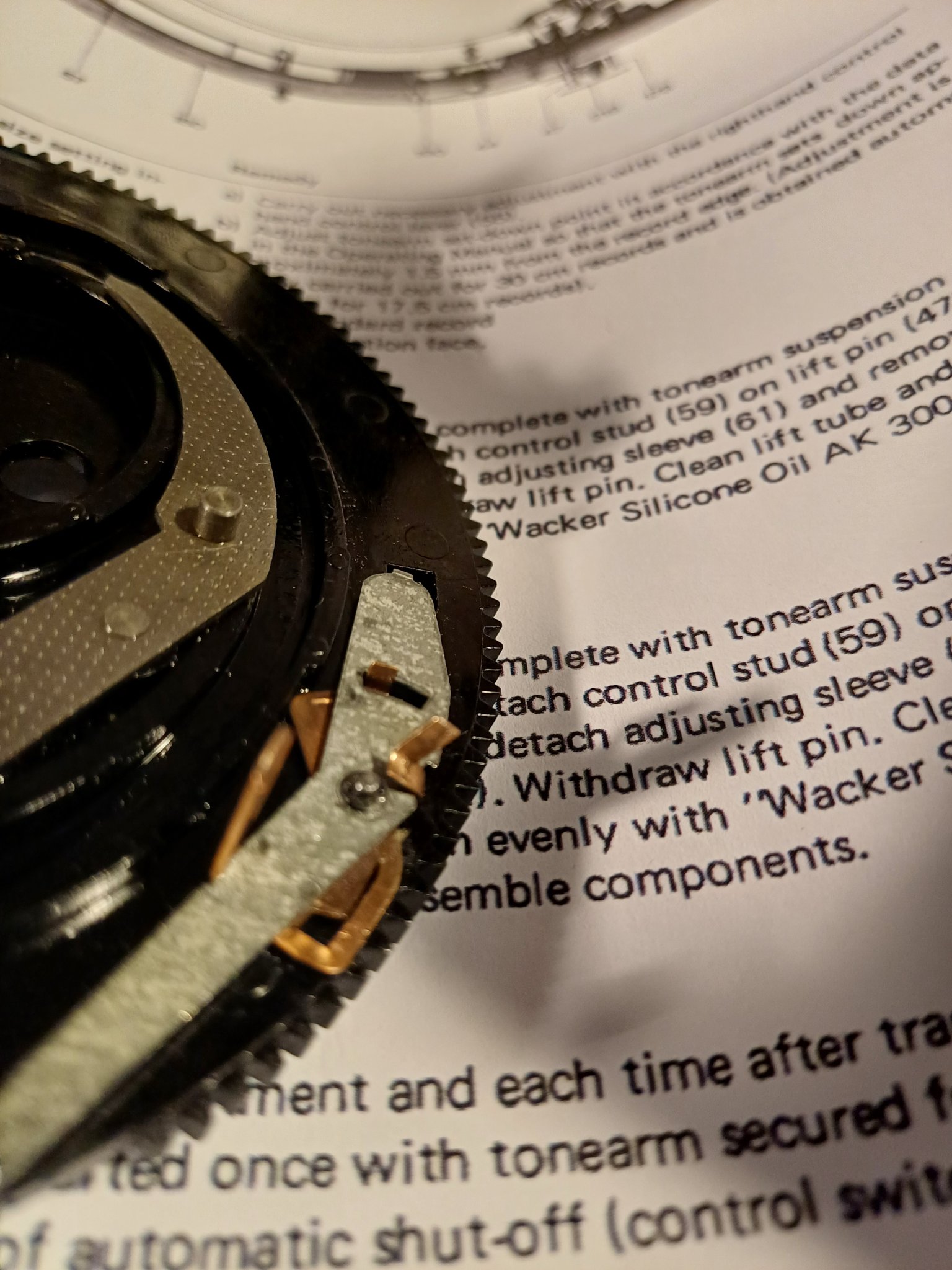

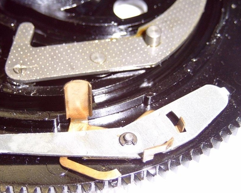

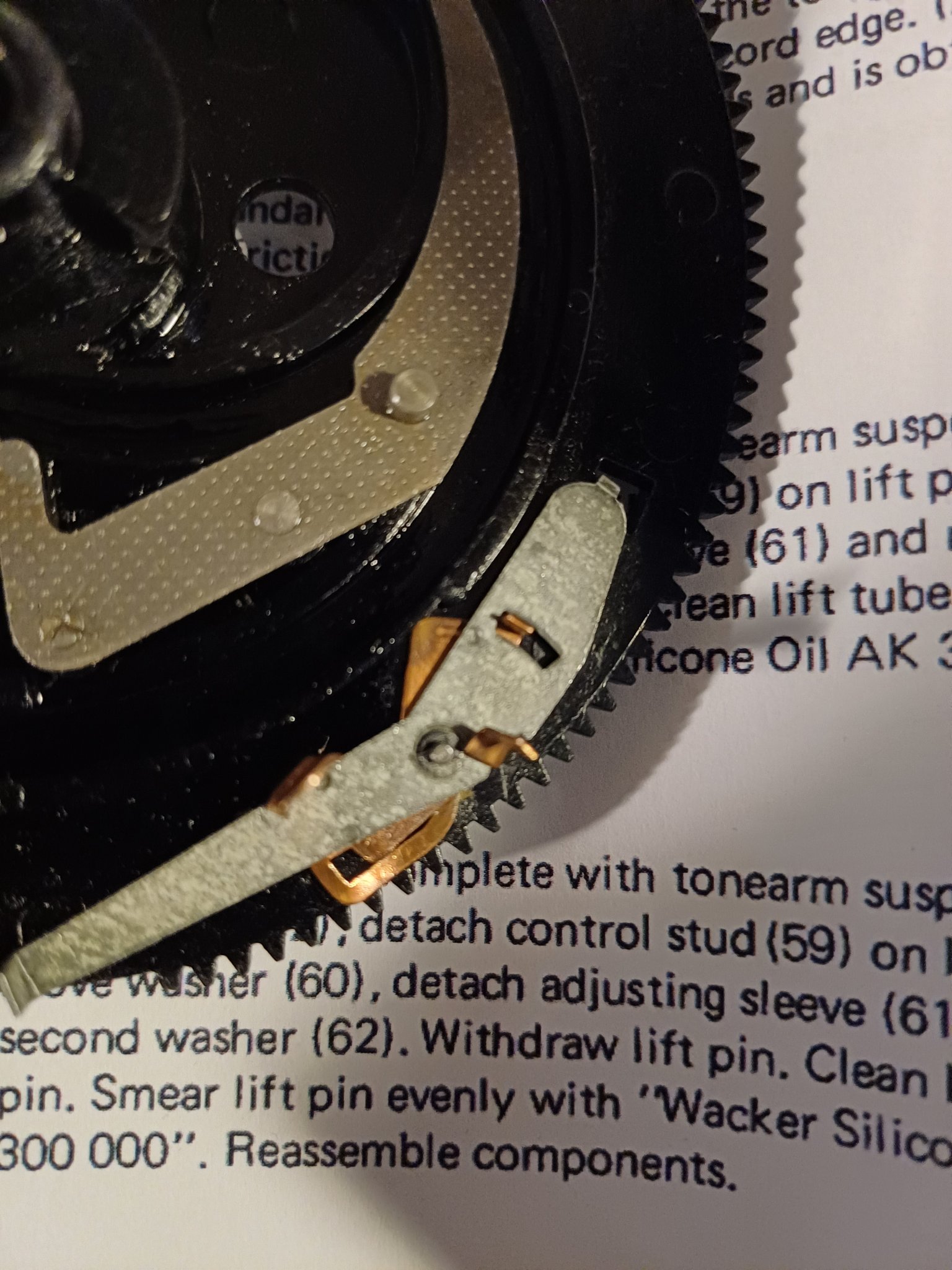

I was way ahead of you ulogon. I took a couple of days of not looking at this at all.
Now I am ready to take another stab at it. I'm pretty sure the ball bearing is correct. But I can't say with 100% certainty.
I am a little suspicious of that tiny little spring - I may not have it attached correctly. But I don't find a good illustration of how it should be.
Anyway this is what mine is currently doing (video link below):
