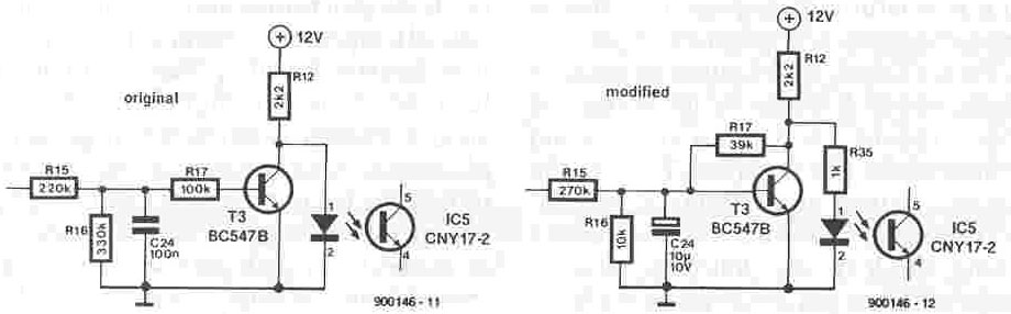

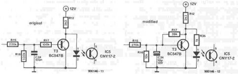

I built this project some time ago & had problems getting it to work properly. I pulled it out again recently and now have the power supply working. Following an errata I received on the project, I now get both channels working in independent & tracking modes from 0-40V and current up to about 4.5A. There still seems to be a loud buzzing/sort of ticking from the transformer when under a load of 2A or more. The errata said the ticking was caused by overshoot in the pre-regulation circuit and the mods suggested should solve the problem. Monitoring the main filter cap (C26) with an oscilloscope shows the cap is being charged every cycle (actually 2/cycle), which seems correct. My guess is the buzzing/ticking is still occuring from too much amplification in the regulation circuit. Is this correct and what should I do to reduce this or has anyone else still had this problem after implementing the suggested change? The schematic of the change is attached - any thoughts on what could be done to fix this problem? Or has anyone else successfully built this?
Errata attached - see link for schematicPS schematic
