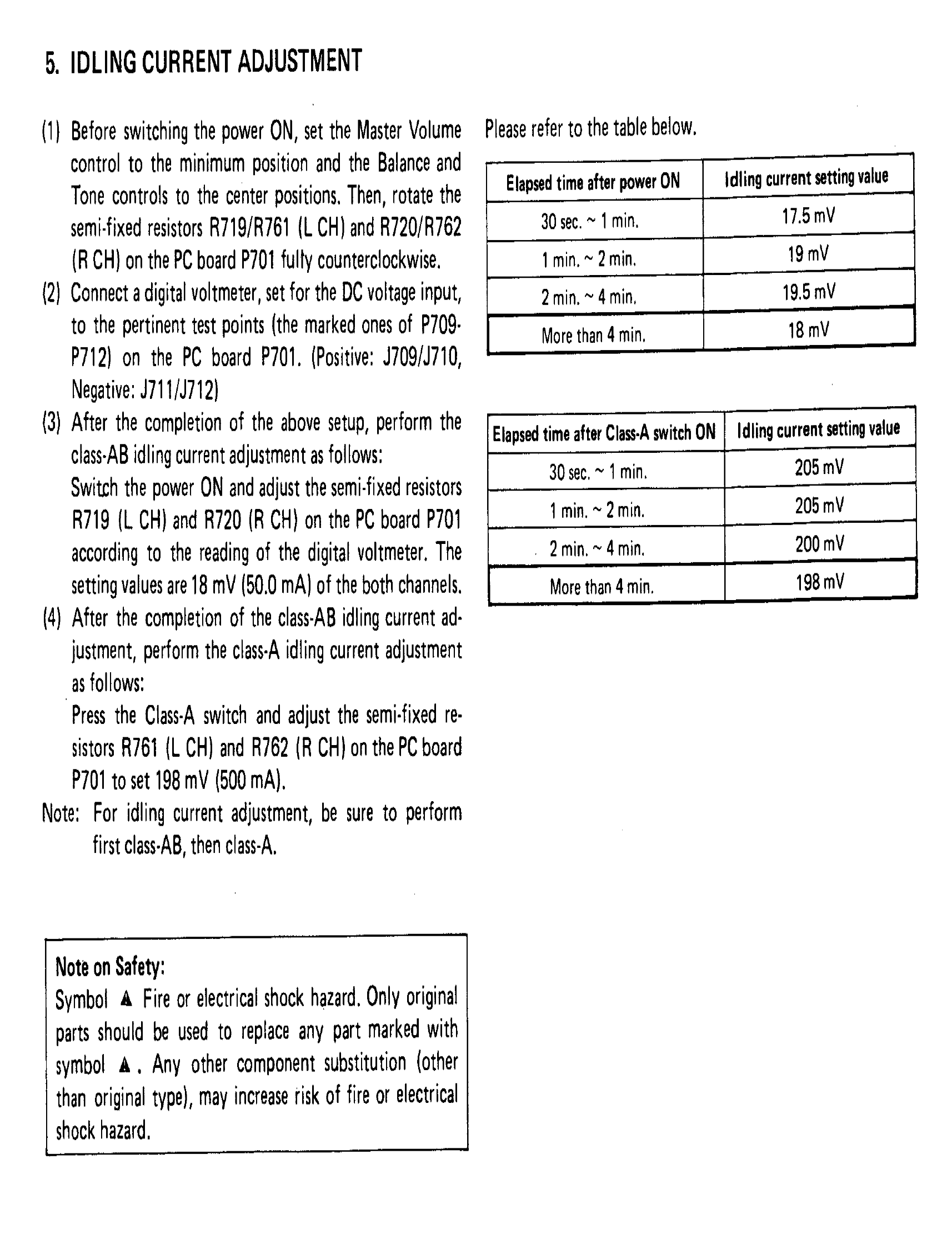

Here is something interesting :
We all expect one to replace the 3102 , check soldering , check the known relays issue ,replace a few capacitors , set the bias and done...
I also expect "techs " that simply replace the 3102 and give away .
Point is that in the first case and when one wants to set the bias will look at the service manual and bias the amplifier accordingly .The problem is that the service manual is written WRONG !!
It states that at bias points bias should be 18mv over a resistor 0.18R and that equals to 50ma ......Obviously this wrong since this equals to 100ma
farther more in the high bias condition 198mv over a resistor of 0.18 that equals to 500 ma Obviously this is also wrong and equals to 1A
Pm 80 features both neg and pos test points and what the missed to print is that the sum of the two redings ( pos +neg ) should be 18mv and 198 mv respectively .
Cannot tell if more than double the bias will stress the IC but obviously in total the heat will stress the amp and produce fatigue of parts and soldering .
Now days fake IC exist from PMC /SAN which the quality i am not aware off so i replaced one , added a far better heat sink and bias the amplifier properly to see how far i will go ....
Enjoy a print of the schematic
Kindest regards
Sakis

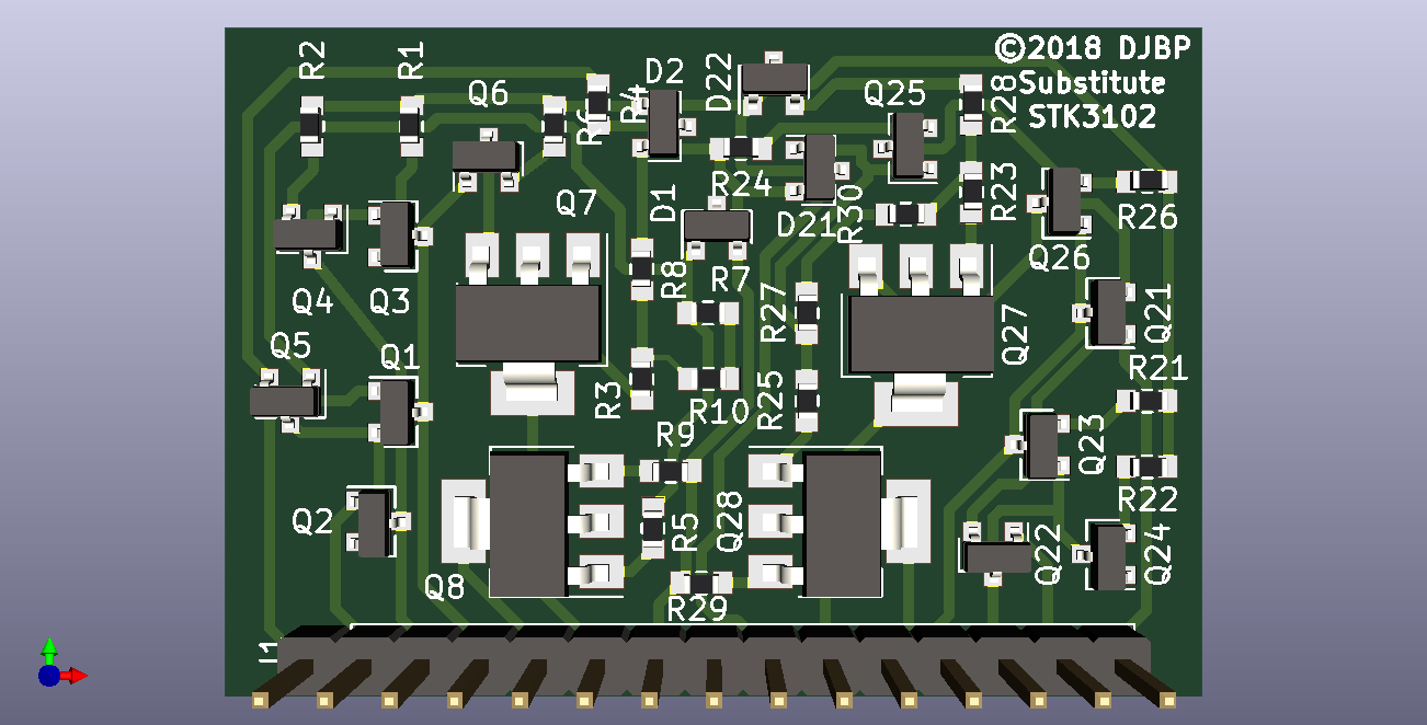

This is an uprated substitute using SOT-223 output devices and splitting the high dissipation "51k"
Anybody who wants to use this, make a donation to a charity of your choice

DZT5551 for the npn
PBHV9115Z for pnp
The original "clone" board is a very good design, I found it hard to change anything without requiring jumpers or vias, but I wanted to keep the B side substrate only. The clone was flawed using SOT-23 as the npns are slightly over run and the pnps can be really pushed by the external driver load. Squeezing in SOT-223s was tricky.
I can improve this board further by adding copper to the outputs collectors
