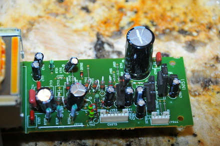

My 5805 stopped powering on; it gets stuck in a protection mode loop.
One relatively slow green blink is followed about a second later
by two quick green blinks, then cycles back to the first blink;
relay clicks accompanying blinks.
There was no shorted speaker connection to provoke this failure.

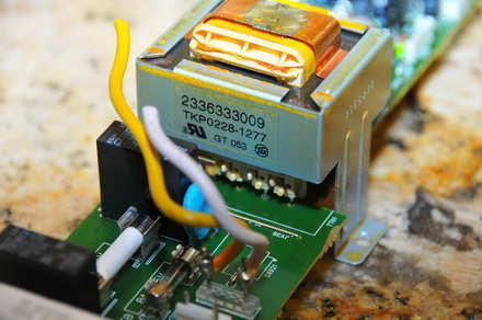

Directly behind AC outlets are individual relays
(RL103-RL105, mounted on page 84 AC Outlet unit 1U-3639-6,
exploded view 6-6, schematic 17/61),
all sharing one fuse (F008, 8A/125V).
Directly above that is Rush-R unit 1U-3639-4 (exploded view 6-4)
with main fuse F001 (12A/125V) and relay RL101. I suspect that
this relay and fuse are dedicated to supplying power amplifiers..?
Above that, AC Inlet unit 1U-3639-5 (exploded view 6-5)
has fuse F003 and relays RL102 and RL106. The fuse is hard to
see and harder to access, behind power wiring wrapped on a ferrite core.
>> Removing F001 and F003 did not affect the power-on sequence.
I assume that some power supplies were not working.
Second Fuse Assu 3638-3 is partially obscured by the upper front
frame rail, to which the front panel is attached.
During the one of the two initialization sequences, AC voltages at
the accessible ends of those fuses measured: 10A 4.8V, 10A 0.4V
8A 0?, 8A 0?, 5A 0?, 2A 4.2 1.25A 8.2, 1.25A 8.2 3.15A 17.6 3.15A 17.6.
Of these, the 3.15A fuses were clearly associated with 15V supplies.
The two 10A fuses are connected at one end.
Reseating the one which had measured 0.4V restored it to 4.8V.
4.8VAC seems low for supplying 5VDC..
I have yet to find any obvious places for checking DC supply levels.
At any rate, after restoring the second 4.9=8V AC supply,
seeming useful voltage appeared at protection unit power transistors,
TR991 and TR992, but power-on clicks and blinks did not change.

i can tell you some of the common failure items in denon receivers:
3 terminal regulators, such as 7815 and 7915's..... especially the 15 volt ones.
HTH
Thank you! You reduced my troubleshooting from weeks to minutes with that post.

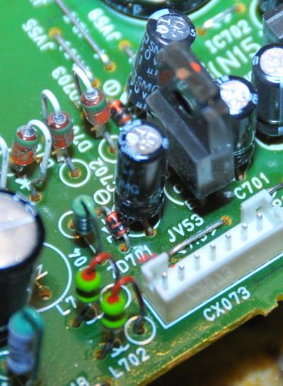

Chalk up another 7815 regulator failure. This time on an AVR5803. Parts Express has the original part, but maybe repeating a behavior and expecting different results isn't wise.
Then, neither is repairing a failure w/o understanding the cause.
I haven't gotten the replacement yet, but the 7815 is definitely bad. Too much capacitance on VOut maybe? Most 7815 vendors want 10uf on Vout. That would be something that a cheap diode could permanently fix.
I replaced the 7815 (and the 7915 because I ordered one). I soldered a shunt diode to their Vouts to shunt excess capacitance to ground when the unit is powered-down v that current flowing back through Vout.
It might not do anything useful if that's not the cause, but it won't hurt anything either, and my 5803 is 1 gram heavier, and a bit less likely to float away in a breeze.
Reinstall is this evening. Denon sure made it difficult to get this board out/in.
If anyone from Denon reads this: the capacitance on the output of the two 15V regulators used in most of your AVRs is much higher than manufacturer spec (10uf). When the unit is powered-down, the excess voltage runs back through these regulators, possibly damaging them. Adding a shunt diode will prevent that possible damage. Also, some test points for all voltage supplies, up top and labelled, would reduce troubleshooting time and save Denon money on warranty repairs.
If Denon found this extremely helpful, I would very much appreciate testing/reviewing the AVR-7200W for a few years. Thanks!
