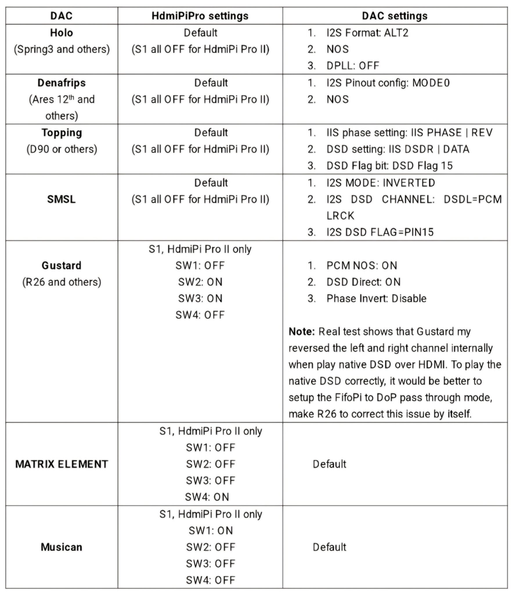

  • Then, as but one example, I have a few DACs. One is a Topping D90. I noticed that the pinout for the Ian Canada board is:
In the manual for the Topping, it shows the following for phase:
It would seem that I would need to reverse the phase with the D90 (or just remember to do it in Roon, I think) - no big deal.
What's odd (to me) is that it shows the following for DSD:
If I'm interpreting this correctly (highly suspect) the two (Ian's board and the D90 with DSD) cannot match. I can either have the phase reversed or the channels reversed, correct? I don't play a lot of DSD, but I'd like to have it set up properly.
It seems like it may be easiest to change the DSD to DSDR Data to get the channels correct. I can leave the phase alone. It would be inverted for both types. Then, I can just leave the phase inverted in Roon, if I actually care at all about absolute phase... which... I don't really, but...
OR
Are those settings independent of each other? i.e. if I swap the phase in the preceding step, it ALSO applies to the DSD?
I can test all of this, but it would be nice to not need to fool with testing phase.
So, if anyone knows, I'd be grateful.

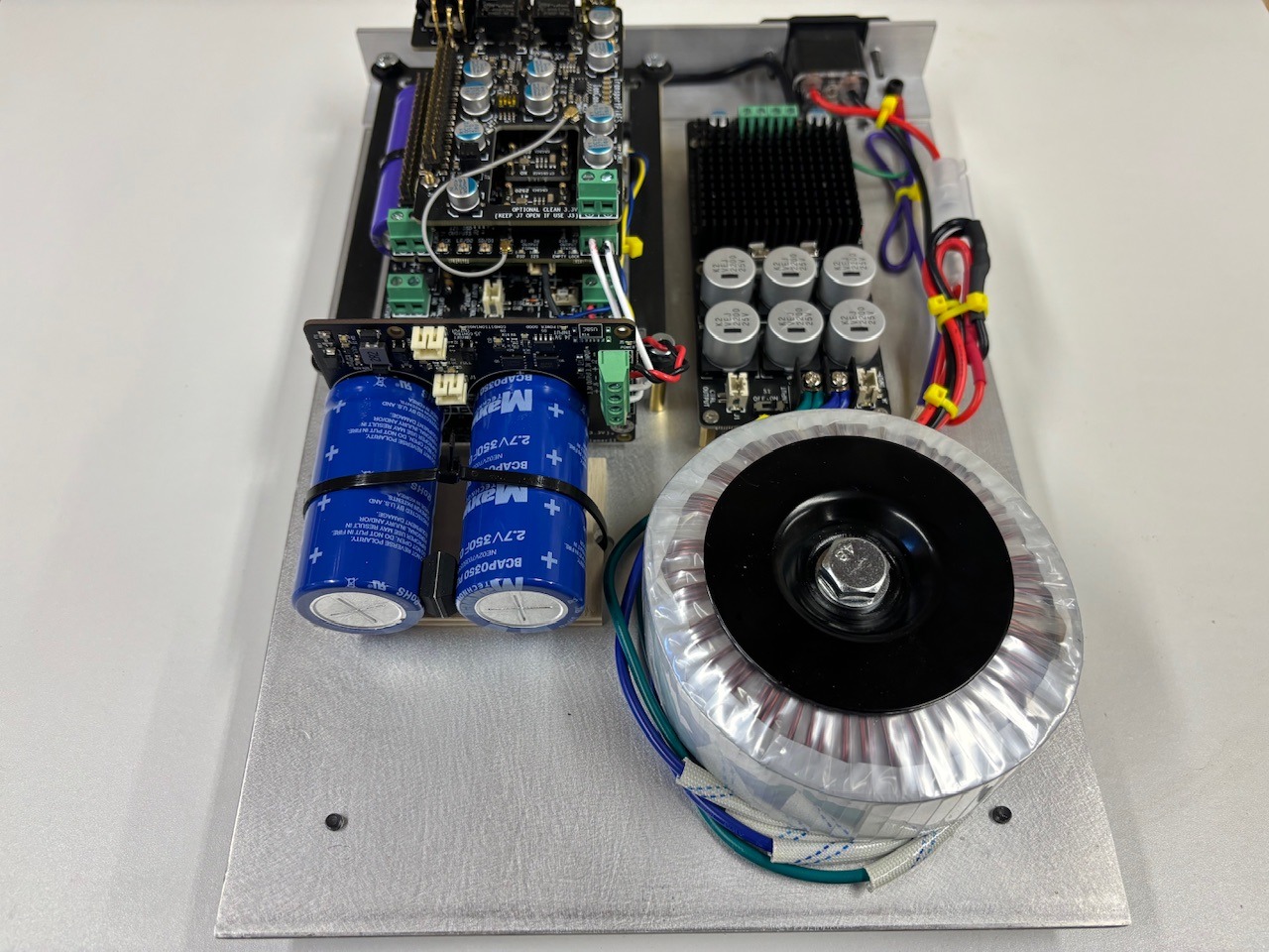

Do you have the FifoPi Q7 or Q7MKII? Asking b/c I don't see J14 and J15 (for the MKII) on the bottom of the board, and I see you've got what looks to be J14 connected to your PurePi for sync. I didn't think that function worked with the Q7. If it does, that's fantastic! I have an MKII that I'm going to hook up instead of the Q7 for this system just in case b/c I was not sure.
On my end, I am waiting on one more set of the caps for the UcConditioner 5V side, and the batteries for the PurePower should be here today. At the moment, I am still running it digital out through USB from the RPi until I get the 3V3 side going with the batteries.

For those that may have similar questions... I've got it all up and working. :). Separate from documenting all the pinouts for I2S over HDMI for all my DACs, I think I've got it all sorted.
Gentoo Player seems to work with Generic I2S for both the Transport AES and HDMIPro.

2) Set the D90 to invert phase (or your software). I haven't tried DSD yet. I think I have maybe 3 DSD tracks in my library. I got them as a sampler with an old iFi DAC, I think. I think my main player (Roon) converts DSD to PCM. Either way, based on the pinouts posted in the D90 and Ian's manuals, I think the D90 should be set to DSDR Data. If you don't care about DSD, I wouldn't worry too much about it.
