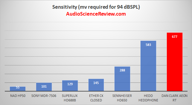

Question: Has anybody here tried driving planar magnetic headphones using Mercury? For example, the Dan Clark Aeons are only 13 ohms. Any direct experience?
TIA, Frank

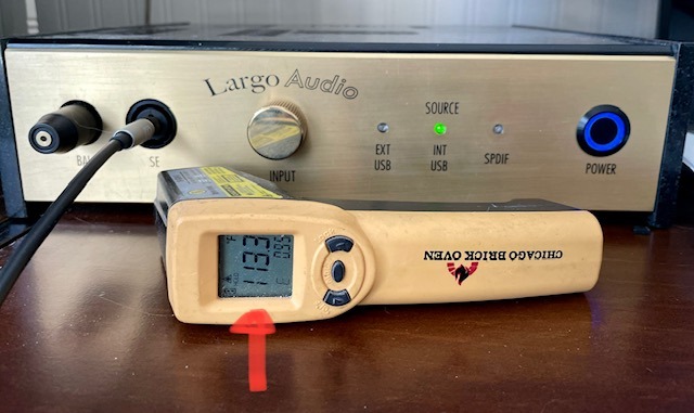

Planar magnetic headphones require significant time to 'break-in', so only after > ~150 hours can you fairly evaluate them. Now I can give a couple observations:
1. Mercury temperature - still ok after running 13 ohm drivers continuously for days. IR gun reports 113°F for the circuit board near the SE LME49600 (photo) and thats with no additional thermal management. Sometime when I'm inside this box I'll stick RPi heatsinks to the buffers, but no hurry.

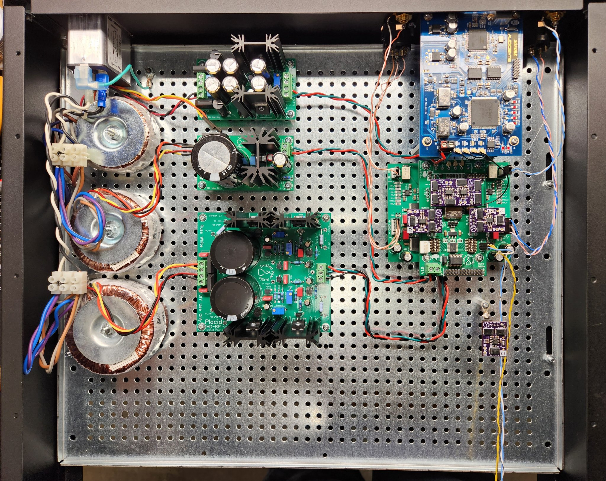

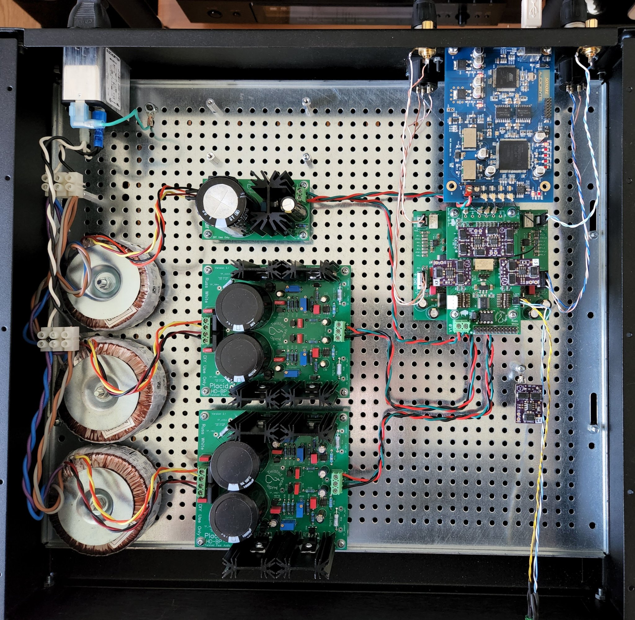

FWIW, I had two Placid HD BP v2.1 powering my Mercury with 9038Pro. I removed one and honestly, I cannot tell a difference. Sonore Audiobyte USB to I2S used as it will run in scynch with BIII where I could never get the Amanero/Hermes/Cronus stack to run in synch.
My system is ARC Ref 3 pre, Krell KSA-250, Salk SS8 speakers, Signature Sonore server running Roon Rock with external powered SOtM USB card, so I believe I can hear differences if they are there. I have Roon upsample everything to Native DSD128, the limit Roon allows with the Sonore interface. IIRC the single HDBP is now at 290mA total output, shunting 100mA for headroom. It gets a little warmer but with the large sinks, nothing to worry about.
The Centaur was powering both the DAC and USB interface. I had an old LCDPS that I added to get out of the spare parts bin and could not detect any sound difference either. As always, YMMV.

If your airflow around the heatsinks is adequate, you might notice slight improvement by shunting more current. Mine have been between 80-90mA without problem. To be honest, I don’t know if the effect is power-related, or the result of all of the components running warmer (including the crystal oscillators).
