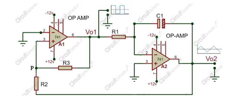

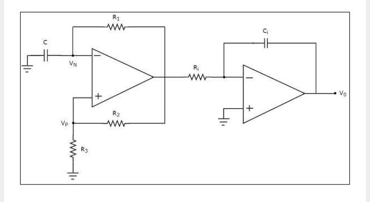

Triangular waves are usually generated at two stage opamp oscillator. One is an analog integrator and the other a Schmitt comparator. The triangle is thus compared with audio signal to generate rectangular waves at fixed frequency and variable duty cycle.
Until you have no good triangle waves, don't sit final MOSFET's.
Two common triangle generators.
