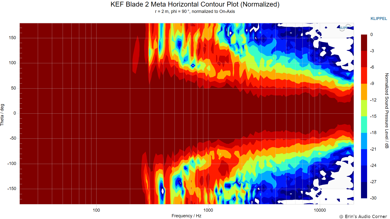

Blade 2 horizontal directivity:
Kef R11:
I don't know if it's just me, but I'd swear the blade has a narrower horizontal beam than the R11. Not perfect, but I see nothing that validates your worry of the blade side woofers that wouldn't be a worry with the R11. An even larger worry on the R11 I'd say.
Is it just the side mount of the woofers that we clearly see that makes you worry this much about them? Because in real life they actually do result in a narrower horizontal pattern when placed this way. They kind of act like a bigger source with more beam forming, not like 4 separate woofers.
You can keep calling it a design exercise, I'd call it form follows function. It's closer to the elusive point source this way. Is it ideal? Not just yet. There's still room for improvement. But it's pretty clever once you look at what it achieves instead of what the eye sees and wrongfully imagine the things it doesn't do.
Edit: I guess I should have made the images equally in size so the scales match up. It would be even more obvious to see my point that way.

Good point, I didn't consider the side placement is essentially adding some horizontal separation between the woofers so narrowing directivity. Just as vauable as the vertical directivity offered by WWCWW.
It isn't ideal and the directivity chart shows it, but it does work.
No worries……50 degrees to 1k is more than fine. The R11 could have used a round over on the baffle which would have smoothed out the horizontal as well……that’s easyBlade 2 horizontal directivity:
Kef R11:

The data doesn't suggest that to me. I think narrower mid-bass horizontal directivity means less troublesome placement close to side walls.We are……all fwd firing woofers allow for more placement options in smaller spaces

There’s NO WAY that woofers firing right against side walls down to 40hz are not going to be problematic…..the laws of physics still exist and directivity isn’t an epiphany.The data doesn't suggest that to me. I think narrower mid-bass horizontal directivity means less troublesome placement close to side walls.
On first glance, but look at how ragged the transition from one colour to the next is in the R11. Vert chaotic whereas the blade is much better defined.

Look again......the banding on the blade is significant and the color matrix for the graphs are different.On first glance, but look at how ragged the transition from one colour to the next is in the R11. Vert chaotic whereas the blade is much better defined.
