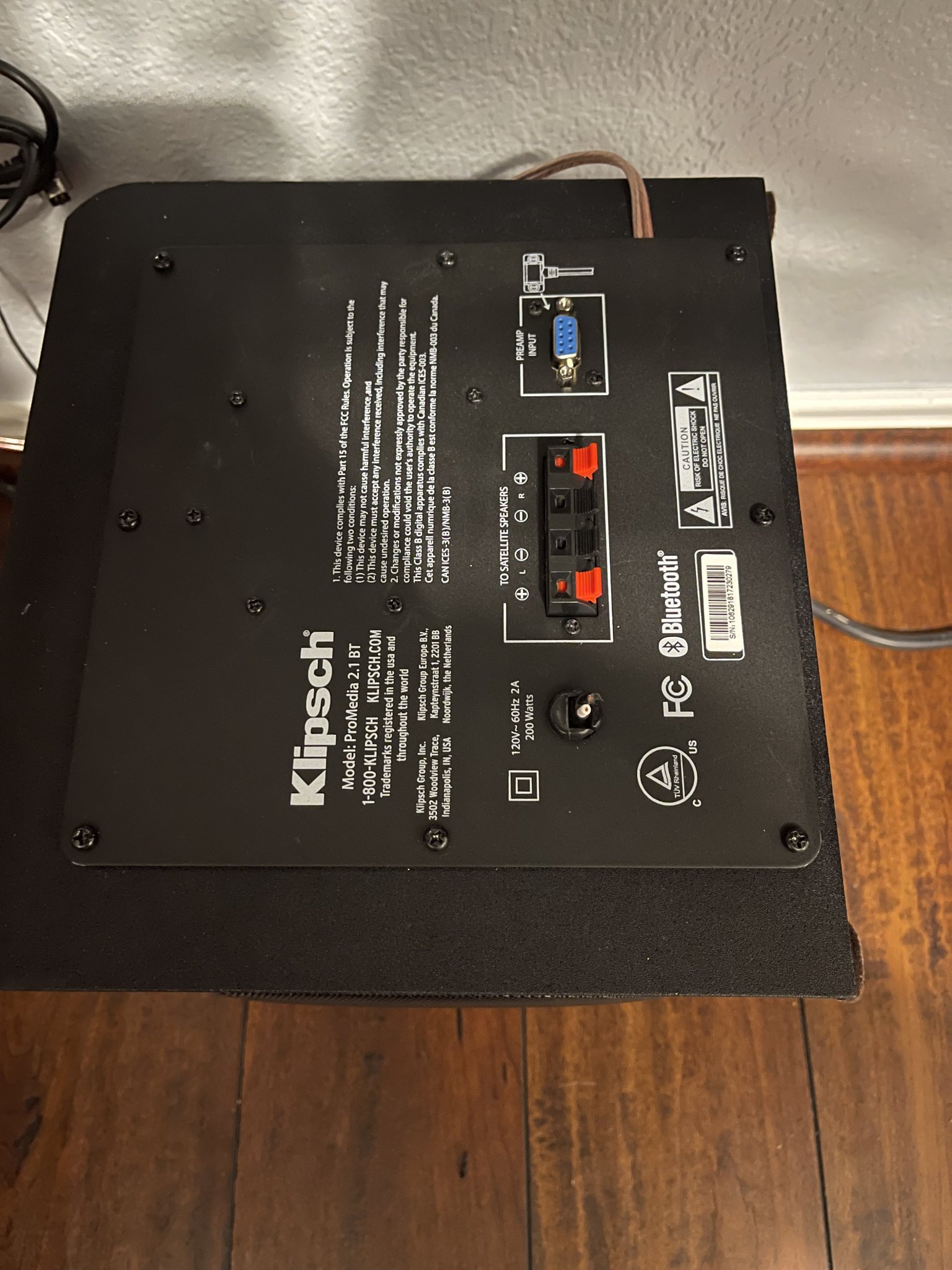

I have a set of the original (rev 1) Klipsch ProMedia 2.1 THX powered computer speakers. When I purchased these, I remember calling my wife over to listen to them because they sounded so amazing! Well, recently the subwoofer started to get quieter and quieter, and needed to be looked into. I opened it up to see if I could see anything like burnt components or leaky caps. I didn’t see anything except the sub board was slightly discolored. I leave it on all the time, and it does stay warm even when not in use, and I’ve had it for over 15 years, so I kind of expected it wouldn’t last forever. It looked like a huge job to test all the caps because you have to unsolder boards from each other just to get at them, and there is a lot of glue/potting that really inhibits disassembly.

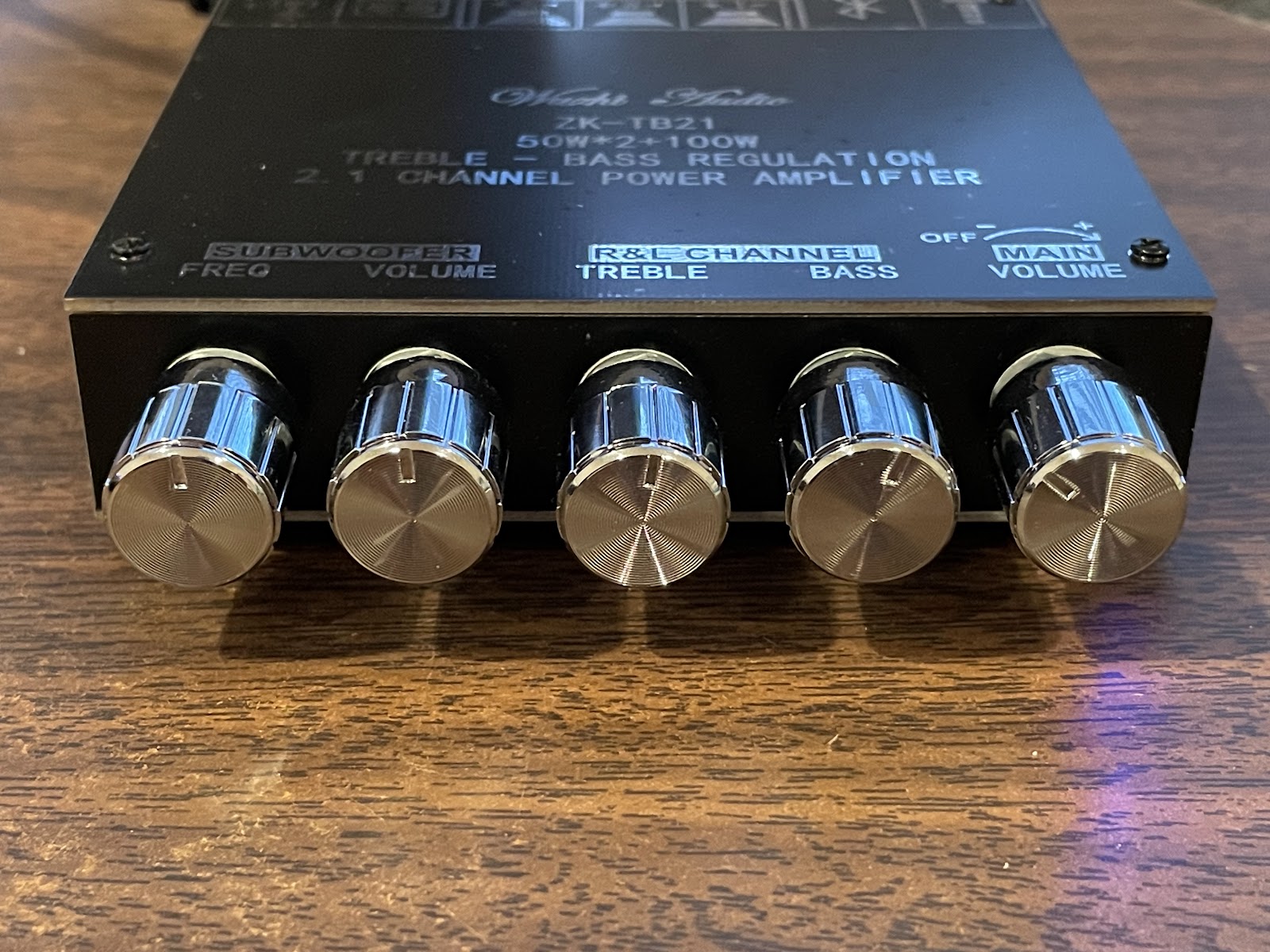

A new ProMedia system (rev 3) is about $120, and is apparently not as well liked, so I decided to keep the speakers and just replace the amp and power supply. After a bit of research, I purchased a zk-tb21 50w + 50w + 100w 2.1 class D amplifier for $30 from amazon, and a 24v 5a 120w power supply for $21. You can look up the specs, but it looked like a good match for the speakers. I pulled the original plate amp off the sub and replaced it with a sheet of aluminum (I reused the original gasket). I mounted some banana jacks on it so I could disconnect the sub when needed. The sub was considerably lighter without its electronics, which amounted to more than half of its original weight. I also removed the control pod off the right satellite speaker since it was also no longer needed. I found that the original polarity on the sub was intentionally reversed (not sure why), so when I reconnected it to the new amp, I tested the phase alignment between the sub and the satellites. Sure enough, if you connect positive to positive, you get destructive interference, and if you reverse it, the phase of the satellites and the sub are aligned. I’m not sure how important that is with the sub under my desk, but hey, they’re aligned when they are sitting together.
The end result was quite successful. It sounds awesome again. The amp has way more power than the speakers can use, and way more than I usually use even when gaming. I over-specced it a bit because someday I might get a bigger sub or nicer satellites, and this allows room to grow. After a few days of use, I found the power supply is room temperature all the time. The amp cover plate gets a little warm after an hour of hard use (maybe 85 or 90 deg F, slightly cooler than body temp) and gets a little cooler, but still above ambient when the amp is on, but not amplifying anything. I haven't decided whether I will turn it off or leave it on all the time. I found I like a slight bit of bass on the satellites, but I caution against using too much bass on those unless you are keeping the main volume down. I doubt there is any low frequency (lots of power in the low end) protection inside the two ways. The picture of my amp settings go along with my typical pc volume slider usage of about 25% for casual listening, 100% for occasional really loud listening. I post them to show you that even at pc vol of 100% you probably won't need to go above ~40% on the amp if you use a 24v ps.

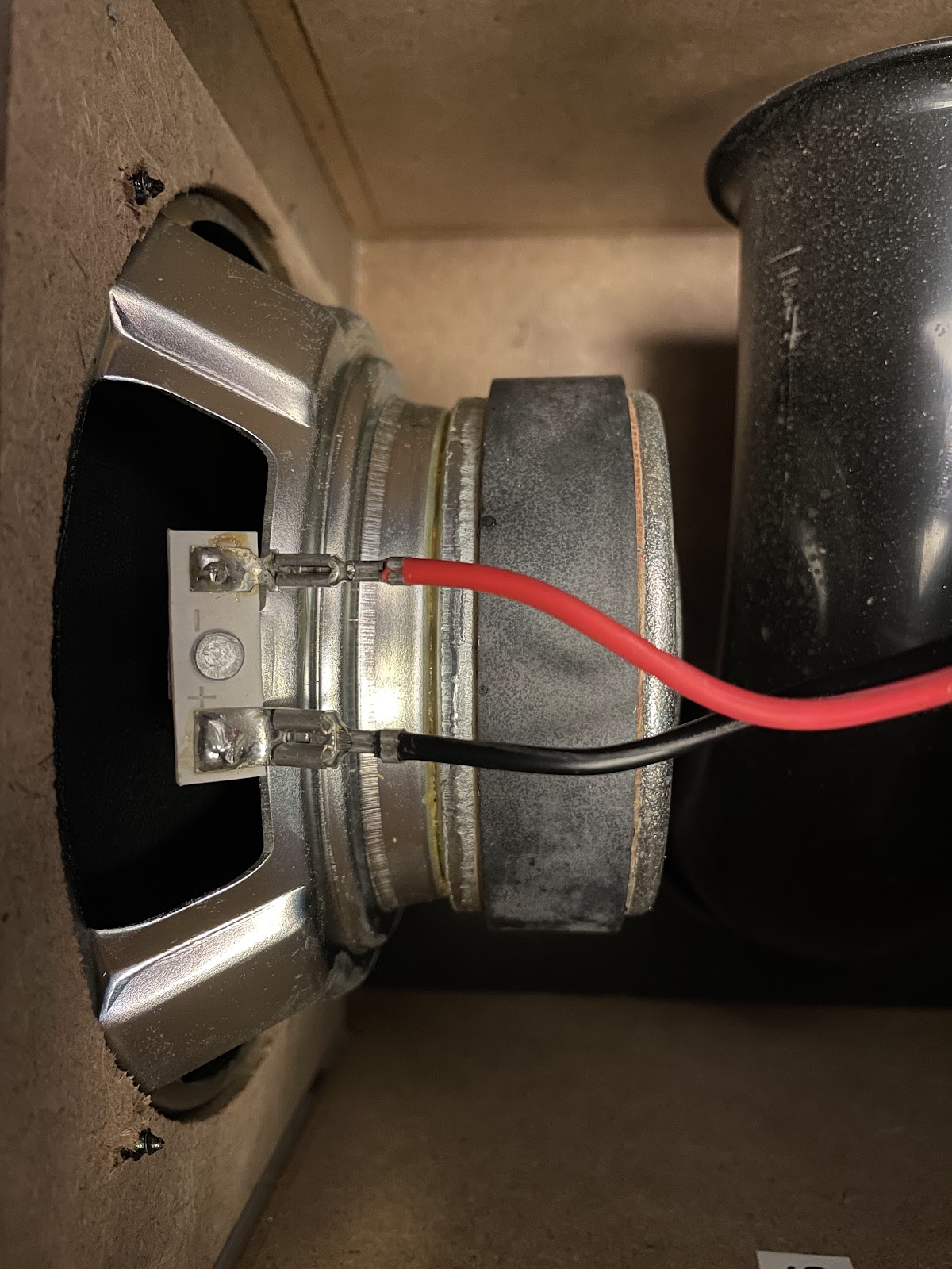

Removed Original Plate Amp From Sub (Spotted Backwards Polarity)
5aG4Na9yavBJ5Ock5t_k79jiyM1dLbpIFzHJ9Exd-5Xpph4bNUs-BgDyiMGR1afBWWGyCxxVBIayZzhHmLlg8x6cjOQYWICyqPbbgu3-RCmJQ6peYIw1xOcpMhiem2x_J_OtplztvrMGzx6mf8ai3w

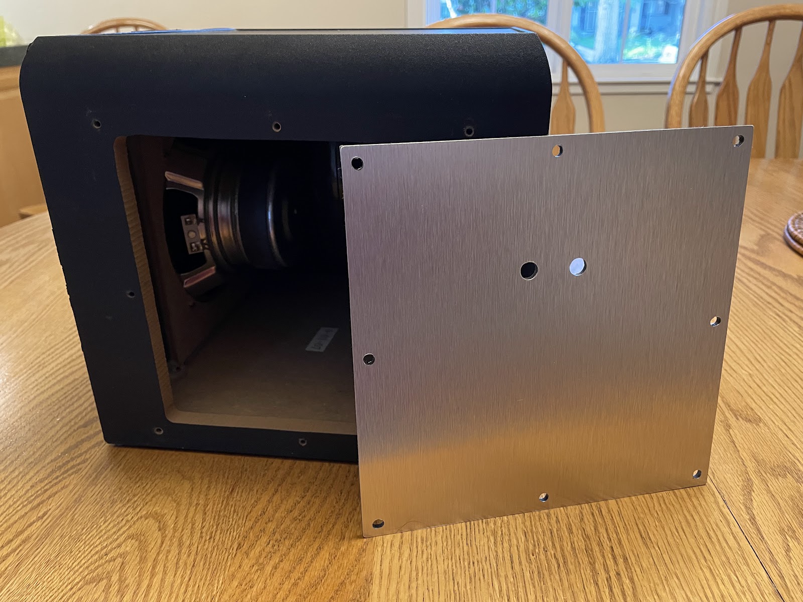

Fashioned New Cover Plate
xoHEPdIvVe6MfxnlQ-BBFTA95j0Y-v09UEVfkgt9n8FqOL1t0spRWessk9-uJYm95EcSxxQuxyyBV64-J-szhWYlEXkXAbHo2jIG3RMOgFiJMpWAAUHshqIZriSbJU2QXIoKUwPPyr4aV-OsxE0MZgQ
Spray Painted Plate Black, And Buttoned It Up
oYsWvc9nRNne40QSxVG5UD4vHLT2x4Vc1tAu7lxv01vly6Y4N-DVjh1jxhH0XqG-PAXRlS2CYGj3Z4oidL6flj2n_Jxa0XoLEXCFml1-ruBV3HLR2FJqVoJpHJrXpFZEEx7nMjWW9ndO7yuEjJraSbU

My Settings For Balanced Response At PC Output Levels

I have the Wuzhi Audio ZK-TB21 amp. I'm considering finding something with more quality. Any recommendations? I hear that the FOSI Audio mini amps are decent. I just want to reproduce that deep bass as the original. I know it won't be perfect, but it's not even close now. Thanks for your feedback.

As for your phase question, I used the correct polarity for both satellites, and just reversed the polarity to the sub. I judged this to be the correct phase alignment by selecting a frequency that both the sub and the satellites could produce and lining all three speakers up on a table all facing a sound pressure meter. When the phase is correct, all three will sum constructively and give a stronger db reading, when the sub has the incorrect phase it will interfere with the satellites, and you will get a weaker db reading. Again though, I'm not sure how important that is because nobody puts the sub on a table in between the satellites, it usually goes on the floor several feet away, so the phase alignments gets all wonky anyway.

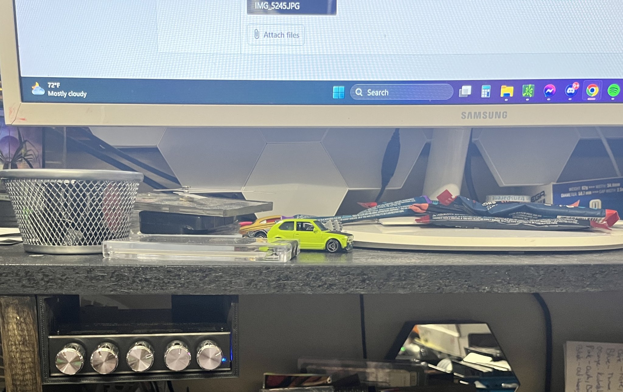

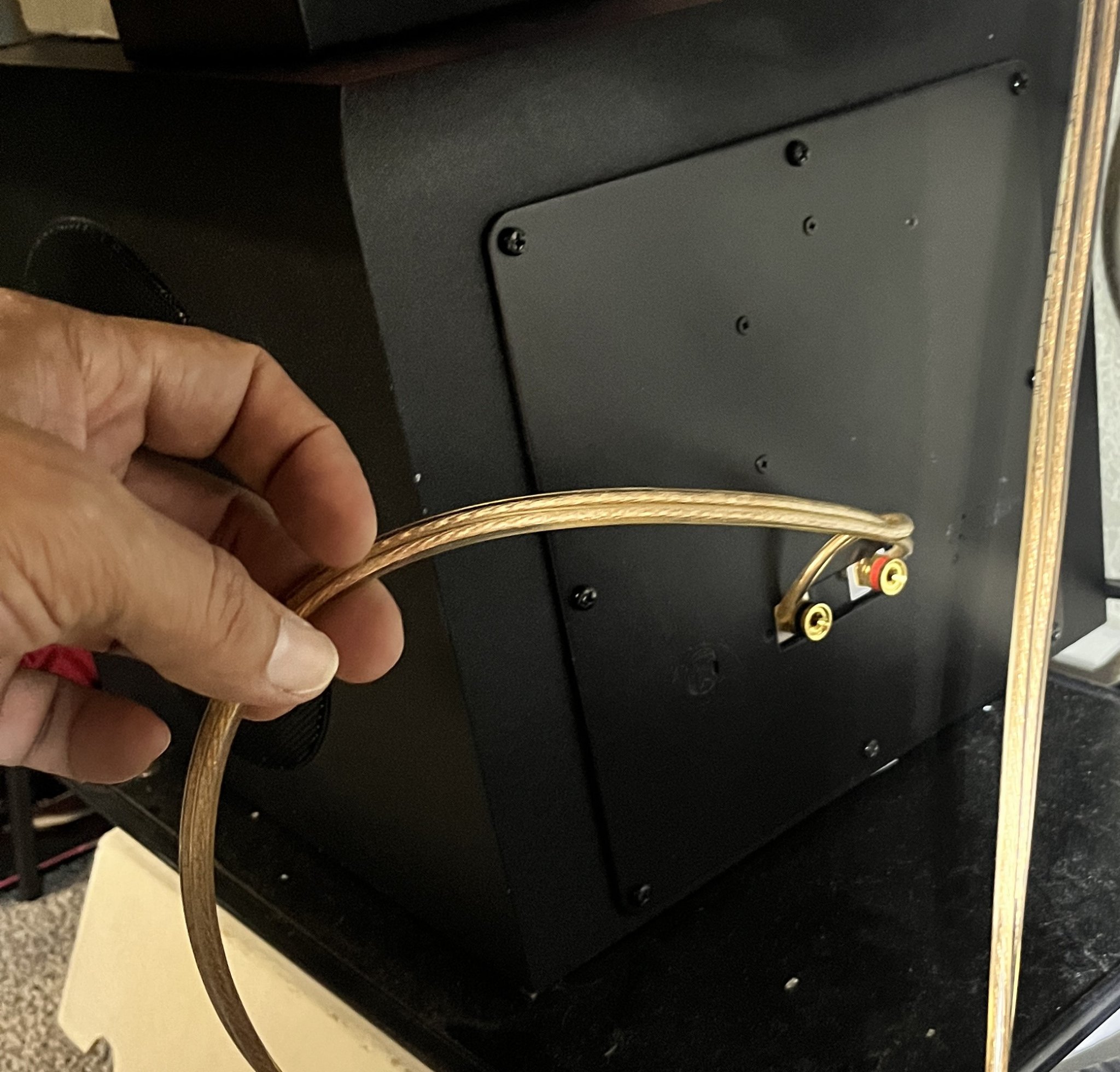

Thank you Sparky Coldfire! I just want to confirm and recommend this mod to everyone with a nonworking Klipsch ProMedia 2.1. Not only is it simple and cheaper than buying a new one, but it sounds just as good if not better. Being able to adjust the satellites independently from the sub is so nice. The sub sounds the same and with some adjusting it does sound better than before. I went with the exact parts listed by Sparky, purchased off Amazon, used Legrand 2-Pack Plastic Banana Binding Post from Lowes, kept the original back plate and gasket and spray painted it all black.
Anyway, I thought I would give an update and thank you for saving me a bunch of money.

Hey, that's great Wonluv! Nice way to connect it. Love the pics, thanks for sharing them. I had mine go silent a few times during the summer on hot days when I would leave it on all day. I have since tried to remember to turn it off when I'm not on my PC (which I should probably do anyway), and the problem hasn't occurred since. I suspect the amp was hitting a thermal limit on those hot days. I agree with cvanc too, I continue to be amazed at their sound quality and can confirm they are plenty loud. Great immersion for gaming and movies.

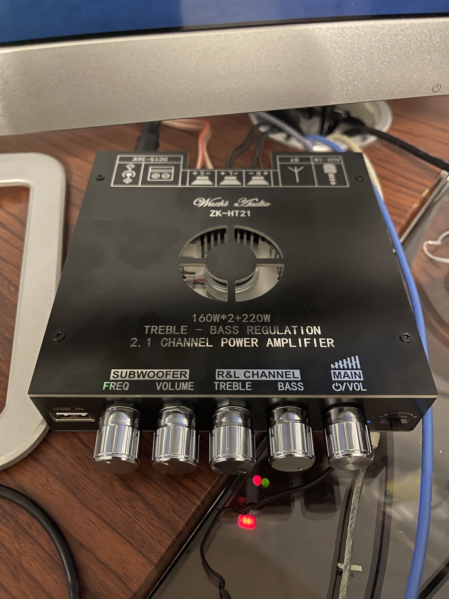

Hey guys. It's been awhile since I replied. I tried the method as shown, but I am not getting the same output as the original setup. The sub bass is flat no matter how I tweak it. I've done reverse and straight wiring and still the same result with the sub. The satellite speakers sound great. It's just the sub. Since I started back working on it, I've noticed that the sound will go out every other second with a popping sound in the sub. Could that be the power adapter not pushing enough voltage? I really want to replicate the original sound like you all have. The only thing I didn't do was the banana clip option, but that shouldn't matter being that it's wired point to point. I may have to buy a different amp to try. Any thoughts?
With my sub I didn’t have to reverse wire my sub. In fact I didn’t touch the wires other than to connect them to those post. I just bought the banana jack connectors to try out as well. I got the power adapter sparky had listed 24v 5a 120w not sure if it’s the exact one could be from a different manufacturer but so far so good.
Also, how are you using the amp? AUX in or BT (Bluetooth)? I have mine setup through the BT on my PC. I know I had to switch some settings on my computer, I had to disable Mono Audio under Settings > Sound. You might have other 3rd party filters or EQ throwing your sound off. You might want to try using your phone just to test a different device or some other source to rule out your if its the sub or something else.
Thats about all I can think of to troubleshoot.

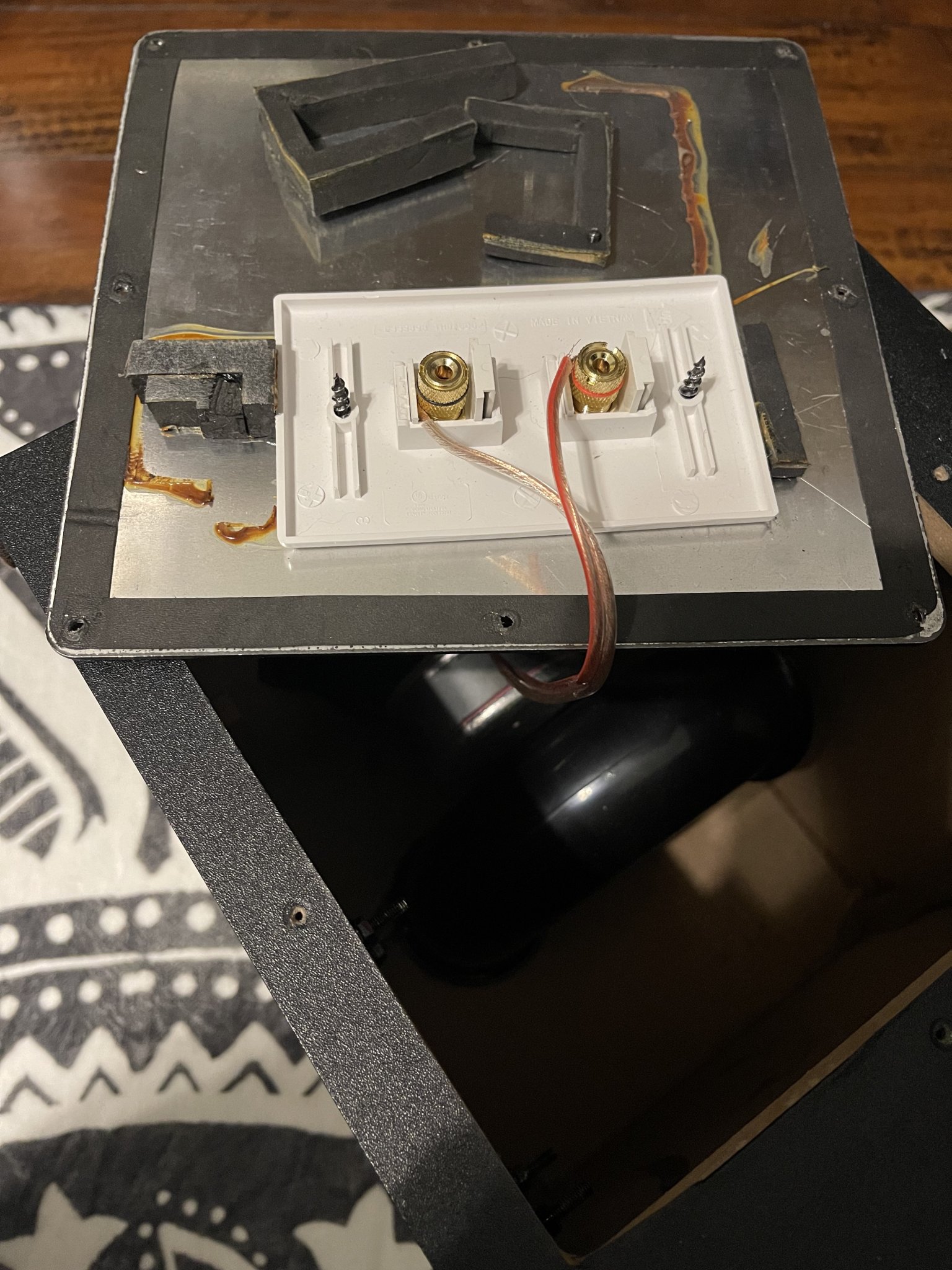

Well guys, If only I had followed Sparky Coldfire's instructions to the T, I would not be writing. Well, needless to say, my brain decided to go elsewhere and not pay attention to detail. So I ordered another mini amp with more output. The ZK-HT21, 160*2+220W to be exact, which requires a 36V adapter. Initially, I had the same problem of punchy bass. After tinkering for a bit, I decided to put the original cover up to the opening and BOOM, problem solved. I literally just leaned it up against the opening without screwing it down and you can hear the immediate change in tone of the bass. Therefore, I cut all the excess wiring off of that panel and screwed everything down accordingly. Needless to say I am very pleased with the sound now. Unlike Sparky, I just ran the speaker wire between the cover, but it does leave an air gap which slightly noticeable. I will most likely do what Sparky did with the banana clips to make moving it around easier, but for now, this works just fine. I appreciate all of the feedback and help!

Ok guys, here's a somewhat cleaner update. Found a wall plate along with the binding posts at Home Depot and decided to make it work. I think it came out decent. Could I have found something different, maybe, but I'm satisfied with the sound overall. When I put my ear up to where the banana plugs are, I can hear a little bit of rattling, but I can't hear it from a distance. I'm not sure where it's coming from. The plate doesn't move and I sealed it with silicone. It could be the plugs, but once again everything is sealed tight and nothing rattles or moves when I shake the backplate. I actually had fun doing this and will forever keep these speakers because I love the sound.

I apologize for missing this, but I can't remember if the wall plate came with the banana bindings or bought separately. I added a pic, but it looks a bit smaller than what sirknightd used. All I had at the time was a hot glue gun and some glue sticks...Those heat sinks are cosmetic only and used to cover up the holes left after gutting the inside and back plate. :geek: And to update you, everything is still working perfectly, the sound is amazing, and the base is as deep as the day I brought it home.
