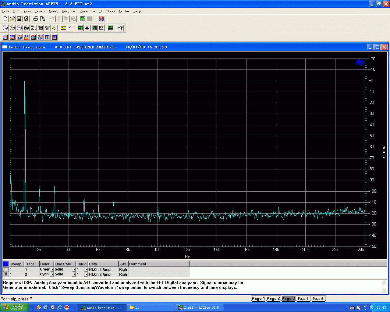

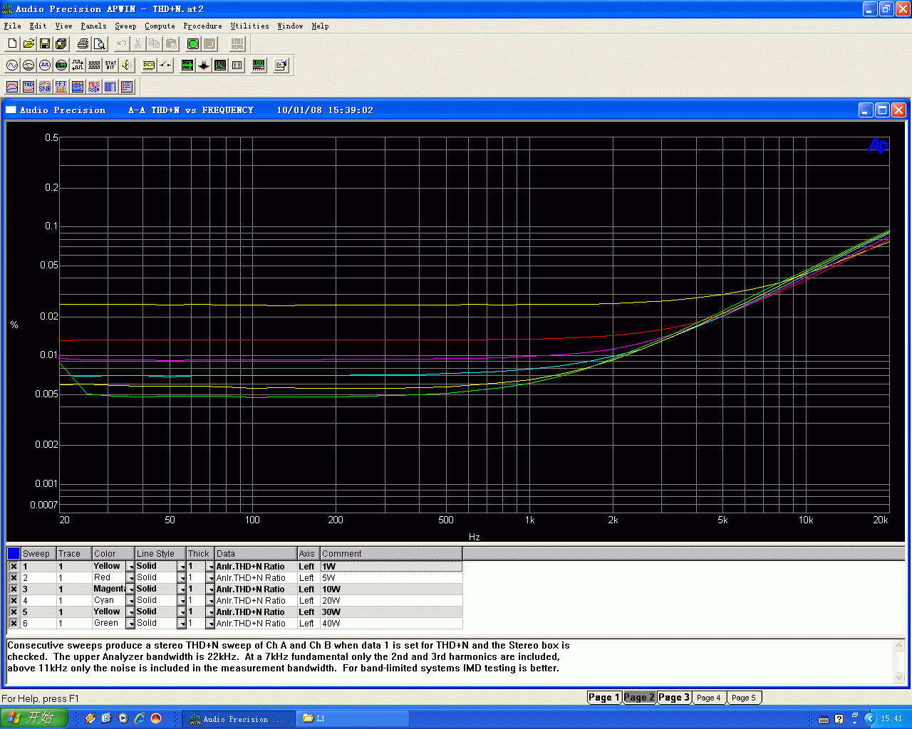

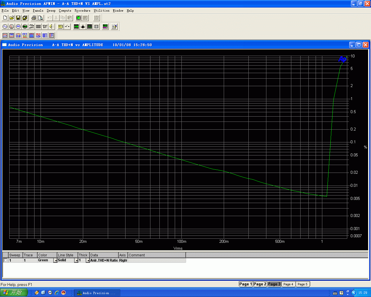

L12-2 CFP Output amp 120W*2 8R
Each track used 2 to 3 will SA1186 2 SC2837 2.
LAPT power transistors, ultra-high frequency FT, solve the CFP switch distortion.
Tiny hand in the distortion + 0.6 V.

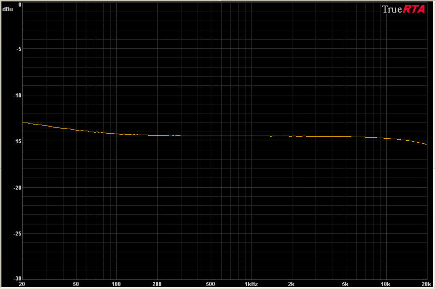

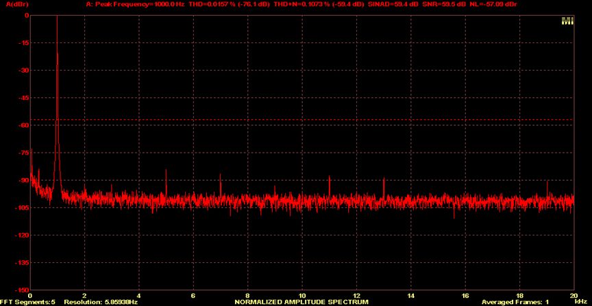

After running out of time with this project, I bought one of L12 kits on ebay. It's pre-assembled so all I had to do was connect a few wires from my power supply and mount it on heat sink. It works!

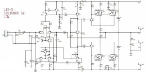

Below is the schematic from ebay. I checked the voltage across the resistors connected to output transistors (hope I've got it right) and they measure 12 mV at one and 10 mV at the other. There is no adjustable resistor for bias. Any thoughts on this?
I also posted the frequency response which I thought was interesting. Other amps I've measured show slight roll off at low frequency but this one has a bit of boost. FFT measurement of harmonics is very similar to what OP posted above which I expected for push-pull amp. Overall, I'm happy with the results from this $19 module. :)

The recommended 50V supply rails should be safe with 4R loads up to 150W. The 120W 8R capability suggests a stiff supply is being used at that voltage but I would not go much over a 300VA transformer in the power supply, just to ensure safety when the load drops below 4R as it likely will, on typical commercial speakers.
Those Sanken TO3P transistors are quite tough on audio as the SOA graph confirms. I can't understand though, why LJM's schematic shows them as Darlingtons. :confused:

This is the schematic they post on the web. You can see it is not screwed up like that above in #6 :
Dear Ian Finch
I tottaly agred with you.
This schematic is very similar with Yamaha small amplifier and it have extra compenents like the transistor like diode in position Q17 and Q19(i suppose). When you see the PCB there is one TO92 TR missing.

On mine, the voltage across R13 and R20 measure 12mV and 10mv. What do you think?
That should be around 40-50 mA. That´s perfect for my taste, but you migh hear different opinions. I follow the current of thinking that CFP should be biased low, at the limit of the crossover distortion. People more skilled than me have given some physics about that, but I cannot reacall who, at the momement.
