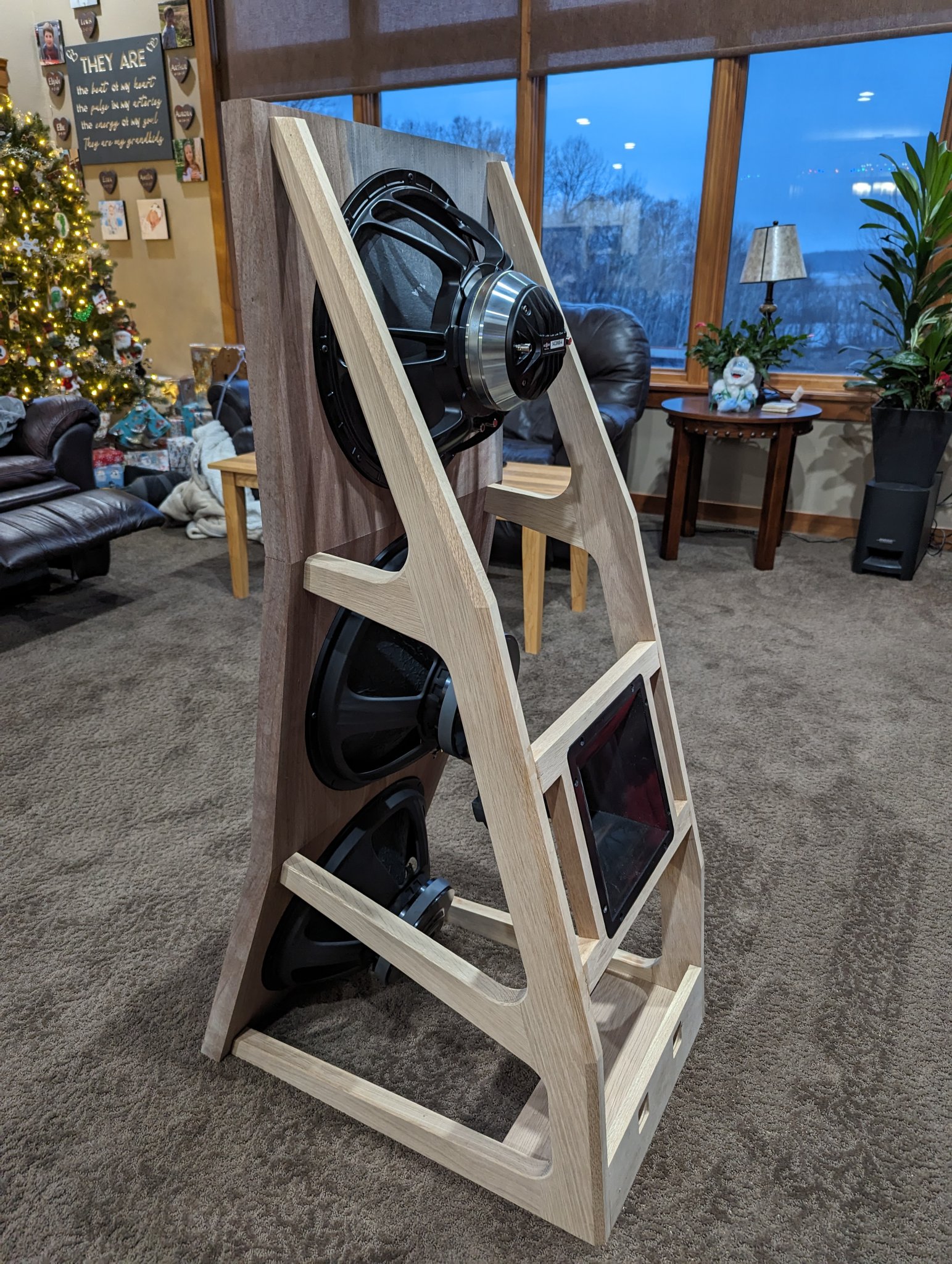

Gorgeous!Did a quick dry fit on the drivers as well.

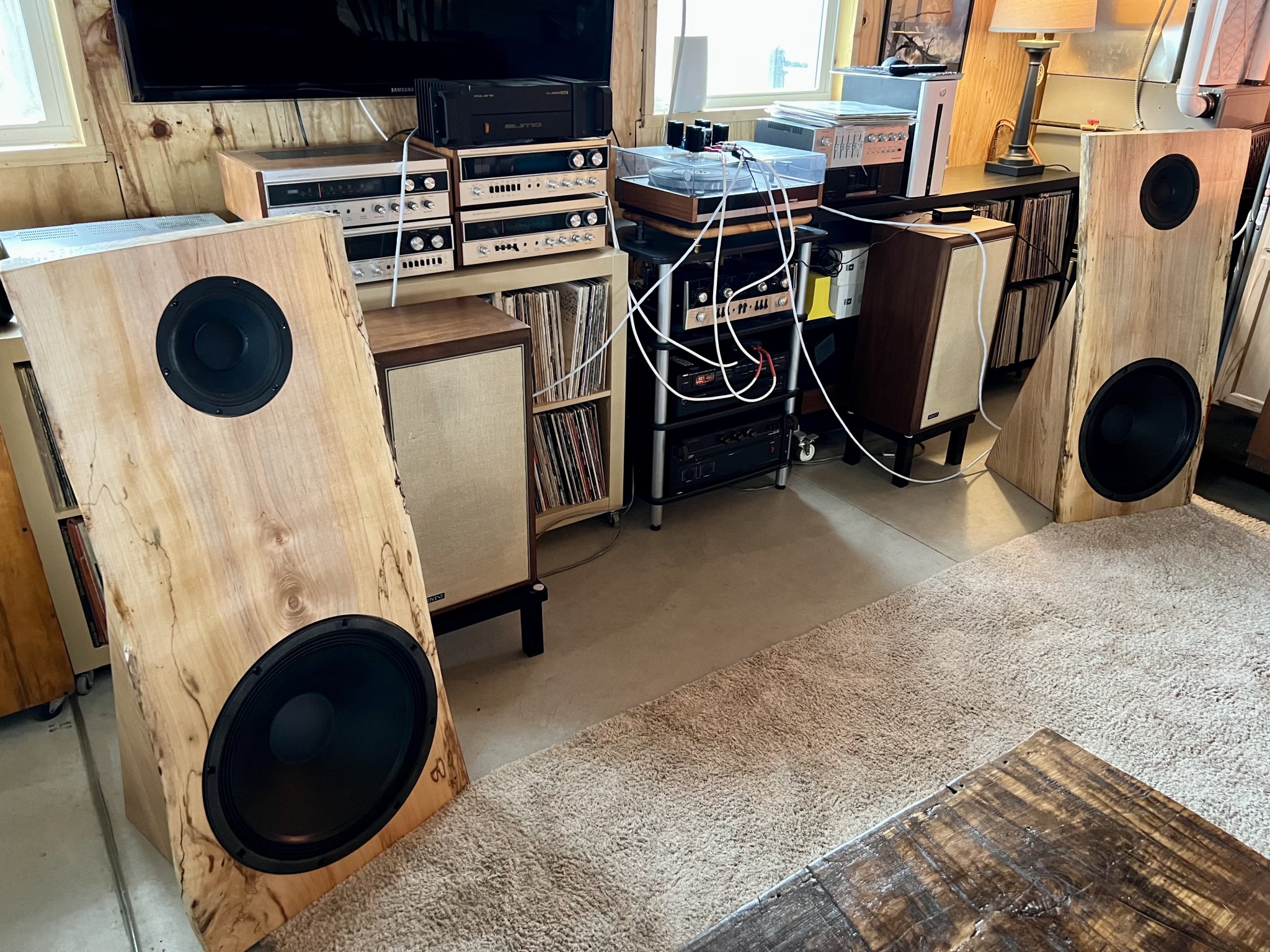

And happy to answer any questions or lend any support, just reach out. It was a fun project, and the speakers are fantastic.Tom Larwa (@tlarwa) chronicled his build of the Live Edge Dipoles in this thead on HiFiHaven. He brought them to a hifi meetup in Wisconsin last winter and they sounded great. View attachment 1244290

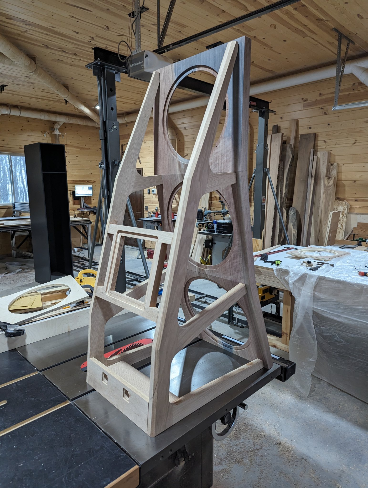

I really like how people are making this design their own, with thoughtful variations and excellent craftsmanship.Just figured I'd post a progress pic on my bitches brew's. You can see I have adapted the top driver for the 14.

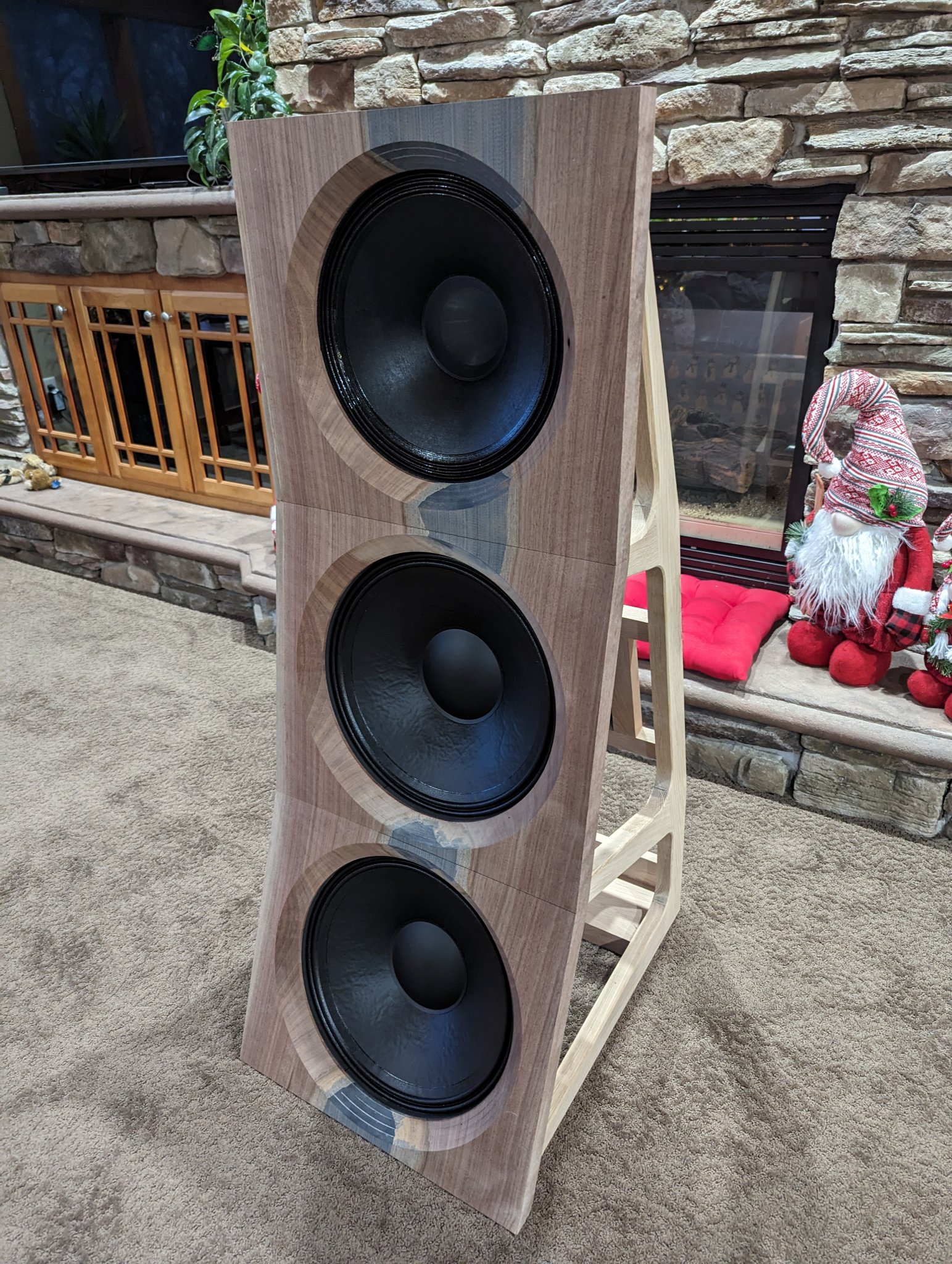

There is not a reason in the world why you can't do this, other than a low ceiling.How about adding two more 15OB350 above 15CXN88?
Will this work?

I also think it's neat how this design lends itself to small variations. Balthazarp's version looks quite different than yours, and mine is another version all based on the same base design. I still have my reservations about the minidsp unit possessing hardware that is good enough to do these speakers justice, but it's extremely cool that you can just make alterations to the active crossover to account for these design changes. My version will also have some removable wings that will fit in the open areas of the bass drivers to see what kind of bass extension I can get. I'm also toying around with the idea of making a single detachable side wing for the coaxial driver to see if having one wing will have a positive effect.I really like how people are making this design their own, with thoughtful variations and excellent craftsmanship.

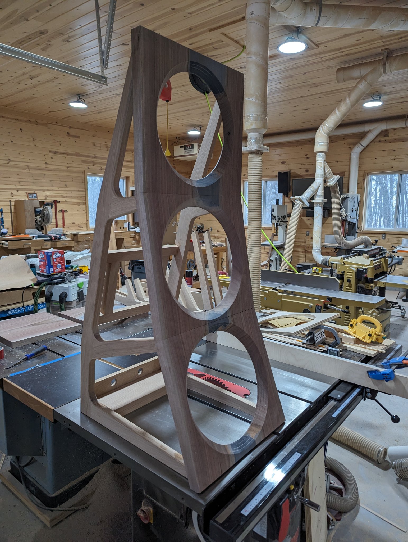

To heck with the speakers, look at that amazing shop!!Just figured I'd post a progress pic on my bitches brew's. You can see I have adapted the top driver for the 14.
Ok, so the speakers are looking pretty damn sweet as well. Were the baffle angle variations driven by aesthetic preference or by a hoped for performance gain?
Thanks dayneger! Yes, my shop is my "happy place".
So the baffle angles are an adaptation of the original bitches brew design that, as far as I know, was originally done by balthazarp on this forum. He has a picture of his speakers posted over on the Ultimate open baffle gallery on page 211. I took inspiration from the original design and balthazarp's adaption and mixed in some of my own design ideas to come up with the version you're seeing. As far as the baffle angles are concerned, first, I just think it looks cool. But second, I'm very sensitive to vertical off axis changes in the tweeter. The original design had the tweeter tilted back at 10 degrees (Perry has since said he would recommend a 5 degree tilt instead of the original 10) and the center of that coaxial driver is about 42". By angling the bottom 2 drivers as well as reducing the spacing between drivers to an absolute minimum I shave off about 1.25" off the tweeter height. But probably more importantly for me, the tweeter is now facing straight ahead instead of tilted back. I've never heard the original design so I have no idea if this is any kind of an improvement. Maybe it's worse. But for me it was worth it to try this for the potential benefit - plus I just like the aesthetic as I said.
I also built removable crossover boards which will house some Neutrik Speakon chassis mount connectors for the speaker cables.
The baffles are super rough from the drum sander in these photos. They will look quite different once they are all sanded up and finish is applied.

Beautiful! Inspiring!Did a quick dry fit on the drivers as well.
