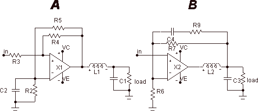

hi all,
This two circuits almost identical to other circuits which can be found in any textbook, however they famous today as class D self oscillation amps (A- similar to typical opamp square wave gen, B- to conventional linear power amp, just with enlarged coil value, and added phase lead term for switching freq. control).

Hey, thats it! This maybe one answer.
With my 3 basic understanding, maybe we can make a self oscilating class D
1. Output mosfets in class D is only working on-off, with modulated width (PWM), its width is proportional to the analog signal. It forms PWM square wave.
2. Opamps are linear amplifier. It can swing to any analog voltage within its VCC range. The pins are non inverting (+), inverting (-) and output.
3. Comparator is a saturated amplifier. Its output is only up or down, without any voltage between the VCC. Has the same 3 pins like opamp.
Maybe someone with simulator can help me. Imagine we built a simple inverting preamp, gain=-10x, using opamp, like TL071. The VCC will be +/-5Vdc. The non inverting input (+) is grounded. The input is taken to inverting input via 1k resistor. The feedback is taken to (-) input via 10k resistor. This will be magnifying audio signal to -10x, right?
Now we replace the TL071 with comparator, like LM311. And we put LC filter to its output. The feedback is taken after the LC filter. The comparator itself will be working in square wave, but after LC wouldn't it be analog?
Is this a self oscilating class D? Making saturating ordinary class AB amp, but putting LC filter in its output?
I've done some search about UCD amp. It turns out that the patent is EXACTLY the drawing B (IVX's).
If my previous idea is using a saturated amp (more like comparator than opamp), then, after looking at this drawing B (UCD patent), I think this principle can be done with any class AB amp, without having to change it to saturated amp.
Why? Because the inductor in LC filter itself will make the output transistors in ordinary class AB amp works to saturated amp (producing square waves), to make analog output after LC. Is this right?
Most linear AB amps won't like working continuously in saturated mode very much - they may even overheat and blow up, depending on the outout drivers that are used. Most linear amps take their own sweet time coming out of clipping because of storage time effects in the driver (and output, if bipolar) transistors. You really want to build an amp optimized for switching operation.

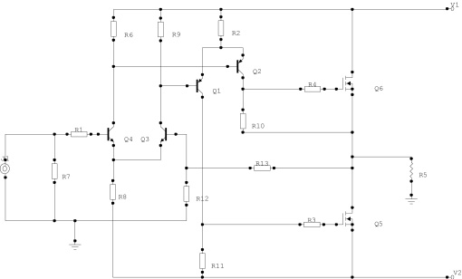

Hi lumanauw,
why you want to force class AB (why need bias) for working as class D? ( a cow could be flying?) For any of class D experimentation simplest solution is a power comparator (lm319+ir2110 etc). If you'll be have such power comparator, then one week be enough for checking several basic class D circuits. But anyway UcD is most cost effective approach, IMHO. Sound & specs just fine.;)
One reason for R2 is to prevent those transistors from going into saturation which would make their response very nonlinear, and cause lots of distortion. It also would help to smooth the crossover between mosfets. But when I experimented with that circuit years ago, it was quite distorted. Also, that type of mosfet drive definitely is way too slow for class D.
