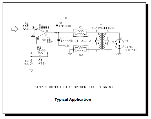

From the Jensen datasheet:
"This transformer is designed for high performance output stages. The 50% nickel alloy core gives it excellent distortion and level handling. It may optionally be configured for 1:2 step-up or 2:1 step-down operation. Driving signals should be free of DC and source impedance kept as low as possible."
I don't see any particular problem interfacing it with Mez DCB1, DC offset is typically very low with well matched JFETs not to saturate the transformer. Because its input impedance (Zi) is stated 712 Ω typical, use a 33 Ω output resistor in the Mezmerize instead of 220 Ω. That's working like the X1 isolation in Jensen's example schematic. There is about 35 Ω intrinsic JFET output impedance added to that. Use a 68 Ω in X2's place. Keep the DCB1 board output and the Jensen near in same box with short cables.
