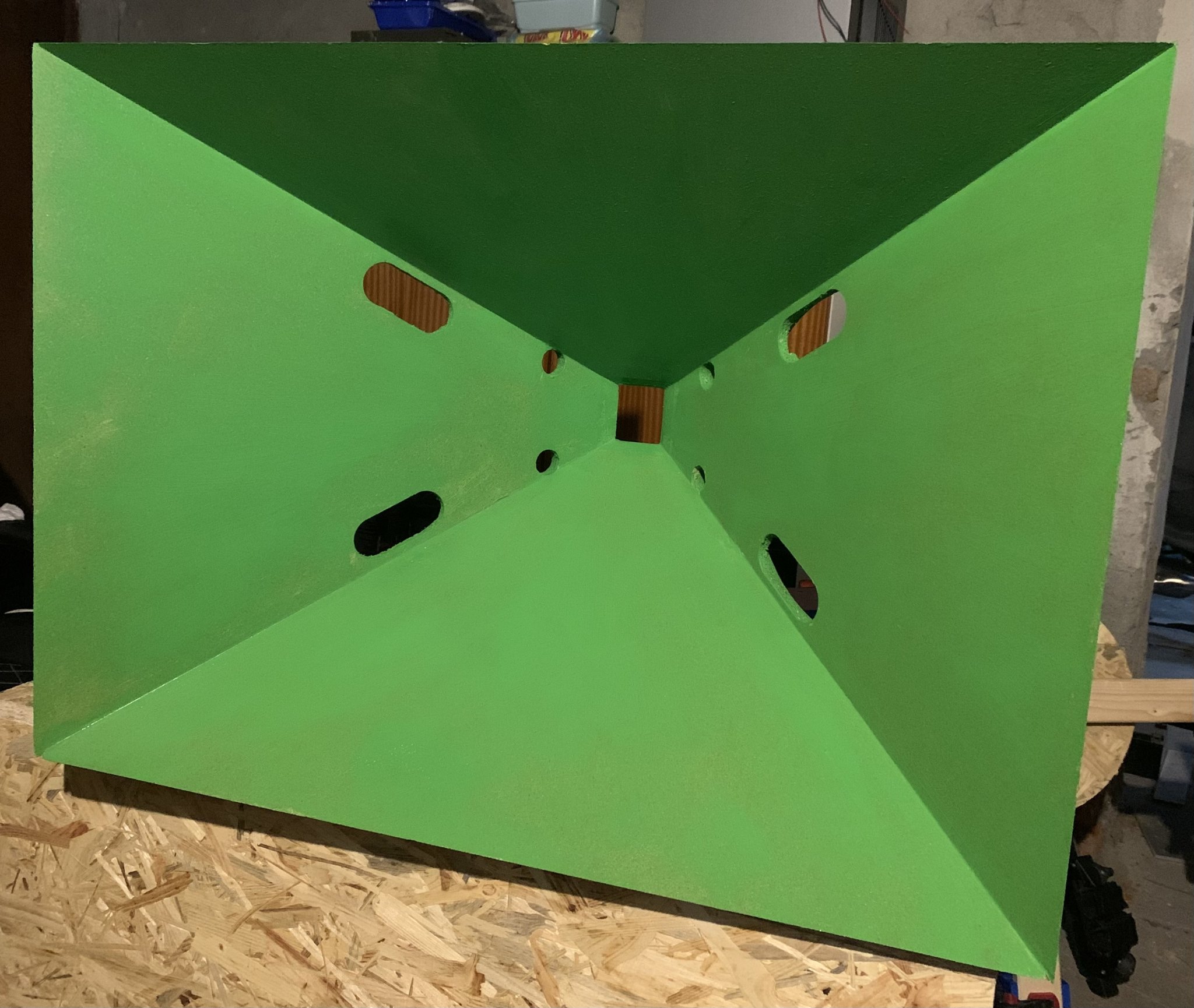

The 2 way SPL Runt clones are pretty compact. Mouth ca 560 x 320 mm. I can definitely recommend Fane Sovereign 8-225, I use them sealed, but they would work with BR as well. The green horn is 80 cm mouth width with 2x12 and I would definitely not call it portable even without a back box:)

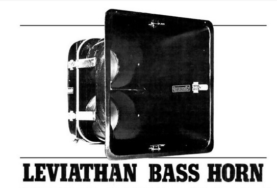

The SynTripP horn extensions are just one example of detachable horn sections.
Community light and Sound had fiberglass/balsa wood core bass horn extensions that could be stacked like Dixie cups:

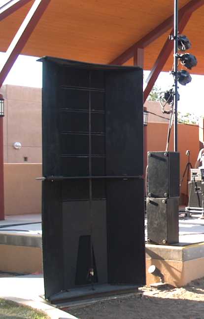

No problems at over 130dB SPL at one meter, using 1/2" ply for "wave guides" in front of 10 x8", 5 x3" diaphragm HF drivers and an 18" tapped horn :
WS Mains w:waveguides.jpg

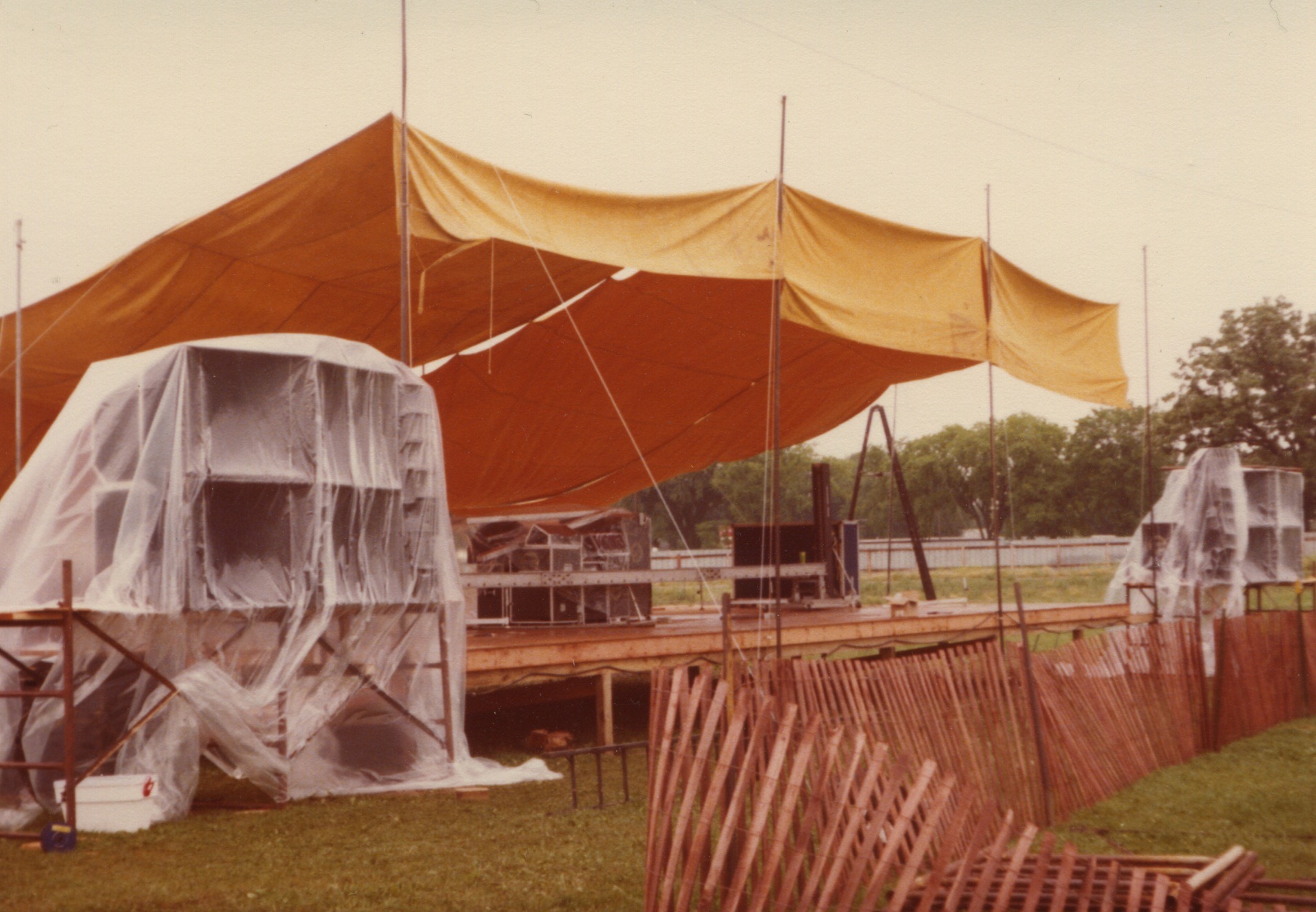

In the 1970s I made 2x15" exponential bass horns from two pieces of laminated 1/4" plywood.
They can be seen in this 1978 photo behind plastic:
The horns mouths were 48", the throat 7" wide, top and bottom flats attached with rods and turnbuckles.
Standard plywood was bent over curved struts, similar to airplane wing construction.
Using "bendy ply", much tighter curves are possible.
Took a while to explain to stagehands, slowed setup time, but reduced the horn transportation volume to about 25% of the assembled size.
Toured arenas across the country using them, as long as the tension was correct, no problems with shaking or vibrations.

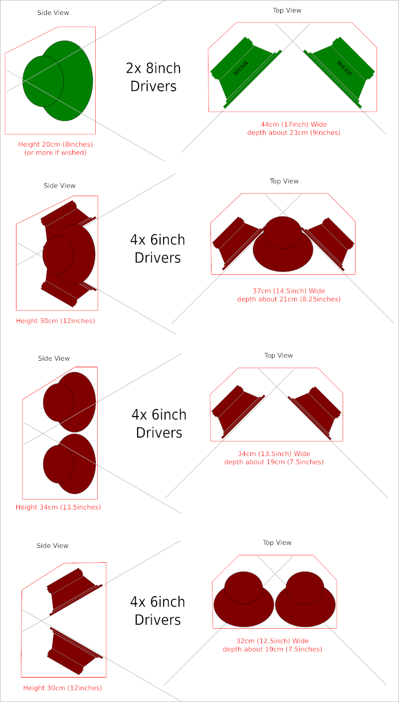

Just for interest, I had a play around with some dimensions. It doesn't mean a lot at this stage since nothing has been simulated for driver positions or choice of specific drivers etc. but as a sanity check I looked at how a pair of 8" woofers might be arranged and also 4x 6" woofers (which are perhaps similar in total) on a 90x60 degree cone. The 6" ones would cost a lot more and weigh more but (if they'll go down to 80hz) they would also allow more choice of aspect ratios and slightly smaller size for the outer casing. Though there is less size difference than I had anticipated, to warrant the extra weight and cost.
Just a few example possibilities:
(click to enlarge)
So, I might be able to pack a pair of these into a 15" cube for storage/transport etc, which would be good. Though obviously the add-on extensions to the cone and flare would take up additional space.

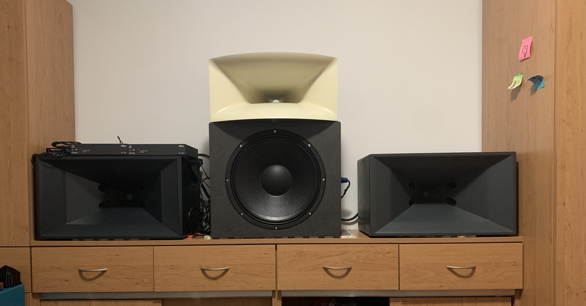

Thanks, that is all very helpful; real-world experience with things very close to what I'm aiming for. My current compression drivers are a pair of 1" Faital HF108; they'll get down well below 1khz sweetly and with dynamics to spare at my normal listening levels. However, at very high (home) SPLs they can start to sound a bit pushed (without a waveguide that loads highly, anyway). So yes, I tend to agree that this might be hovering around the threshold of suitability.
I shall need to be more decisive on the scope for this project. For the current use, the HF108s would be great to below 1khz. However, on reflection it would be prudent to allow for future eventualities, needing more SPL - such as for Home Theater use, or bigger rooms than the current one. That could mean crossing higher (to smaller/more woofers), but I think there are still other reasons why crossing low remains desirable.
In that latter case, a compression driver with bigger diaphragm could make sense. Realistically that would mean stepping up in throat size too, but some of the modern ones apparently don't beam as much as their exit diameter might indicate, and my hearing age is old enough to not care about reaching the full 20khz either. So something like a 1.4" with a clever phase plug might be a better compromise in my case. I know some people like the dual ring types, but I'm not sure they're for me, or necessary for my application.
Anyway we'll see if I can breathe life back into my windows laptop and do some simulations. If I can get to grips with hornresp, anyway. My ideas are going to be vague until that point but IMO still important to consider the general format needed. It would be upsetting to expend all this time and money, to then realise my target wasn't what I wanted.
