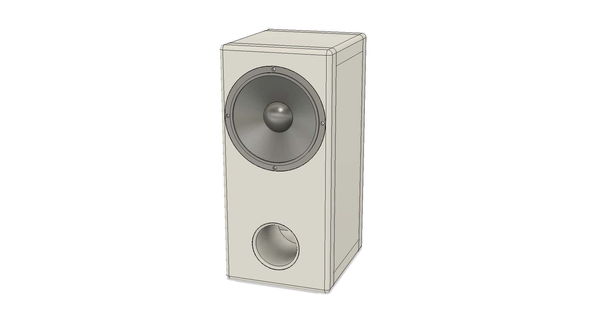

2- if building for emicence alpha 4, there’s 3 option I’m thinking.
2.1- building a regular, prism, sodden box.

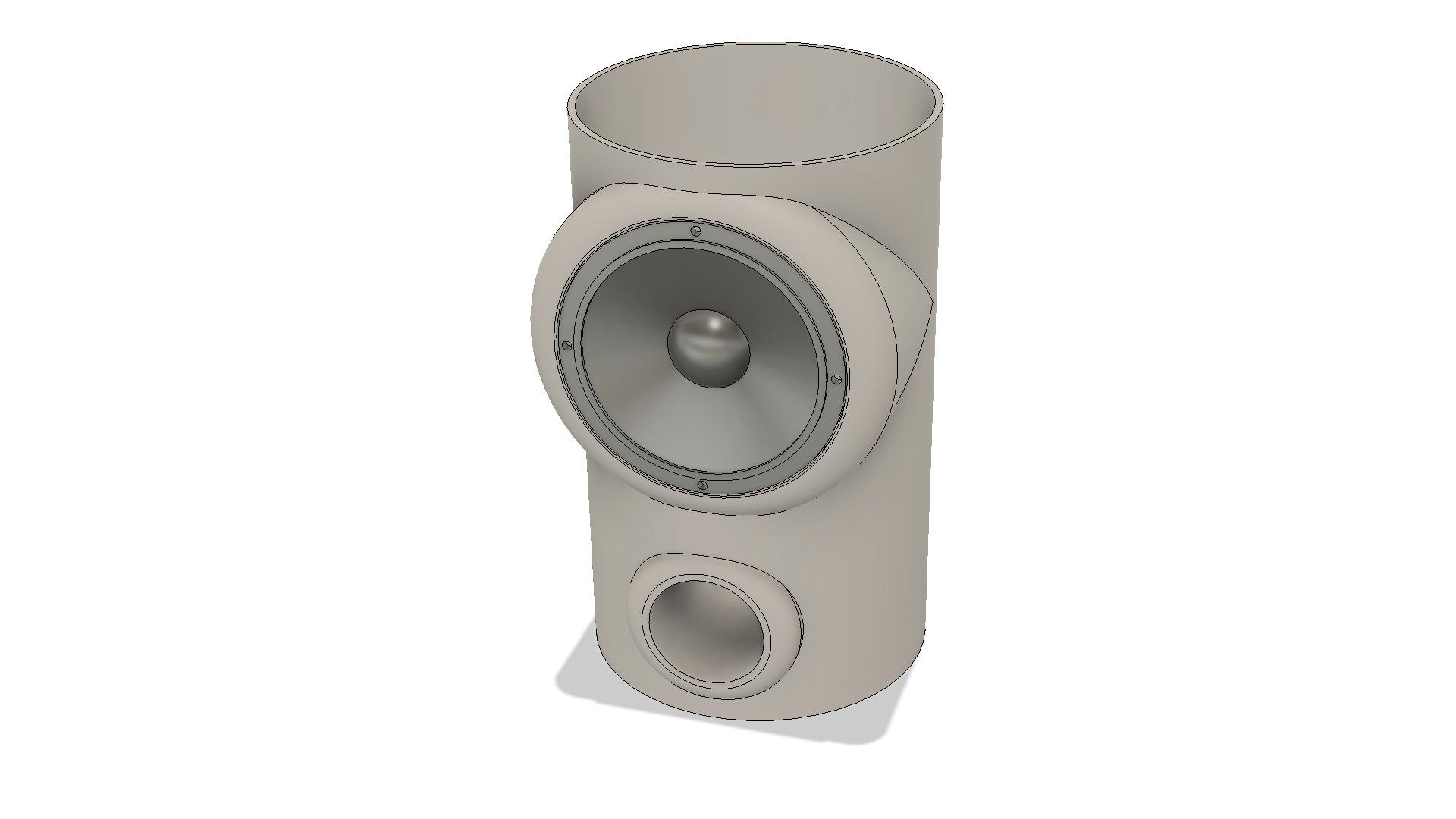

2.2- going with the sonotube / 3D printed angled bracket.
(https://www.avsforum.com/threads/diy-cylindrical-angled-atmos-speaker-enclosures.3255712/)
(https://www.avsforum.com/threads/cr...rsl-c32e-in-ceiling-speakers.3293578/#replies)
2.3-

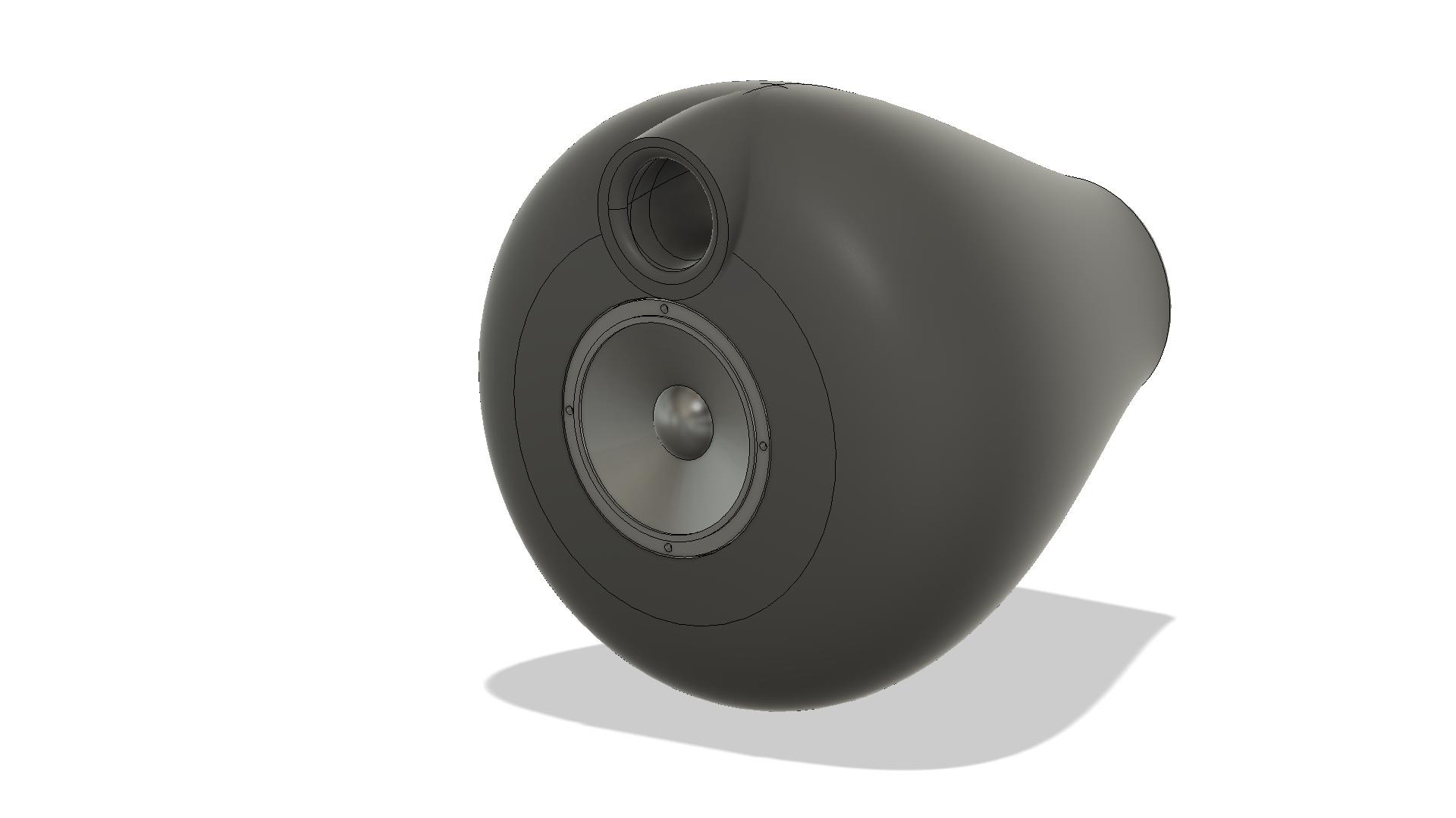

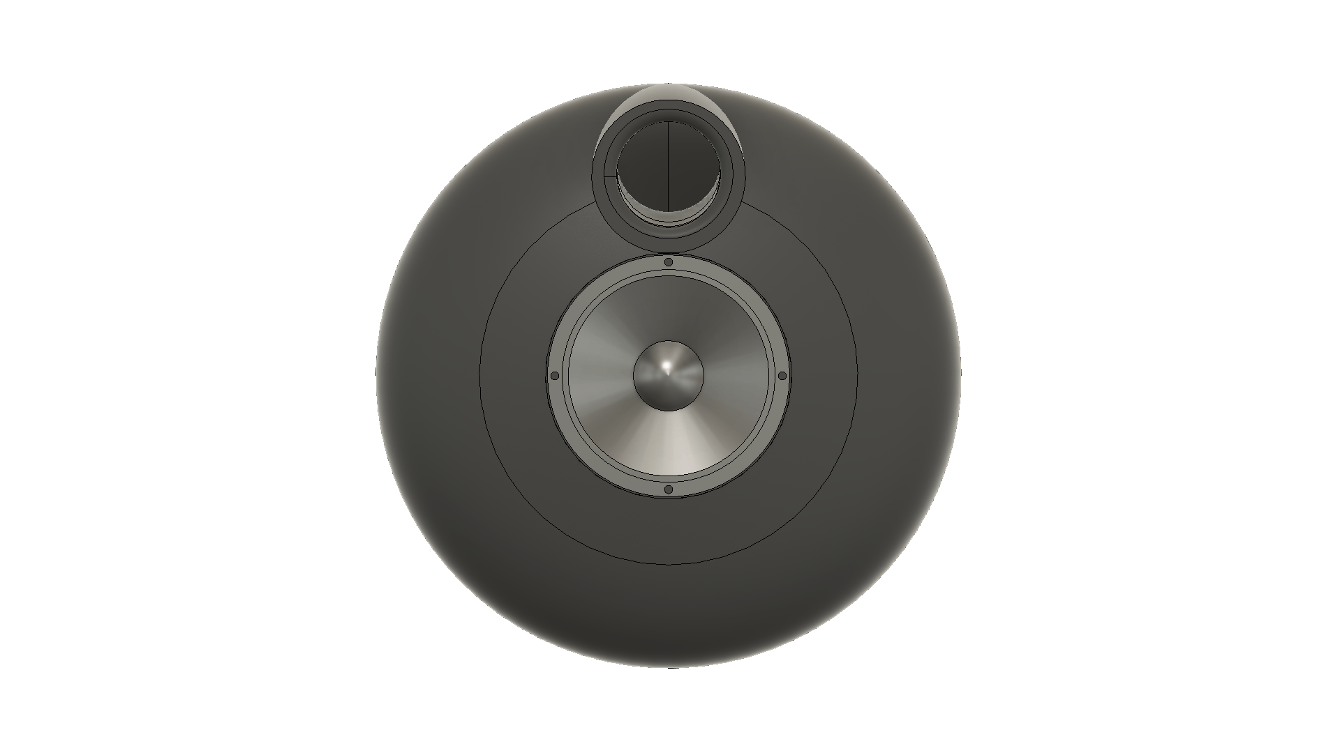

Speaking with my friend about the sonotube version, and that it’s not a good thing having a cylindrical (circle) baffle has it has lots of diffraction. So I suggested I could 3d print a half-sphere to go over and install the driver. Then he suggested that I print a bower will in shape:
So with the proved eminence drawing tonight I tried to model the 3d printed “bower wilking” enclosure.
(Since those pictures, I rounded the corner inside the speaker, back wall and port)
Volume and port diameter and length is provided by eminence.
(https://cdn.shopify.com/s/files/1/0270/8665/1462/files/Alpha_4_8_cab.pdf)
See page 10
I want the build to be “quick” . I don’t want to spent all my free time making boxes for those speaker, but I want the best sound possible. Going 3D printed route would allow me to start the printer and do other things. When all pieces are done printing, I could glue them, install driver and binding post and call it a day. When I have more free time, I could sand them and paint them.
If going wooden box, I feel like I would need to spend “a lot” of time doing cuts and assembling, also, I could not finish the box, but I feel like they would be uglier unfinished mdf box and 3d prints.
What you guys think?

Well, I dont think the 3d printing project will go through.
I've run it quickly in my slicer program, and for only 2 part out of 8, it requires 18hr of print and at least 2 kg of plastic for all the parts. for ONE enclosure!
ill make wooden box!
it was a fun practice for 3d modeling tho!
