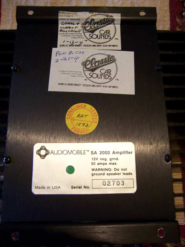

Does anyone have a PDF scanned manual for the AudioMobile SA 2000 they can email to me?

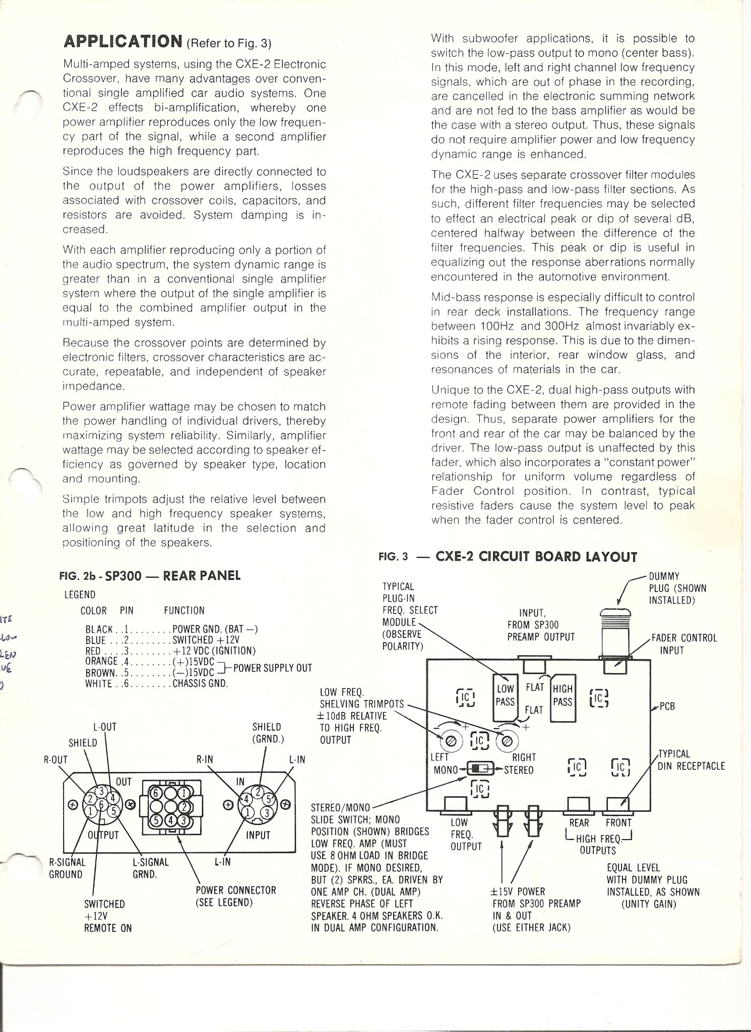

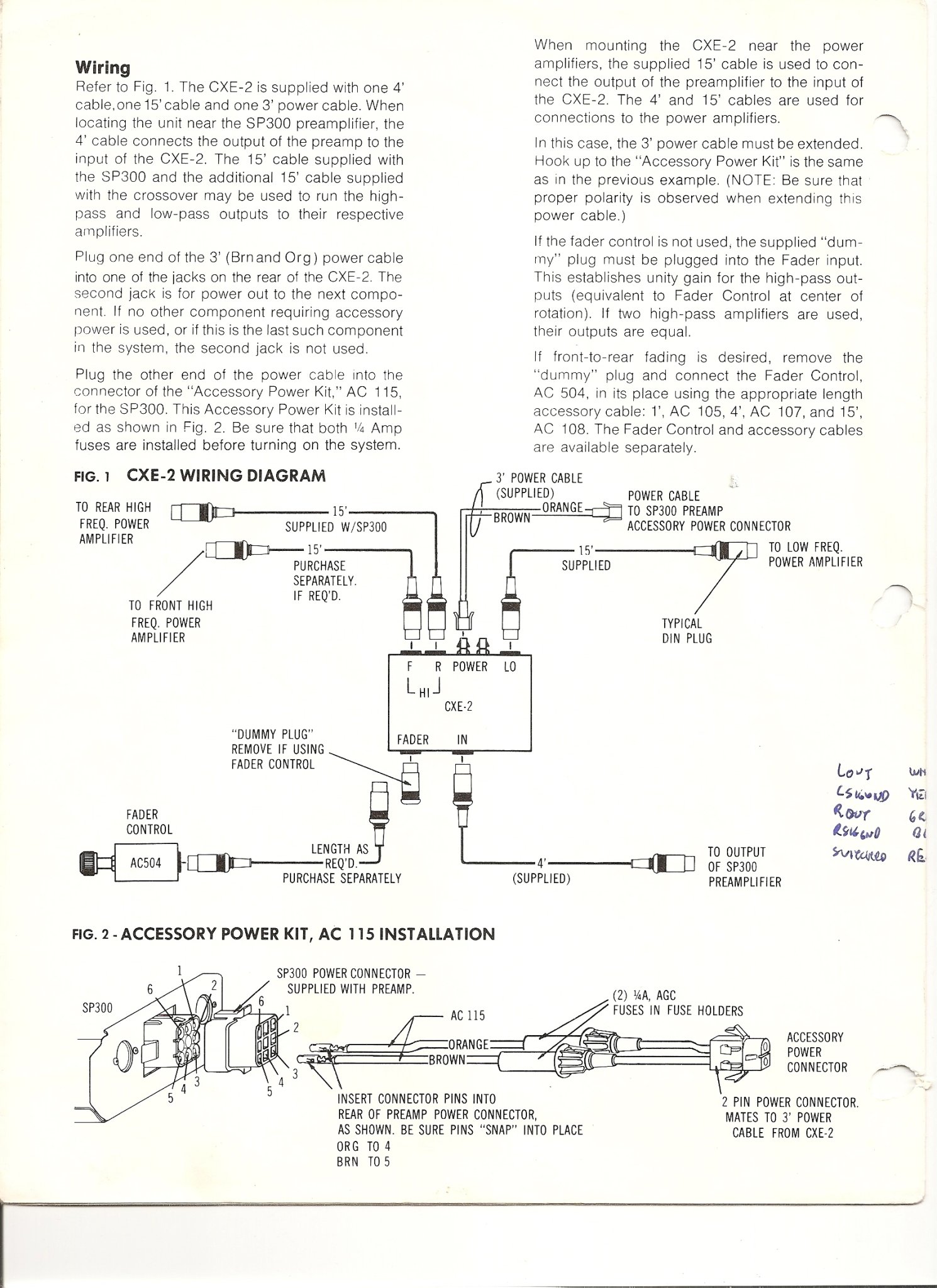

Heres the basic DIN PLUG layout of the early AUDIOMOBILE product line. Later amplifiers (SA-1200, 1600) used a 8 pin DIN and the layout is different. The CXE-2 CROSSOVER is a 30 volt OPERATION. POWERED by the SP-300 EQ. Orange and Brown wires POWER the crossover from the 30 volt -&+ inside the EQ. NJOY BDBD/2023

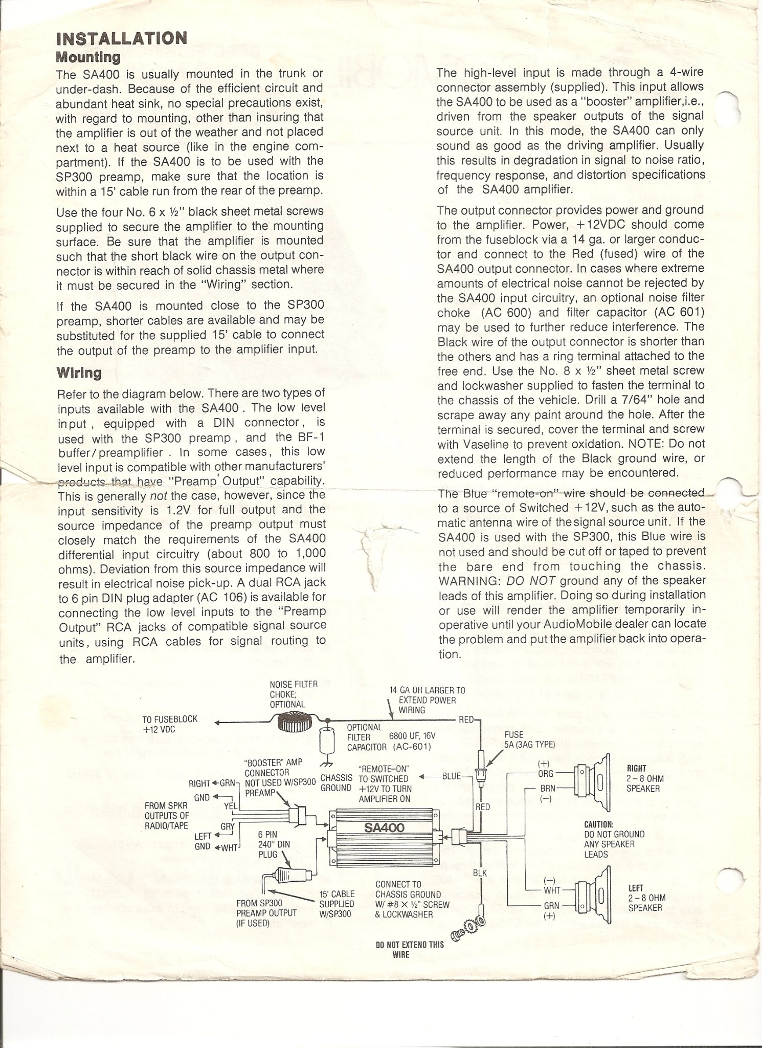

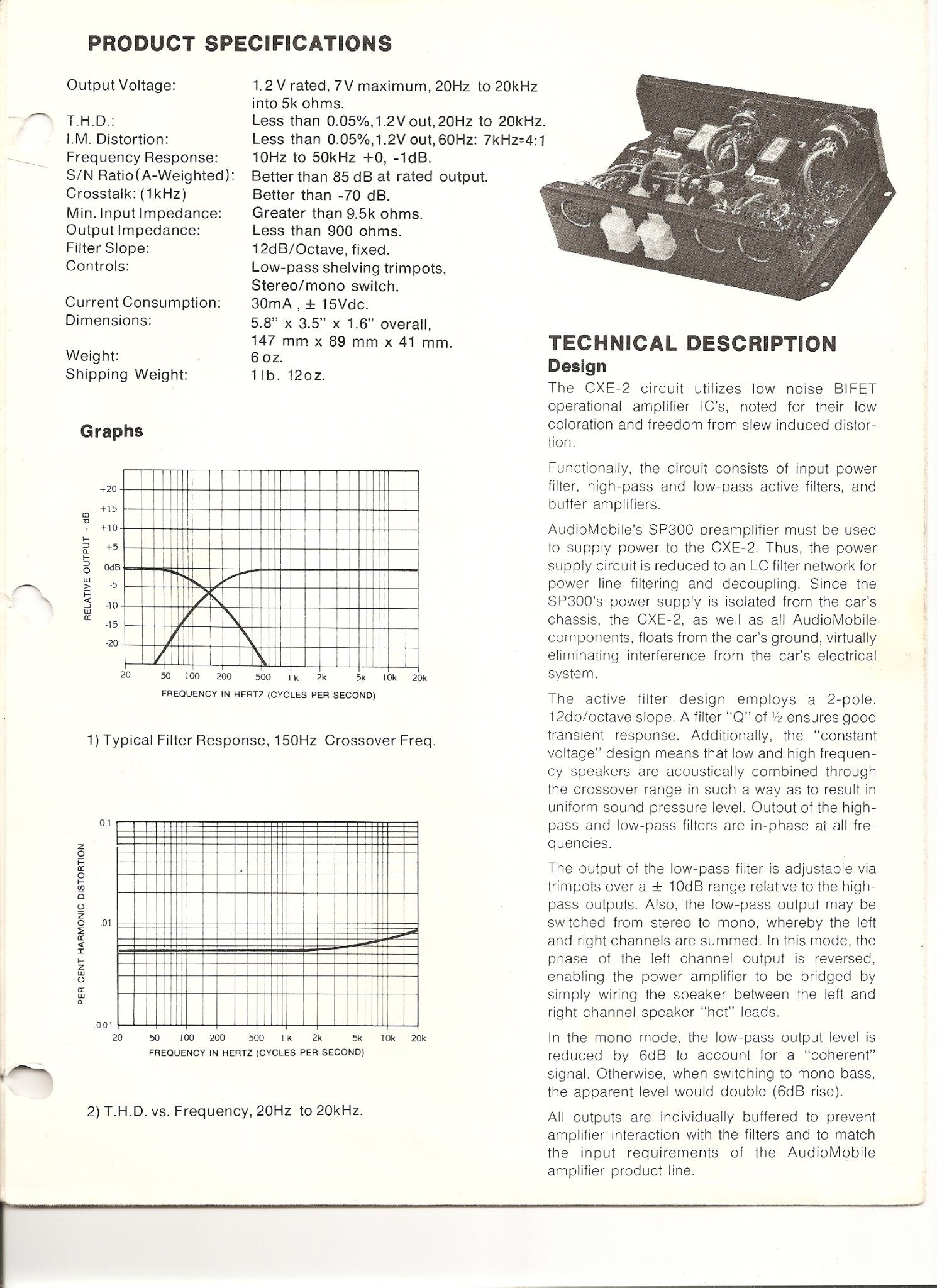

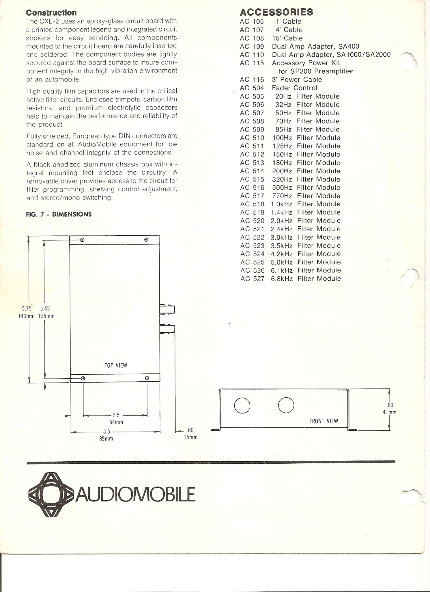

Heres the CXE-2 Crossover Brochure. These are likely ALL anyone would need to BRING BACK TO LIFE, their old AUDIOMOBILE gear same as I did. NJOY/BDBD/2024
