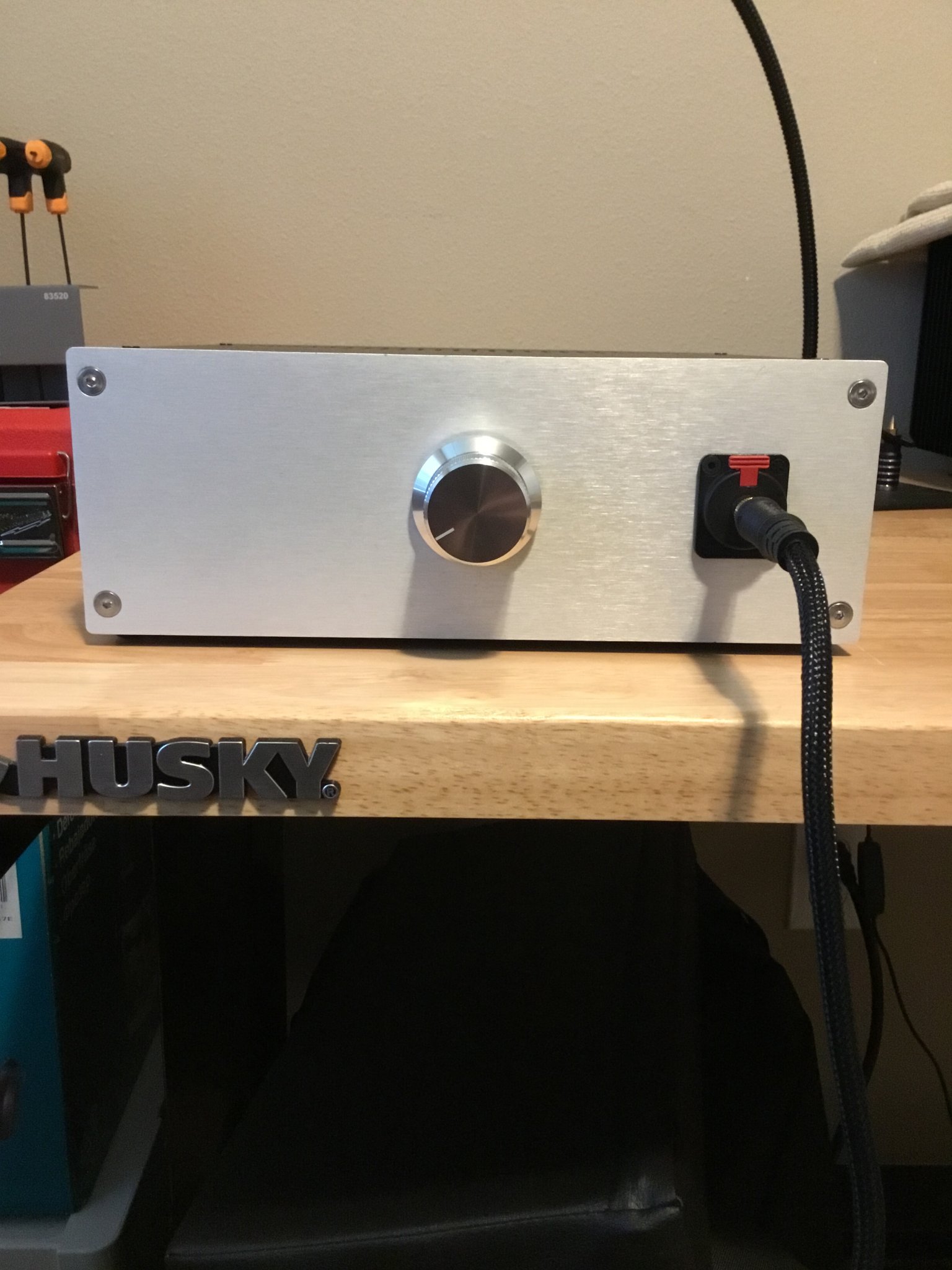

Out of the toaster and into something more presentable. Plain and a little generic, but safer and more robust.

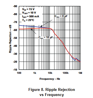

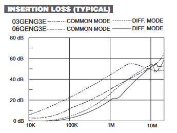

A filtered power inlet does not replace the onboard LRC filter. I suppose a filtered inlet won't hurt, but it wouldn't add much, either. Such inlets typically add a meaningful insertion loss starting from high hundreds of kHz:
while the onboard filter suppresses noise starting from high 10s of kHz, where the regulator's ripple rejection starts falling with frequency:
