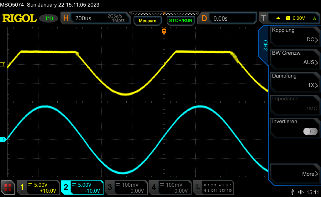

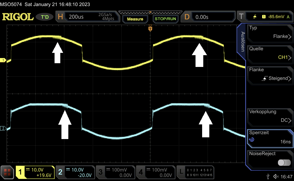

Looks like oscillation somewhere.
Yes. The output NPN transistors are suspect (see my previous post). The same amp with BD139/BD140 shows nothing like (again, see my previous post).These look like oscillations to me.

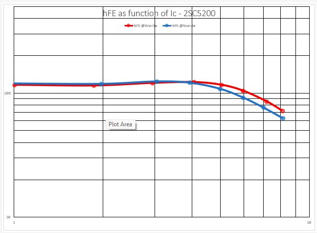

The problem is that at low Vce and high Ic, the DC current gain and the unity gain frequency of BJTs fall sharply - this effect is known as quasi-saturation. Unfortunately, it is rarely documented by manufacturers (Sanken is a happy exception).
As an illustration, here is the DC current gain of the 2SC5200 as a function of its collector current, measured at Vce= 4V and 5V:
Here, a popular power transistor rated for 15 amps starts losing its beta above only 4 amps.
Quasi-saturation sometimes may be a problem in power amplifiers, but usually not in headphone amps. In particular, the BD139/BD140 pair chosen for Omicron behaves perfectly under a variety of loads, including those way beyond what Omicron was designed for. The SMT version runs on good old 2222/2907 with no issues.
The transistors used in baggerbole's build (2SC3421/2SA1358, both obsolete) should have the unity gain frequency of 120MHz, which is better than that for BD139/BD140. However, these particular specimens of 2SC3421 demonstrate very low current gain and what appears to be a poor frequency response. My suggestion is to replace them with the BD139/BD140, which are inexpensive, readily available, and have been demonstrated to work well.

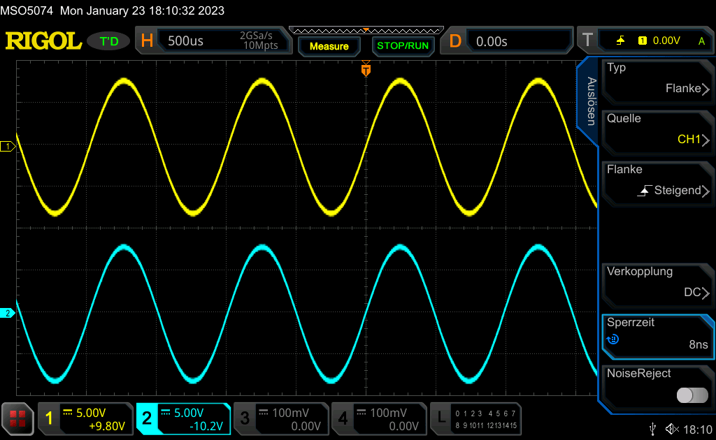

I changed Q21/Q22 to BD139/BD140
Output is loaded with 2x16R
Yellow trace is output with 2SC3421/2SA1358
Blue trace is output with BD139/BD140
I´m pretty shure the 2SC3421 are genuine. I bought them many years ago from a reliable source.
Grounding the heatsink didn´t change the results.
It looks like your observations hit the nail
You did a great job Alex
Thank´s a lot for your patience with a dump guy. I have learned something.

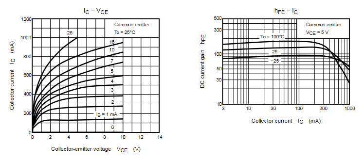

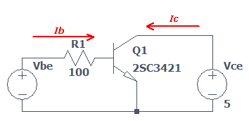

As for the 2SC3421, test them. With a regulated, current limited power supply, it's easy. Clamp (or bolt) the transistor to a heatsink and connect it as follows:
R1 protects the transistor against excessive base current (100mA max for 2SC3421). Vce is set to 5V because that's the voltage at which the datasheet specifies current gain:
Set Vce current limit to below 1A - that's the max collector current for 2SC3421. Set Vbe to zero and power it on. Now slowly increase Vbe and measure the base current Ib (e.g. as a voltage drop on R1) and the collector current Ic (directly with a DMM - the current limit at the power supply will protect both the transistor and the ammeter) at several Vbe values. Calculate hFE=Ic/Ib and compare it to the hFE-Ic chart from the datasheet. You can also vary Vce and compare the results to the Ic-Vce chart:

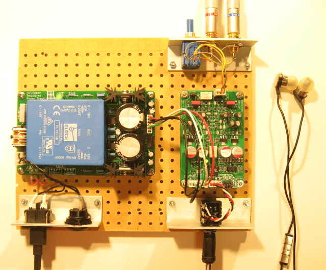

Tested my Omicron today with a range of mobile earbuds and on-ear cans, ranging from the inexpensive Panasonic RP-TCM125 ($13 on Amazon) to the magnificent 3-way AKG K3003 IEMs (claimed to be "the best in-ear headphone ever made by far", with 8 ohm impedance):

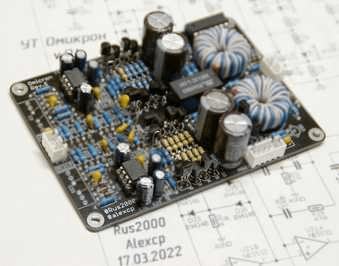

The only problem found was not with Omicron or headphones but with a cheap 1/8" to 1/4" plug converter. As you can see in the picture, my copy of Omicron is equipped with a Neutrik 1/4" jack, so 1/8" plugs require an adapter. The one I had at hand worked with older no-mic earbuds, but more recent pairs equipped with a microphone sounded distorted, probably because of a poor common wire connection. Changing the adapter solved the problem, and each pair in the batch sounded as expected (within its budget).
I also got a chance to compare the sound with 200 ohm in series with the output (the SMT version of Omicron, pictured above, has a line output with RCR T-filters), which refuted my hypothesesis from #106 above. The low output impedance of Omicron is not a problem. Cheap plug converters are.

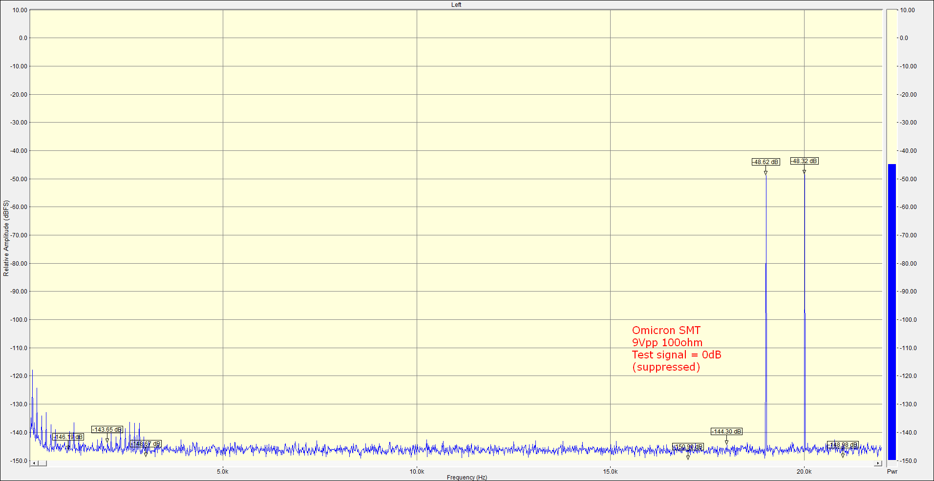

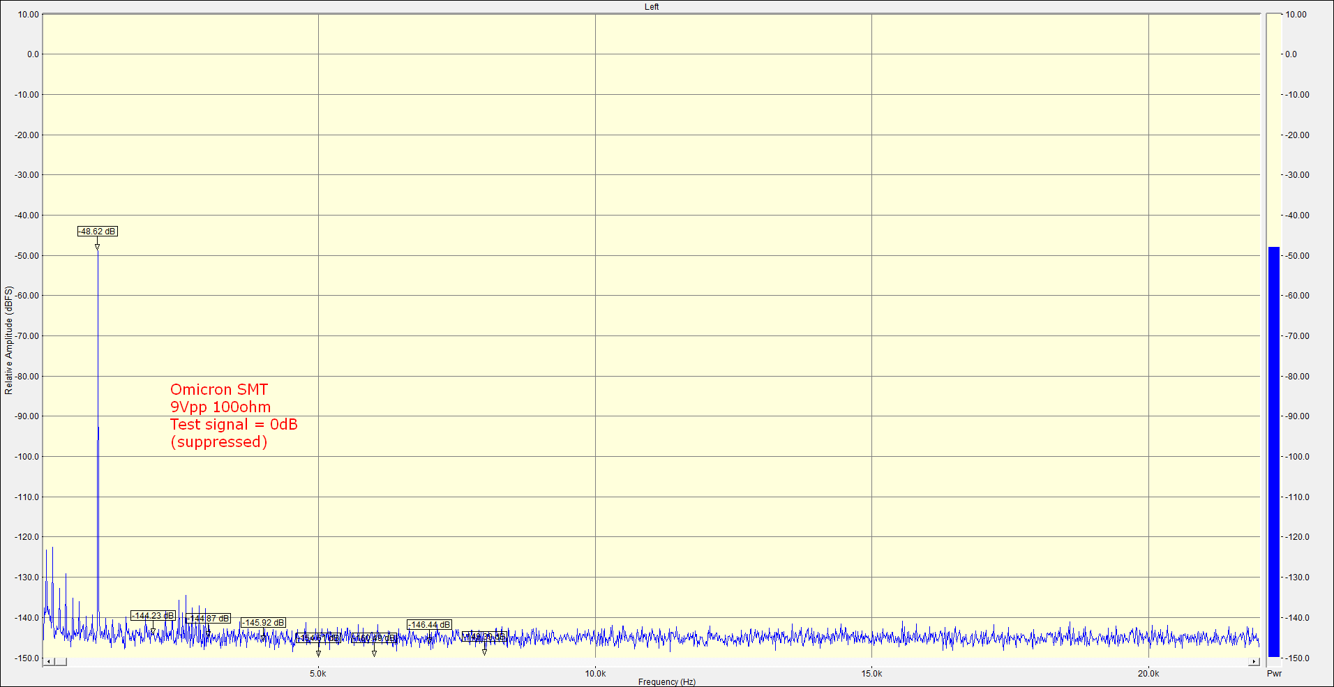

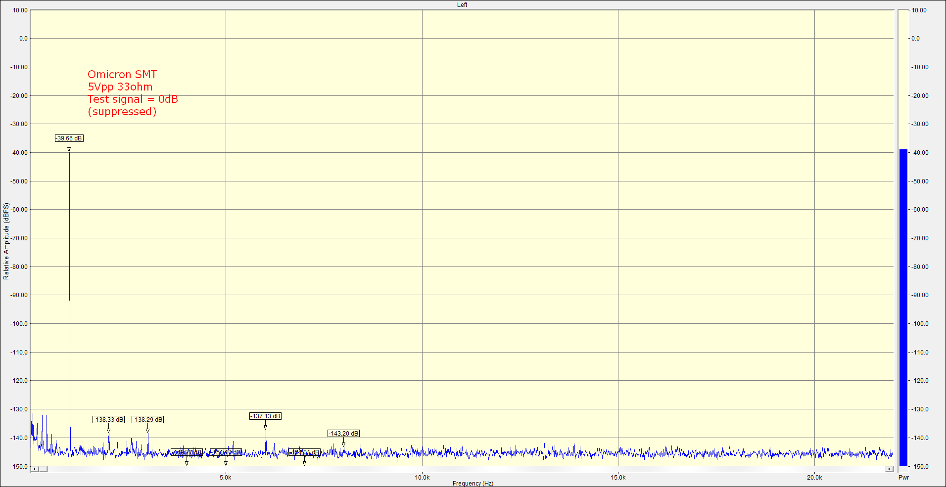

Finally, tested the SMT board pictured in my previous post. The distortion performance is identical to that of the through-hole board with the same quiescent current (25mA) of the output stage.
BTW the output stage on this board is one pair of PZT222/PZT2907 in SOT-223 packages per channel with. With that quiescent current and +/-17V supply rails, the two channels dissipate 1.7W with no heatsink other than the PCB itself.
As long as the output stage stays in Class A, the distortion is hard to detect. Here is the THD and IMD when driving a 100 ohm load to 9Vpp (which is 200mW peak power or 100mW RMS on a sine)
When driving a lower impedance loads to full power, the output stage leaves calls A, but Omicron still stays extremely linear:
Compare these to the published distortion performance of other headamps claiming high or even ultra-high performance...

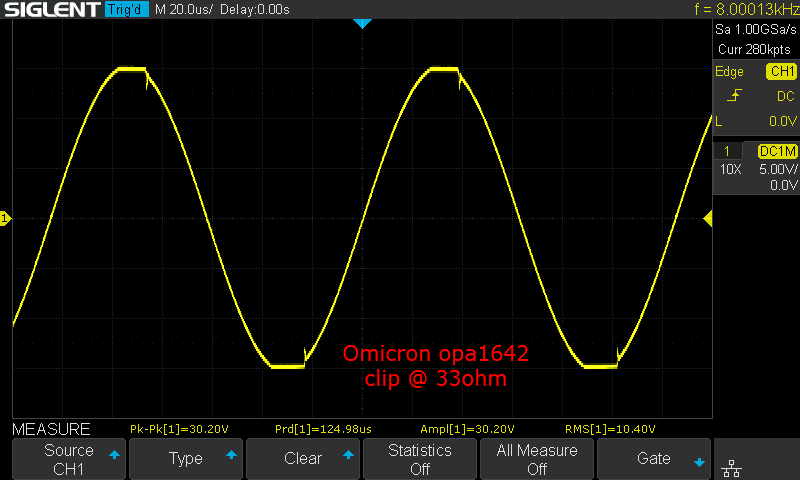

Clip is fine:

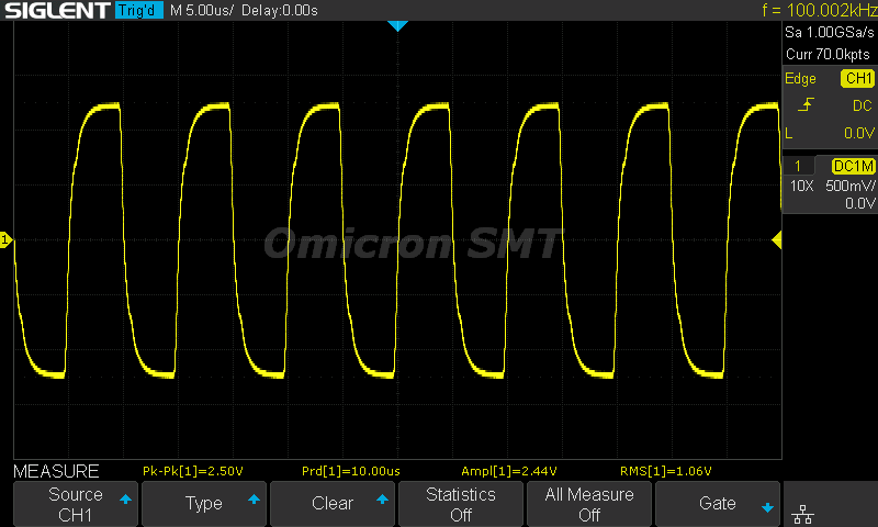

Response to a fast square wave has no surprises:

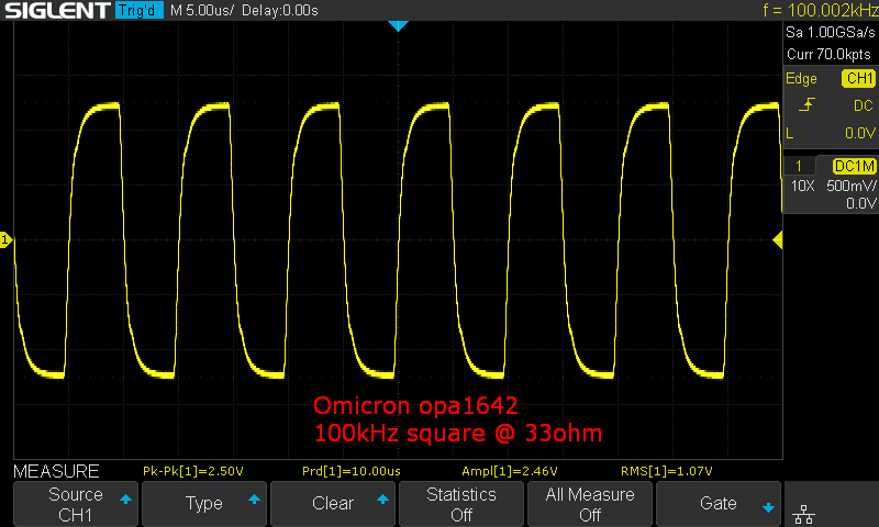

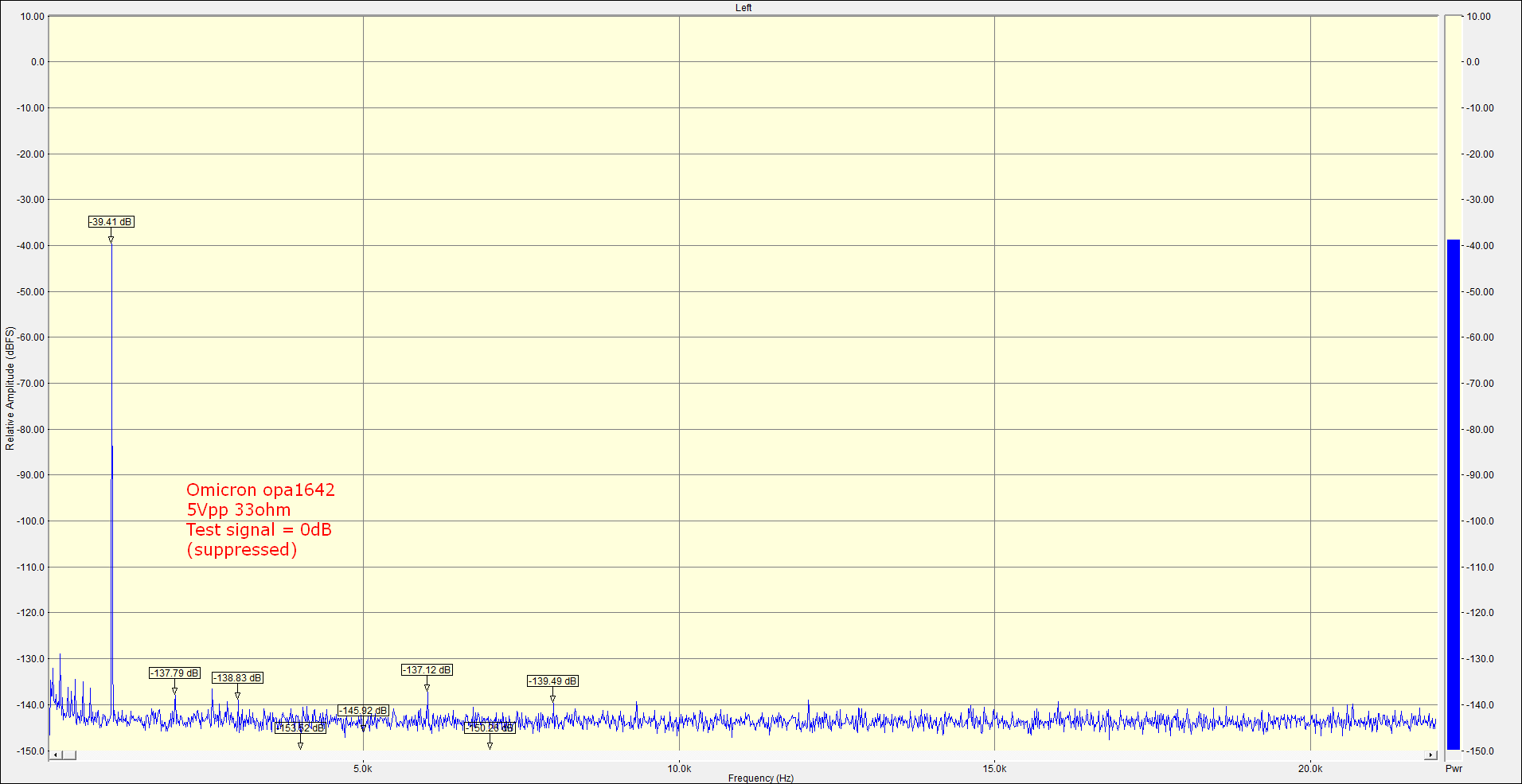

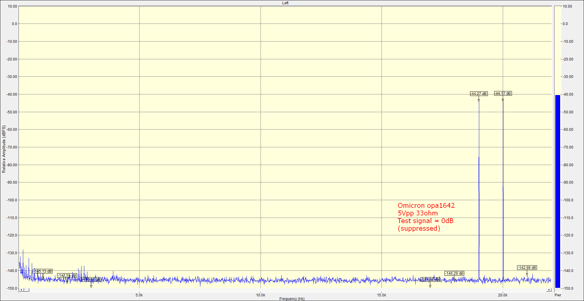

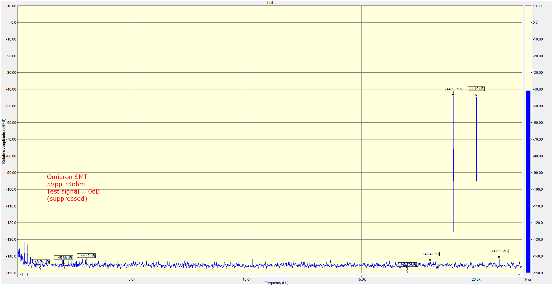

One of the reasons for the development of the SMT version of Omicron was the wider variety of dual opamps in SOIC (vs PDIP). Below are the measurements of Omcron running on OPA1642. Its performance is just as great as that of NE5532:
THD 1kHz @ 5Vpp 33ohm:
IMD 19+20kHz @ 5Vpp 33ohm:

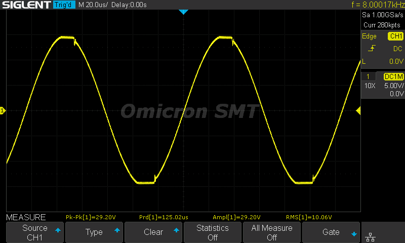

Clip @ 33ohm:
Fast square wave:
Clip @ 33ohm:
Fast square wave:

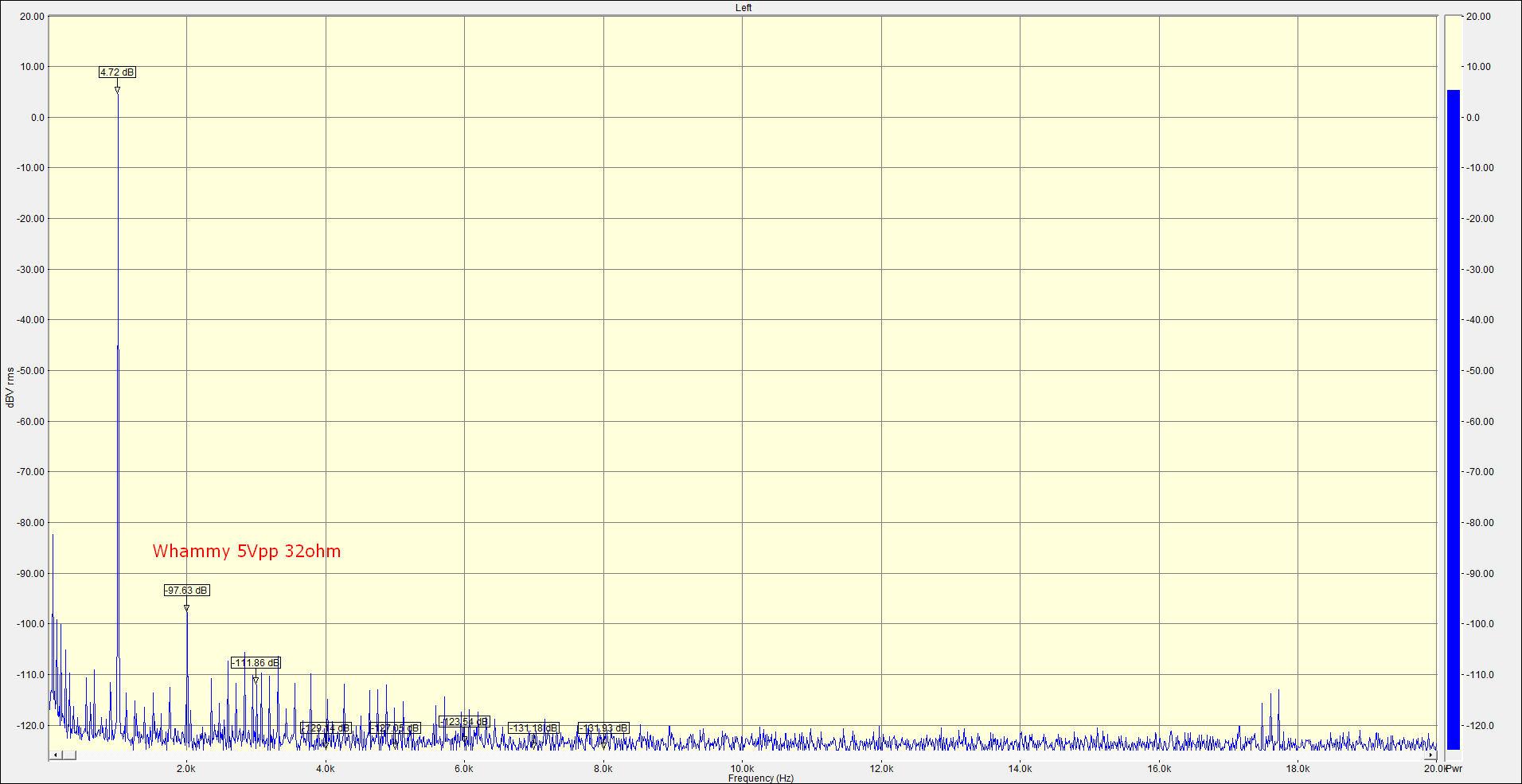

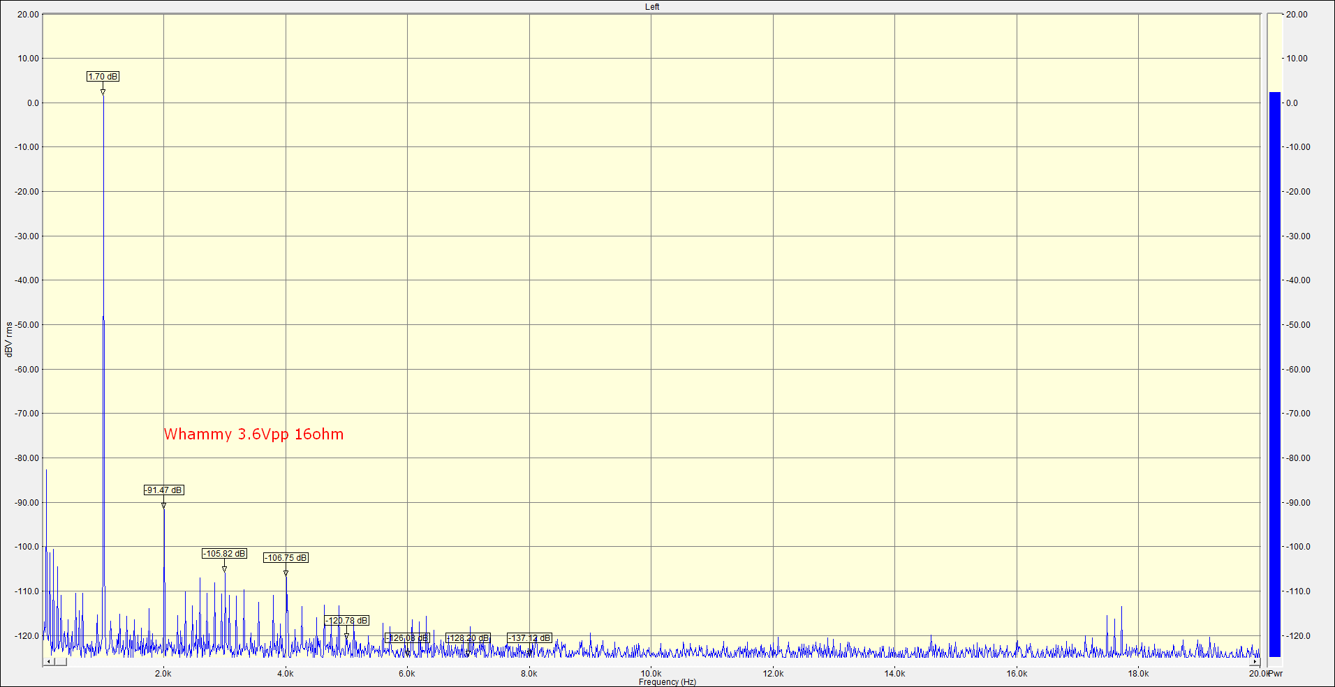

It should - compared to Omicron, my Whammy has two orders of magnitude (!) more harmonic distortion - of the "right" kind, of course - which does add some fairy dust🧚♀️ at the expense of clarity:Whammy tends a bit more to the warm side.
