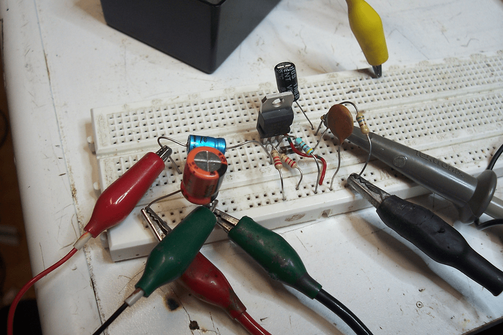

In the meantime, I have tested the 317 version in real life:
As was more or less expected, I had to add a stabilization network across the 470ohm output sink: 10ohm + 10nF.
I didn't try to optimize anything, as it worked immediately.
This is the result, with a 1kHz triangle signal:
Pretty neat. I may measure the THD later

The simulated THD is certainly overoptimistic; even the 0.0013% predicted by LTspice probably (slightly) is.
From my previous Vreg amplifiers experience, I can infer that the full power bandwidth will reach 20 to 40kHz; not exceedingly ample, but perfectly sufficient for the reproduction of audio programs having undergone transmission, encoding, decoding, pre+deemphasis, etc.
