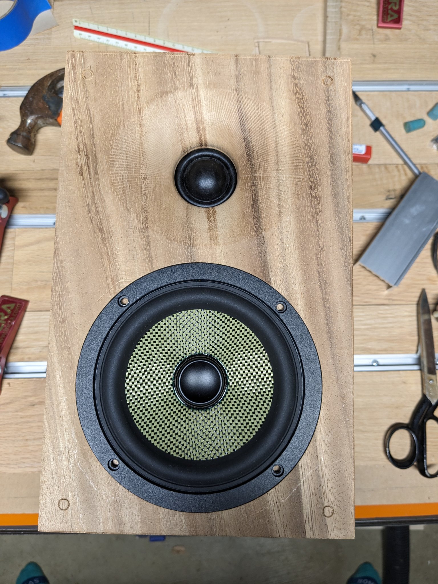

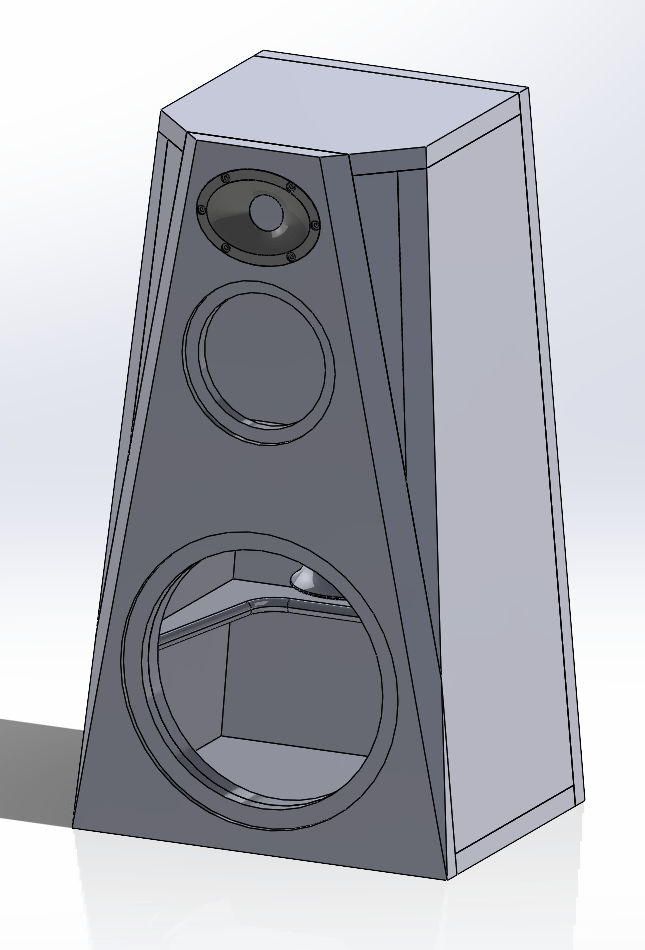

I am currently in the process of putting together a 3-way with the SB26ADC and an SB15NBAC30 for tweeter and mid. I was wondering if people had experience pairing the mids with one of the Augerpro waveguides.
I am thinking that the 4" may work (hopefully better than stock) and fits on my current front baffle. I could also move to the 5" if need be if it would lead to a performance benefit. Also, would the PS be necessary in something like this? Any suggestions?
Reactions: 1 users
I plan on crossing between 2-2.5k, ideally around 2.2k. Don't know the exact slope yet but it will be 2nd order if I can manage that, maybe 3rd if need be, all passive.
I will most likely be resin printing these myself and finishing/painting (which is good because of hard dome and phase shielding). I might be able to CNC them if need be though but would remove the phase shielding.
The corner chamfer would go from around 58 mm to 50 mm. I used a similar process as hifijim used in his speaker builds in Vituix to simulate the baffle diffraction. He mentions that in Vituix you can model each driver individually and use a full width radius (differnt for each individual driver) and it yields similar results to what his actual testing produced. I had tried to get a license for ABEC through my university at the time but I figured it may have been overkill and not worth the hassle for what I needed.

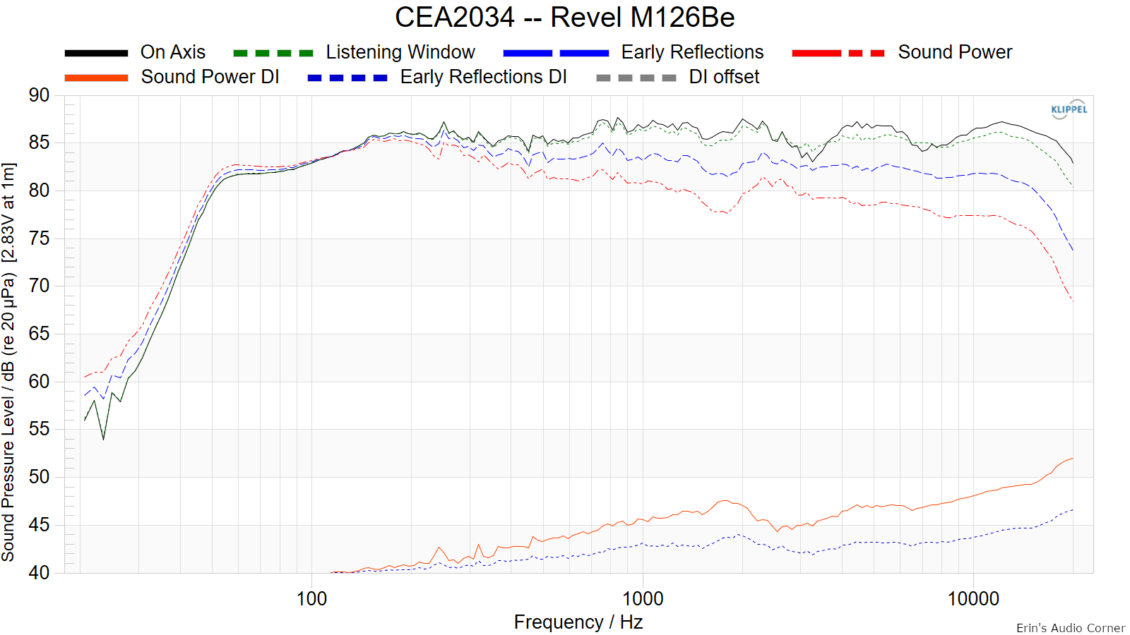

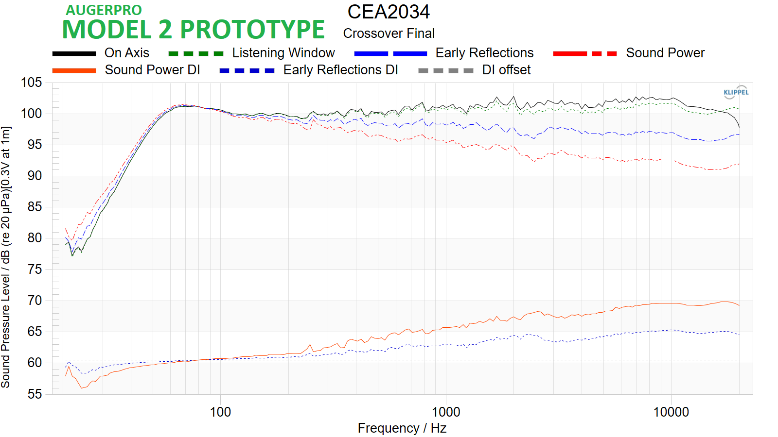

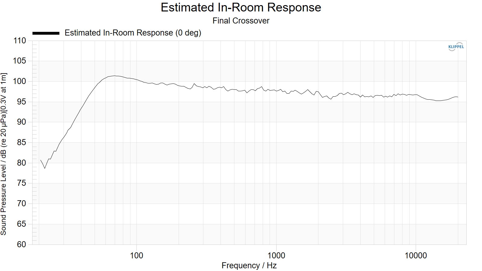

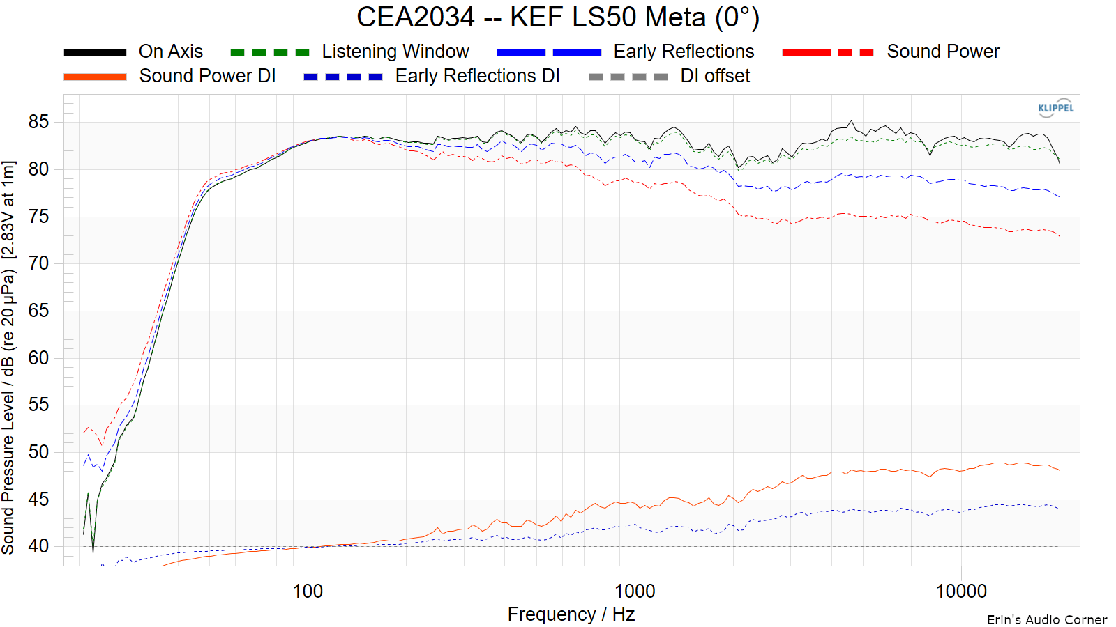

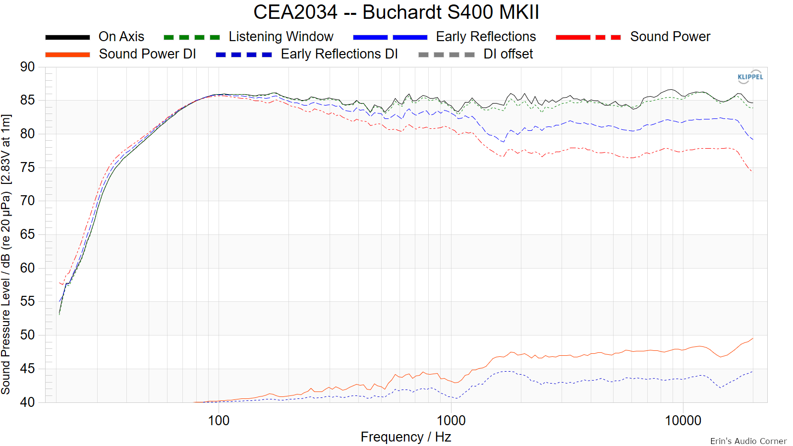

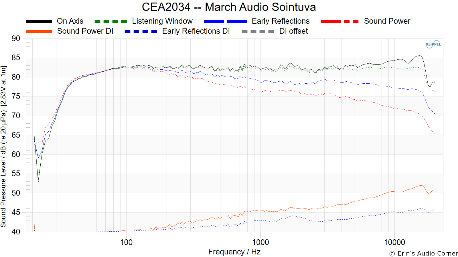

Quick update on my SBAcoustics "ceramic" standmount design. Following is the Klippel measurement for the active version. I think a 250hz boost filter may have been off, but oh well, you get the idea regarding power response. Added some other target designs for comparison. Before I post the design I'm going to try another box shape to see if I can get the same response, but with a less complex passive crossover.

How did this compare to your own measurements btw? :)
I'll try to find my QC from last fall. But yes, I was very satisfied (relieved?) when I compared them. Basically it ended up:
<150hz = same sensitivity but rolloff was a bit different. Makes sense given mine was a combined port+near woofer response. I've never really put a lot stock in this measurement anyway since accurate T/S will generate better box response in software.
150hz - 1000hz = This is where the biggest difference was. But in a way that my measurement is still accurate, but smoothed. Where the Klippel has some little ripple with its high resolution, my response was like a slightly wavy line that touched the tops of the ripples on the Klippel response.
1000hz - 6000hz = dead on to the Klippel
above 6000hz = slight deviation that became more noticeable >10khz. Maybe 1.5dB different around 12khz or so IIRC. So basically the top octave and bottom octave diverged, but with the middle in good agreement.
Reactions: 1 users
I think that is a bit open for debate, since Klippel is using a "averaging" method (to overly simplify their method in one word), this always leads to some bumps and things.
Unfortunately they are not very transparent about this.
Especially below 500Hz, or rather below the lowest point of the impedance, a speaker just follows 100% piston behavior. Even more so when the cabinet is small enough (no internal resonances).
The question that should be asked here, is where is this little ripple coming from?
At low SPL's that also can't be panel resonances.
This I find the danger of such Klippel like system.
You get a nice overall picture, but without zooming into certain things, it's just a total guess where certain things come from.
A simple near-field measurements with a BD plot, distortion etc will often tell you these things much better.
Above 6kHz is probably just difference in microphone calibration and/or position.
Move your mic just a couple of degrees or so, and you can already find differences.
Would you mind sharing your own measurements as well, as a one-to-one comparison?
I think it would be absolutely fascinating to compare the two! :)
