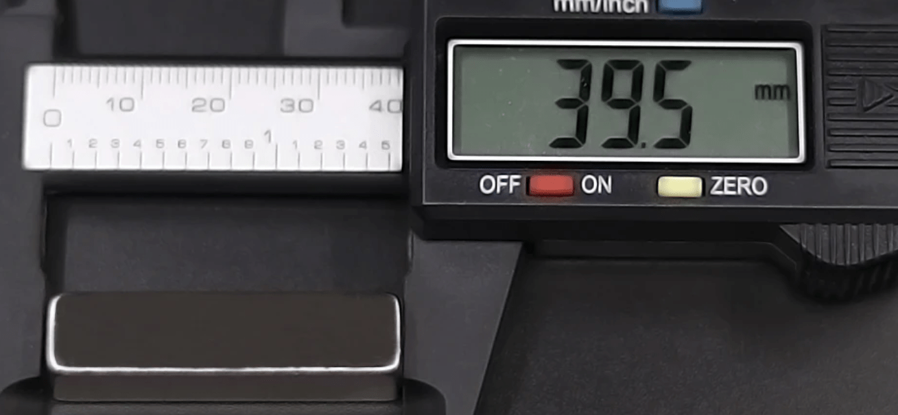

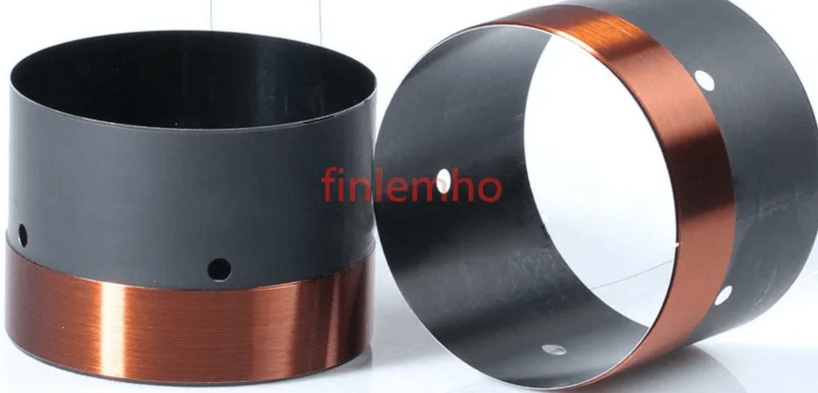

Proposed VC
Guys, first time attempting something like this. Any recommendations to VC gaps and cylindrical mag sizes? A comfortable 100wrms ability and 12" nominal cone diameter. Max work area is 400mm x 400mm x 400mm on a Creality CR-6 Max and 300mm x 180mm x 40mm laser and CNC. So basket parts can be made from a combination and alloy parts in heat sensitive areas are possible. Aim is to create a very large vent area that can house part of the HF structure

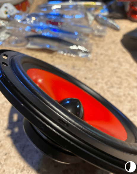

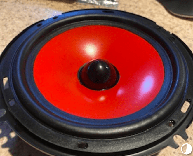

Dave, it's not on the retail market. The motor structure is from the 3" Tang Band FR with the phase plug but in a smaller basket with a smaller cone. I think, a volume item only for Systems developers. I want to move up from these. If something like the Mark Audio 6" FR drivers can be way louder then I can try to fit one into a larger DIY woofer
re the DIY driver, is there any reason for the VC to be inside the mag? Can there be an array of flat bar mags round a cylinder and the VC ride over that?
