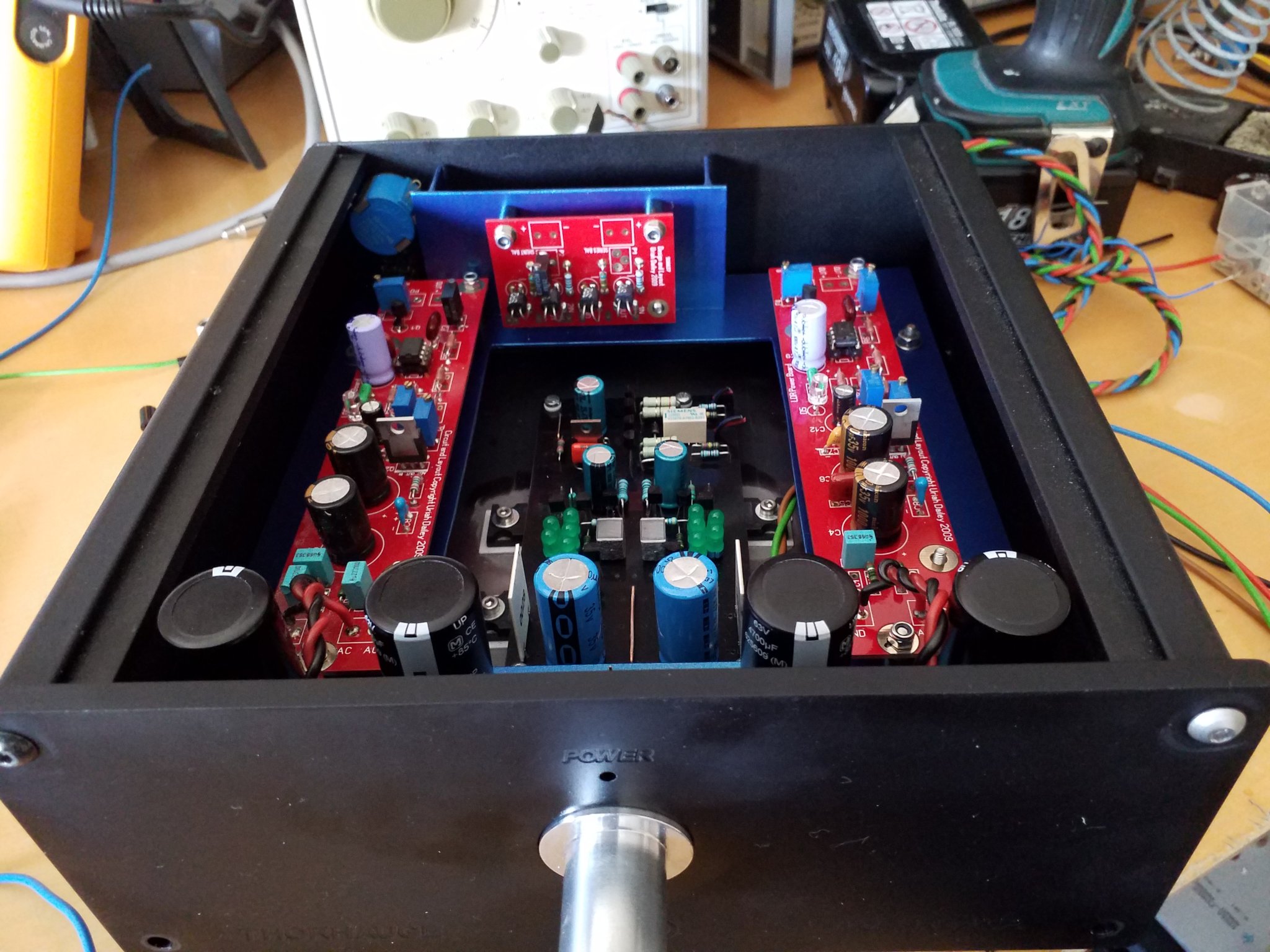

My self designed and self built RIAA amp.
  • MM & MC
  • Adjustable load capacitance for MM and load resistance for MC
  • Adjustable gain, 4 steps
  • DC servo to eliminate unnecessary coupling capacitors
  • Active/passive RIAA network with 0.1 % thin film resistors, 2 % PPS caps
  • RIAA accuracy better than +/-0.1 dB
  • Mute circuit to eliminate pops at power-up and off
  • Low noise and ultra low distortion
  • 4-layer PCB with good GND plane for low noise
I recently did a couple of these and had the enclosure CNC machined:

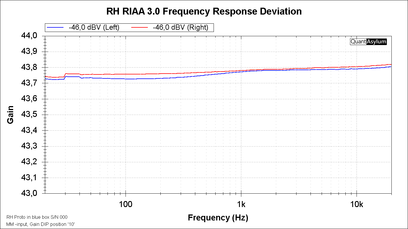

Example frequency response deviation (jumps at low frequecies caused by QA software settings). Note the Y-axle span.

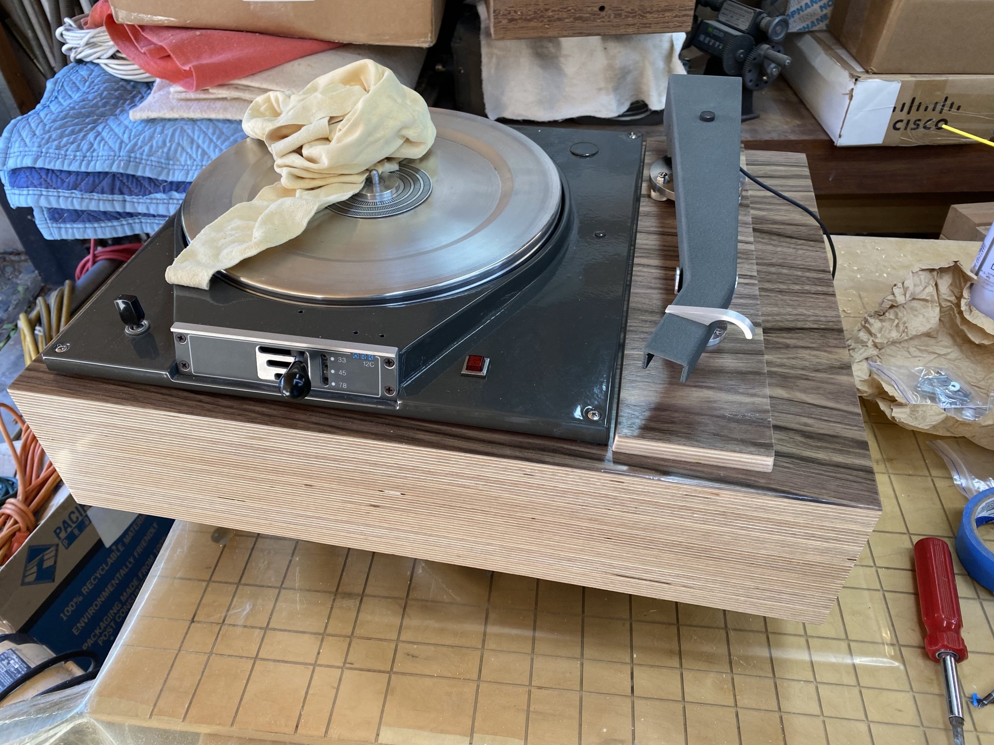

My Super Nova, a re-imagined SOTA Star Sapphire vacuum platter deck. A very high mass rigid plinth with the motor and power supply in a separate high mass unit. Upgraded vacuum pump in its own high mass module that can be placed across the room. Arms are Triangle Art Osiris and SME Type IV.
Veneered with zebrawood.

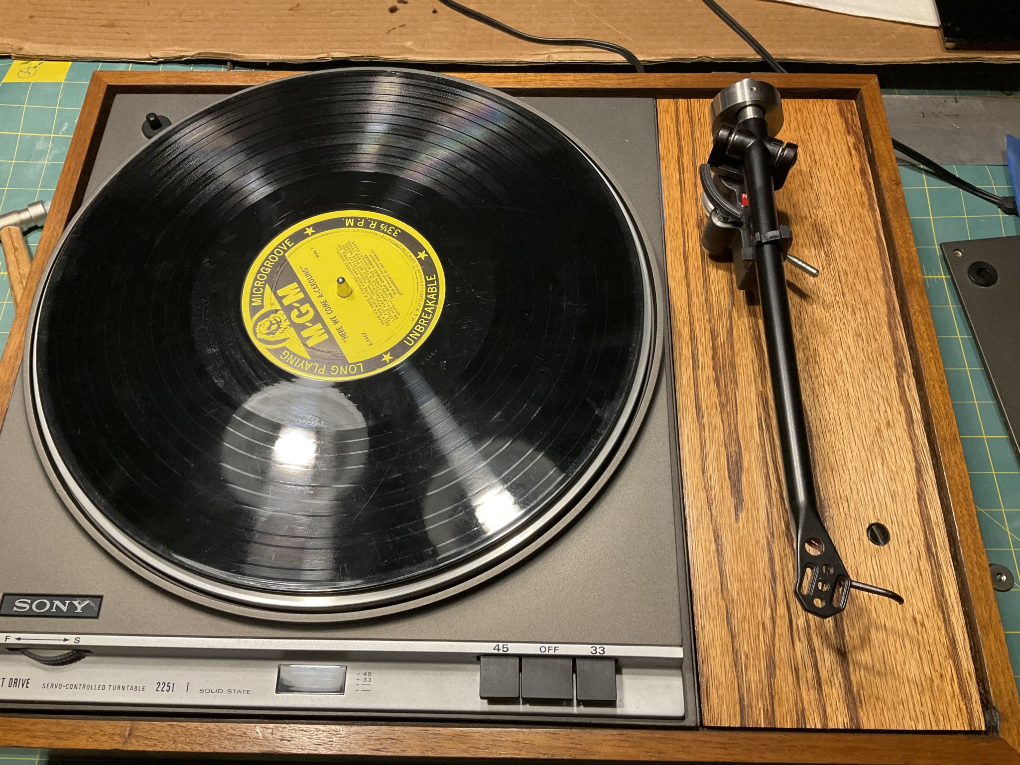

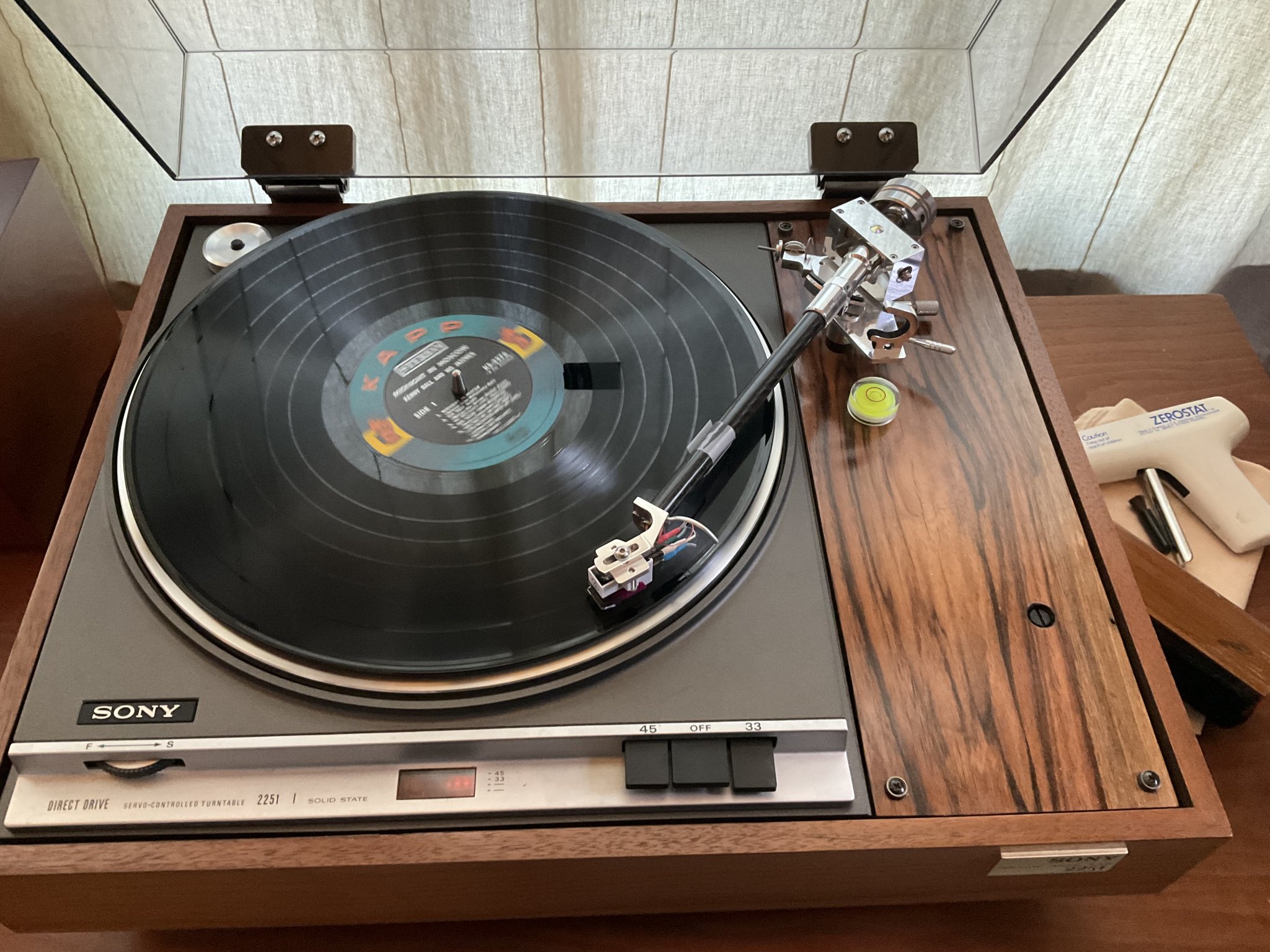

Denon DP-3000 in a solid Baltic birch plinth with Brazilian rosewood veneers and a Fidelity Research FR-54 arm. The dust cover from the old SOTA star was a perfect fit so it's repurposed here.

As with all of my stuff, high mass. Mass is great for damping and stability.
