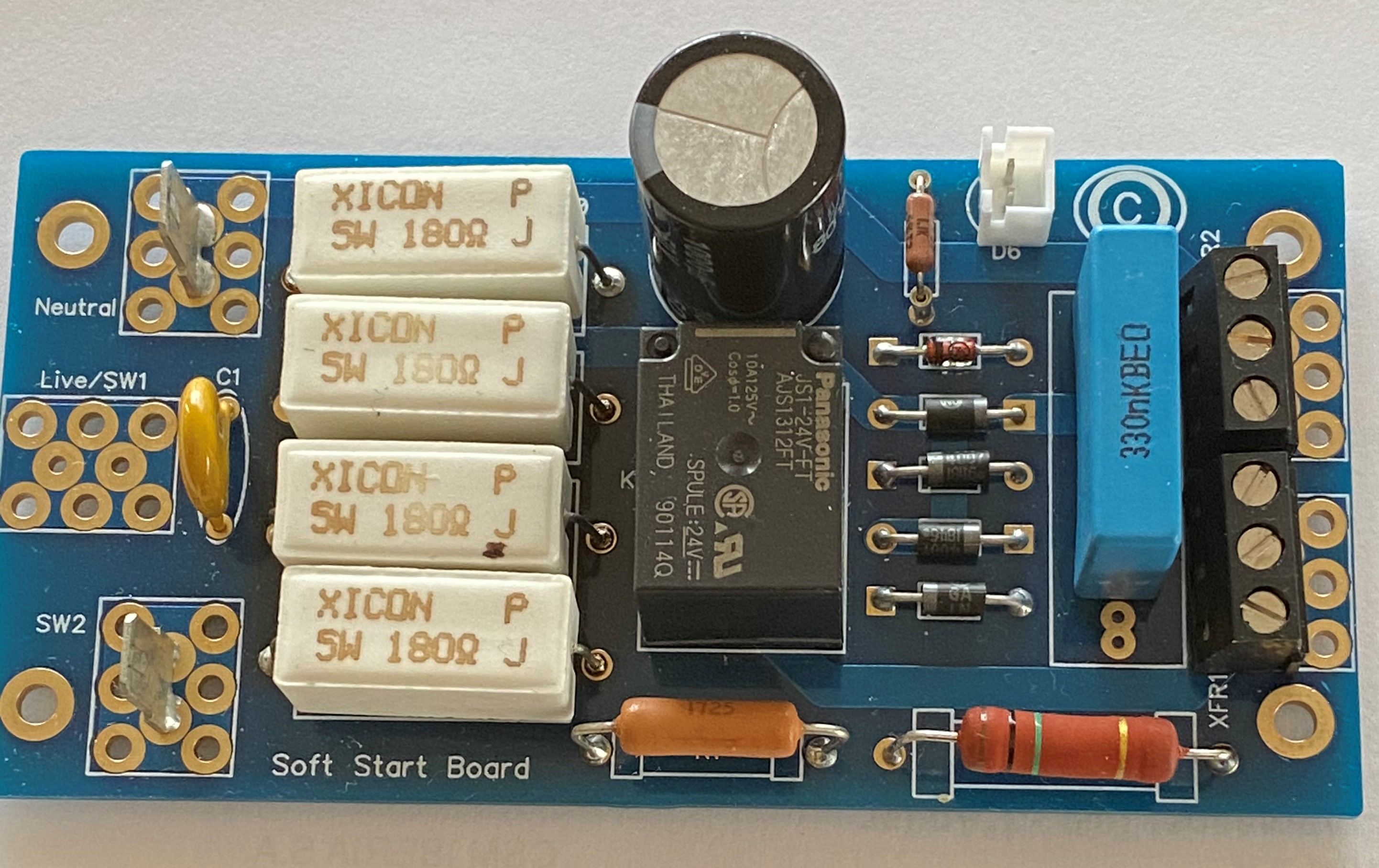

Hi guys,
Need some advice here.
I’m using a softstart board (v3) to power up an F5 amp (PSU: 400VA Toroidal transformer / 240V mains).
Even though the softstart board seems to be working well – the LED lights up and the F5 gets powered up, the R3-R6 (180R / 5W) are getting hot, so hot that even solder starts to melt.
I’ve made two changes to the original softstart BOM:
Relay: Panasonic JS1-24V-FT instead of Omron G5LA-14-CF-DC24, and
C2: 0.33uF / 275V instead of 1uF / 275V.
Any idea what’s causing the R3-R6 to get so hot?
Shall I increase the resistors’ wattage to 10W or even more?
Thanks.

AX tech editor
Joined 2002
If the resistors stay hot, that would indicate that the relay is not shorting them out.
If the solder starts to melt, that's not 'seem to be working well'.
You made C2 only 1/3rd of design value. That significantly lowers the supply for the relay coil. That may be the reason it doesn't switch.
Jan
I reckon the 'seem to be working well' was not the best way to put it :).
I've changed the value based on another post that with the default value (1uF) and on 240V mains the relay would never turn on.
Voltage is 13V and (unsurprisingly) no click given it’s a 24V relay.
In the meantime I’ve realized the LED is drawing too much power; by removing the LED the voltage across the relay coil jumps to 23V.
So to fix the problem I’ll choose a LED with a lower current draw and increase the value of C2 to be on the safe side.
Thanks for the help.

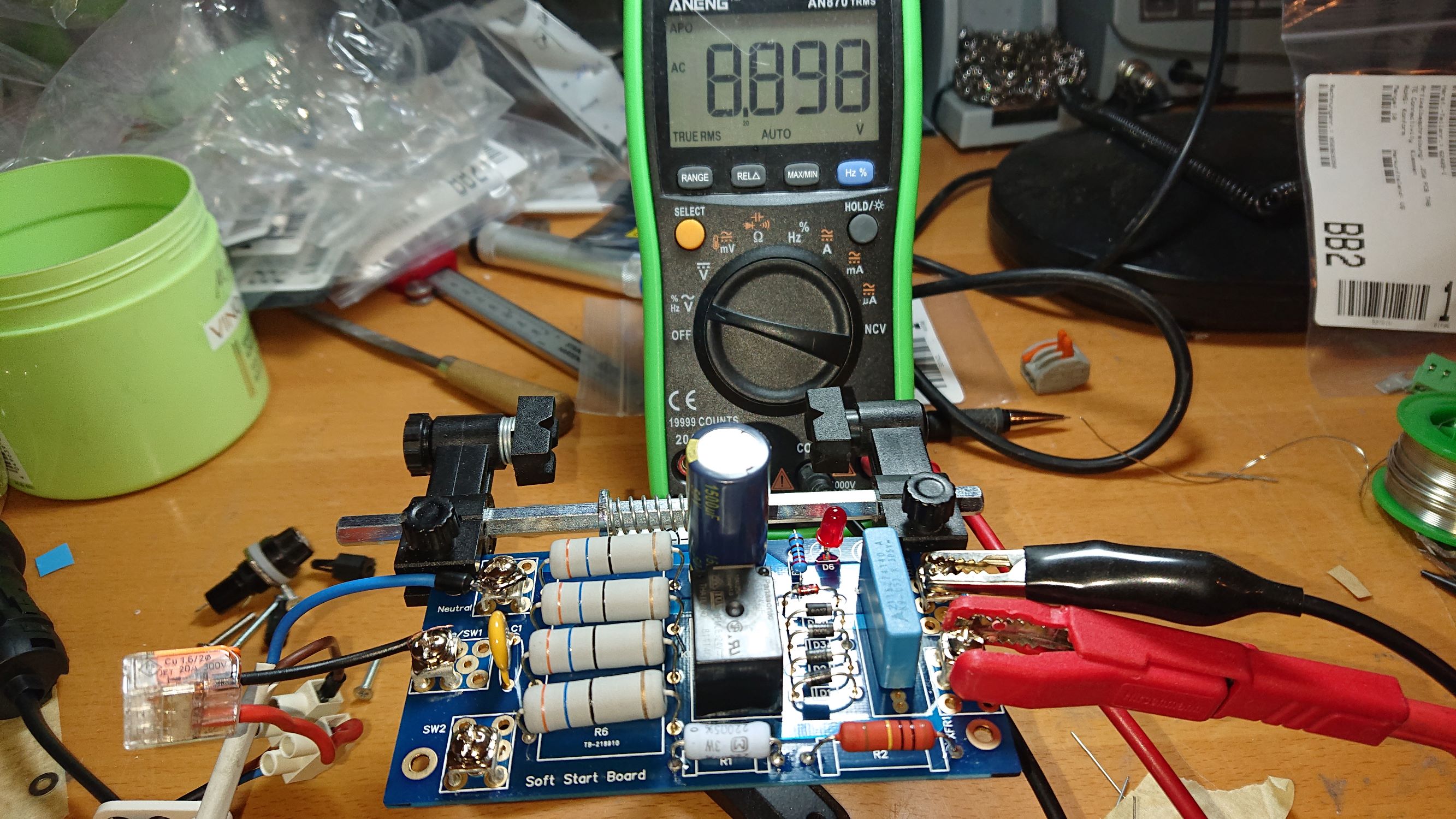

Hello everybody,
I have built the Soft Start Board for 230V.
Tested with 25V light bulb, did not light up.
C2 0.330µF
C3 1500 µF
R3-6 36 ohm for 200VA transformer
Relay does not pick up, LED does not light up.
Issue 8.89V Ac.
Relay coil 5V av 0V dc
Led 0V dc
