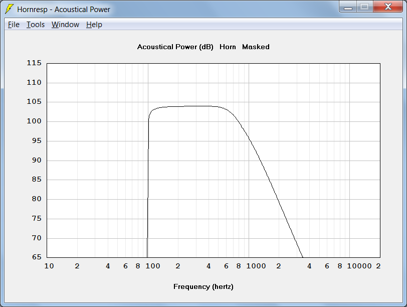

The attached screenprint shows the normalised throat acoustical impedance of an infinite 100Hz exponential horn. Because there is no impedance mismatch, there are no reflections back down the horn to cause ripples in the throat impedance.

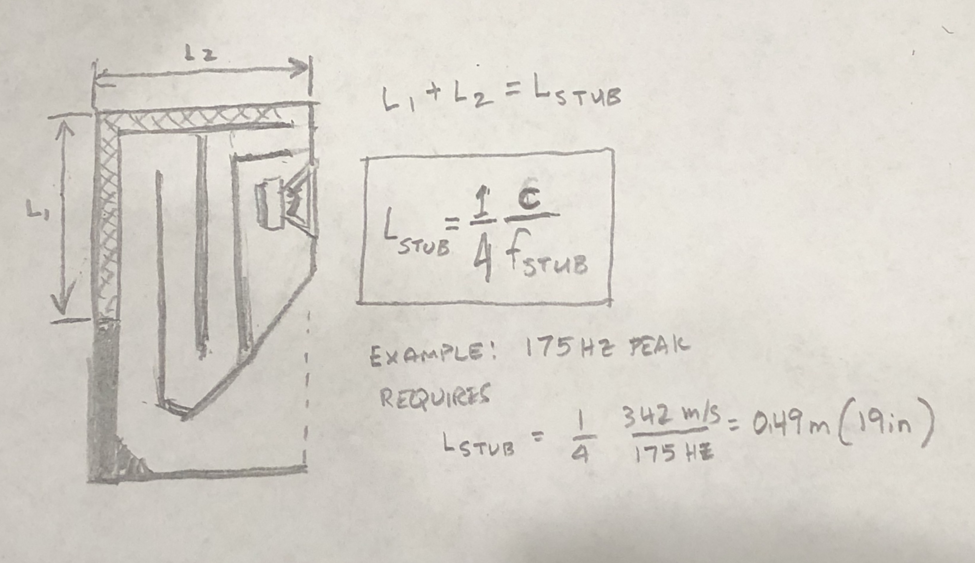

If you have a resonance peak, adding a tuned 1/4-wave stub packed with fiberglass can help suppress that particular frequency. Usually I put the stub near where the horn driver is located for best effectiveness. Usually same width as main channel and then about 1in wide and as deep as needed to equal length of 1/4-wave you are trying to suppress.

For example, take this fictitious BLH and let’s assume you have a pesky 175Hz peak, adding a 19in long stub helps to absorb this peak by 3 to maybe 6dB depending on location and stuffing used.
attachment.php
Putting stub entrance near excitation throat helps.

Ah, now I see and understand exactly what you mean! I am very much in favour of what I call 'mechanical eq' through construction - even though I use a (very nice) guitar eq pedal with my present mono horn playback.
Thank you for making a proper drawing for me, it is the kind of thing that sticks and stays for me. I'm going to keep this very much in mind for my next build. :)
