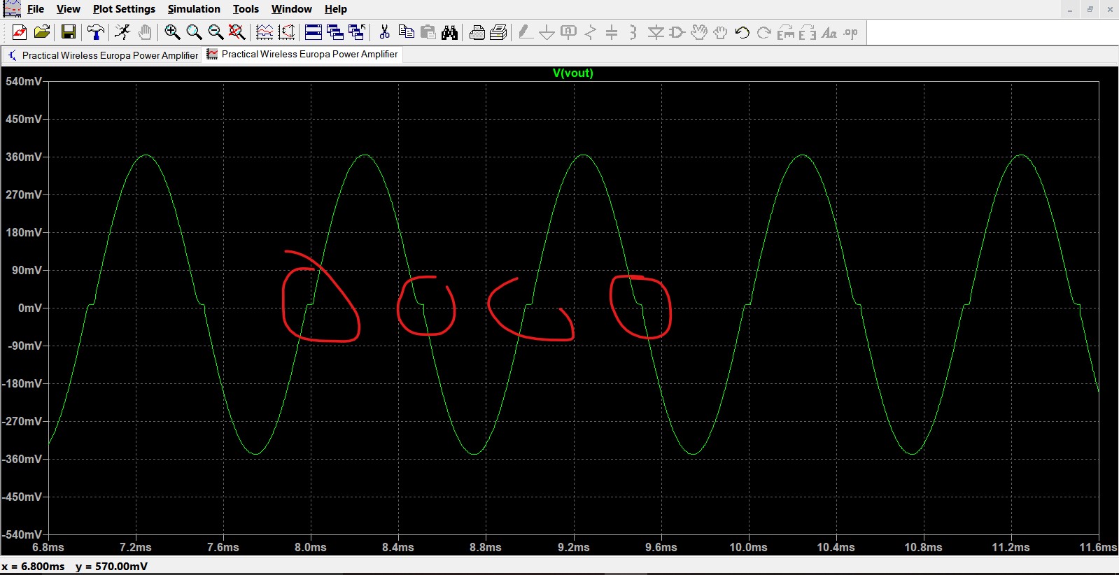

If it is bias current you are adjusting then set it on a low amplitude sine signal (with load attached to amp) and adjust until the crossover distortion just disappears.
Use something like 1 to 5kHz and an amplitude of just a couple of volts peak to peak.
Crossover distortion looks like this.

I see a step down on the top and a heel bump on the bottom that seems to flatten out about mid travel on the bias pot.

Ok I think I'm going way past the rounded wave to a square looking one.
OK I used 2vac on the speaker, sine wave at 2khz.
there I could see the sine wave with a bump more like this edited image
I turned the bias up to just before mid way and that lump just went away.

Ok I did 5khz. Bigtime stressing out.
Both trimmers are set to about 11-11:30.
Both lumps "just smoothed out" to make a smooth slope.
I hope its good enough. I'm pretty stressed about this.

It sounds like you've got the hang of it. Low amplitude and high (ish) frequency tends to show the distortion the most.
Adjusting to the point where the distortion just disappears means that you are playing safe by leaving the bias current low. That's much better than setting it to high which would cause the amp to run hotter and also make the whole amp more prone to 'thermal runaway' where bias increases on its own with temperature... and so on... resulting in a major failure.
So enough to eliminate the distortion but no more.
With no signal there should be no significant DC voltage across the speaker. Less than 100 millivolts is fine.
