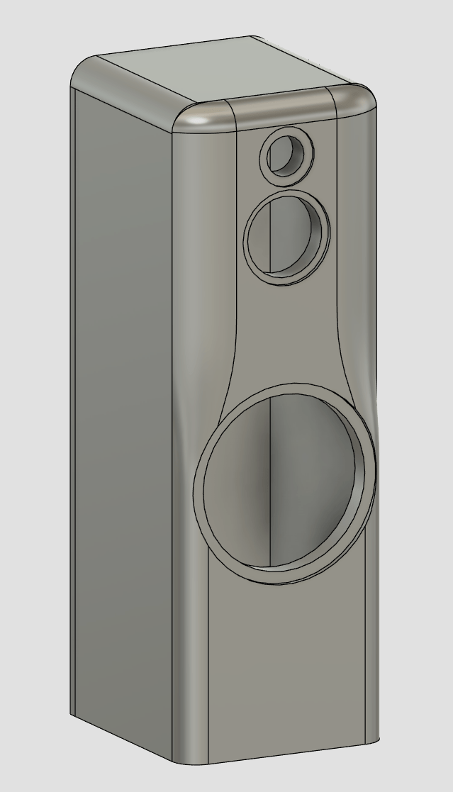

Hi again,
Been busy so a bit slow going for the moment. Current design attached. Ignore the fillets on the top not being perfect, still working out how to draw them properly in fusion360.
Going to have a compartment right at bottom to mount the FA253 Horizontally, then route some slots for ventilation above it.
Then there will be the compartment for the 12", and the top for the Tweeter & Mid.
Thoughts on the design?
Thanks again!

From drawing it's not apparent how bracing looks like. For panel resonances you might consider adding bracing after boxes are done. Tapping with a palm reveals which surfaces are problematic. Standing waves can be reduced using non-paralell surfaces or filling. Filling is the most effective at velocity maximum(e.g middle of longitudinal direction).
Regards
The shape of the baffle in post #83 is about as good as it gets from the standpoint of diffraction control, for a large wide cabinet. If you can post some dimensions, I can work up a baffle simulation for the drivers. I would need the overall width and height of the cabinet, the edge radius along the top the baffle, and the width of the flat baffle region at tweeter level. It appears the flat baffle region is about 20 mm wider than the midrange, perhaps?
A baffle diffraction simulation would help as a sanity check to make sure we don't have multiple diffraction effects adding together in a bad way. It is unlikely this would happen, but it is good to check.
Bracing and structural damping will need to be carefully thought out for this design. You have a single large cabinet that will be energized by both a woofer and a midrange, over a frequency band that extends from 20 Hz to ~ 2 kHz. What cabinet material / thickness are you planning to use?

I'll take some dimensions off the drawing later on today and post them up, at work at the moment so I'll tackle it when i can.
The front baffle will be 3 x 16mm think MDF laminated to get the thickness for the roundover.
The rest of the cabinet will be 18mm MDF.

Some measurements for you...
Overall cabinet size is 386mm wide x 1130mm high x 413mm deep
Edge of tweeter to start of side roundover is 43mm, 3mm down from top roundover
Edge of Mid to start of side roundover is 12mm
Width of flat face of baffle between starting edges of roundover is 190mm
Top roundover radius is 45mm
Side roundover radius beside tweeter and mid is 130mm wide (not a uniform radius)
Centre of tweeter to centre of mid is 140mm.
If you need anything more just let me know.
Thankyou :)

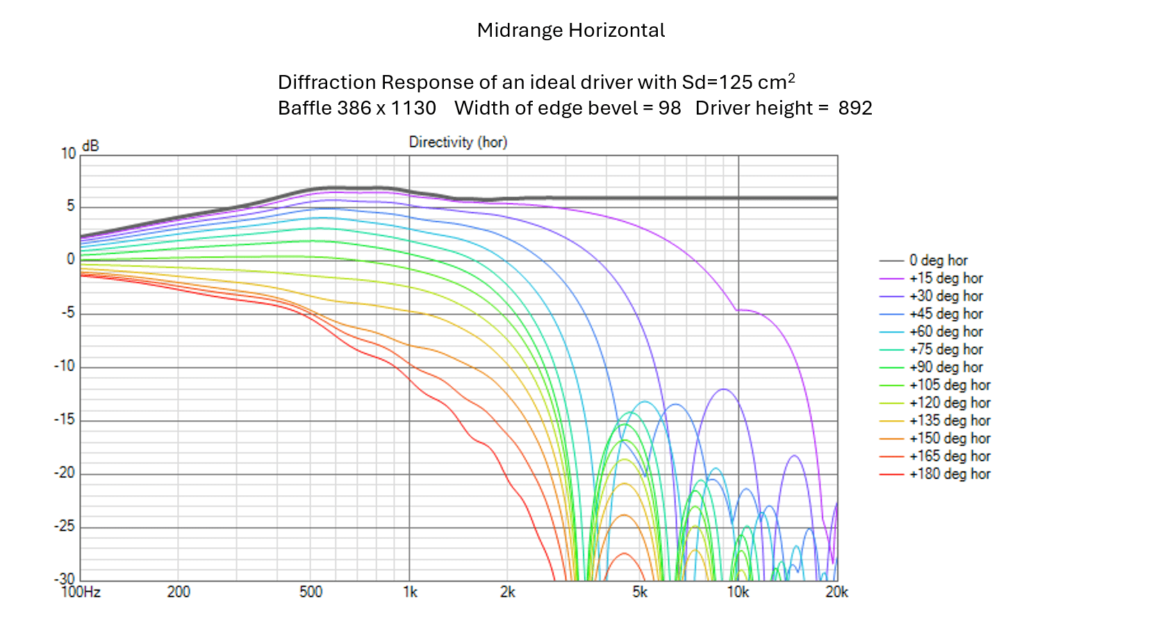

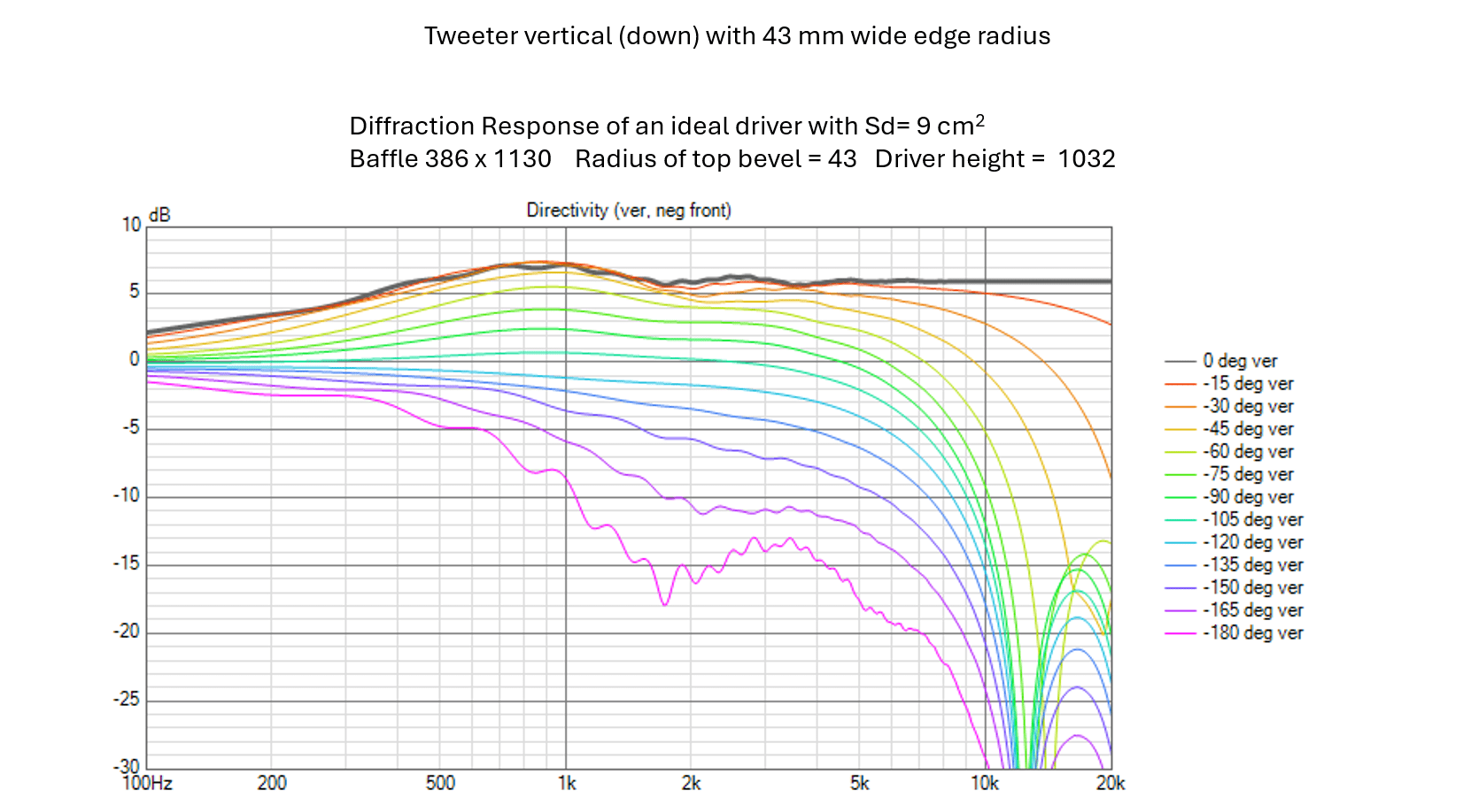

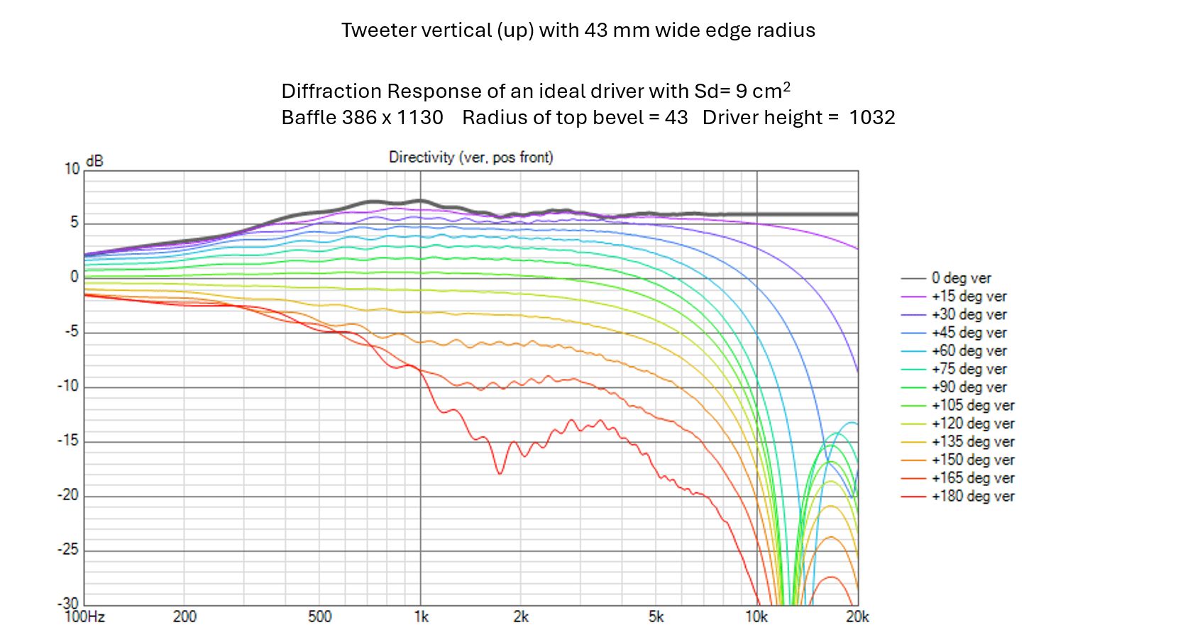

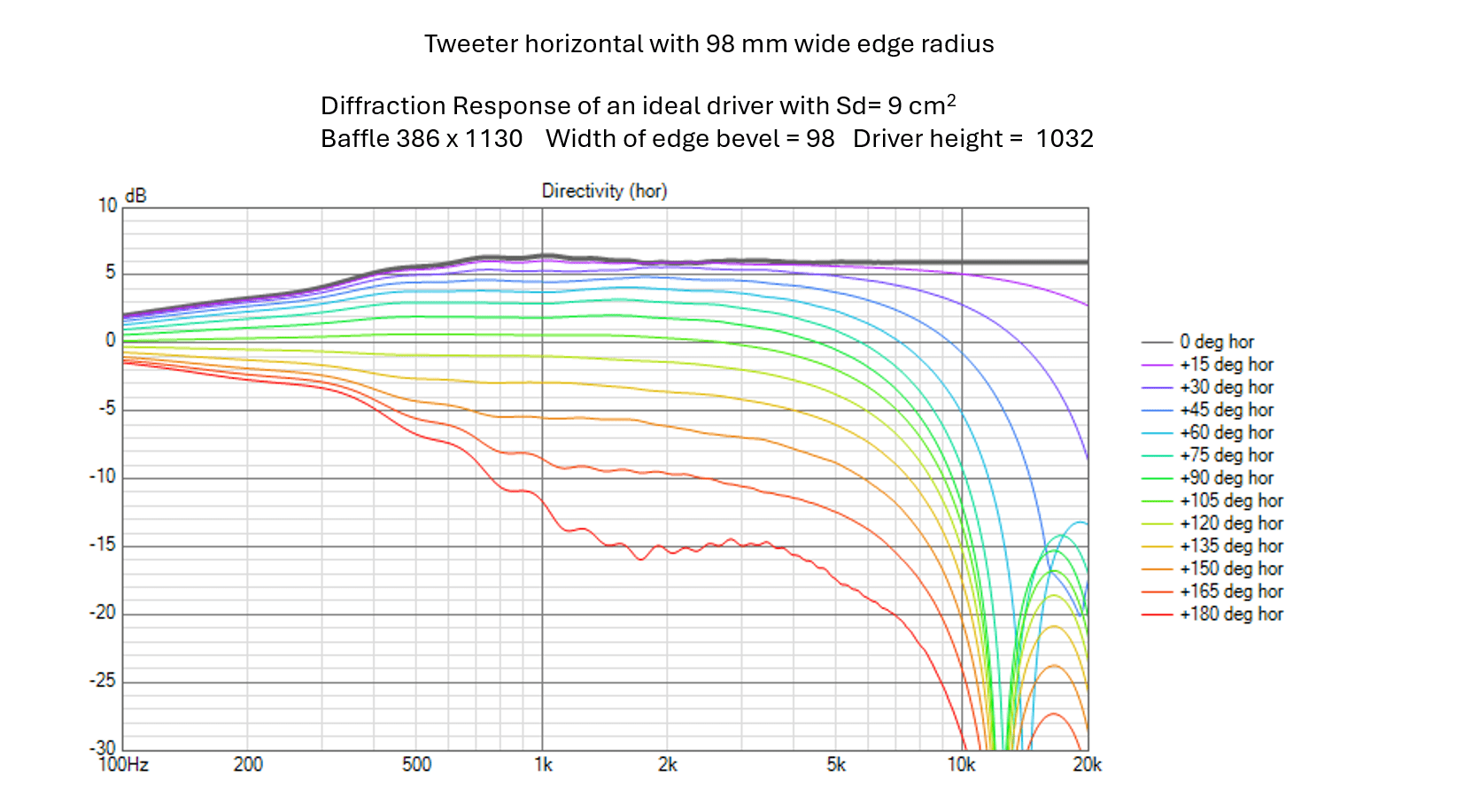

Here is the baffle diffraction simulation based on the information you provided. I used VituixCad.
You have a different size edge treatment on the top than on the sides. VituixCad simulates all four edges the same, so we have to choose which size radius to use for each driver simulation.
For the midrange, the width of the radius/bevel region is 98 mm wide [ (386-190)/2 = 98 ].
For the tweeter, the width of the radius/bevel region is 98 mm wide in the horizontal plane, and 43 mm in the vertical plane. I ran the simulation both ways.
I do not see any diffraction related complications at this point. The diffraction hump on the midrange is small. The tweeter high frequency diffraction is very mild.
At a crossover frequency of 2k, there will be a mismatch in directivity between the tweeter and the midrange. In these idealized simulations it looks like about 3 dB difference in directivity. When I look back to my actual measurements of a TW29TX and MW16TX, the difference in directivity was about 2 dB... the TW29TX has higher directivity than predicted by an idealized piston it seems. I expect you will have about the same. So this will be something that you will have to manage with driver spacing and the crossover, but 2 dB difference in directivity index is a very manageable challenge, not a show stopper. In my case, I used as low a crossover as the tweeter could tolerate (1.6k 4th order) to get the directivity matching as close as possible.
So all in all, I don't see any issues at all. That is not to say that the shape is fully optimized. There are probably some improvements that could be made, but your first attempt at a baffle design has a high potential.

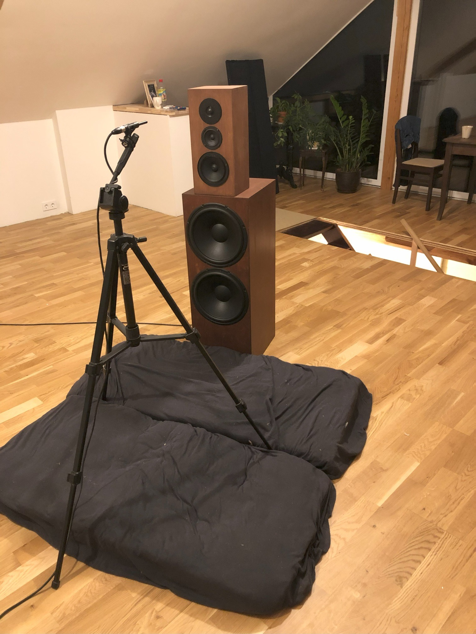

While doing measurements in typical room, at least put something on the floor and move speaker as far as you can from any hard surfaces. Normally measurements are done with time window to exclude reflections as much as possible. If you can afford 80 euros, ARTA is highly recommended.
