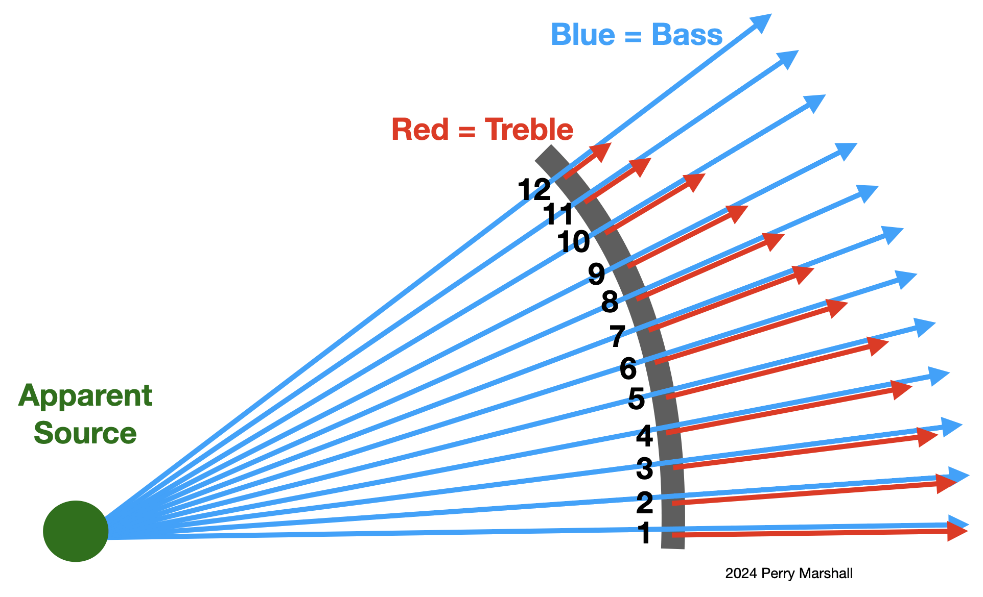

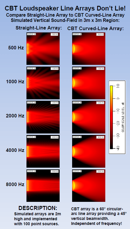

A shaded array is a curved line array where each driver receives a unique signal level according to a Bessel function. This eliminates most of the lobing and comb filter effects of a line array. (Conventional line arrays are notorious for comb filtering effects. You have to use lots of tiny drivers in order to eliminate them.)
In auditoriums, shaded arrays ensure all seats get equal SPLs no matter how far from the speaker. In a home system, a shaded array with the hottest drivers near the floor results in equal SPLs whether you’re right next to the speaker or all the way across the room.
When I invite people over to listen, I ask them to get up and walk around. They’re astonished that the sound level and image doesn’t change no matter where they are in the room. When I host listening parties with a dozen people, every seat in the house is great.
You can stand right next to one speaker and hear the other speaker clearly across the room with a nice stereo image.
The graph below is from Don Keel’s website, it shows even distribution across all frequencies for a shaded array with the hottest drivers in the center. In my design, the floor is the centerline through the middle, with floor reflections simulating the lower half of the array.
Imagine a black dotted line running right across the middle of each heat map above. That dotted line is the floor of the room.
Put your couch on top of that floor and now you can visualize how the sound is distributed throughout the room from the Shaded CBT Array.
This means the hottest drivers are the ones at the bottom, with the signal tapering off as you move up to the top of the array.

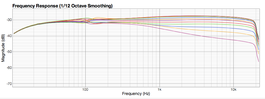

This is the actual measured signal at the terminals of each driver:
As you can see, at the tuning frequency of 43Hz, each driver shares exactly the same signal level, but around 100Hz the signals start to diverge, and at 10KHz driver #1 at the bottom gets 14dB more signal than driver #12 at the top.
The irregularities around 100Hz are due to varying resonant frequencies and impedance curves of each individual driver. This is a trivial issue in application. The Fountek driver has the following specs: FS 125Hz (in my measurements it was more like 110Hz), Qt 0.52, VAS 0.85 liter.

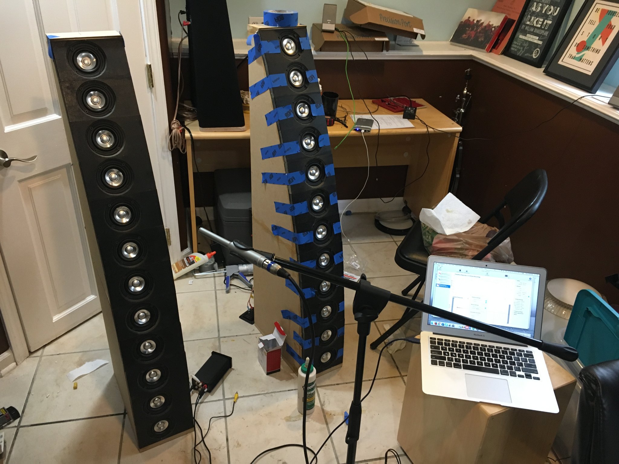

Measurements

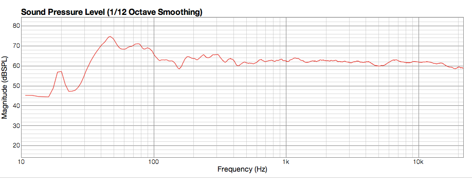

This is the system response in my room, average of 18 positions, mostly near the listening spot, with the EQ that sounds right after much tweaking:
As you can see they deliver 35Hz-25KHZ. Of course at listener position in a real room, you want about 10dB more bass and that's exactly the case here.

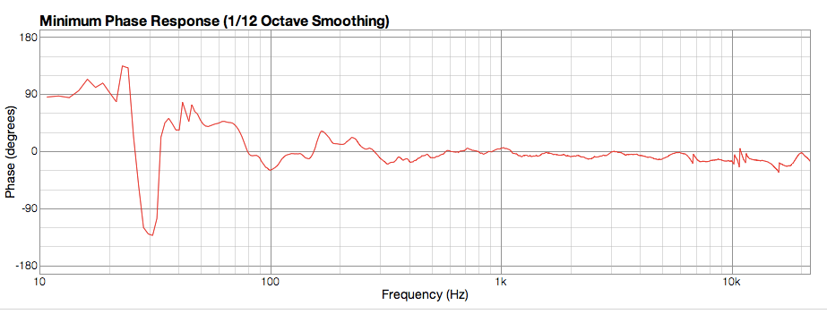

Phase response is essentially flat above 80Hz:

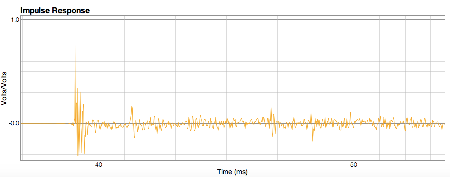

Most speakers butcher Impulse Response. Not these:

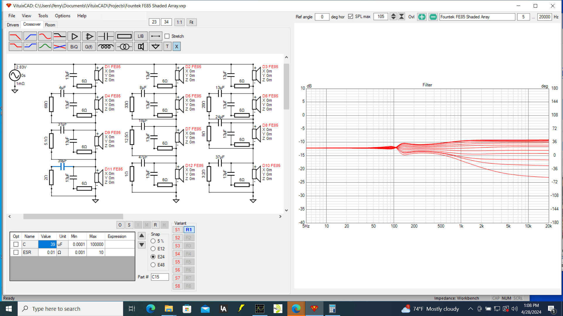

Schematic:
This design requires an elaborate filtering network to provide each individual driver with the exactly correct drive signal according to Keel's Shaded Array methodology. Each driver has a Zobel network (6ohms + 13uF) which flattens the impedance and makes behavior more managable.
The wiring consists of three parallel sections of four drivers wired in series. Each driver starting with driver #4 and above also has an RC network which directs extra high frequency energy towards the bottom drivers and less HF energy to the top drivers.
As you can see, drivers 1, 2 and 3 get 3dB extra signal above 1KHz, and drivers 10, 11 and 12 get 10-15dB less signal above 1KHz, with the intermediate drivers getting exactly proportional signals. I am very proud of the above family of curves.

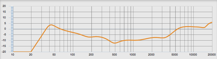

I used a MiniDSP 2x4HD to EQ these speakers flat. Above is the correction curve, which is absolutely necessary because without EQ the 3.5” drivers start rolling off below 150Hz.

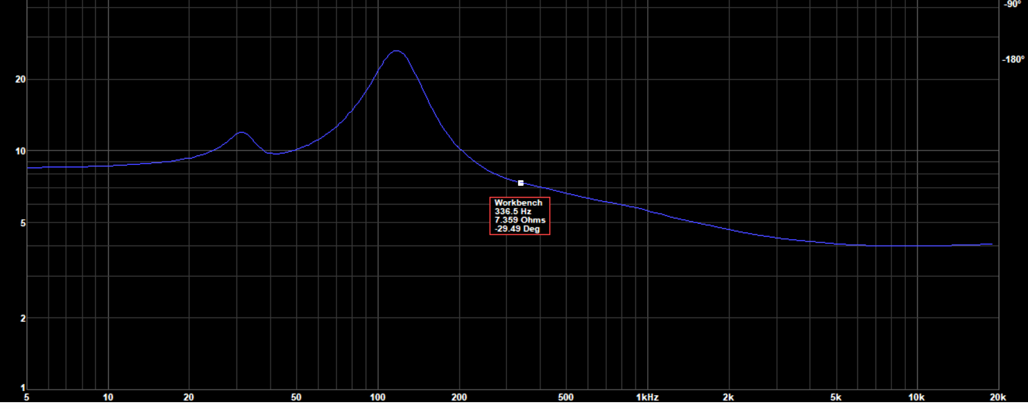

Impedance
They are easy for any amp to drive. You can see in this graph the port tuning frequency of 43Hz and the impedance is around 10 ohms at low frequencies and 4 ohms at high frequencies. These speakers are easy to drive.

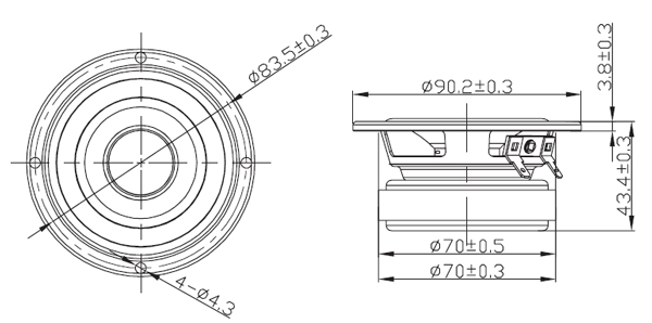

The Fountek FE85 is an excellent full range driver. It has a 3/4” voice coil and very light cone assembly of less than 2 grams. It has a fabric surround which ideally matches the acoustic impedance of the aluminum cone and very smooth response. It has very good high frequency resolution, as good as many dome tweeters.

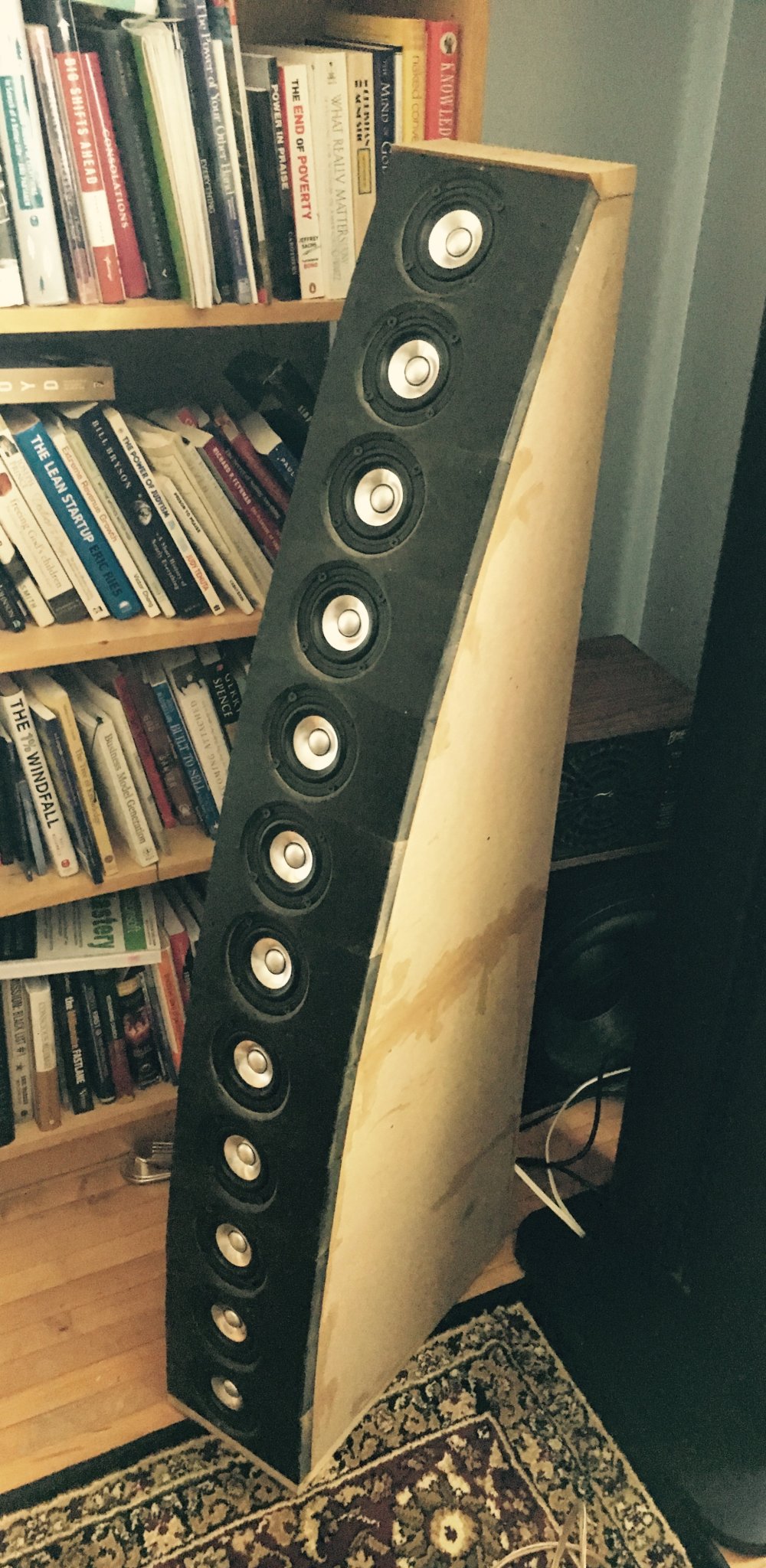

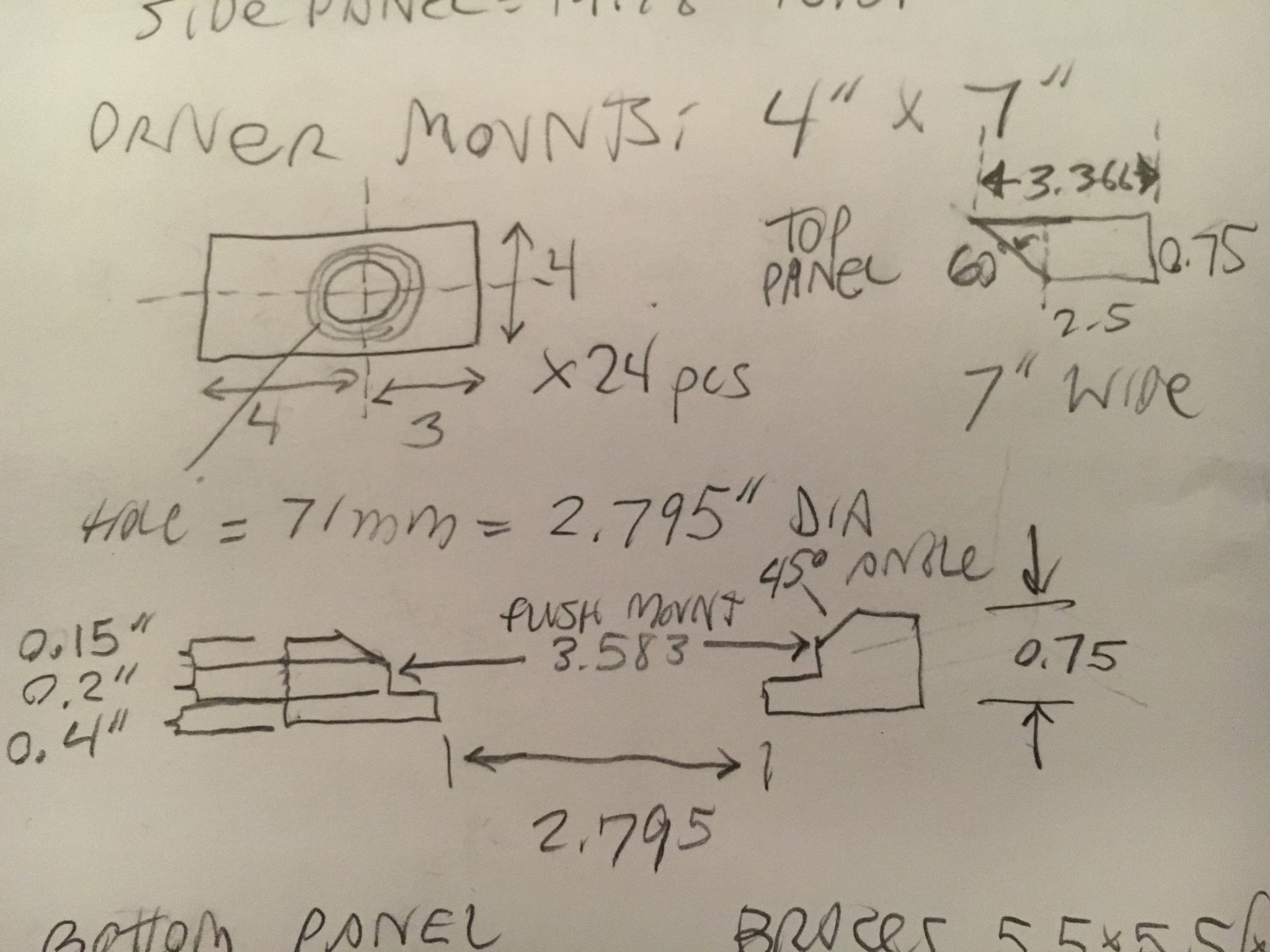

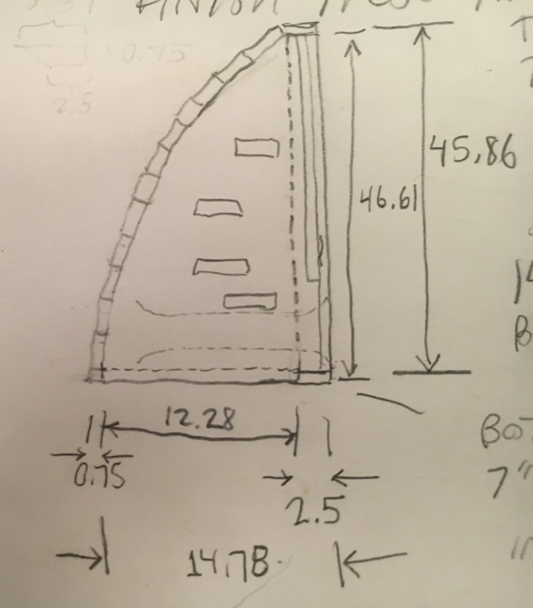

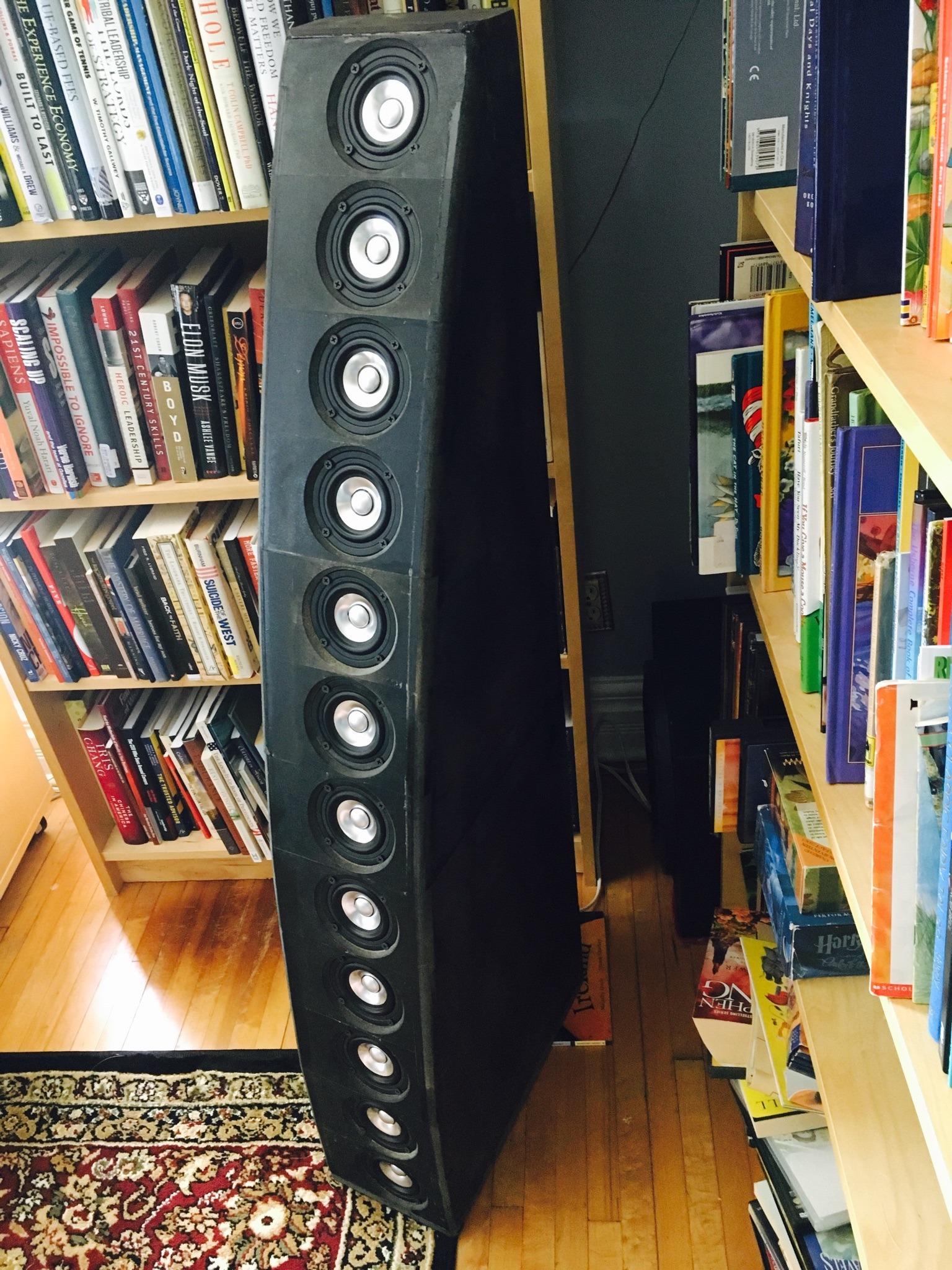

Cabinet details
The cabinets are 46” high, 7” wide and 14.75” deep. These are the sketches I gave to my carpenter Joseph Budka, who milled these on a CNC machine:

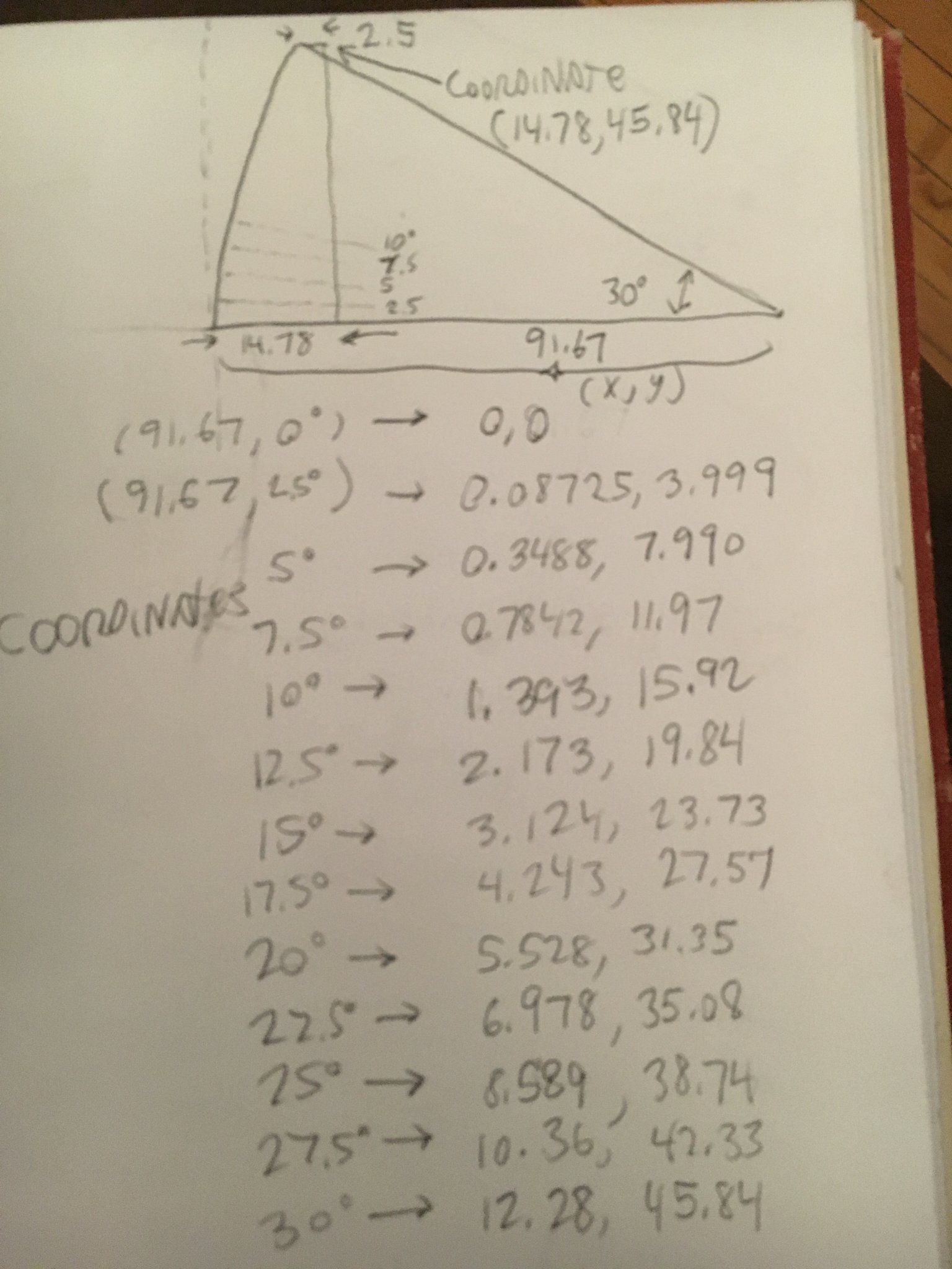

The drawing below shows the coordinates of each facing surface on the side panel that touches the front panel pieces, along with the angles of each facing surface.

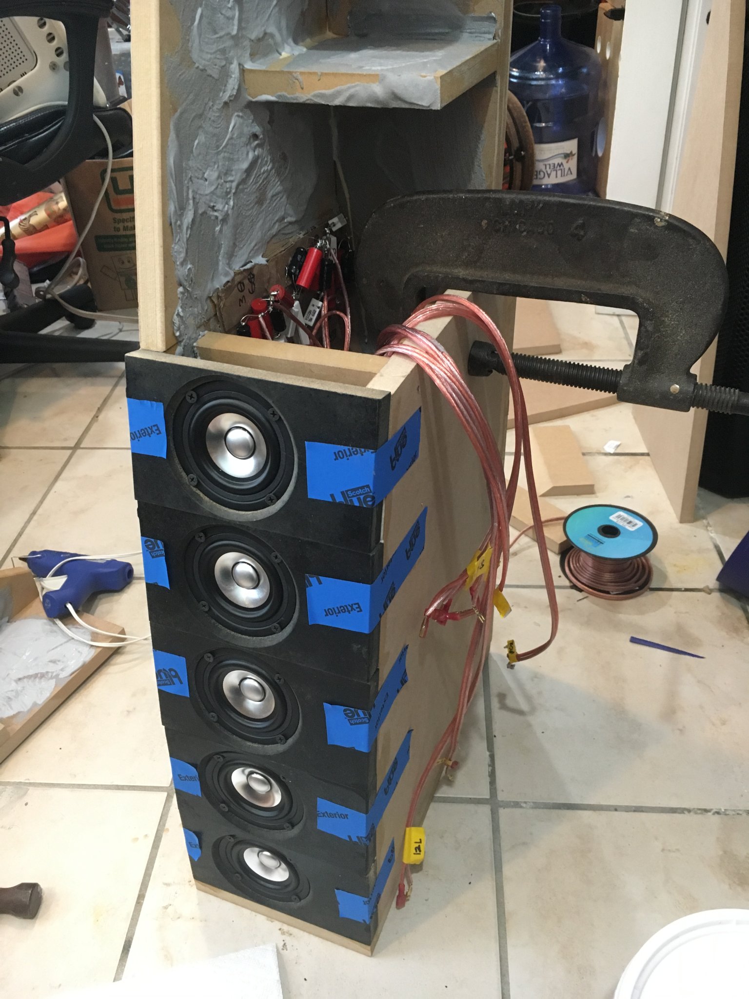

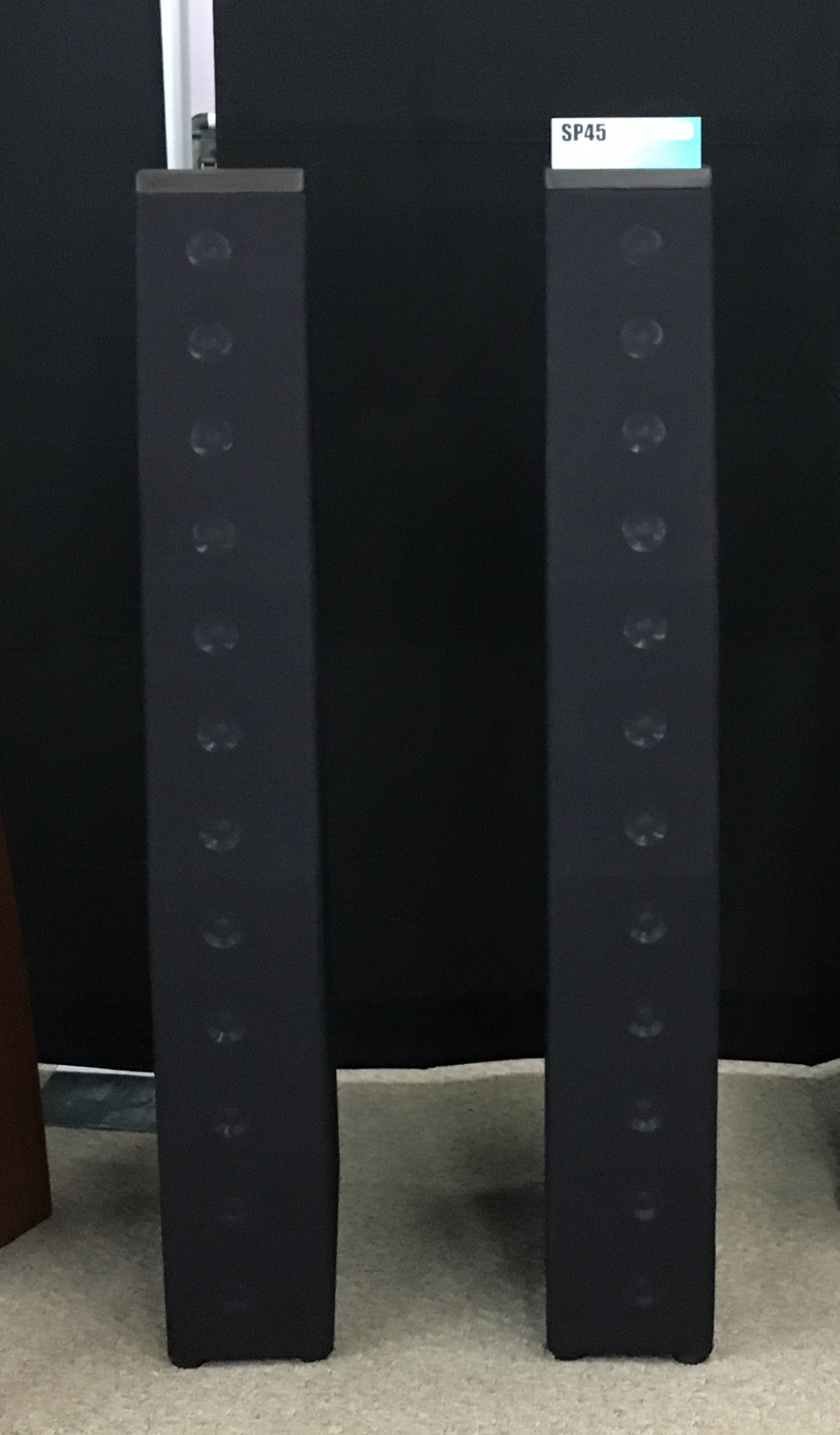

I wrapped them 360 degrees with black grille cloth with an oak wood cap on the top. I used very dark wood stain that makes it almost black.
I took these to the Parts Express 2017 speaker design competition where I got a lot of questions from curious designers. (Coincidentally, the speaker that won the competition was a much more sophisticated 2-way Shaded Array design.)
I think shaded arrays are underrated and I encourage y'all to try a design for yourself!

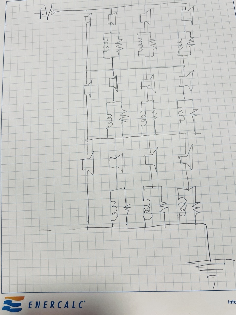

Impressive design! Instead of capacitors as shown in the circuit diagram, could it (using fewer drivers) be done using a cascading chain of small inductors in series, the drivers branching/hanging off in-between, each attenuated by resistor, would that also work? I can try that more easily (possibly Tangband W3-871S or small vintage drivers). Thanks.

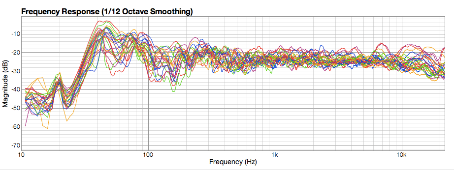

I've long since deleted the original actual measurements from my hard drive, and my son has these speakers now, but generally I found that various vertical angles got fairly consistent curves. At any given point there were usually a few comb filtering effects but in aggregate the system did very well.
The measurements I kept screen shots of are pretty good. FOR EXAMPLE: Here is an overlay of 24 microphone positions:
As you can see most of the curves fit within window of +/-5dB and this is in a real room with no attempt to gate reflections. @WhiteDragon
As you can see in the original post, none of my EQ required anything drastic. No nasty peaks or dips, in fact I'd say the real world measured performance is better than what is implied by the polar heat map.
Yes, you could do that. One way to achieve that would be this circuit here, or something similar. You should simulate this to get the values right. The TB W3-871S would be a great choice for this design.
Inductors do pose some problems: They magnetically couple with each other, unlike capacitors, and are usually more expensive.

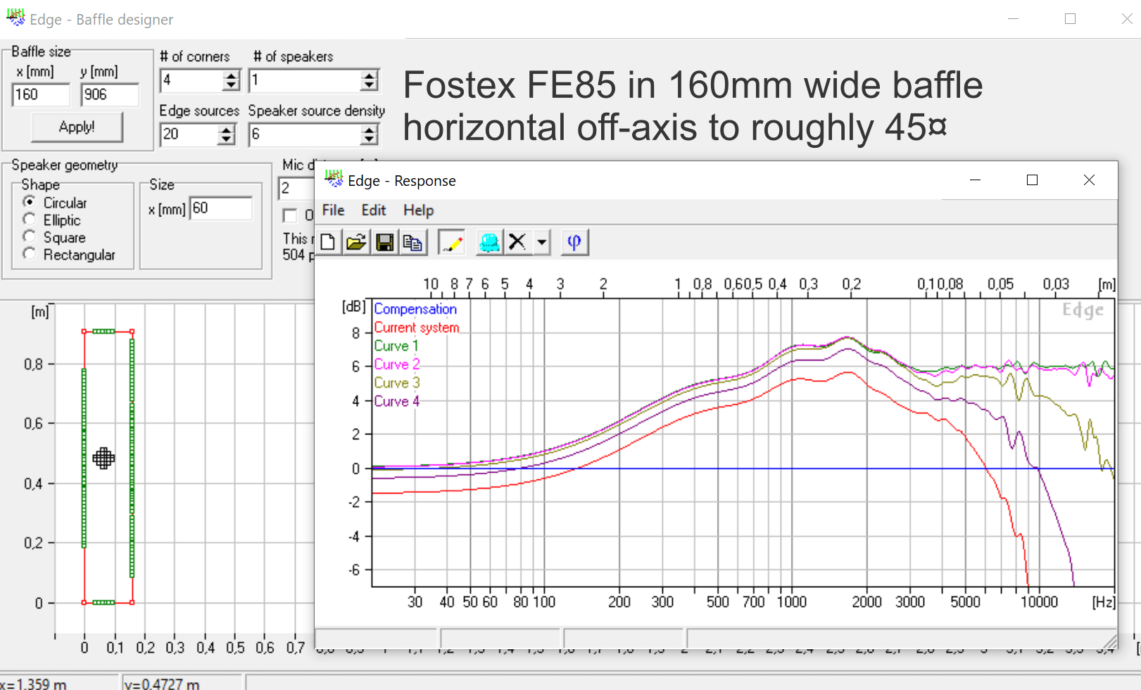

Fine! Did you save horizontal polars?
Link to Keele's presentations https://audioartistry.com/presentations_keele.htm
FE85 radiating width is roughly 60mm (midpoint of surrond roll) Sd 27cm2
https://www.madisoundspeakerstore.com/approx-3-fullrange/fountek-fe85-3-aluminum-cone-full-range/
I did not save horizontal polars, but they basically have the usual horizontal pattern of a 3.5" driver with 2.5" diameter cone, which you show nicely in your graph here.

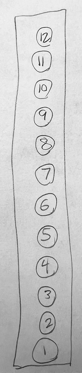

And to be absolutely clear, the drivers in the schematic are numbered from bottom = #1 to top = #12, and the HF response curve of each one tilts down 1-2 decibels every time you move from one driver up to the next.
This configuration makes it possible to "slalom" 5 simultaneous goals:
1) Full range drivers with no traditional crossover points
2) Constant Directivity
3) Linear Phase
4) Good efficiency
5) High power & high SPLs
