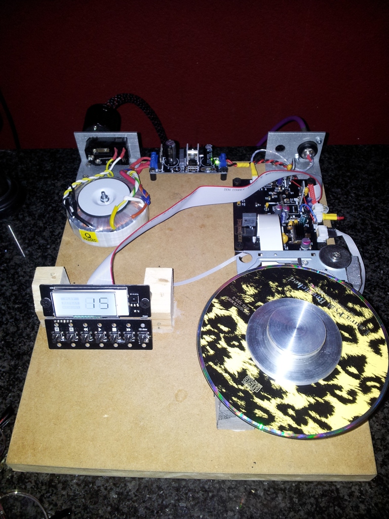

Ok, nothing new since last sunset or a few sunsets... No new builders. Is it just Tibi, Danzup and me? Follow the pic as I referred to will not give the answers, Tibis joy over an old famous picture doesn't really help as that is the picture he pointed out to follow. And now we have a standard an a high-grade kit so which one did we buy? Tibi - get your act together. Go for 2 boms - one high-grade and one low-grade. Now, so everyone can put these together an get a functional system! Then we can start to play and test things - othervise it will just be dirty and foul.

There are at least two other people who finished building SHIGA MKII. Maybe too busy with listening music. :)
Please post here a high res picture with what you have mounted so far.

Please post a picture with what you have mounted so far and what parts remaining.

Yes, quite so but not as in the pics you were refering to... Yes I have one good pic.
Tibi - I know the elec on C10 should be moved to C43 to be replaced by a 220uF tantal but I don't have one... ;) As you can see C28 2.2uF tantal is missing as is C2/C3 100pF on the remote. The silver mica on the PS board - maybe I didn't order that... Well well... The board is waiting for cleaning as well - clearly.

Turbon,
The parts might slightly differ from KIT to KIT upon availability on distributors. The pictures on my site are there to guide you to place correct values on correct places and to see which parts must be mounted and which can be omitted.
BTW, the best part for C10 is an oscon or polymer cap.
So far so good. Please show me other side as well.

Ok, here we go:

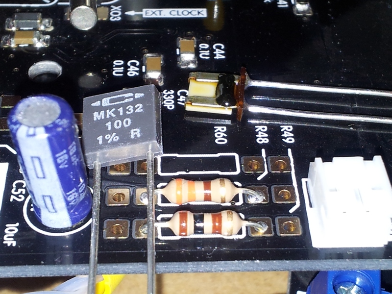

Hi Tibi,
The package has arrived.
Have the modified board (with regs and silver mica) listened to with the default board the modified board sounds better more depth and more detail.
But now wants to replace the spdif resistances but what is now the shunt and series resistance.
The bomb says:
R48 = 75Ω (100Ω) Shunt resistance
R49 = 75Ω (300Ω) series resistance.
https://docs.google.com/spreadsheet/ccc?key=0AkpVHsdmSfohdGo4VWMzTWlLRXlveDVPOWctLW5URnc&usp=sharing#gid=0
The photo and my measurement says otherwise.
Rudy
