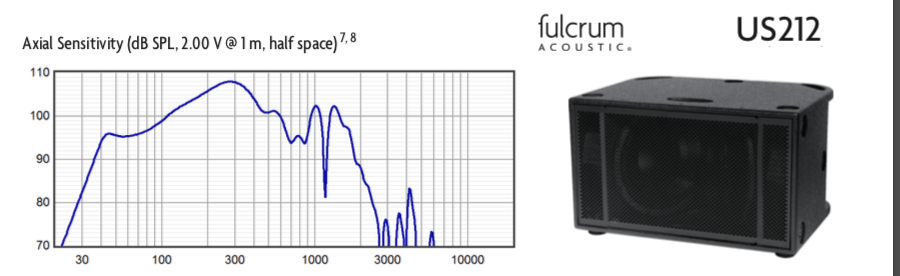

The "V" directivity behavior shouldn't be any more problematic than the frequency response.
The "V" forms a short offset horn, boosting the upper mid range ~100-300Hz, response above that will be fairly peaky.
The Fulcrum US212 frequency response will give you a rough idea of what to expect from the "V" configuration:
Putting an aperture in front of the relatively large dual 10" "V" chamber will make it a 4th order bandpass, usable response may not even extend past the frequency where polar response would be (almost) omnidirectional.
The bandpass resonance increased decay time (ringing) will be more of a problem than directivity or frequency response.

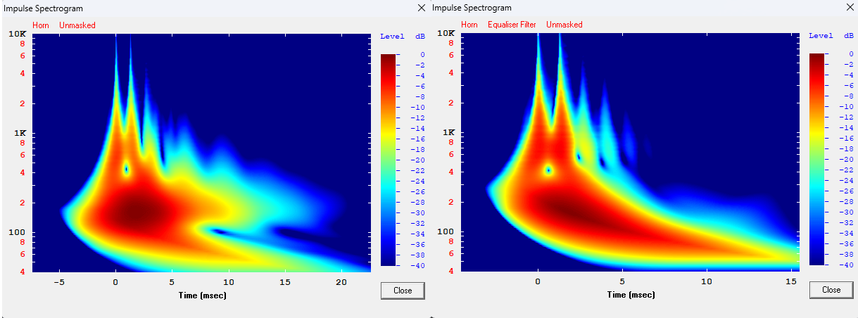

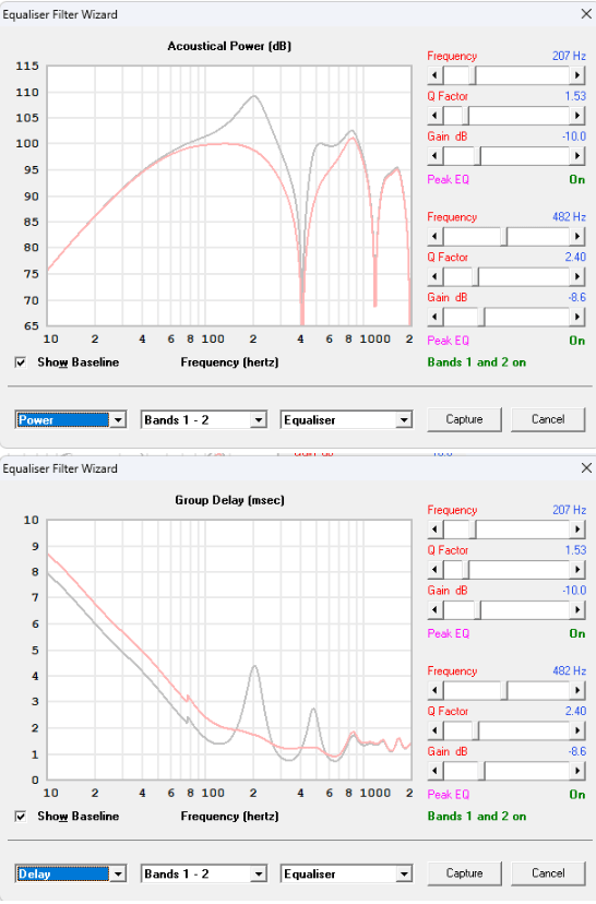

The ringing is not near as bad as it appears. The decay isn't as exaggerated as it appears, its just that the time to peak energy is pushed out in time and the decay portion can only begin after peak energy has been achieved so of course the decay sticks out in comparison to the areas where the time to peak energy is low. I honestly don't understand it fully, just enough to take advantage of the applied knowledge. As you can see the filter reduced the GD/Time to peak energy. Ringing in the FR is due to sharp changes in the response, Smooth out the response, get rid of the ringing. The end results isn't literally exaggerated decay free but its not enough to care about....given that we are dealing with typical short "pipes" "vents" you know what I mean...
As you wrote in that thread:
"Now consider a reflection. The cone makes sound which travels away somewhere, and returns to combine with the direct sound. Now there are two separate sources of sound. The resonance is not intimately linked, it is a circumstantial combination of two sources with a delay between them."
A bandpass chamber in front of a cone has multiple output times due to the internal reflections (echos) from various parts of the cone (diaphragm) which arrive at its output exit and "travel away somewhere" at different times "with a delay between them" .
Please explain how EQ can "fix" the multiple arrival times.

we aim for and expect a largely minimum phase behaviour from bass enclosures.
And we expect a bass reflex port's output around Fb to lag ~one compete phase cycle from the direct radiator's largely minimum phase behavior.
EQ does not "fix" that arrival time difference.
Multiple arrival times degrade transient response.
Whether that degradation is audible to an individual depends on the passband, time difference and persistence, program material, audition location, training and hearing ability.
You still have not explained how EQ could "fix" the multiple time arrivals from a bandpass chamber placed in front of a driver.

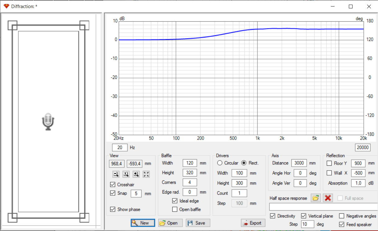

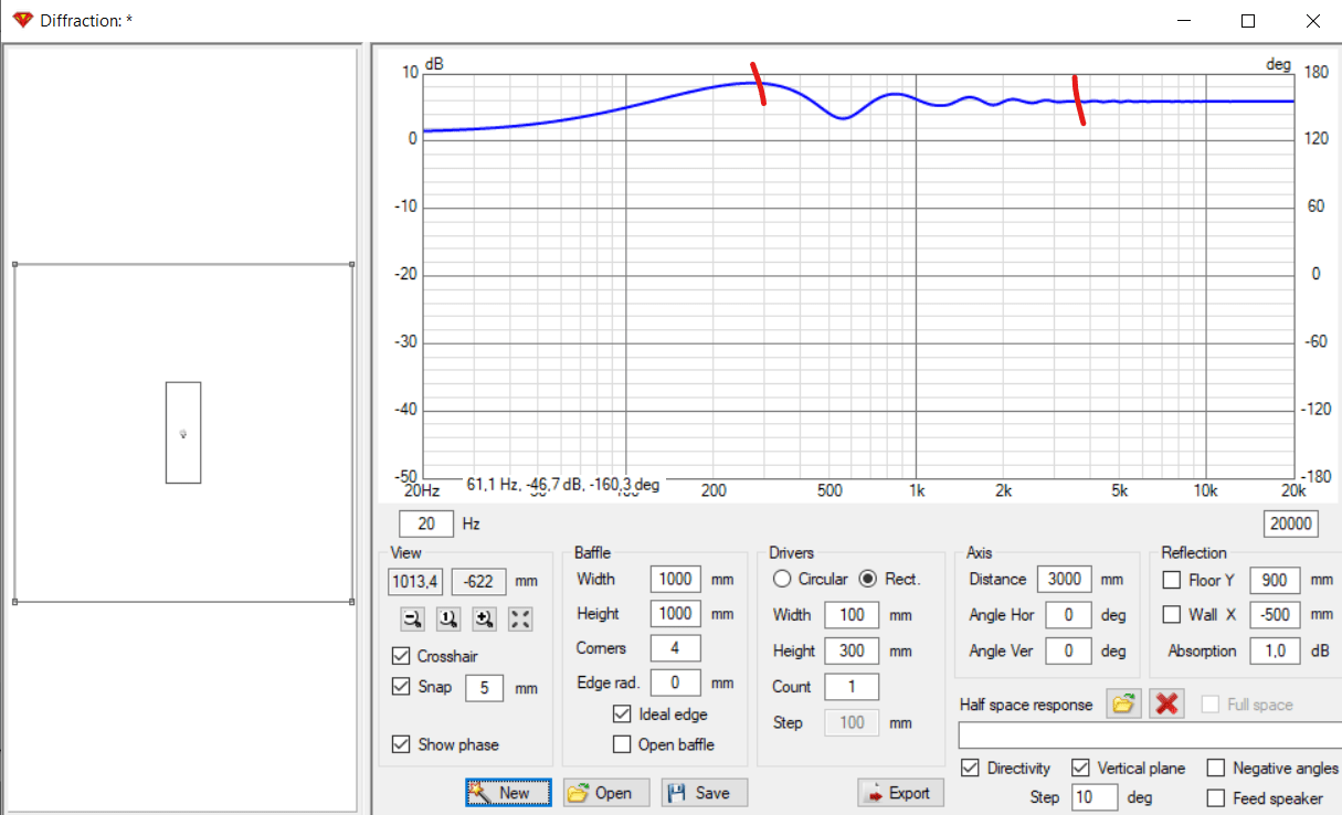

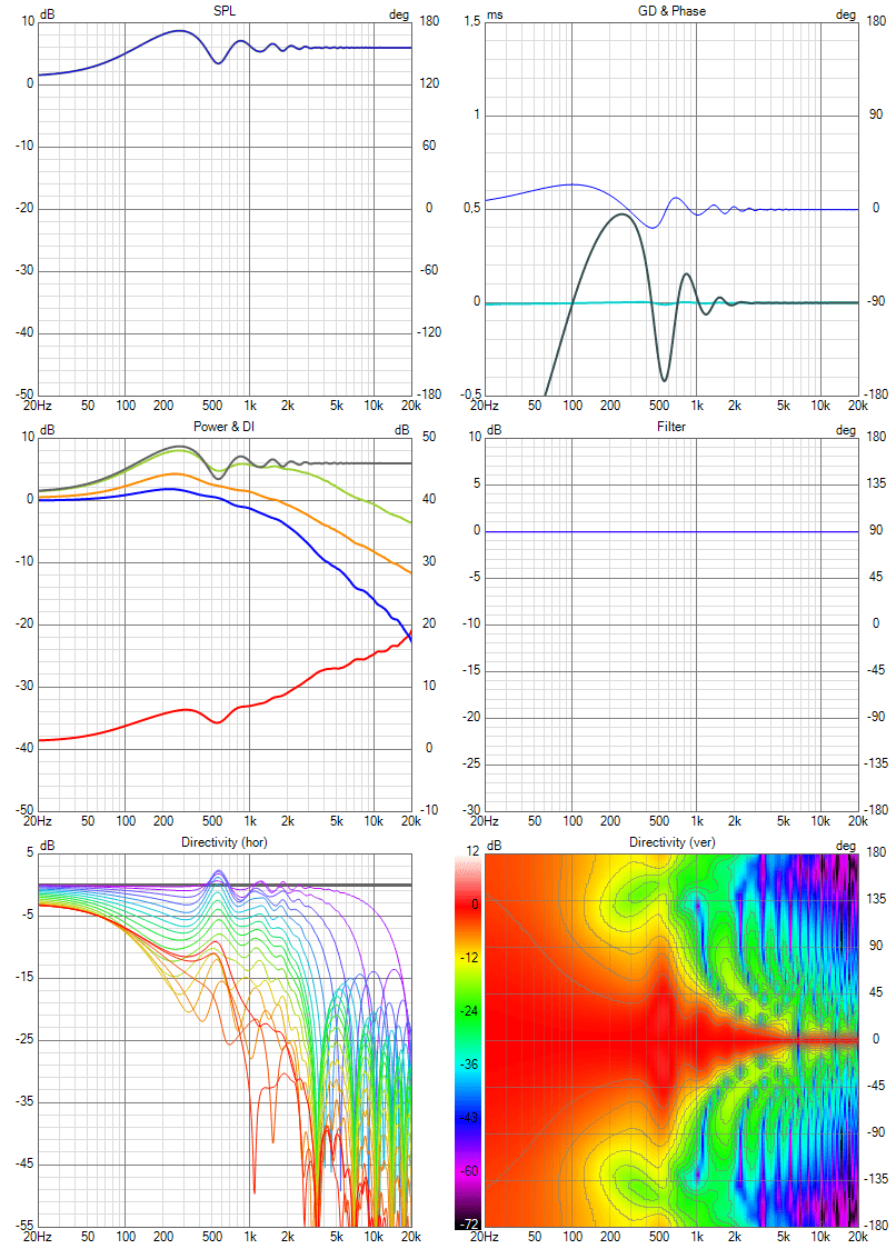

Example how one could estimate slot issues with "ideal transducer" in VituixCAD diffraction tool.
You'd be sure the baffle would make diffraction like any up until "the slot" beams, which depends on its size. In reality, the slot would have more chaotic response around the slot size wavelengths, and above, but you shouldn't use it that high anyway. It would also have acoustic low pass, perhaps response is already dropping there.
Example: Big baffle with "slot", where the baffle is roughly 340Hz in size (wavelength about 1m), the slot is roughly 3.4kHz (wavelength about 10cm) in size in horizontal dimension. Response is bad from baffle size up, because the slot makes wide radiation that reaches the edge, where diffraction backwave emits and making interference with direct sound seen as undulation in the response. Above slot size frequencies the slot beams and no interference seen anymore, but here response to any direction would be chaotic most likely, also dropping response due to acoustic low pass. Look the polar plot to see how much such sized sound source would beam in ideal case, while real life it likely has even more undulation to various directions, more than here. Slot isn't likely usable beyond this due to beaming / "chaos", and due to acoustic low pass. "best" usable bandwidth here is below baffle size, like always with any sound source on any baffle, because there is less and less secondary sound emitted at the edge. Roundovers would help of course.

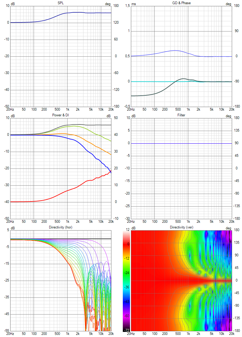

Example 2: if slot is no bigger than baffle, the usable bandwidth is now from slot size down. I'm kinda abstracting the slot away here to show it would be roughly similar in system performance terms as similar sized sound source, except likely bit worse. So, best slot is no slot. Slot has benefits too, the acoustic low pass would low pass distortion as well. So, wanna use slot, make it small and factor the cavity so that the acoustic low pass helps you out.
Above is how to "simplify" and just reason with wavelength to physical object size and how they interact, to get intuition and ballpark idea just by thinking it through. Real world graphs would always be worse than simplified simulation with ideal transducer. This example does not show any driver related things like cone resonances, or resonances in the cavity between driver and baffle and so on. Most of these would happen above driver size frequencies. Real world sound could be just fine though beyond what I idealize here, to some extent, which are things determined by you, what you are looking for, what is important and what is not. If there is a slot, it's there probably with some reason with associated trade-offs. If trade-offs outweight benefits it would be better to change the plan.
Hope it helps, have fun with imagination!:)

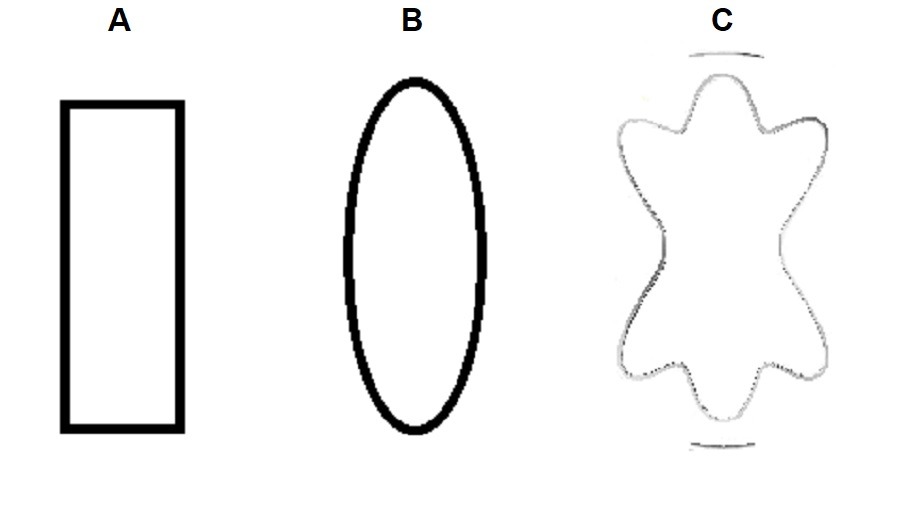

Very interesting. Lets say one wants to use a diffraction slot on a 12 inch speaker to better match a small horn (or "K-tube") mounted on top of a cabinet. How might they pick in advance a best slot shape? - or should the exercise be carried out empirically with cardboard lenses and measurements ? (could be faster).
In the 1960's John Karlson devised and marketed a line of "asymmetric projectors" claiming wide coverage of rectangular areas (-nearly 20 year before Don Keele Jr.). I know these "worked" or seemed to in a sense. They were mounted high at a wall and if one sat pretty close to that wall and around floor level they sounded reasonably clear.
What does the tapered slot in Karlson's "clam/klam" really do with regards to dispersion patterns? The front chamber is relatively deeper than Karlson's Ultra Fidelity stuff and can cause more problems (probably when small)
How do you view the regular Karlson enclosures? I would ditch them but with good driver match they sound "more real" with drums than any of my limited FLH collection. I've also heard horrid stuff from them with some drivers.
