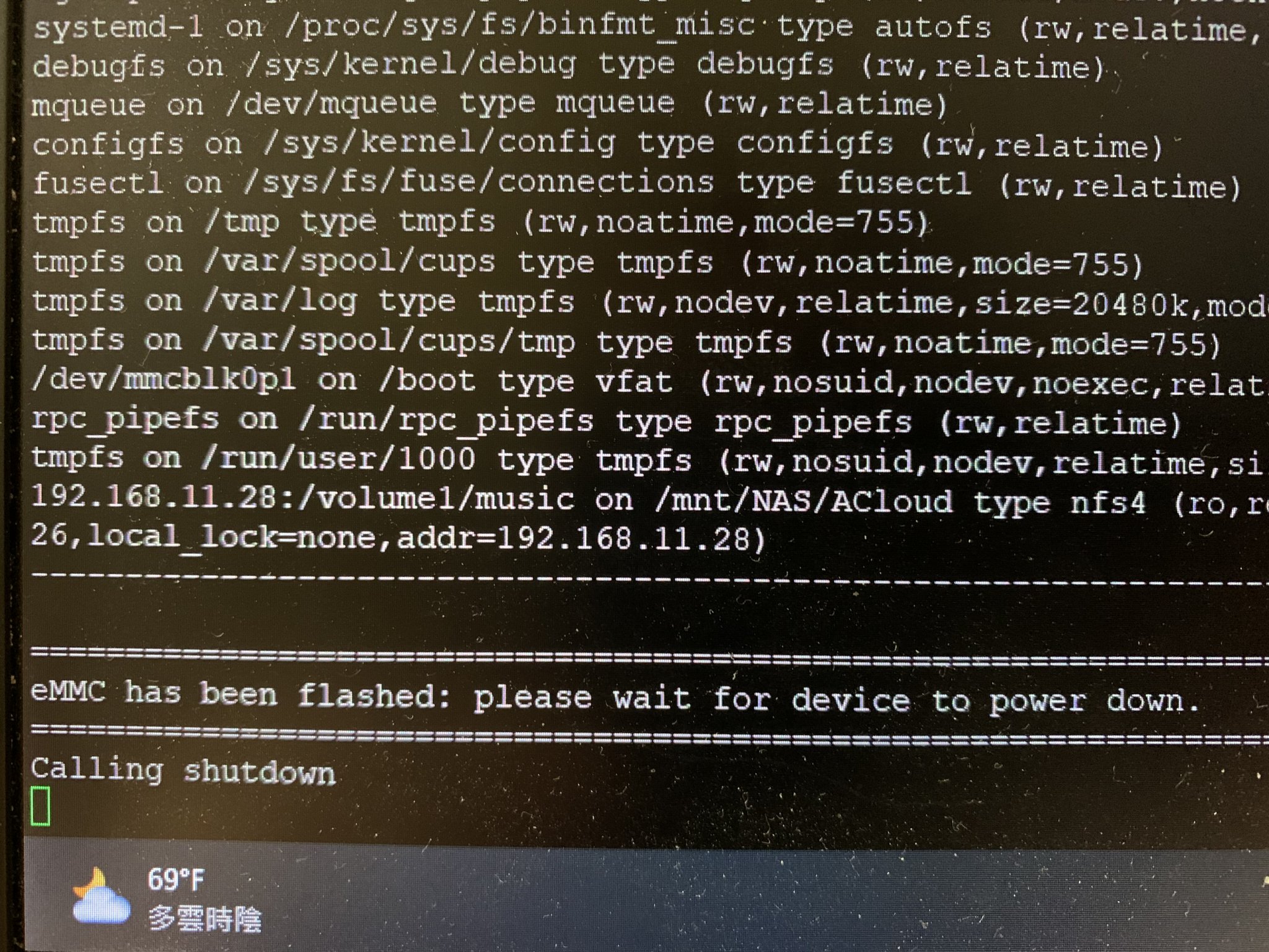

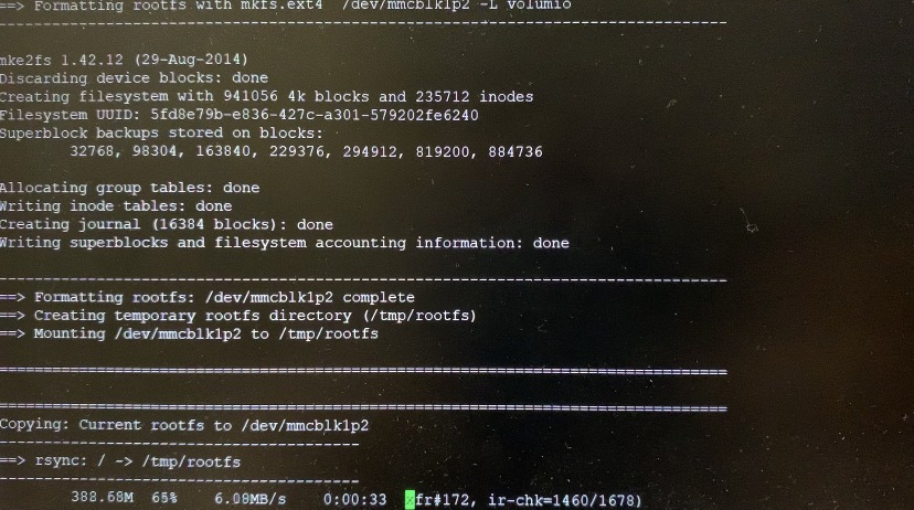

Thanks for your information. I’d successfully flashed the eMMC. However, it failed to boot from eMMC. Does anyone face the same problem?
