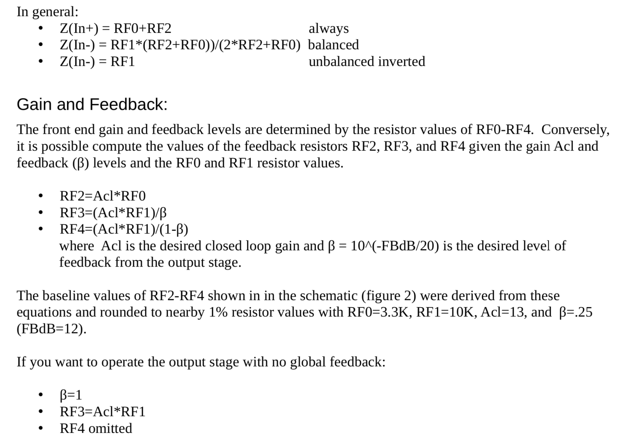

On page 9 of the build guide, Lynn has provided details on how resistors RF0-RF4 affect not only the input impedance, but also the overall gain by manipulating the amount of feedback. I suggest you go through the computations with the resistors that you have in your stash to see how these values change and to see if they are compatible with your own goals of closed loop gain and input impedance.

Thank you @lhquam also how critical are these odd value resistors in the front end just trying to see if I can use the parts from my stash
RF2 1 x 43.2k 1/4 watt 603-MFR-25FBF52-43K2
RF3 1 x 511k 1/4 watt 603-MFR-25FBF52-511K
RF4 1 x 169k 1/4 watt 603-MFR-25FBF52-169K
They are no that critical. Slightly different values will modify the gain and global feedback factor a bit, but if the same values are used for each channel you will not have any problems.

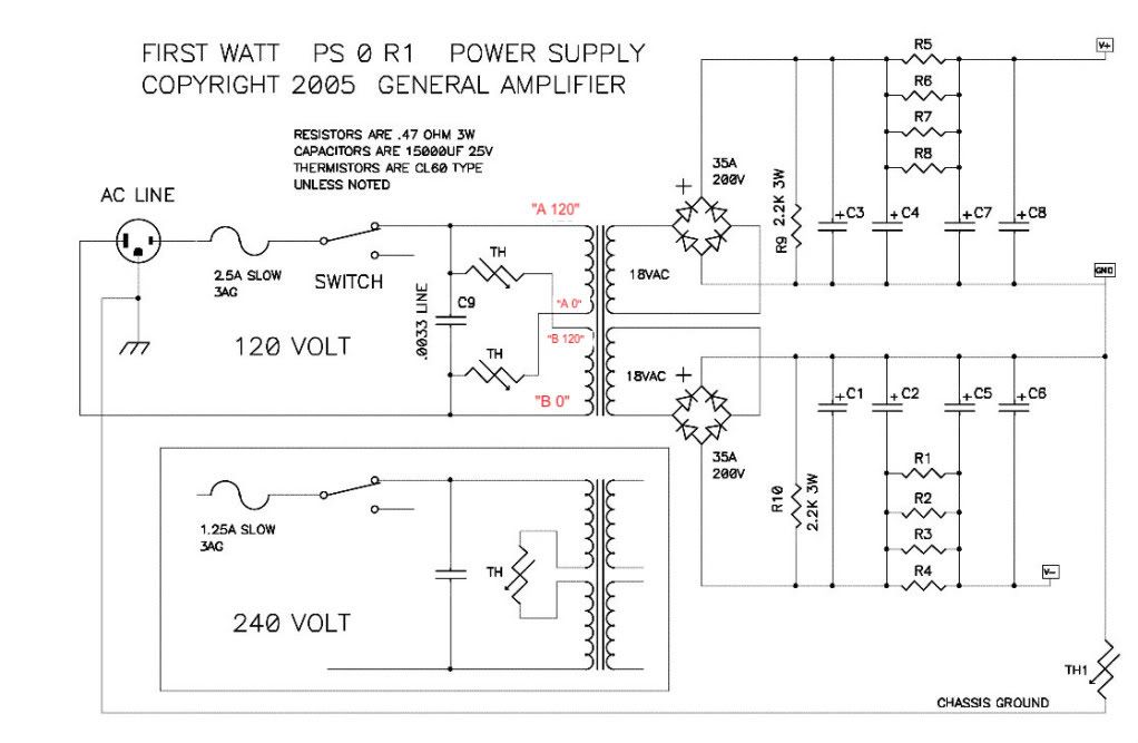

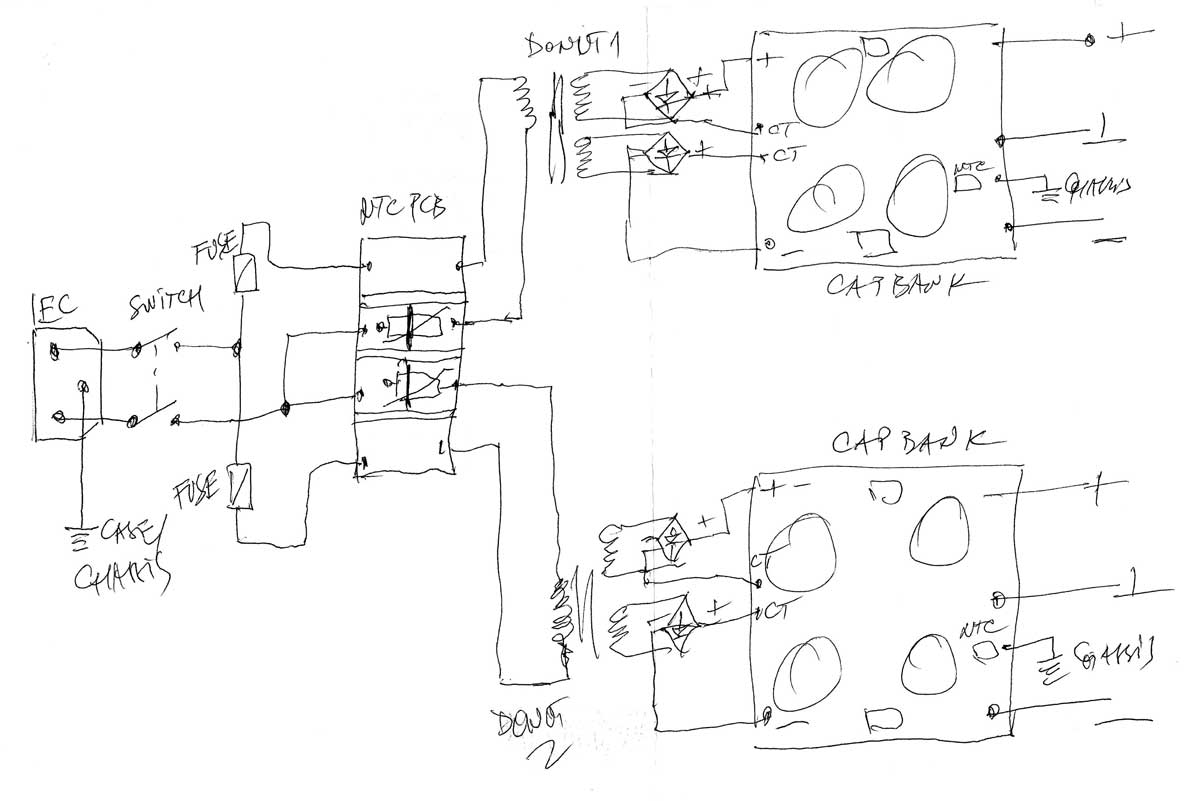

I have a little follow-up on the PSU-discussion: I intend to build a FW-style regulated PSU, in dual mono (1 independent PSU per channel), like in the attachment, but with 1 NTC ground-lift per channel... As far as I could follow the discussion, this shouldn't be an issue I presume?
common IEC, common switch, then everything else separate per channel
Note that with common IEC (including common chassis ground) and common switch, the fuse for each channel should be located after the switch, unlike the schematic which shows the fuse between the IEC and switch for the stereo configuration.
If you wish to have a switch for each channel, then the fuses may be located between the IEC and switches.

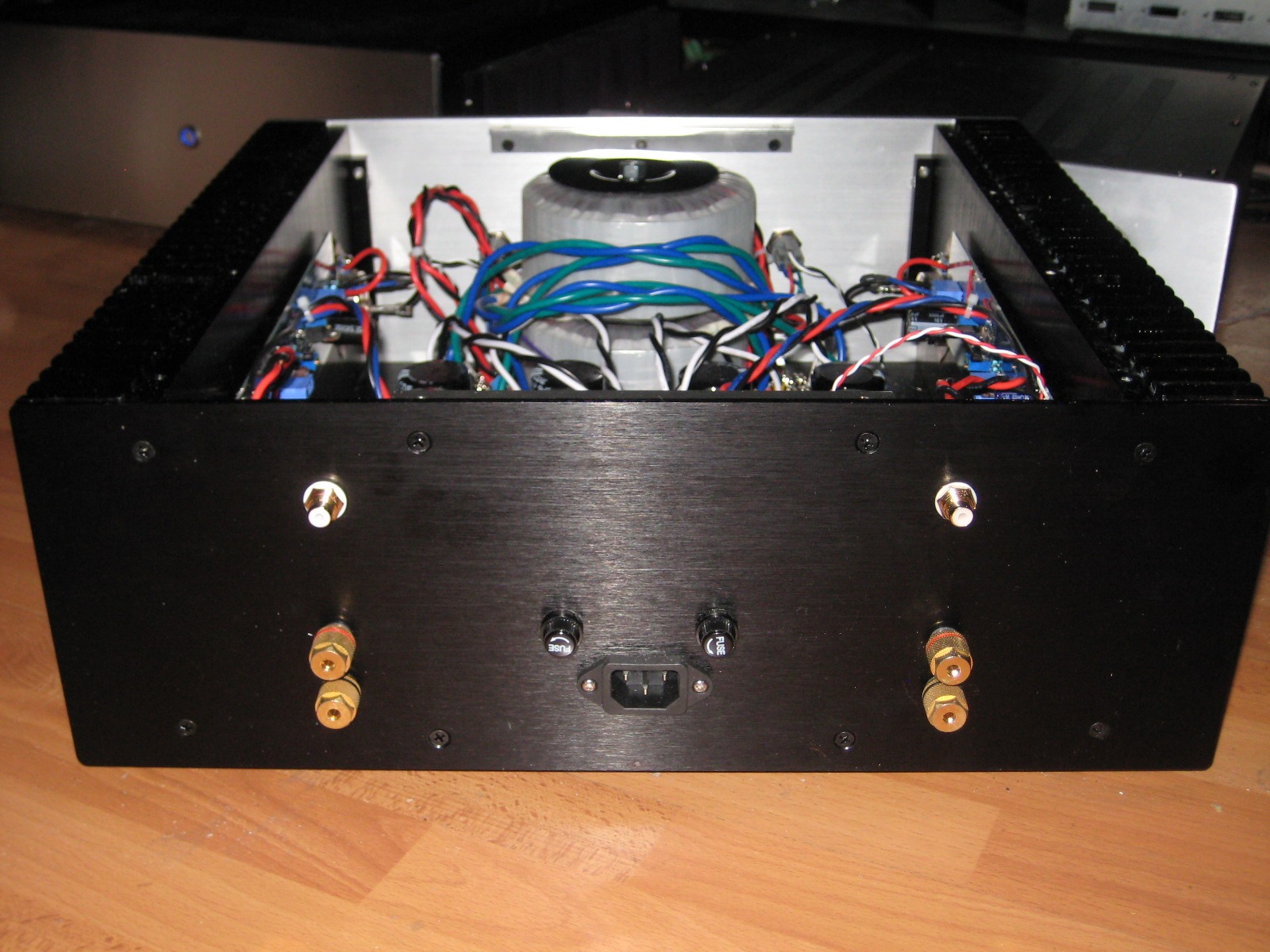

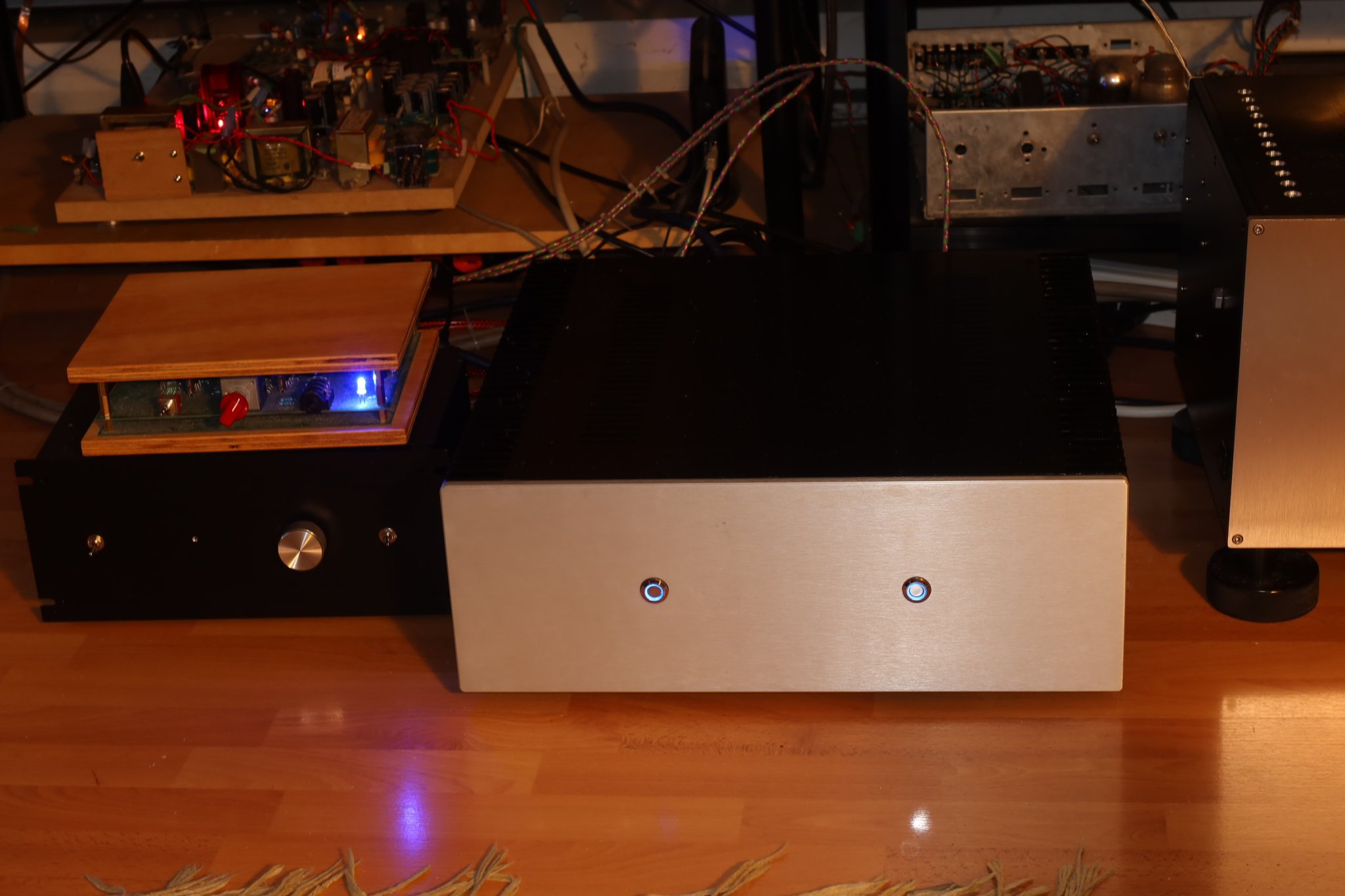

I built a dual mono amplifier with a switch for each channel. It's one extra step at turn-on and turn-off but it is handy and I like the look.
Reactions: 1 users

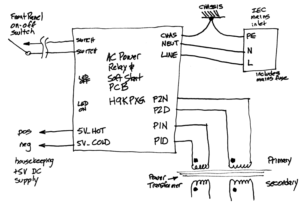

What circuit will you add for regulation?
Ahem. Now that you're asking, I (probably again) confused terminology? I will use a conventional 24V regulated linear PSU as used in FW-amps...

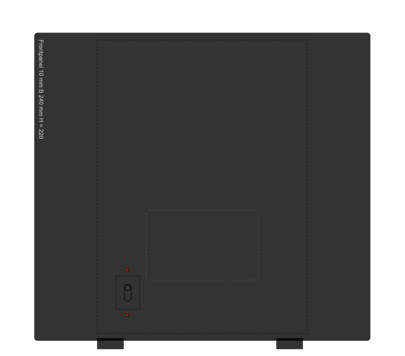

@Ben Mah Thank you for the heads-up. Although a dual-mono-dual-switched solution is cool, there will be one switch and one softstart-board triggering both PSUs. I'm not sure where this will lead me to / where the fuses will be, but I'll use Mark's H9KPXG Softstart… (Even if Mark's sketch indicates the fuse before the switch—integrated in the inlet—I am confident it will be appropriately and entertainingly :) answered…).
