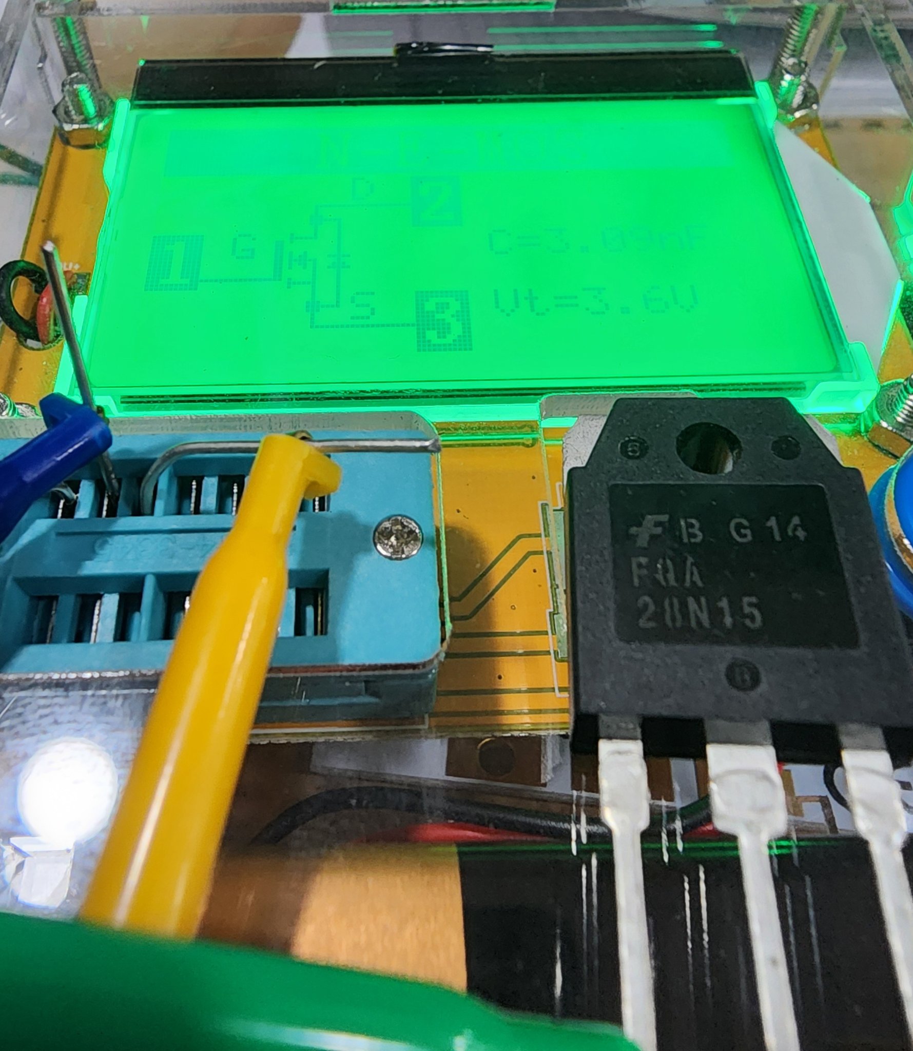

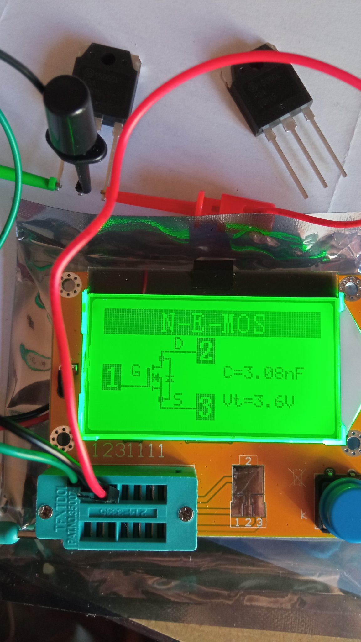

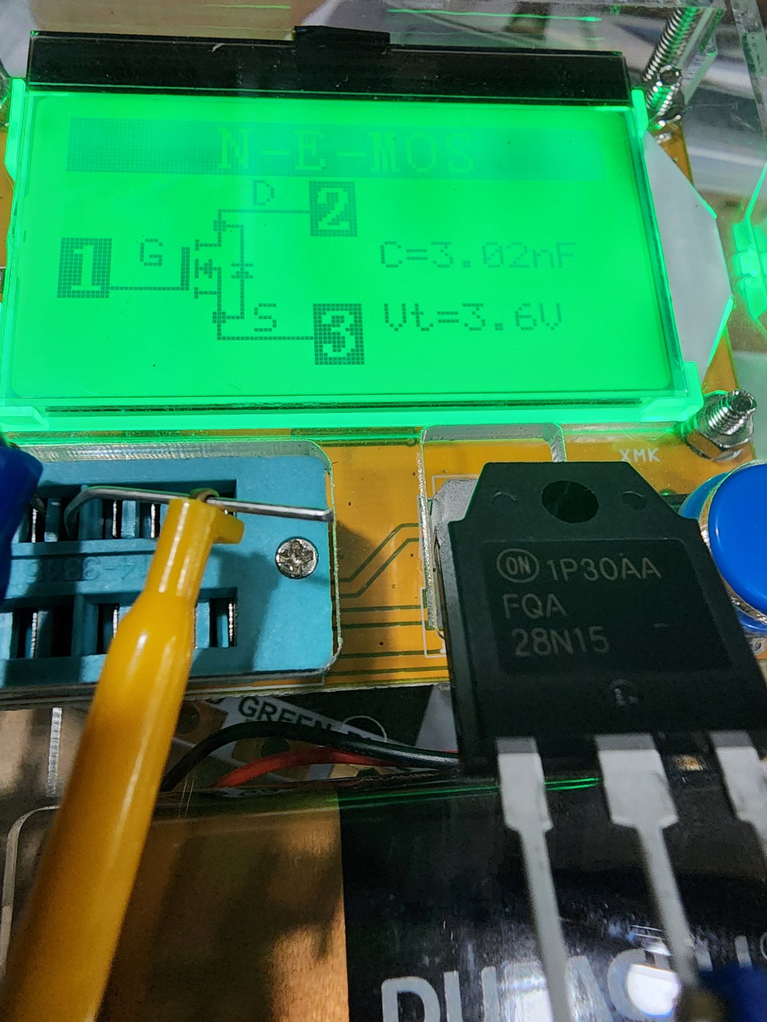

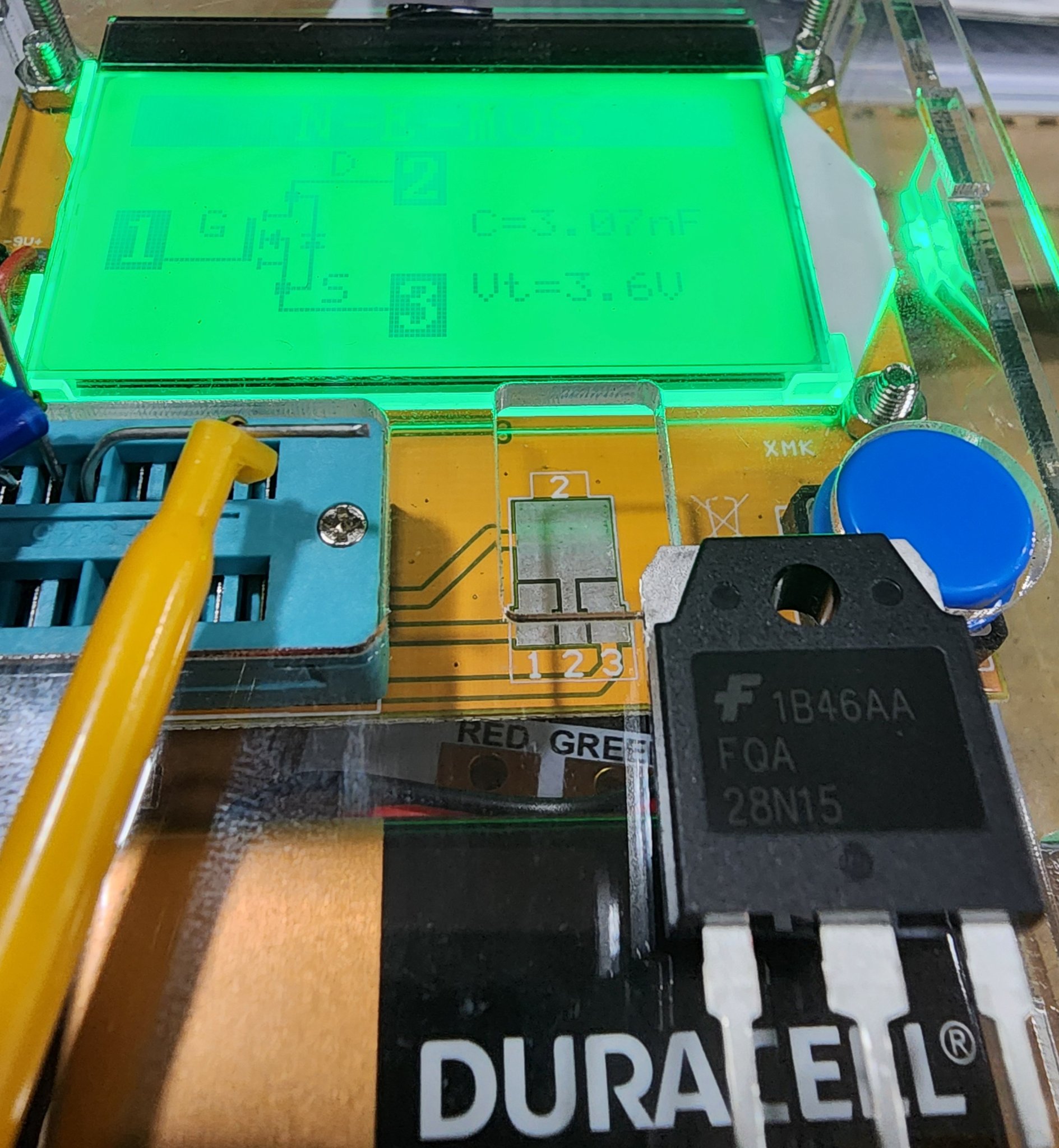

I tested the fake MOSFETs with a basic component tester and the values obtained are similar to those of genuine MOSFETS (image below). But, from what I understand, fake components can perfectly mimic the 'behavior' of genuine components, the problem with these fake components lies in their reliability.
Furthermore, the visual inconsistency between the received MOSFETs stands out, and I don't believe that Fairchild had such poor quality control.
This is why I don't think it's worth investing time in taking more measurements when it seems obvious (to me) that these are fake components. Even if those measurements were within expected values, I would still think that these were counterfeit components.
PS: I'm only referring to my MOSFETs, the same doesn't apply to @myleftear's.

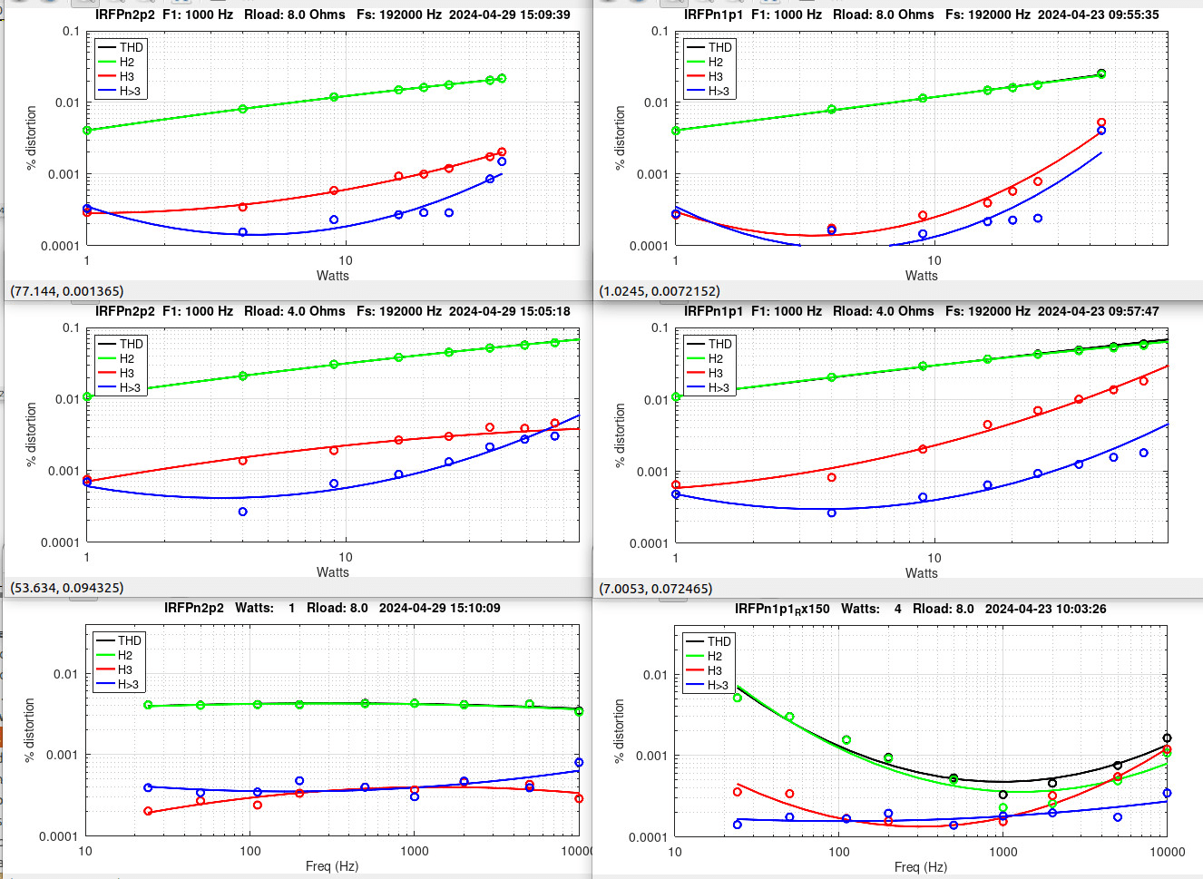

I finally obtained some Harris IRFP9140 FETs and tested them in the Holy Grail Follower.
The image shows distortion sweeps for the left and right channels using randomly selected pairings of IRFP140/9140 FETs.
Bottom line:
  • H2 is about 20dB above H3 and has positive phase relative to H1. H2 phase is easily inverted by using In- and reversing the speaker connections.
  • In A/B listening tests I cannot hear any difference from well selected FQA28N15/FQA36P15 FETs.

I ordered a set of 10 MOSFETs (28N15) from this eBay seller. When I saw the image (see below) posted by @myleftear I was quite confident that I could receive potentially genuine MOSFETs, but unfortunately the articles I received seem obviously counterfeit.
Apparently, the seller may have genuine FETs as well as fake ones.
In other words, buying from this seller seems to be a game of chance.
Do business with this seller at your own risk!
@myleftear MOSFETs (which I assume @lhquam got from Polida's store)
MOSFETs I received from Polida (visual inconsistency between the various items is significant)

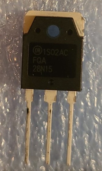

For reference genuine onsemi 28N15 MOSFET
The FETs I received from Polida had the same "funky" weld on the legs as though they had been scavenged from something and made available for resale. Various manufacturer markings seem to suggest that they came from different fab lines and/or production batches.

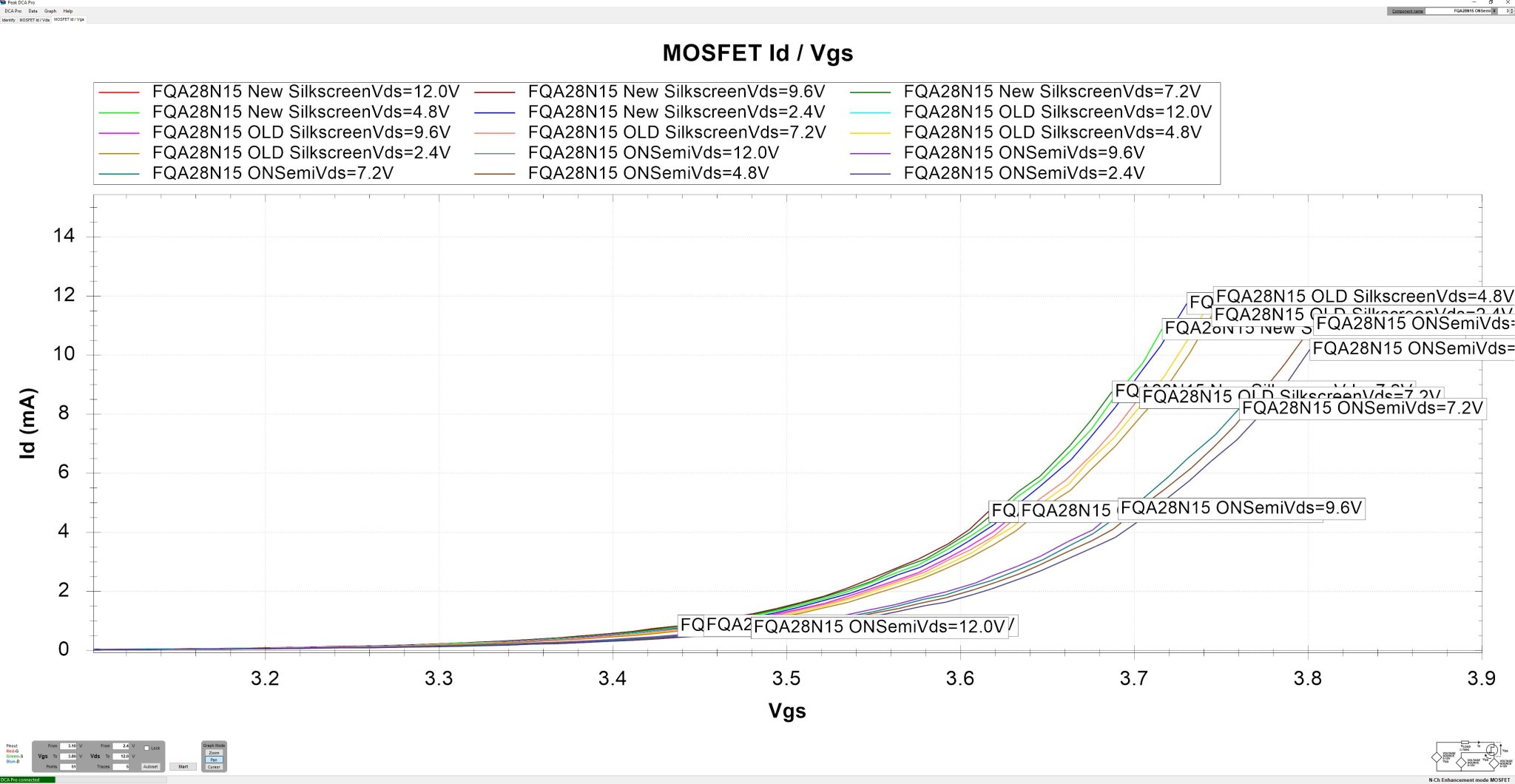

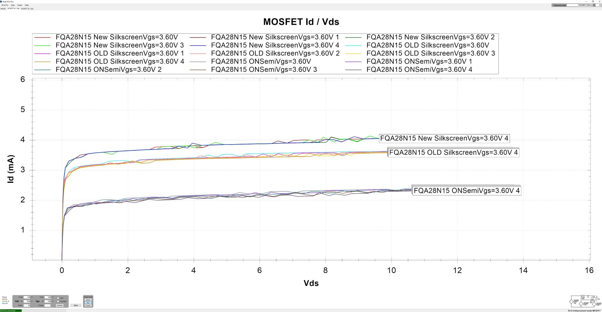

I got two silkscreen versions from @lhquam (and thus from the same eBay seller) and measured both. Seem to be legit match regardless of silkscreen based on measurement. "New" is the top one with unbroken numbers. "Old" is the middle with the break for the number 8, Q, B, and A. I also added the Onsemi version.
Here's a picture @Toys4Boys provided showing what he purchased from a reputable source for the OnSemi FQA28N15 (Newark) just so it's all in one place.
Bottom line:
So after all Harris or IRF 9140/240 combination can be used for the Holy Grail Follower, perhaps with lower bias currents. Is that correct?
Post 557 shows distortion sweeps for the pairing of IRFP140 (?) with and IRFP9140 made by Harris. Those sweeps are with 12dB negative global feedback. The distortion levels are quite low into an 8 Ohm load, but not so good in to a 4 Ohm load.
I will discuss this further in a future post.
