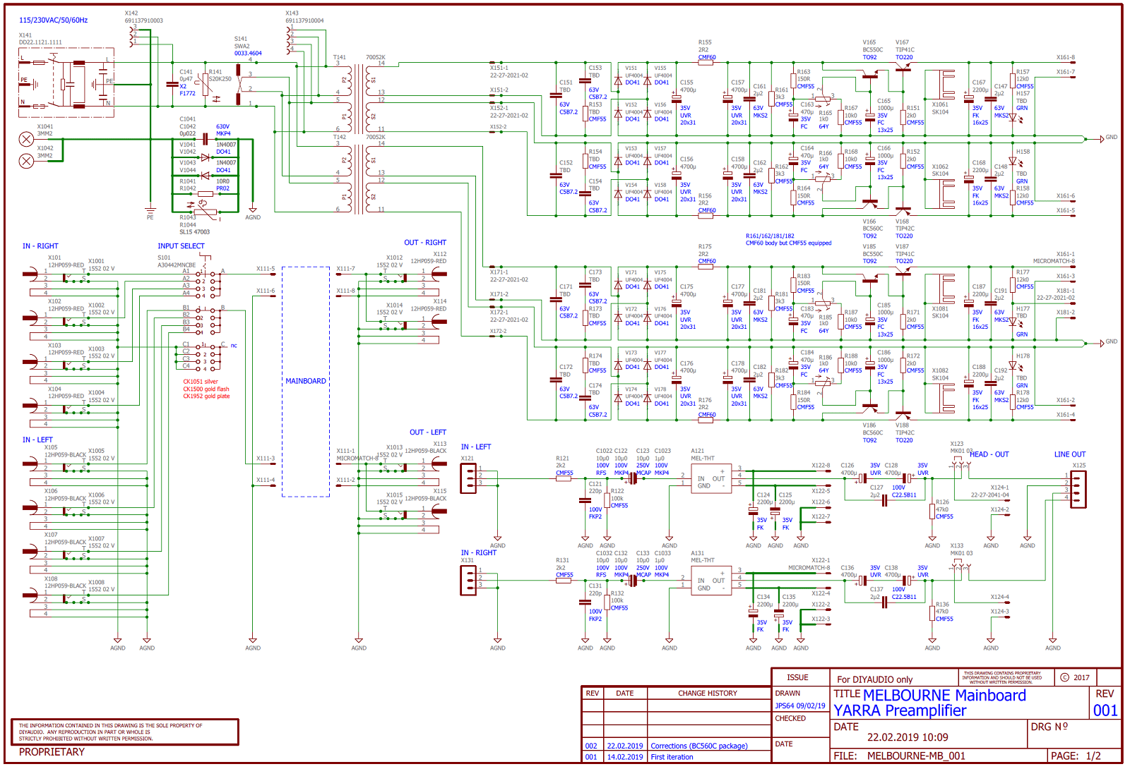

I'm late to the game and just completing this Yarra preamp and have what is probably a dumb question. I'm using the Melbourne daughter board. I've read most of the threads, but may have overlooked something. It appears that the Melbourne wants +/- 24VDC rails. I'm using 22 volt transformers and hence getting 32VDC from the Yarra PSU. I assume that I should be using 15 or 18 V transformers instead, but wanted to check here first. Thanks.

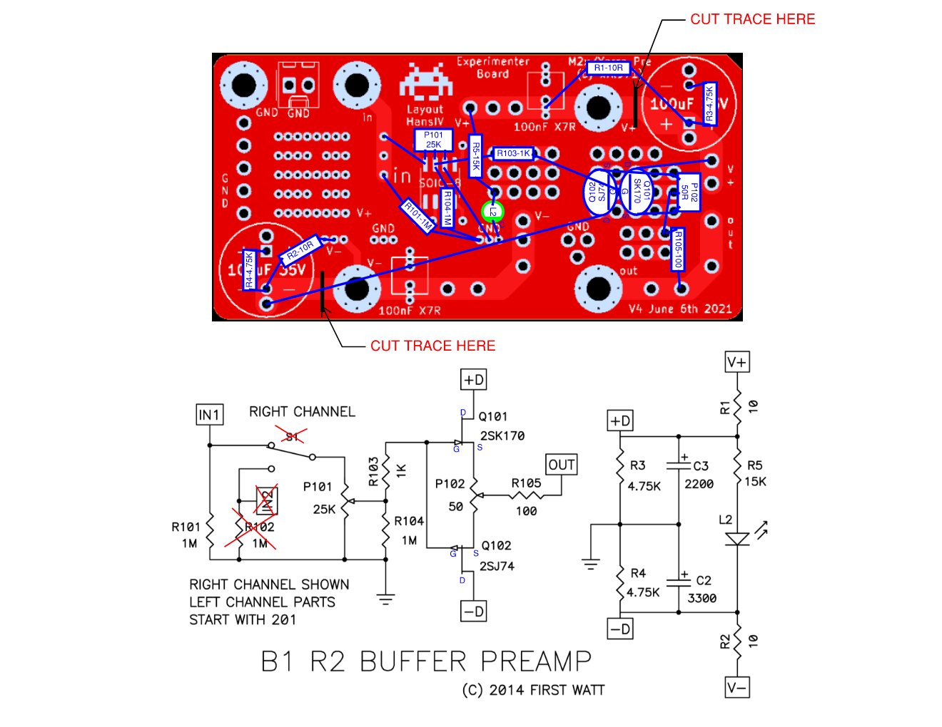

For experimentation's sake I'm going to use the earlier developed Yarra Experimentation Boards to plug a B1 Buffer (Rev 2) into the Yarra. Here's a crude diagram. Let me know if anyone sees anything wrong with what I have proposed.
