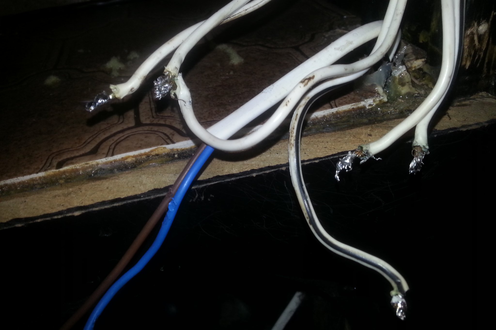

Ok so I swapped over the wires as recommended, this time I'm still not getting any ST sound, the midrange surround is not as it was before the movement is way less. Over all im not missing any high frequency notes to suggest their is a requirement for the ST. Only time will tell as more music will be played and more listening.Bazza, you should try connecting both ways and see what sounds best to you. Do it to both speakers together when making the comparison.

Could this have something to do with it. Hear the 2 white cables without the black stripe is positive, and the 2 are soldered together? Also the ST had 2 black wires connected to the negative and 1 from the positive. So their was some kind of connection going on with the 3 drivers.The supertweeter is probably lobing with the tweeter to the end that it could be varying the treble with frequency.

You know that all the negatives are connected together. Trust what you see, since it isn't clear what a previous owner did to manage their polarity scheme. However, this shouldn't prevent you from choosing your own polarity arrangement by swapping connectors at the driver terminals.

- Stop assuming the original owner had any idea what he was doing with the wiring!
I could guess why, but that wouldn't be productive.Thanks I get that, but all the wires where tide together eg 2 for bass. 3×3 for ST.T.M then tide together in 2's was ST.T.M. but why was the ST have 2 black to negative and 1 to positive? That's what gets me?
I'd take my multimeter and check continuity this way. See that all negatives are connected to each other. See that none of the positives are connected to negative. See that none of the positives are connected to any other positive (expect the resistance between T and ST).
So only 1 ST works! ! I then just went for it, swapped phase at amplifier=nothing interesting. Then swapt the M phase unit=peacks in mid up and down but I did hear that annoying pathetic bass, only 1 thing to do their. .that was to swap phase at the bass unit. ."HALLELUJAH" Top side was great I mean really nice midrange including tweeter very good indeed. Bass was coming through deep and correct. But 1 question, can too much woolly damping material hinder poor bass at very low levels?I will disconnect the ST's and test them alone away from everything. This I'm thinking I will do by connecting a headphone jack into a phone which has the ends for the speaker disconnected so it's just bare wire. This way I'm thinking not to much power is given to the ST, also I have a 4uf 50v capacitor. Will the capacitor separate the low frequency and help with answering weather the ST works or not?
