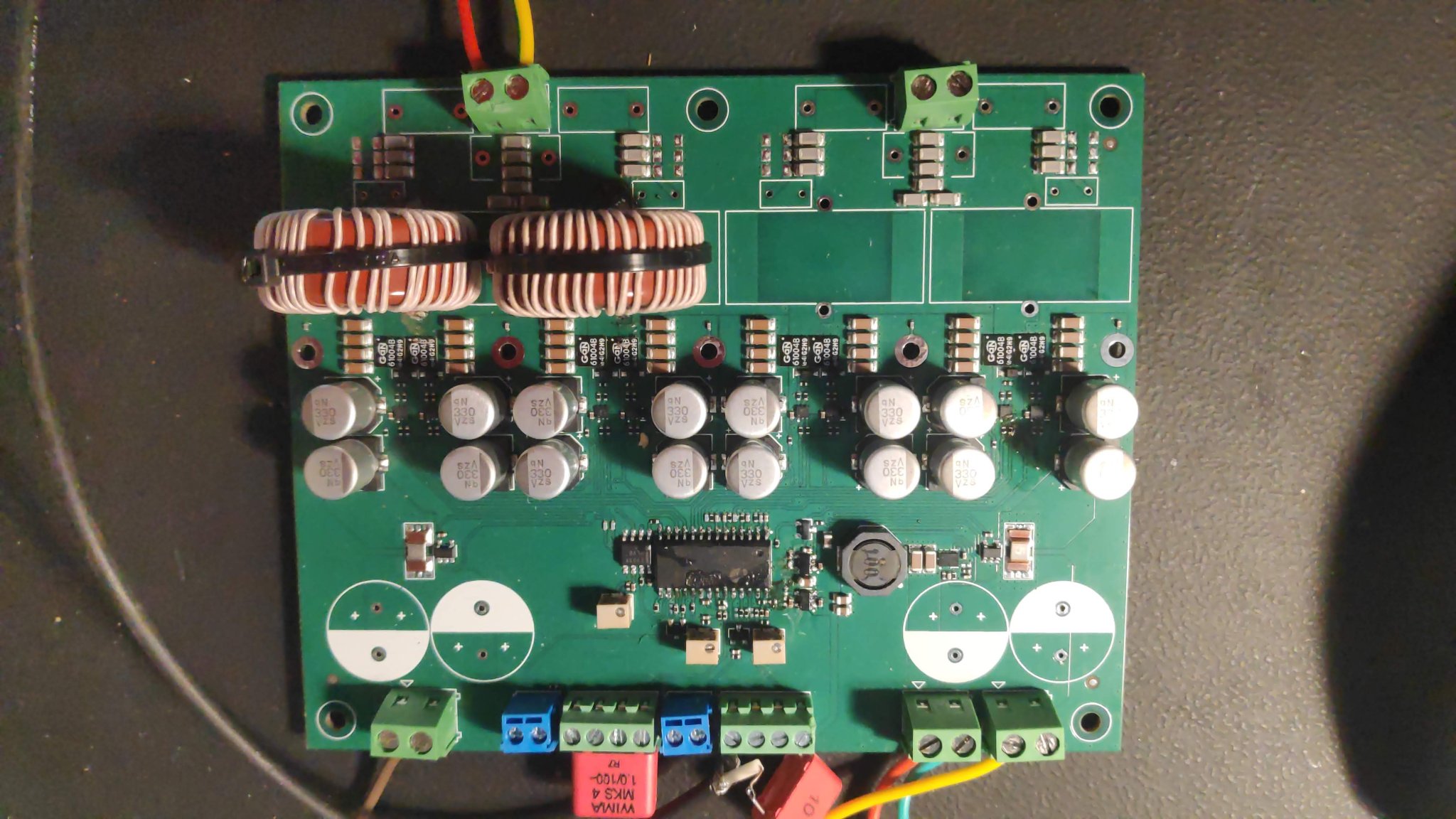

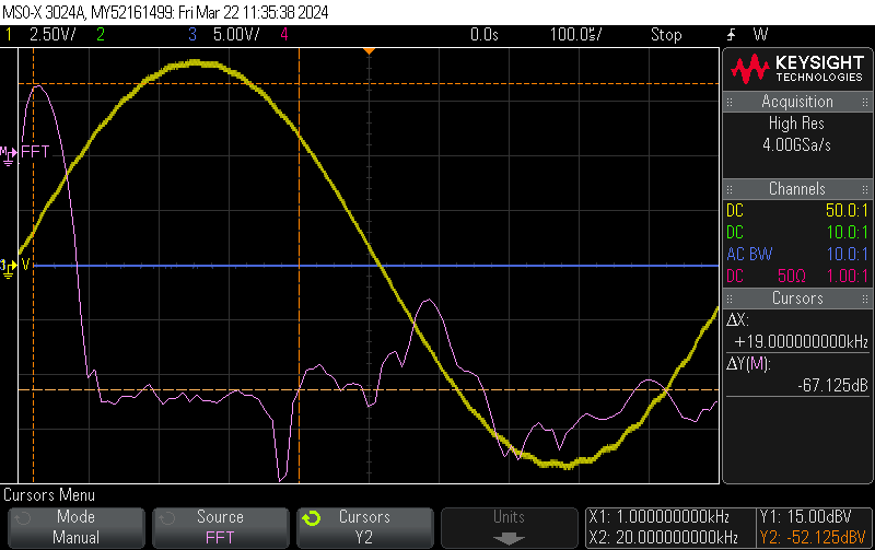

I've in the process of testing my new Tripath Class D amp (TC2001).
Design is based off the 41Hz Amp 4 schematic.
I've gone with GaN output transistors mainly because they don't have any reverse recovery so have much cleaner switching transitions.
Output filter is still a work in progress - currently running at 26uH inductor into C0G ceramics with the posibilty of adding a film if needed. Running at about 30kHz low pass as this will be used for a mid speaker (60-1.2kHz). Currently no Zobel which is why you can see a peak at 30kHz in the FFT. If anyone has any tips on filter implementaiton let me know. Scope is only 8-bit so can't measure accurately below about -60dB.
First test is into a 4R resistive load. I'll try running them into speakers later on this week when I'm happy with the performance.

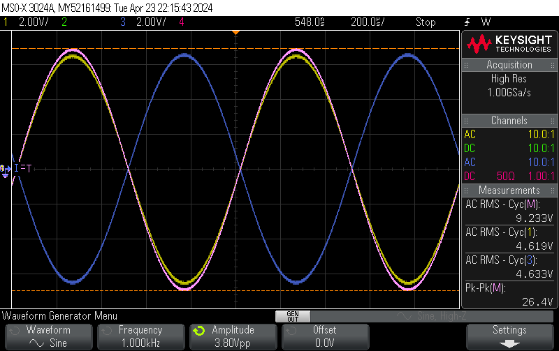

Finally got around to adding the zobel network (15.7R + 47nF cap) with an amobeads in each capacitor leg.
The idea of using amobeads was to supress the high frequency losses in the zobel resistors (everthing above ~300kHz) although other magnetic materials may be more suitable - it's just what I had on my desk.
The zobel has managed to get rid of the 30kHz filter resonance even with high impedance loads (15R).
I noticed that the output stage gain is a bit high when running from a 24V supply so this could be tweeked to improve SNR by a few dBs.
Next stage is to test with xover and speaker, and then to put it all in a box.
Let me know what you think of my progress or if anyone wants schematic or PCB layouts
