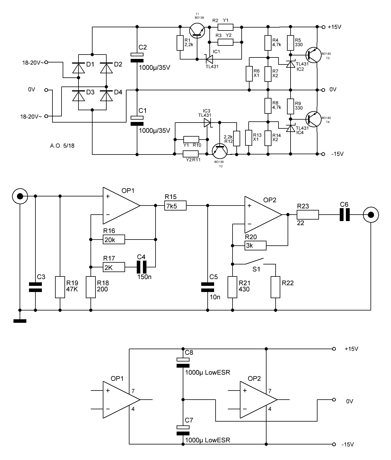

I also made a PCB, with a dual mono design, for each channel a separate power supply. It is a modified MD Elektor circuit.
When you use other OP`s, you must be aware that the current draw can be different, which can be important for the current sources setup . More info under "power supplies".

What about swapping the order of the RIAA eq stages, putting the bass lift stage first and the low pass stage second?
This would follow what Erno Borbely did with this discrete FET RIAA preamp in The Audio Amateur many years ago.
Unfortunately Borbely's all FET designs became impossible to do nowadays, because FETs have vanished from the market. So chips are the only thing to work with in DIY.
There is a very good reason to to use a low-pass stage at the input of sn RIAA phono preamp : clicks, which are caused by dirt or fine scratches. These clicks have fast transients and a surprisingly high amplitude and can and do overdrive input stages, which not only distorts the unwanted transients but also widens the resulting audio dropout. Using a low-pass filter with low or no voltage gain will lessen the clicks and even reduce the amplitude, so they become much less pronounced. As these transients do not contain much low-frequencies the high pass filter of the bass lift will not amplify the clicks. This way slight contamination of a vinyl records could be rendered inaudible.
