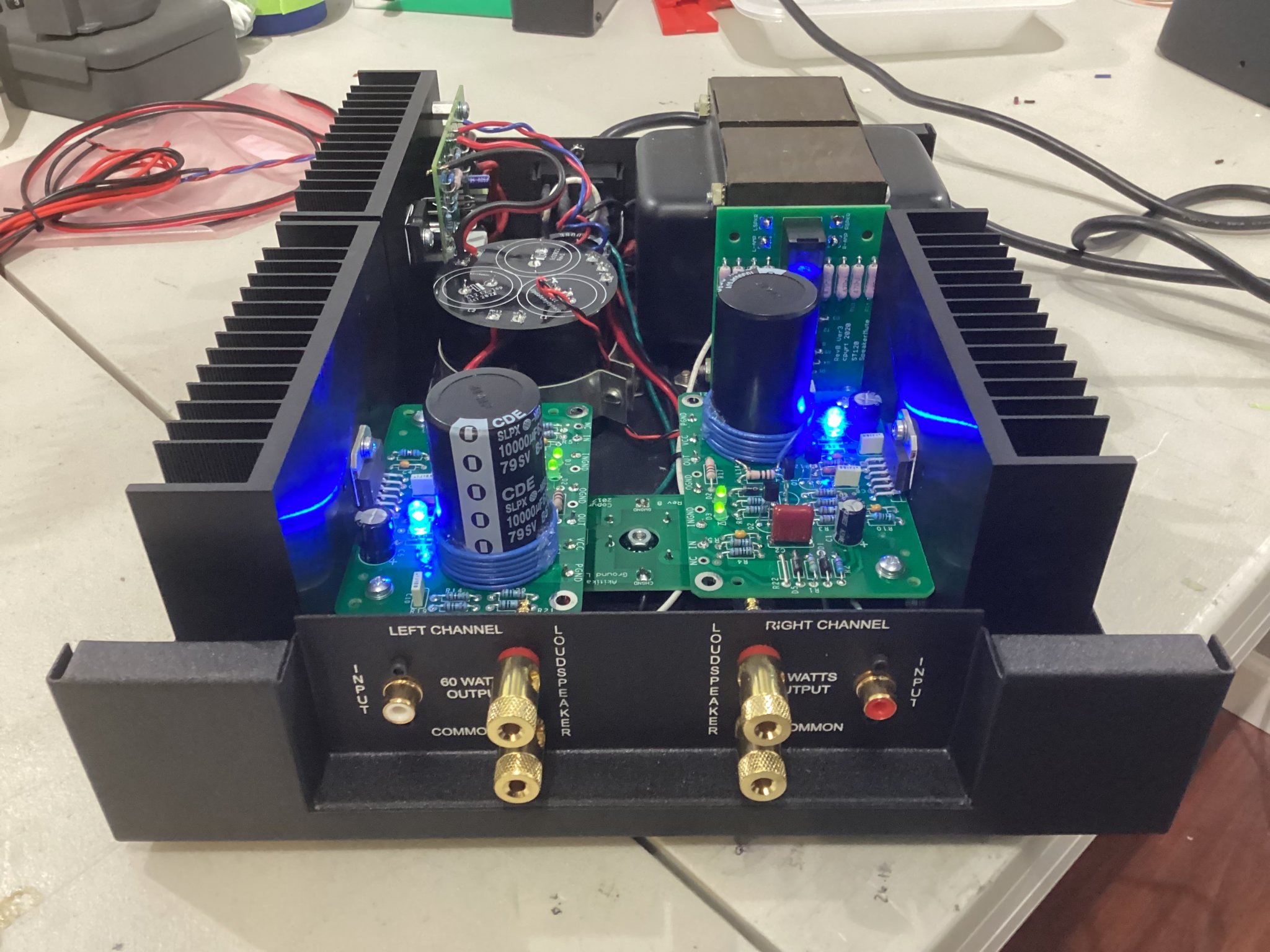

Starting another Update My Dynaco Stereo 120 complete rebuild kit. My first of these had a nearly flawless chassis, transformer and cover, but of the several carcasses I have remaining, all have some rust on the chassis. Being chrome plated it is not a simple matter to restore the chassis. I looked into strip and rechrome, and it seems prohibitively expensive.

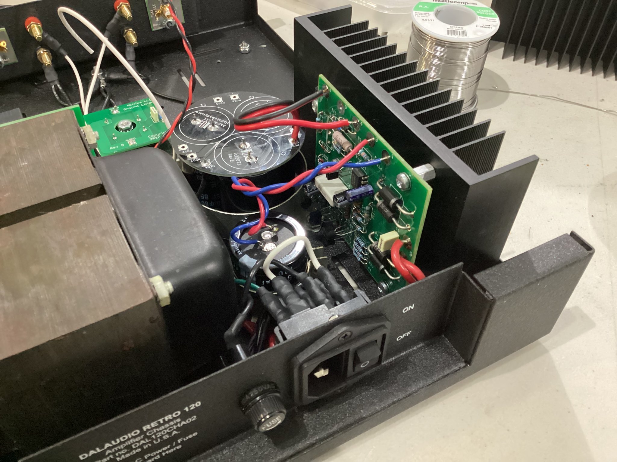

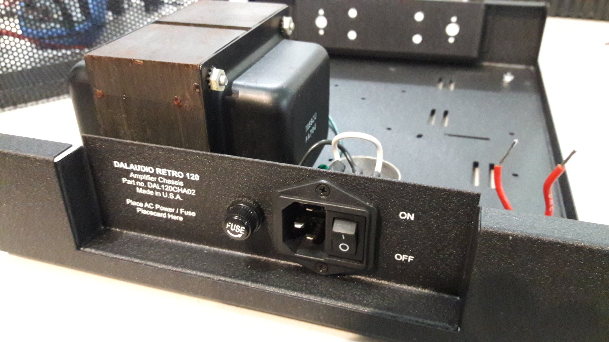

Since I am replacing everything in the amp with Dan Joffe’s LM3886 based complete rebuild kit, I wanted something that looked as good as it sounds. It does require the stock Dynaco transformer be moved slightly, and the the use of a smaller GMA fuse holder, due to proximity of transformer.

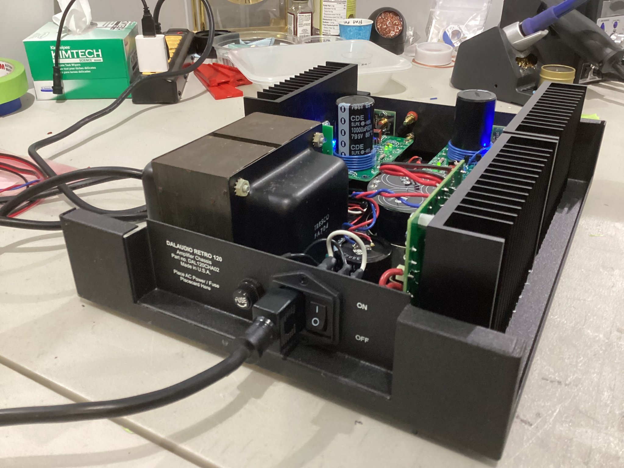

at this point I have located and mounted the transformer, and wired the IEC power receptacle and fuse holder. Since the C-9 cap is also close to the installed power receptacle wiring, I test fit it in place to make sure there was no interference. Everything else will be straightforward, so the next steps will be to build and install the power supply board, and associated C-12 capacitor replacement. The thickness of the chassis is a lighter gauge steel, but seems more than adequate. More to follow.

After a lengthy delay (3 weeks for a USPS shipment) for some parts, the power supply section has been completed. Dan originally developed this power supply for use as an upgrade to an otherwise original ST120, so it has similar output.
As can be seen, with the DALAudio chassis, the IEC power socket makes the available real estate somewhat crowded, however it is still adequate. I elected to use crimp on connectors to slide onto the receptacle and switch, if you simply soldered the wires it would provide more space.

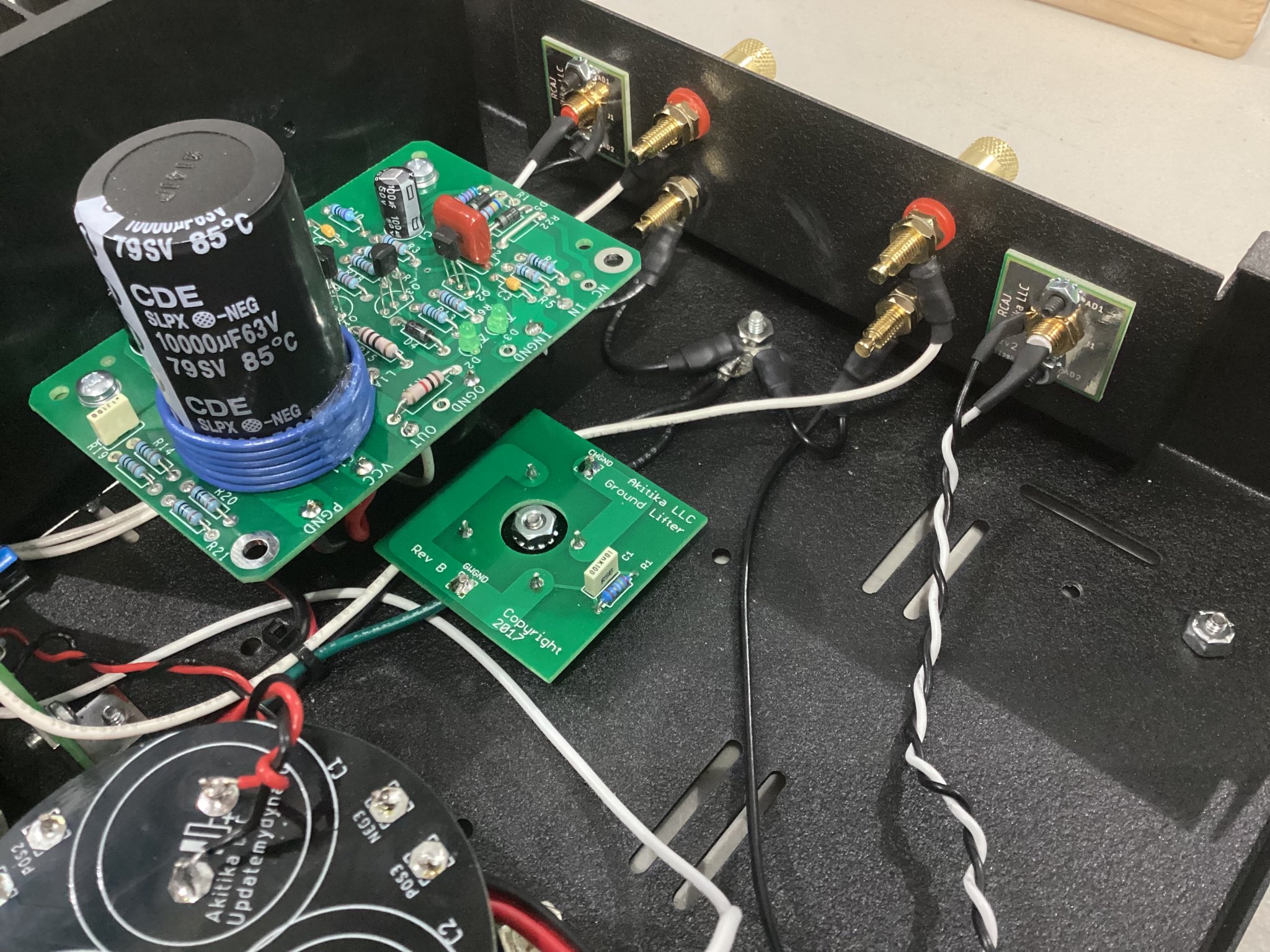

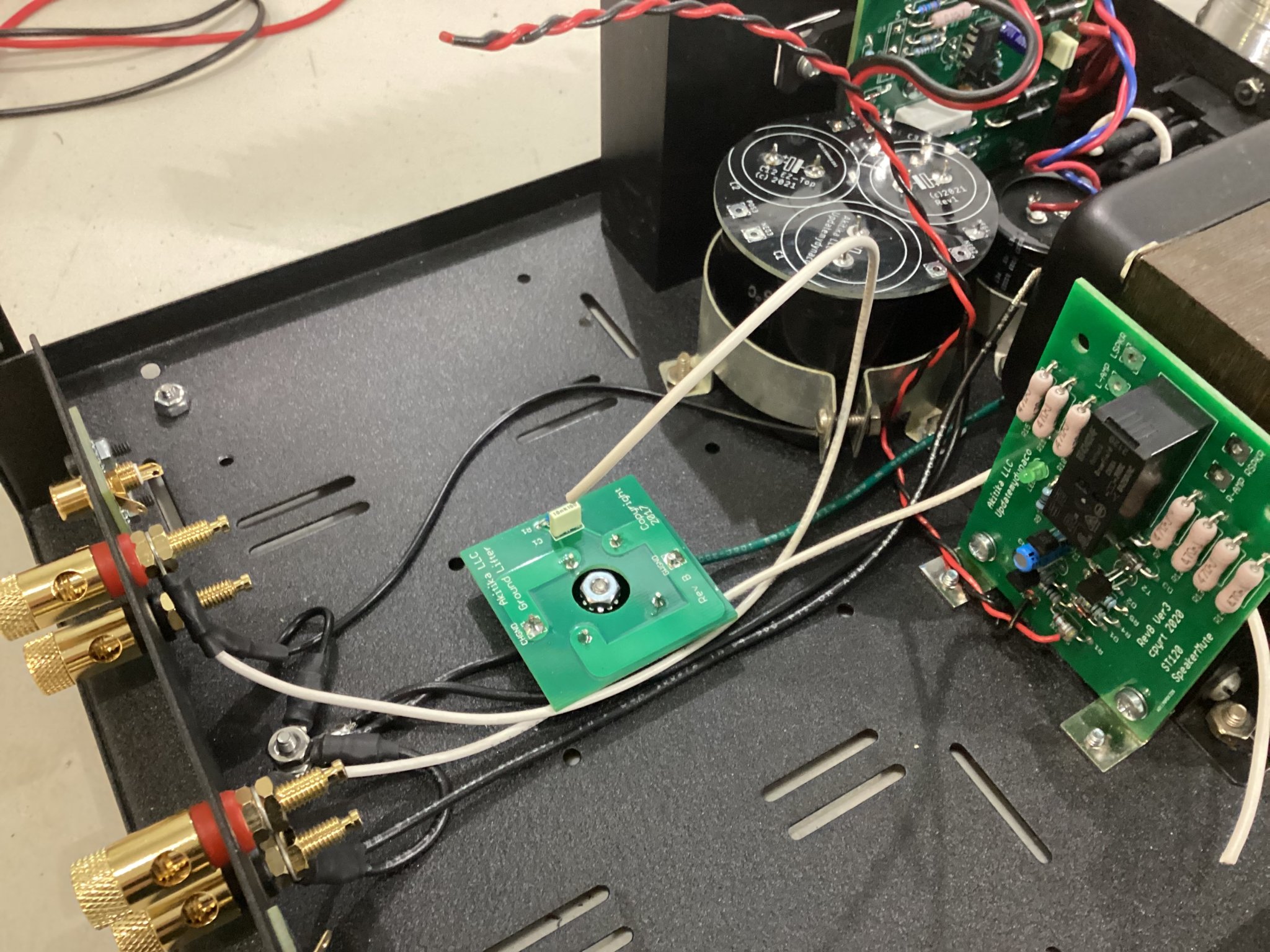

While waiting for parts I installed the elevated ground, which provides some isolation for output grounds from the power cord ground (green wire into elevated ground.). I also installed the RCA input jacks and Parts Express gold output terminals. The small board hiding behind the transformer is the optional speaker relay kit, which incorporates a delay to allow caps to charge before connecting outputs from the amp boards (next to be built.)
The output signal and ground wires were added (while still waiting for parts,) where again I elected for crimp on connectors with heat shrink to keep things tidy. The comprehensive complete upgrade kit (all new except transformer) uses Dan’s largest heatsink, which calls for a few resistor and one cap upgrade on the board to allow more power to be delivered.

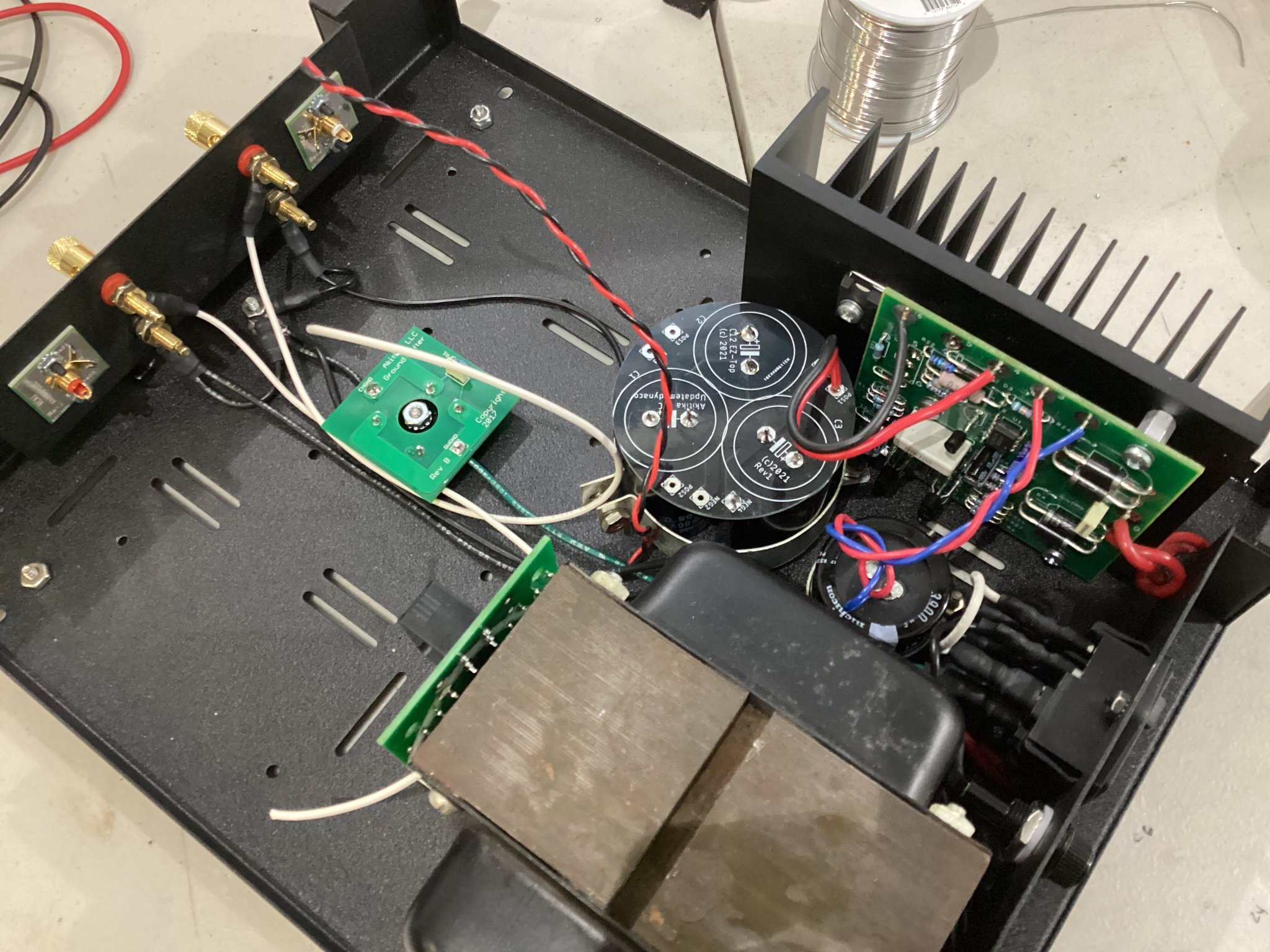

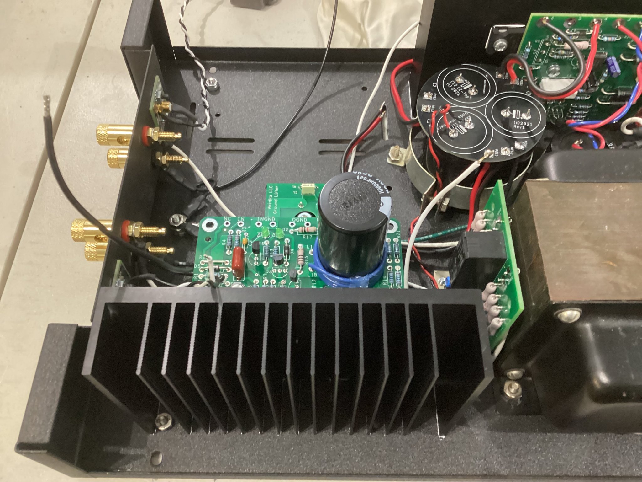

The original large diameter 3300uF C-12 gets upgraded to three 6800uF 80v caps for a total of 20,400uF, and the smaller 500uF C-9 filter cap gets upgrade to a 3900uF. Results are more output power, most noticeable in low frequency reproduction. The original C-11 is eliminated with these two upgrades. With the power supply completed, I powered it up, measuring 71.89 volts DC, which is specified to be 72+/- 2 volts. So far so good.
I have just started the first amplifier module, and further progress will be forthcoming.

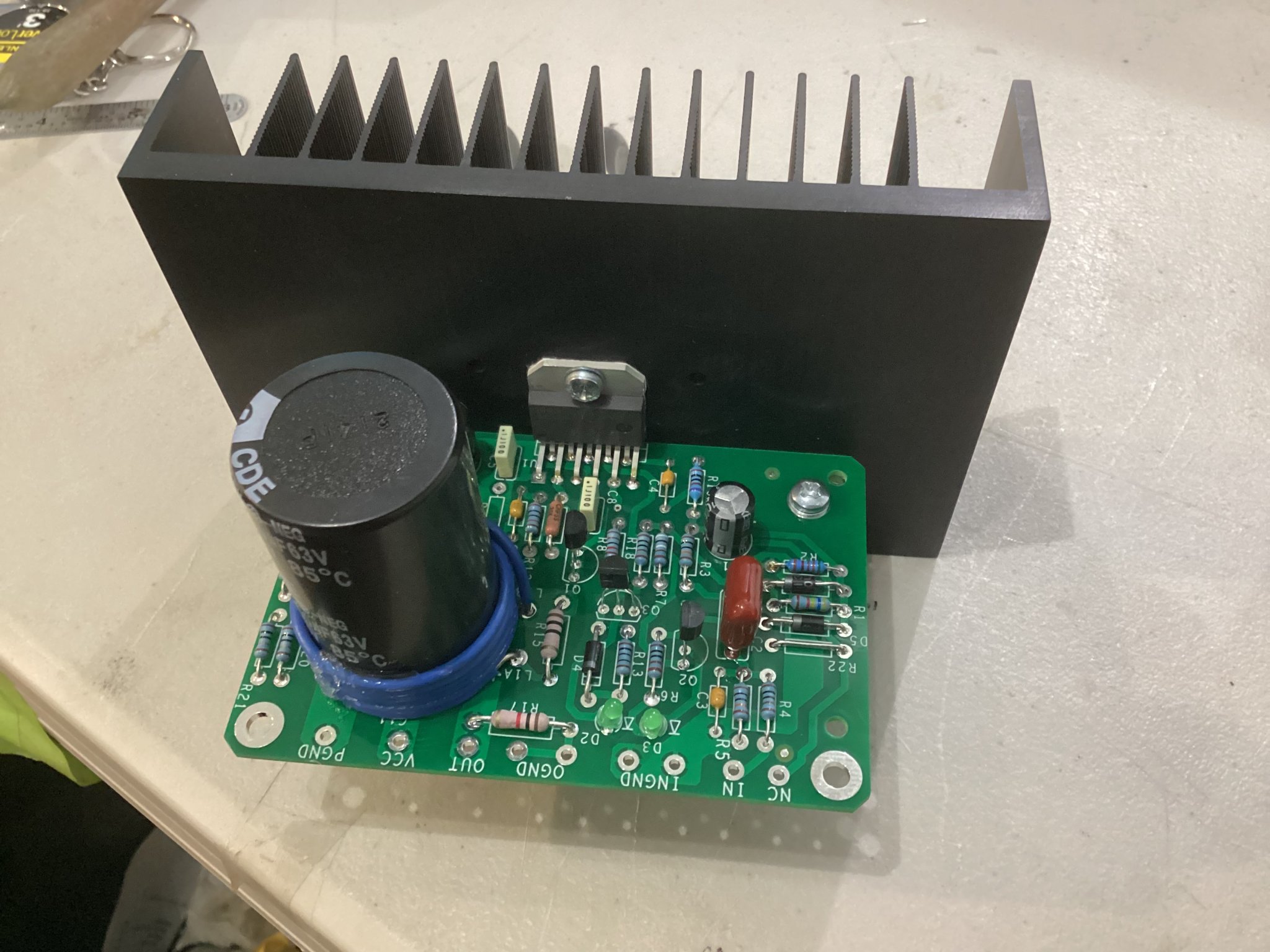

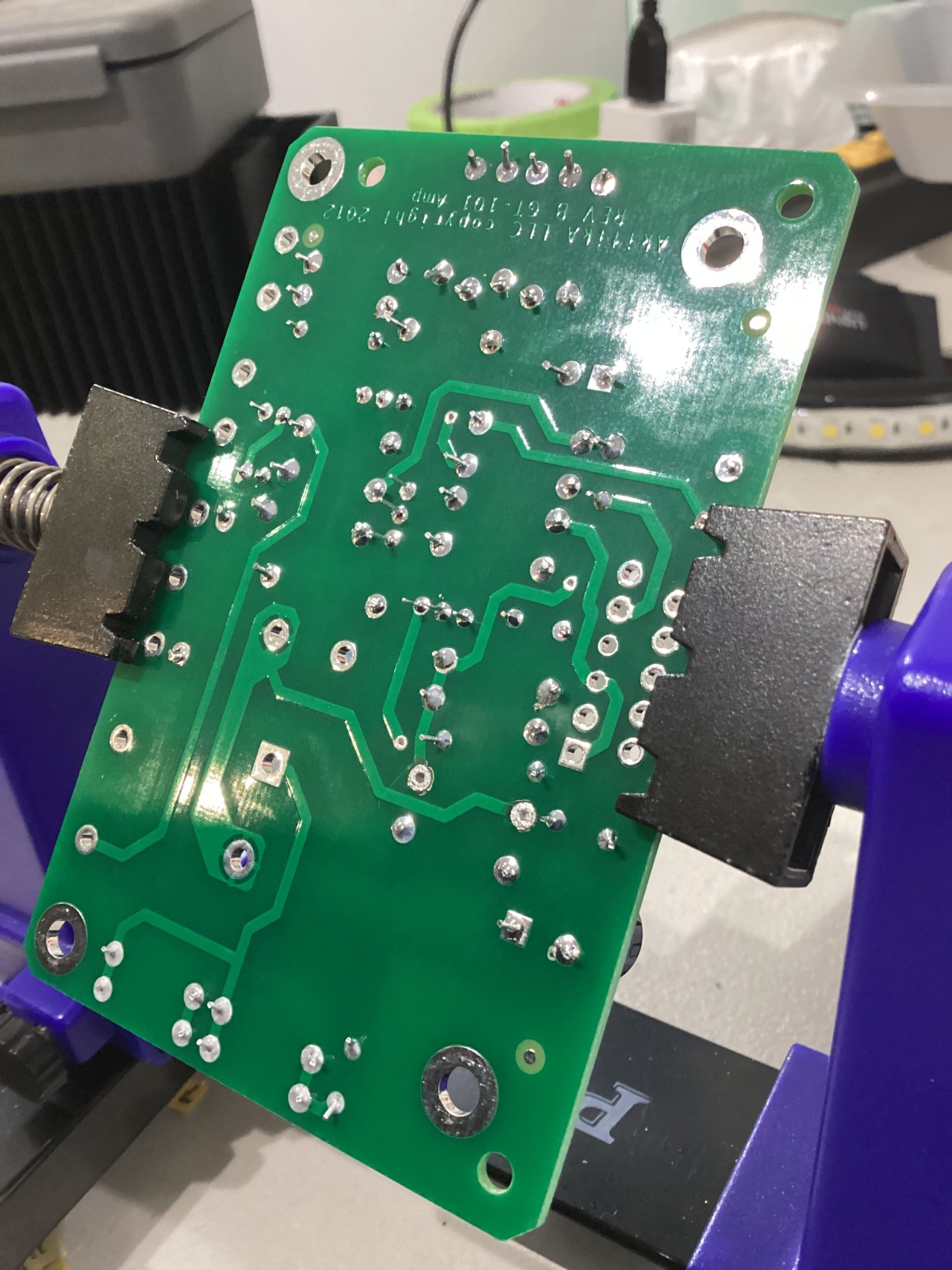

Amplifier modules are the original Akatika GT-101 units, as stated above, based upon the LM3886. These are mounted on the same large type heat sink as the power supply. The first was assembled (below) and used to test the effectiveness of the ultrasonic cleaner on flux removal.
They were first scrubbed with a toothbrush and isopropyl alcohol, then cycled for 5 mins at 140F in a 15:1 dilution of Simple Green “Crystal,” which removed all of the greasy residue. Final rinse with a squirt bottle of Isopropyl, then blow dried.
The board mounted onto the heatsink, and the LM3886 fitted and pins soldered. At this stage I elected to attach the assembly to the chassis, where it is required to use some care. If you apply heatsink compound to the base of the heatsink, the chassis black crinkle paint will show any excess if you misalign, which does not cleanup easily.
The input signal and ground, output (to the speaker relay) and 72vdc power supply and its ground are trimmed to length, ready to connect.

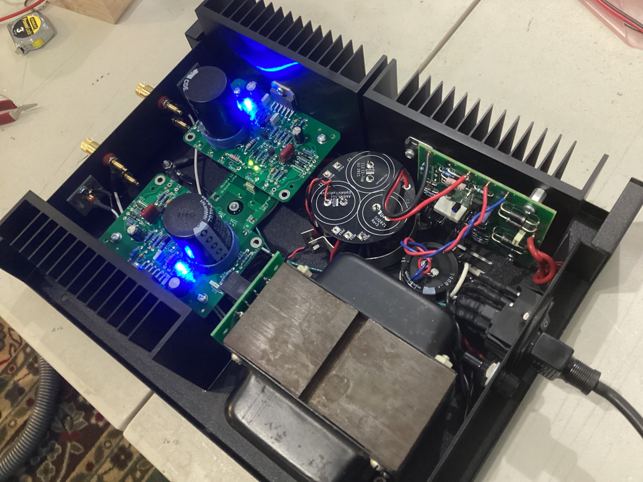

Finally, with both amp modules mounted, all connections made, initial power up illuminates the two green LEDs, and the optional blue LED (which replaces one of the resistors. The basic tests have you measure DC offset, falling to below 100 millivolts after a few minutes warmup, the check for noise after connecting speakers with no input connected. Mine is dead quiet, and this particular transformer has no detectable hum.
The point of this exercise for me was to create an all new (save the transformer) amp from known quality components, in a compact package. I will be looking for a toroidal transformer that delivers at 70+ volts for the two remaining Dynaco ST120 chassis I have. My take on the sound reproduction is very positive. Compared to my VTA ST120 tube amp, not quite as powerful, but excellent bass and very pleasant on horns and cymbals in the upper frequecies.

One of the first things I noted was the heat generated. I am currently playing WAV files from windows media player through a USB cable to my DAC direct to the amp (no pre amp.). After the first hour, driving it at better than 90% DAC level out, barely warm to the touch, and there, only under the base of the chassis where the heatsink mounts.
I have no way of knowing what the actual output wattage is, but it is not lacking if relative to other similar spec amps. As I stated above, not quite as loud as my VTA 120 tube amp I normally run, but pretty close. I do like higher listening levels, as it seems to better reveal the details in the recording, and this amp is plenty loud for that purpose.

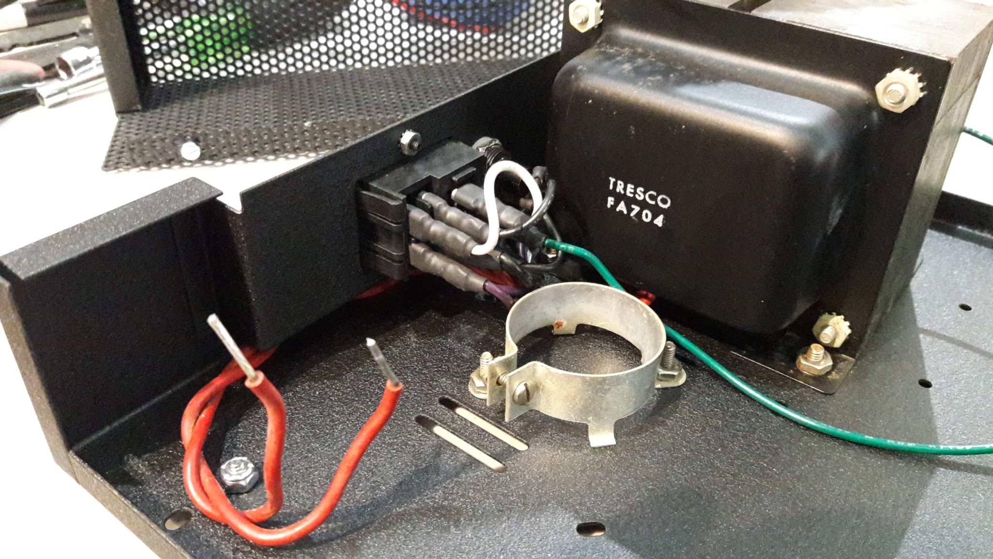

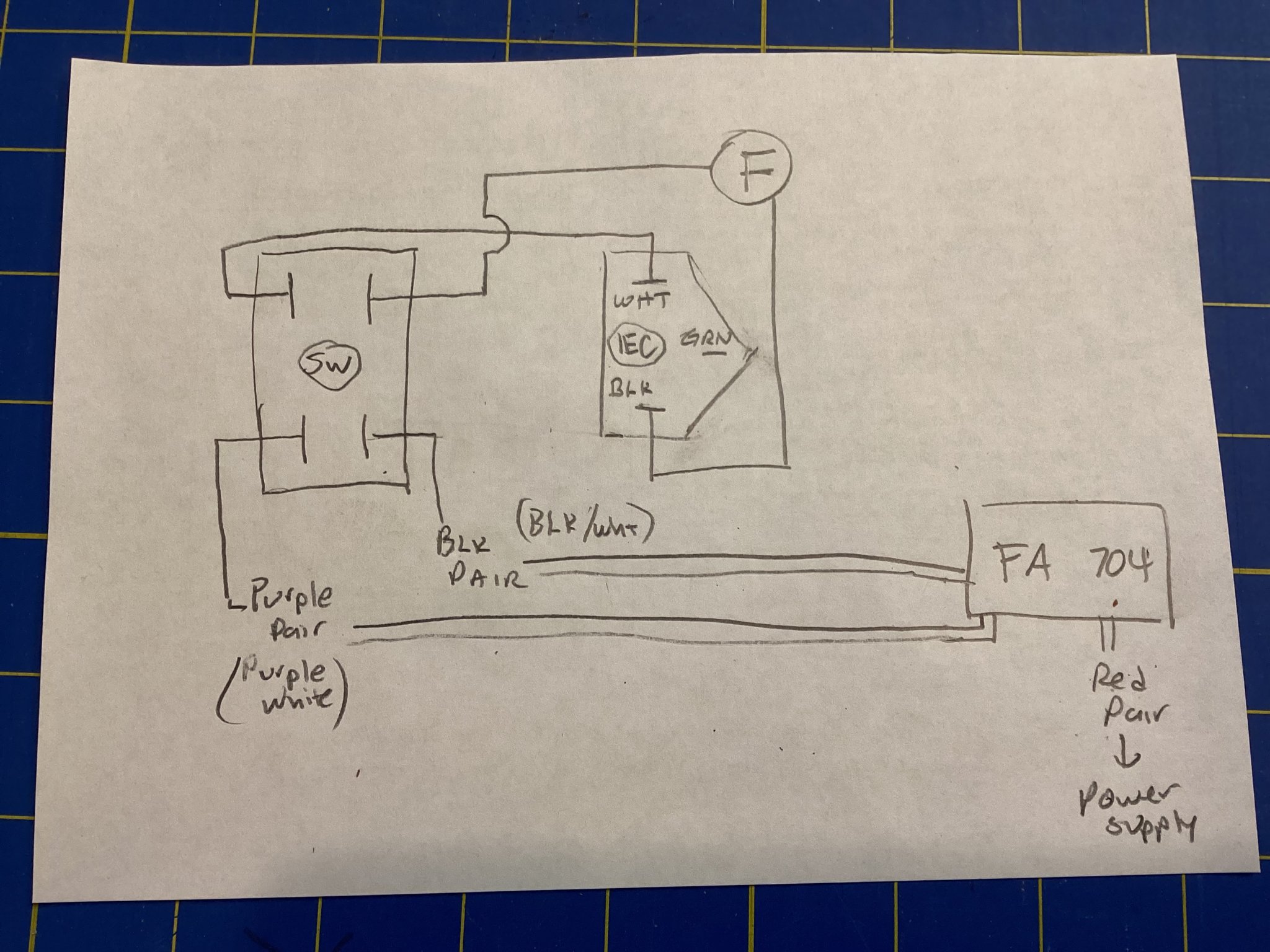

I queried DalAudio, who I got the chassis and IEC switch combo from, and he could not provide wiring advice because of liability issues. He does have photos of inside his amps that I used to determine which power wire(s) are switched. I asked him to confirm my guesstimation, and got a thumbs up. I did not save the drawing, but I will open up the amp and see what I can tell you. Standby…
I just made this sketch from looking at what I did. The pairs from the FA 704 “purple/purple white,“ and “black/black white“ connect to the bottom of the switch. You can join them either on the poles or into a single wire first, then to the poles of the switch. The black (hot) AC input from the IEC goes through the fuse, then to one of the top poles of the switch. The white (neutral) AC input from the IEC goes to the opposite top pole. The sketch is depicting the inside view. In this setup, both the neutral and the hot wire are switched, adding some redundancy to the switch’s ”off” position for added safety.
