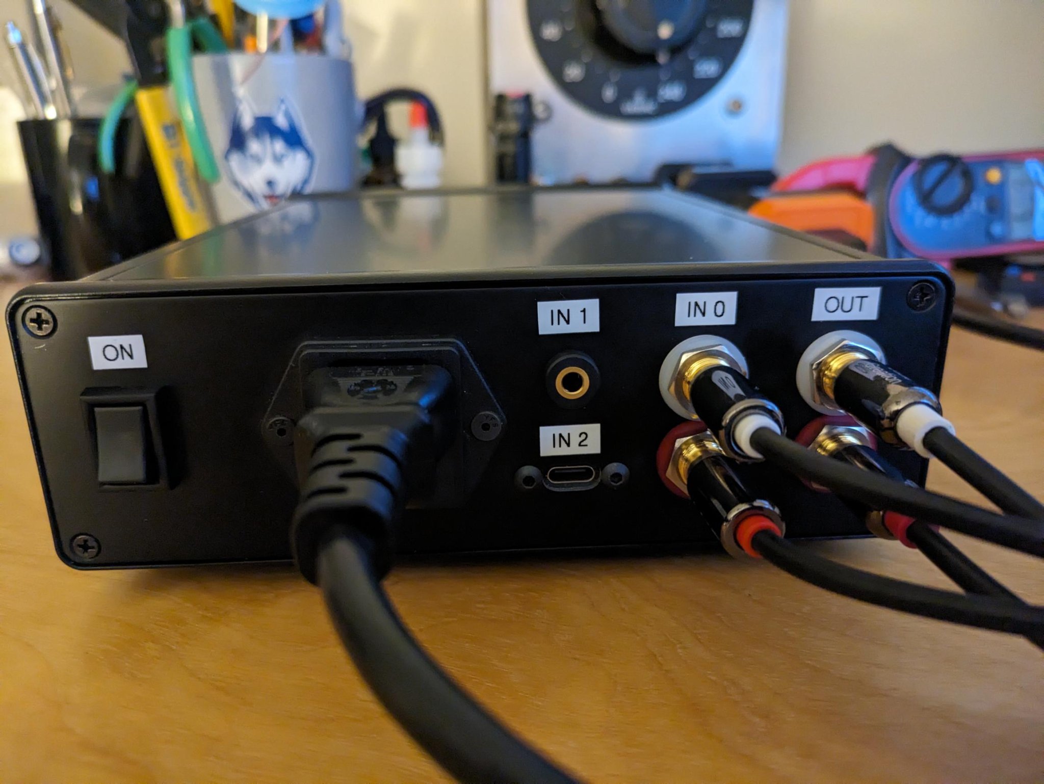

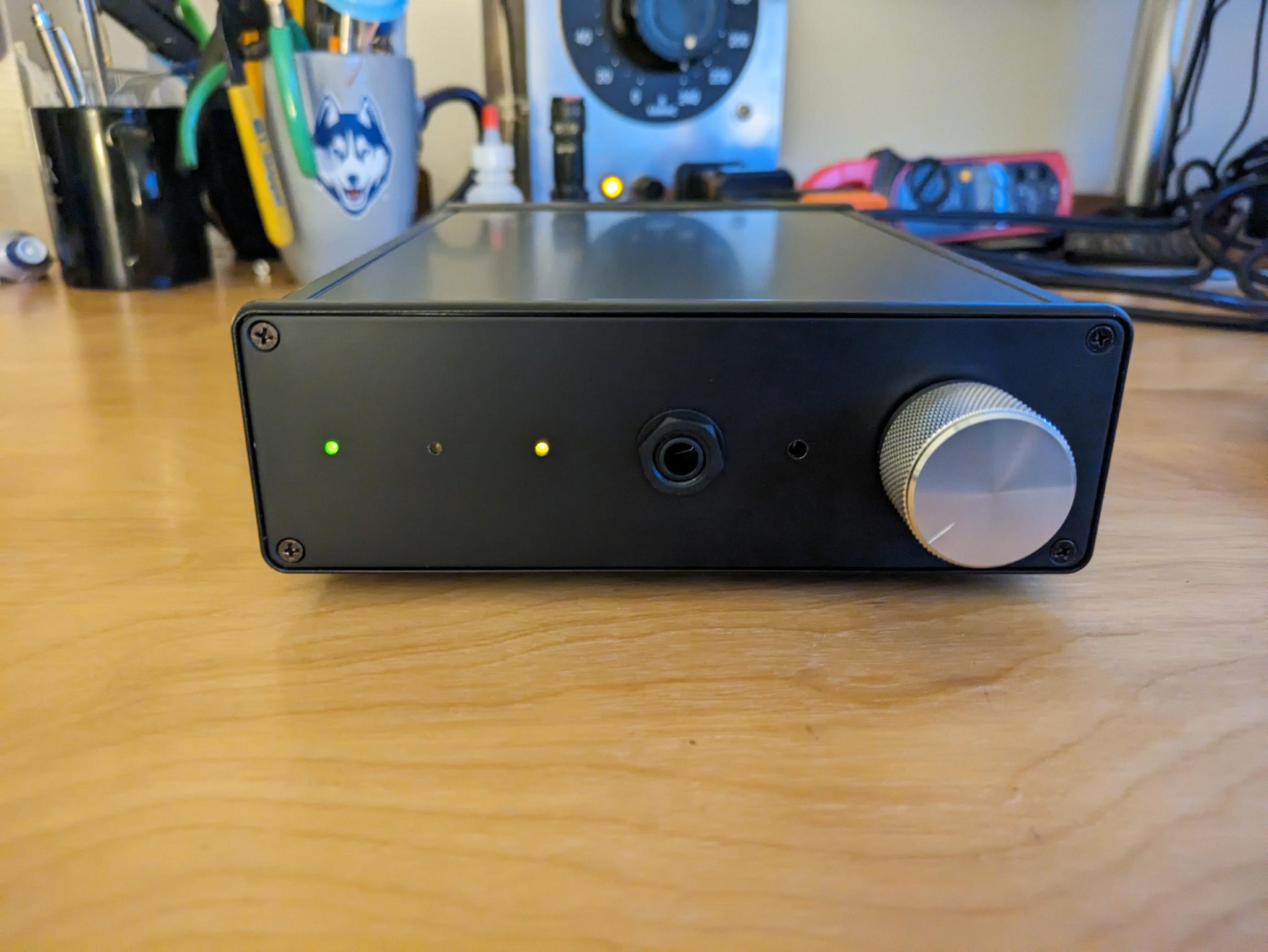

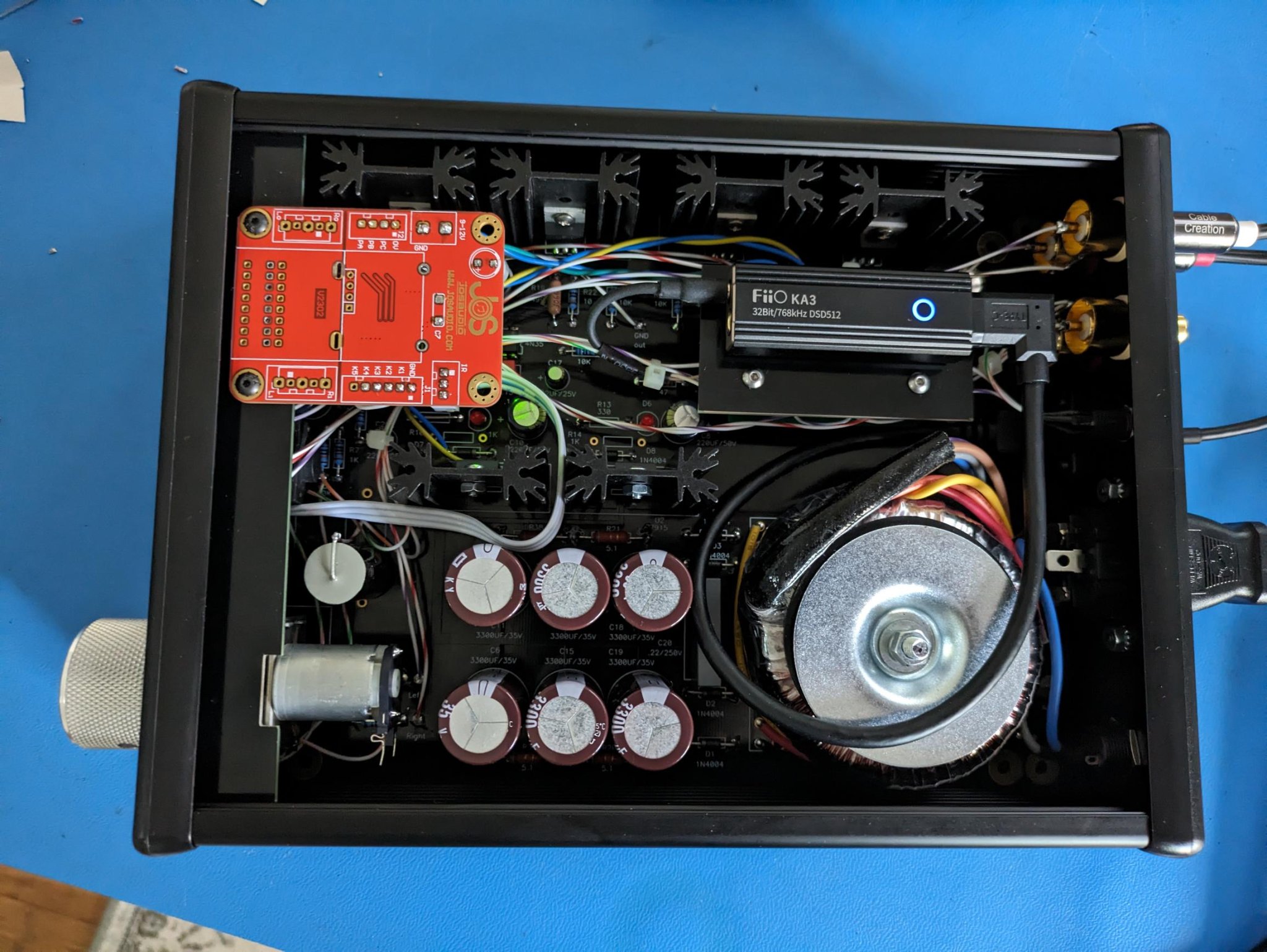

The way you wired it, you basically grounded the Whammy directly to the chassis. Is the chassis connected to GND from the power cable?
Yes, the safety ground is connected to the chassis via IEC screw on some bare chassis m I ground down to raw metal (which I just learned is not necessarily necessary?).
The important thing to keep in mind here is that I had trouble figuring out how to do the LED power indicator so... I may not be the best person to reference in this scenario.
In any case, the intent wasn't really to ground it to chassis, but to audio ground. The chassis grounding (if it's even a thing), was by accident.
@SeeRockCity - Check the resistance between the wire you've wedged in there and the ground at the power inlet. If you haven't scraped away some of the anodization / paint on the front panel, you likely won't have a very good connection (if it was your intent to ground it to the chassis).
It was not. It is mostly to ground to the audio ground. Any grounding to chassis is incidental.

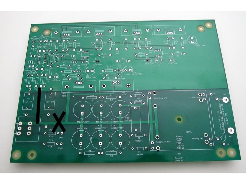

I had a noise issue with this build when using the unit in preamp mode.
I detailed this a bit in post #5110.
The noise issue was troubling at first. I solved it by experimenting.
Now, after looking at the board, there is clearly a flaw with the layout. Maybe it has been discussed, I did not read many of the posts. Noise will not be noticeable with headphones, but it can be significant when using in "preamp" mode attached to an amp with a lot of gain.
If you look at the ground trace that runs from the power supply side to the amp side, next to C11, all of the board current returns thru this trace. The pot and input ground are also on the power side of the board. They are referenced to the wrong ground point. Noise is going to be added.
I'm using a wired pot so it was easy for me to change my input and pot grounds. If you are using the mounted pot and have noise, it can be resolved by cutting the trace shown with a "X" and running a wire between the pot ground over to the ground at the 100 Kohm resistors at the opamp input. You could easily run the wire on the bottom side of the board. It does not need to be heavy gauge. It's essentially what I have done with my wires. I didn't need to cut the trace.
Hope this makes sense.

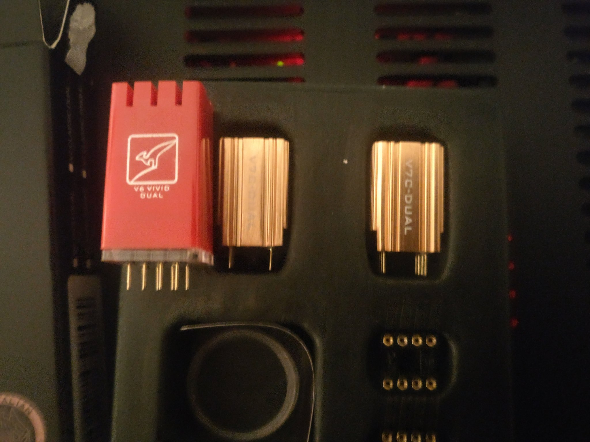

Last week I found some time to do a good comparrison. And try some tweeking.
First comparison was between the Whammy as I build it with the Burson Vivid V6 opamp.

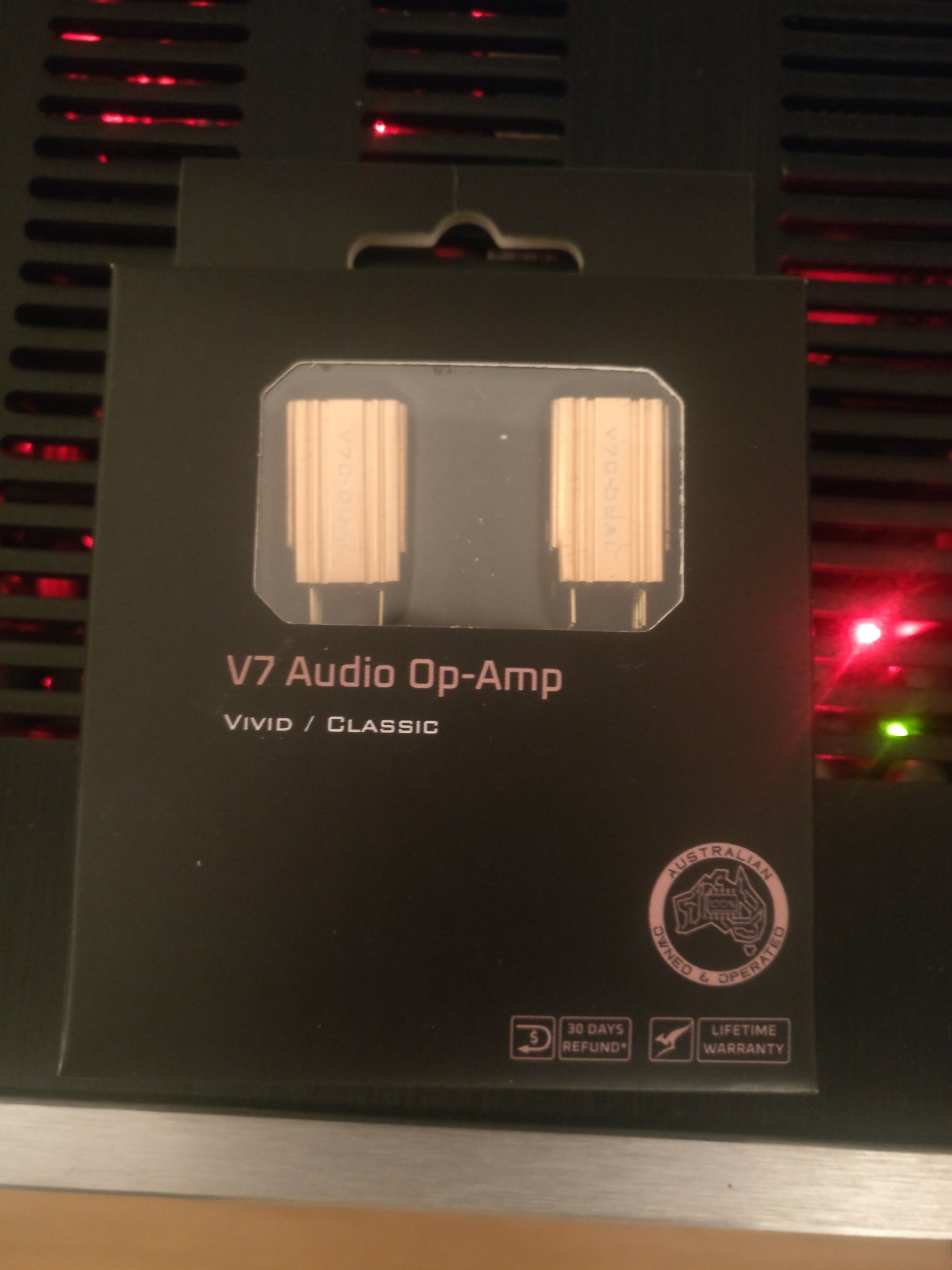

John was so kind to ask me if I would test and try another of their opamps. Since I had the Vivid. I thought it would be nice to try the classic, becouse of it's different sound signature.
A few weeks later a parcell arived, at first I thought it was a mistake, What did I know in the meantime a new version, the V7 had come out. So I got one box with 2 Dual V7 Classic opamps, (WOW nice!). these are in a way more luxery pakkage, really nice, Aluminium heatsink cover instead of the plastic one of the V6.

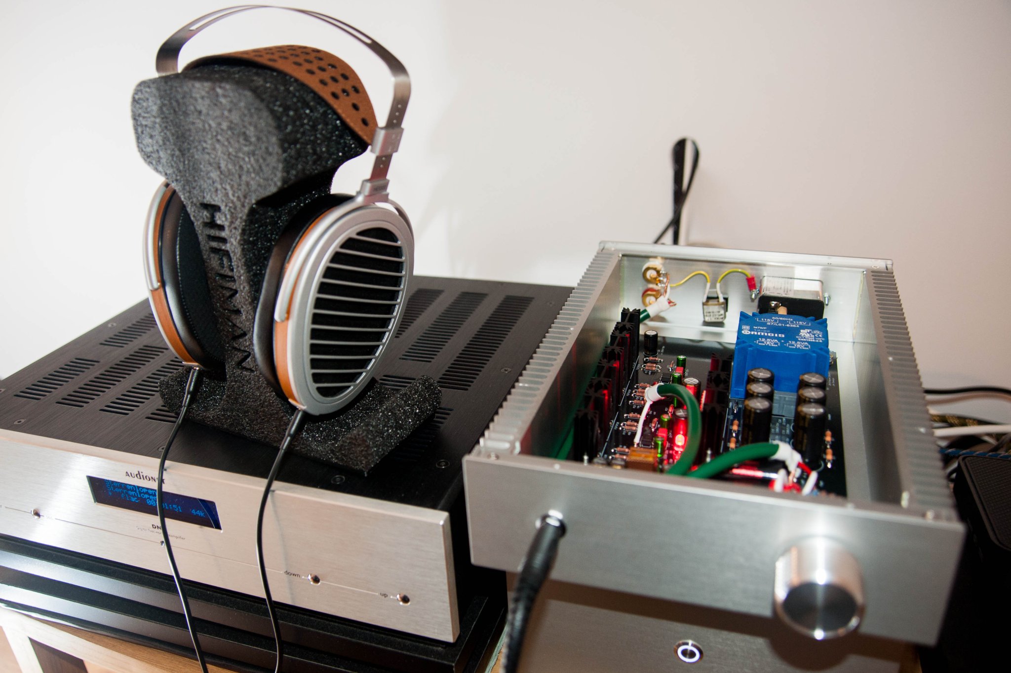

I decided to connect the Whammy to my main Audio set-up with the Hifiman HE-1000 V2 for this comparrison (normally I Listen with it in the office on a different set-up).
Made a playlist, and started listening. with it as I build it, First impression, o wow, this Streamer-DAC combo is indeed a bit better! Any way after a few songs I put the Classic V7 in. At the first secends I noticed allready a difference in sound signature, this one is way more laidback, I think what some people will call more analog. I woukd describe it as more colouration, butt little less sparkling and after the same amount of songs I turned it back to the V6 Vivid again.
immediately I noticed more fresh, crispy-nes I liked about it, Bass is more accuratly.
And To get in in proportions they both sound very good,
To my opinion it's mainly about taste of soundsignature, In the end I Preffered the Vivid 6, So I stick with that for now.
A more fare comparrison between the V6 and newer V7 would be with both Vivid's so the Sound signature is the same, but only versions are compared.
Here ar some pic's of the comparrison.
