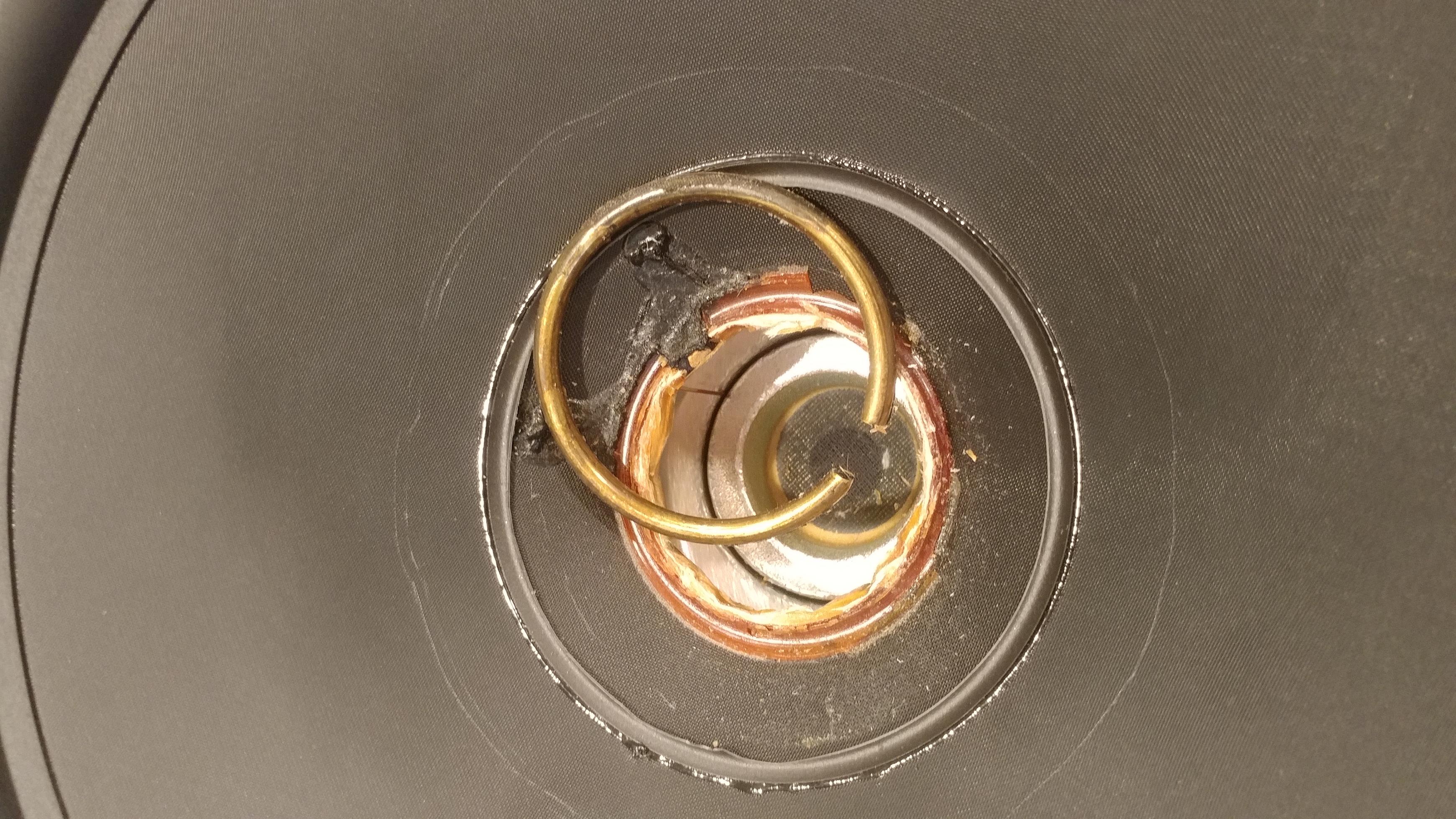

What is the nose ring for?
My friends often bring me speakers in need of repair in spite of my protestations of relative ignorance of the subject.
The attached photo is of a 12 woofer minus a big ring that came unglued. I'm guessing the ring is to add mass to the cone but I'd like to know more about that if someone can take a moment to enlighten me.
I'm planning to reglue it with contact cement unless there are better options. It gets hot here in Phoenix at times and I find adhesives don't always live up to their promise here.

It is probably just a simple tweak to tune a cab adding mass, but remembers me too shorted turn to give some braking effect and some over-excursion limiter.
For references :
Seas :
"The "33F" was made in a number of versions: 33F-WB, 33F-WK, 33F-WKA and 33F-ZBX and some of these with "DD", dynamic damping:.The "DD" refers to "two high conducting rings placed at each end of the motor coil. These act as eddy current brakes, firmly halting additional cone excursion as the rings enter the magnetic field". Thanks to Martin Colloms/High Performance Loudspeakers, page 79, 6th edition."

OK- second post here, so takes this with a grain of salt.
I suspect it was a multi-purpose component. As others have already stated: added mass to lower Fs, looks like brass which is a little strange because copper is the metal of choice for inductive "shorting rings". Looks like it may have been directly attached to the top of the VC Former? If so, that's a high-heat interface. I would only recommend hi-temp epoxies for that application. In a pinch, JBWeld could work. Just be very attentive not to coat the coils, as I believe it has particulate aluminum fillers in it (I could be wrong about that though) check the MSDS.
Good luck on the driver rebuild!
Sublimacon, it is indeed installed above and outside the VC former. Given your remark about heat, the failure isn’t too remarkable, however it’s apparent that it wasn’t bedded well the first time. Orange silicone would have been an excellent choice for adhesive. Unfortunately I just set it in contact cement so what’s done is done. I suspect it will be good for another 10 years.

Never mind about the conductive fillers in JBweld, as it would sit on top of the former/cone epoxy joint anyway.
Yeah, contact cement wouldn't have been my first choice, hi-temp RTV (orange) would of been better.
If your looking to make midrange noise from that driver - soft adhesives are not what you want. They are typically heavy for volume, dampen energy more so as Fq increases.
That driver is a little curiosity!
Looks like a stamped steel basket, not a huge motor, yet loaded with a hidden brass treasure. Somebody was crafting a semi-custom piece, for low $'s.

Yeah I thought I remembered there being particulate metal in it. I thought it was aluminum? Never seen JBweld develop rust coloration before - hum! I'll have to look up the msds on it.
Yeah, epoxy with iron/steel could caused massive T/S shifts. Good, bad, who knows with this driver? It probably would've mutually coupled with the brass shorting ring causing unpredictable results.

JB Weld would be problematic in this application, as it is actually loaded with powdered steel. You can pick up the hardened cement with a magnet.
Wrenchone,
Perhaps you can pick up the hardened cement with a magnet if it's hardened to ferrous metal, or if you have mixed ferrous metal in the epoxy, but it's not "loaded with powdered steel" when packaged.
JB Weld's ingredients are bisphenol-A-(epichlorhydrin), epoxy resin, crystalline silica, and carbon black, with trace amounts of titanium dioxide.
It has no more magnetic properties than plastic, just checked with magnets to verify that.
JB weld is non-conductive, it is considered an insulator.
