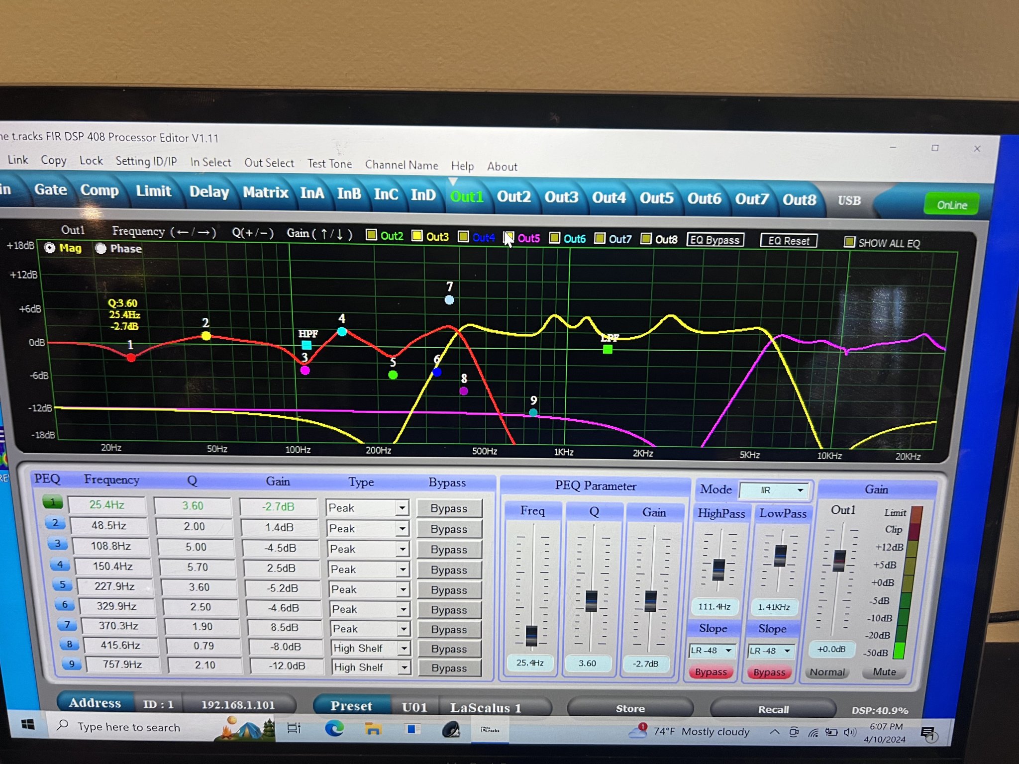

no, it doesn't. Part of that is that the 2226 has a strong response past 1000Hz, part of it is that I'm using parametric EQ to soothe the horn response, as well as using shelf eq filters at the crossover points in lieu of named filters. As such, I've been able to tune it to have a somewhat linear phase response and a pretty flat frequency response at 1mThanks - - -and it doesn't seem in the graph to lose any upper bass either
this doesn't include the shelf eq filters that I'm using for the crossover, but here you go:post your EQ settings would be nice

Filter 1: ON PK Fc 109.5 Hz Gain -3.20 dB Q 9.403
Filter 2: ON PK Fc 148.5 Hz Gain 3.20 dB Q 7.420
Filter 3: ON PK Fc 227.0 Hz Gain -9.50 dB Q 4.500
Filter 4: ON PK Fc 652.0 Hz Gain -4.00 dB Q 4.473
Filter 5: ON PK Fc 807.0 Hz Gain -3.00 dB Q 1.362
Filter 6: ON PK Fc 939.0 Hz Gain 4.40 dB Q 7.056
Filter 7: ON PK Fc 1154 Hz Gain 7.40 dB Q 1.002
Filter 8: ON PK Fc 1238 Hz Gain 2.70 dB Q 7.400
Filter 9: ON PK Fc 1920 Hz Gain -14.40 dB Q 1.002
Filter 10: ON PK Fc 2053 Hz Gain 12.00 dB Q 1.891
Filter 11: ON PK Fc 2401 Hz Gain 5.00 dB Q 7.015
Filter 12: ON PK Fc 2724 Hz Gain 1.50 dB Q 7.199
Filter 13: ON PK Fc 3045 Hz Gain 0.70 dB Q 7.380
Filter 14: ON PK Fc 3429 Hz Gain 4.50 dB Q 7.403
Filter 15: ON PK Fc 3918 Hz Gain 9.90 dB Q 2.317
Filter 16: ON PK Fc 6513 Hz Gain -2.90 dB Q 1.022
Filter 17: ON PK Fc 9291 Hz Gain -3.00 dB Q 1.046
Filter 18: ON PK Fc 16495 Hz Gain -2.70 dB Q 2.890
Filter 19: ON None
Filter 20: ON None
Filter 1: ON None
I'm crossing at 400 Hz and 5kHz, so filters 4-18 are irrelevant for the woofer. since the JBL extends past 1000Hz, driver overlap has made getting a linear phase response challenging, but I've gotten it pretty close. also, my eq settings are more to tame the horn peaks and nulls of the LaScala bass bin than to manage the woofer itself. YMMV with a direct radiator or other application.great thanks a lot!
If you cross at 800Hz then filter 7 to 18 are irrelevant for the 2226?
They work best with the natural roll-off of the driver. In some instances, I’ve added a -6db butterworth filter a further up from the low pass shelf filter to help it along, or played with the q of the shelf eq to help it along.Are the 12 dB LF suppression by the shelf filters enough in order to be used as highpass for the tweeter and midrange ?
