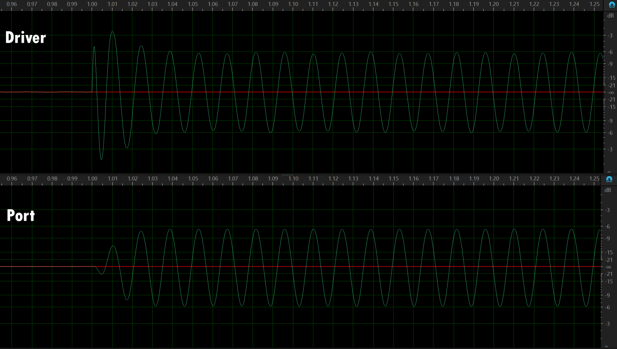

At Fb, the port’s output is 90 degrees behind the driver’s front radiation.
At Fb, the port output lags the driver by 270 degrees, 90 degrees short of 360 degrees
I'm confused to be honest. Does a port lag the driver by 90 or 270 degrees at port tuning freq? I'm sure you agree this should be a universal for any bass reflex regardless of size or tuning. I thought the port is 90 degrees lagging the driver front radiation as you said earlier in the thread. This matches perfectly with my own measurements.
STV's measurements don't look as I had expected, I can't reconcile my measurements showing the port lag as 90 degrees and his 270 degrees. Firstly we can agree the phase of the driver is inverted, but it actually looks to me like one of the two mics is inverted compared to the other. Alternatively the waveform alignment was adjusted, because there seems to be a blip of sound from the port mic before the first sound from the driver. As you said it looks like the port lags 270 degrees, but if the driver mic (or port mic) only was inverted we would see the same 90 degree port lag we get on my measurements and that would make everything click for me.
Or... I suppose it could be my setup that has one mic inverted. It's not always obvious because the pre-amp in the mic can invert. You know what I'll check right now!

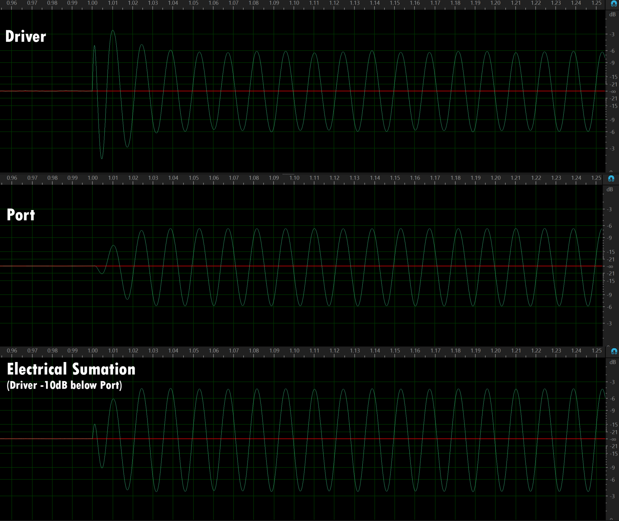

Okay, solved! One of MY mics was inverted! The port is indeed 270 degrees behind the driver, not 90.
Here is the correct image. I've also included the summation of the two waves done in software.
I think the interesting part is that we do not actually see a 'delay' from the port output except for the propagation time. We simply have a phase shift.
Well, there is a delay in the sense that the port takes time to increase its amplitude - the rise time, if you like - which correlates with the energy input to, and stored in this resonant system. It's the 'area under the graph' of the driving input compared with the resonator output. This energy is then released as the resonant tail seen in a step response test, the decay time being considerably longer than the rise time, as expected.
Yes, you might say there is a delay if you look for when the maximum amplitude peak occurs, but not if you look for when sound starts to be generated. Again, this is all defined by the minimum-phase behaviour of the combined system so not really a function of 'port or no port'.
