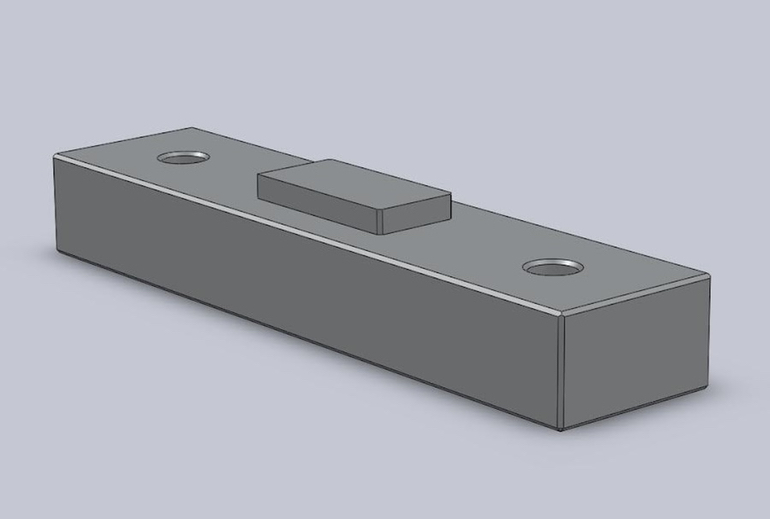

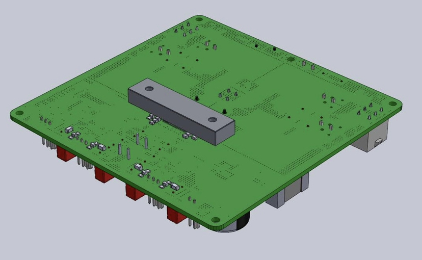

I have some CAD plans for a heatsink spacer block if anyone is interested. It can be made from 12mm x 10mm thick aluminum bar stock. Basically a 50mm long x 12mm x 8.7mm thick (at thickest point) bar with two M3 holes 36mm apart. The elevated mesa contacts the thermal pad on the TPA3255 chip. 0.3mm thick silicone spacer heat sink insulator sheet needs to be used in between the block and the chassis along with nylon shoulder washers to prevent the dirty chassis ground from contacting the clean amp ground. This block is meant to be used with 10mm long M3 standoffs (hex brass ones) on the 4 corners of the board to clamp it to the chassis with enough pressure to clamp the silicone thermal spacer sheet in place.

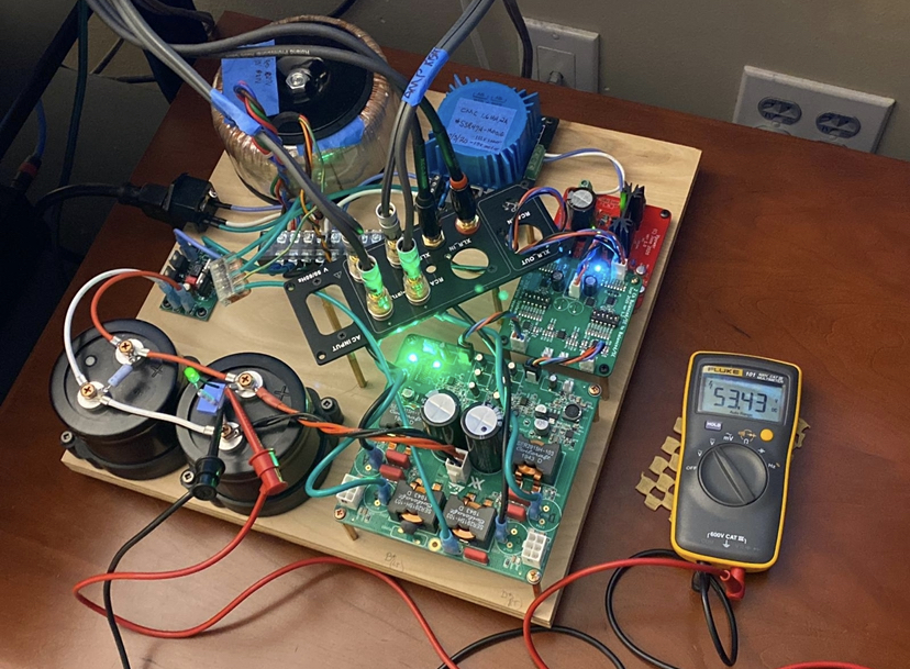

It seems that this amp sounds pretty good with a 400VA linear trafo making 53vdc using an LT4320 active bridge and 44,000uF of bulk capacitance. Even the buffer uses some nice Vpower power supply boards. This amp on a plank is working really well and is reported to have an inaudible background noise level. Cannot tell it is even on. This amp shown here is courtesy of Vunce. Nice build Vunce!

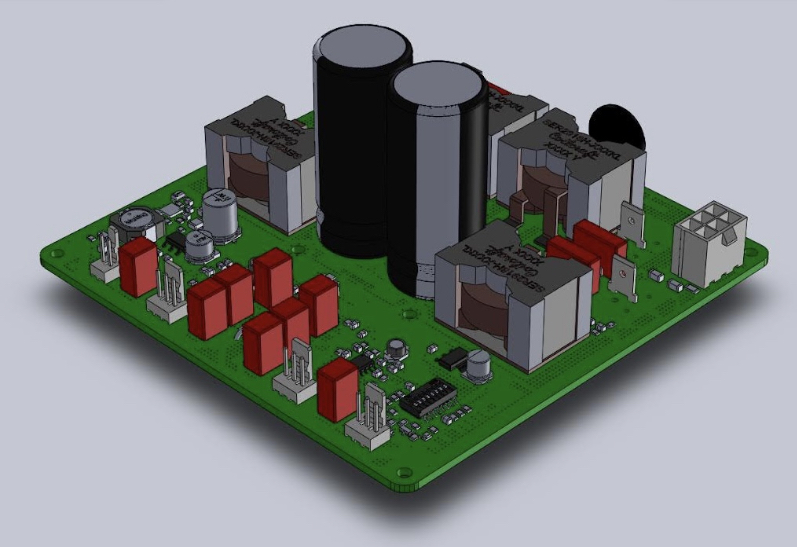

Sorry, it’s many weeks away. Due to the holidays, the manufacturing house in CA won’t be able to start until first week of January. The lead time of having mass production on a complex board like this is long because a trial unit has to be built with the automated pick and place machine, then heated and then tested. Then inevitably, a part of two has an error (200+ components). That must be tracked and found. Once confirmed then the whole batch is made. It took 3 months last time. I hope it’s going to be 2 months this time. If we are lucky maybe 6 weeks. Some of it is scheduling as there are competing assembly line jobs.
44,000 uF …
What is the standard amount of capacitance?
This is much higher - what was the reasoning? at some stage could this build be compared to the standard, on some music that’s bass heavy?

I wanted to try a linear psu with this amplifier. I utilized screw terminal caps I have on hand and cobbled together a nice psu. You could definitely use smaller caps if you wanted. Even with this busy looking setup, this is one of the quietest backgrounds I’ve had with an amplifier.
I will try an SMPS unit also.

A copper shim is fine - just make sure it doesn’t bump into nearby SMT caps on the underside. I found that genuine AMP brand Faston spades make excellent thermal conductor pads for this. Two of them stacked gives them needed offset from a heatsink. Combine with thicker one and 10mm standoffs.
