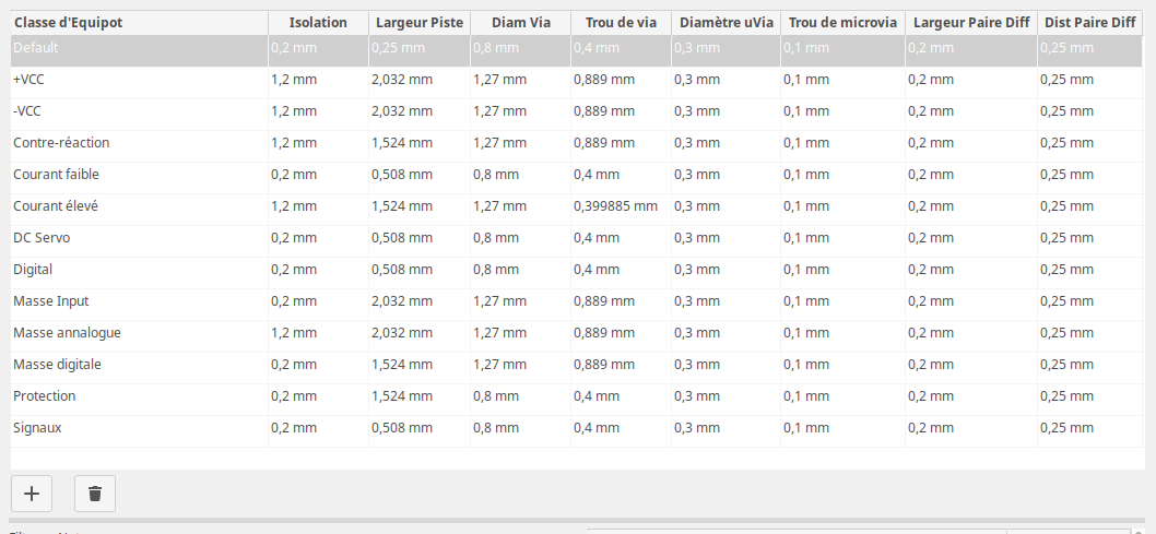

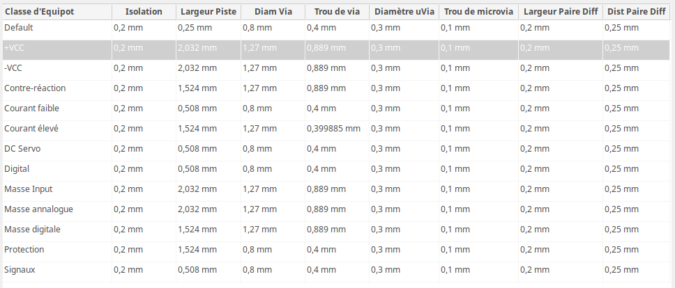

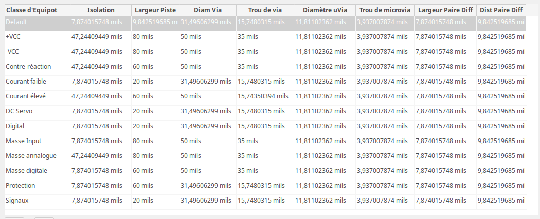

Following the most conservative suggestions above, I modified the minimum spacing to 1.2mm for power rails, ground and high current traces.
1.2 mm would be the minimum spacing assuming standard PCB material without a conformal coating.

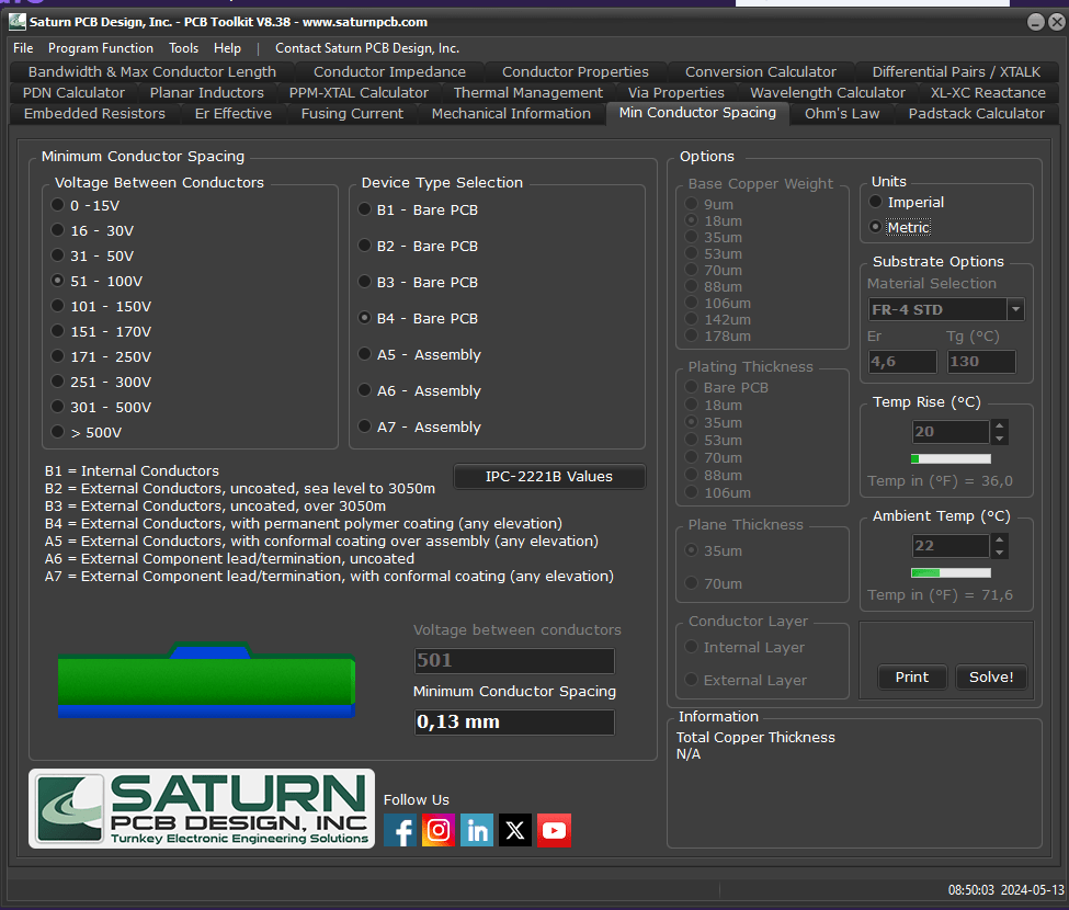

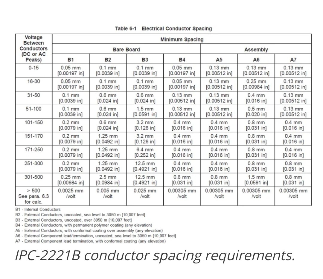

@Sevy, the said 1.2mm is creepage distance for conductors without a conformal coating, or solder mask, and is not from a standard suiting domestic electronic device such as an audio amp.
With presence of a conformal coating, IPC-2221B recommends 0.4mm minimum @101-150V, see column B4 in the attached. And 0.4mm is what we have in my day-job products that need to be CSA-ed.

I always use 2 oz Cu PCB with solder mask. Your 1.2mm rail spacing above is without coating, right?

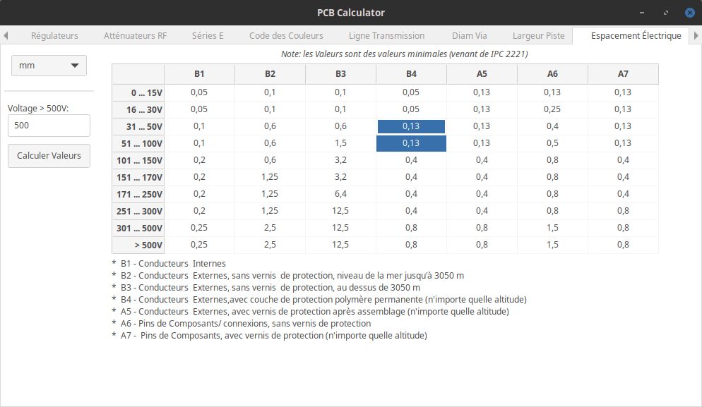

I ask PCBWay what is the thickness of 2 oz Cu. They answered 2 * 0,035mm - 0,07mm. I had also some tools calculators with KiCad based on the IPC 2221. If I configured these values I get these results from the B4 column, 31 to 100V:
B4 - External conductors, with permanent polymer protective coating (any altitude)
So I should be ok with 1,64mm traces width, spaced from 0,13mm one to each other. am I right?

Seeing that the highest voltage I got from my actual toroidal transformer was 49.something VDC, and that my theoretical design was done for 50 VDC, I guess that with your suggestion of 0,4mm nattawa and my calculation at 1,3mm above, I wasn't so bad with a default 0f 0,2mm of space violation limit after all, no?
@Indiglo your post just came in after my writing. What would be your suggestions based on the IPC-2152, 2 oz Cu, 50 VDC maximum, with permanent solder mask?
That's right. Also, it may be worth noting that the IPC-2221B recommended minimum creepage distances are NOT mandatory enforced, but rather more of voluntary guideline nature. Breaching the IPC-2221B does not mean immediate failure of a PCB/product design, but that PCB/product design becomes subjected to hipot tests and/or accelerated failure mechanism tests in order for it to be safety-certified.So...

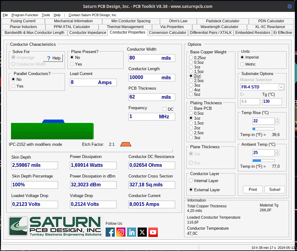

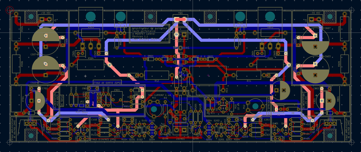

I started over my board layout checking progressively my traces length in the tools and finally, with my board at 10 inches wide, I still can use the 80 mils trace width I was using for the ground and the rails over a 10 inch length without problem... See below, I can travel more than 8A over 10 inches!
This seems backwards.Ground:
Unless you know you need something different, ground should probably be a plane by default, not traces.
Then "scrape away" thin lines of copper to add insulation. Use online calculators to estimate parasitic capacitance and inductance. If the empty insulating areas between traces are too big, you may unwittingly create RF antennae. If they are too small, you may slow down critical parts of the amplifier with a few extra pico Farads of capacitance. The latter is likely to be a much smaller problem, but it could be important in for the feedback loop.
Ouf!Unless you know you need something different, ground should probably be a plane by default, not traces.
It seam that a lot of peoples have different view of how to route an amplifier. I remember having ask if a ground plane would be adequate and some answered me back the contrary.
I feel that I am turning around with this board layout. Every time I modify it to respect some good advises, someone else came in with other good advises that make me go back to square one.
Star grounds were probably fine, and more fun to debug, in the days when every sqr cm of board space cost a dollar, but a ground plane is certainly safer.
There are caveats -- remember to add 'spokes' to the component pads to avoid soldering issues. Anyway, that's just my suggestion.
