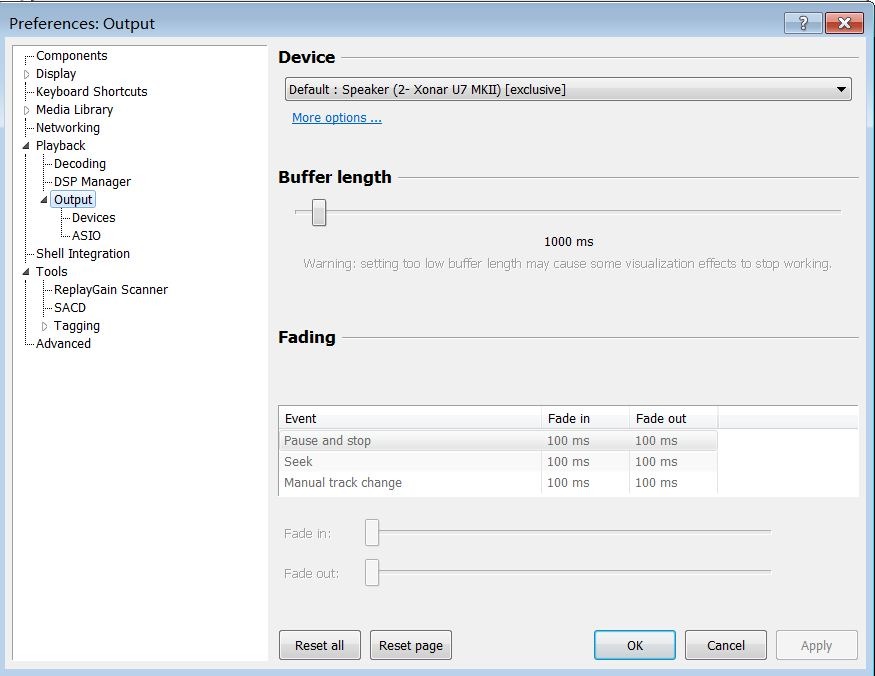

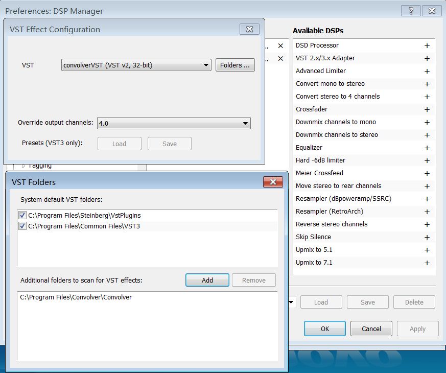

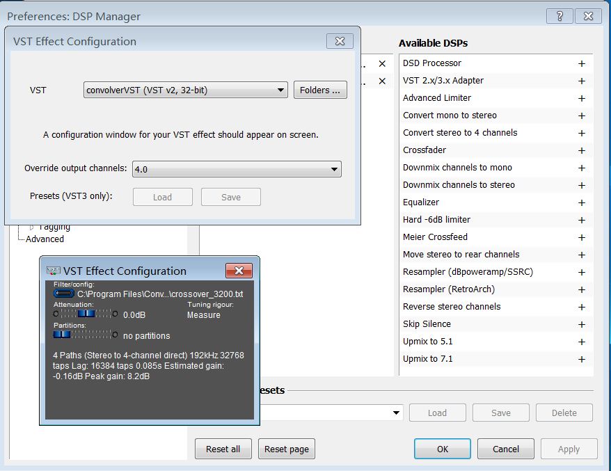

Install foobar2000V2.1.5 on the system, download and install the VST 2.x/3.x plug-in, add the VST 2.x/3.x plug-in in the DSP management of the preferences, configure the VST 2.x/3.x plug-in, add the folder where the installed convolver is located, select convolverVST (VST v2 32bit), and display the VST Effect in the pop-up format Click Filter/config in the configuration window, select the config file generated earlier, OK. Select the default speaker exclusive in the output and play it.
