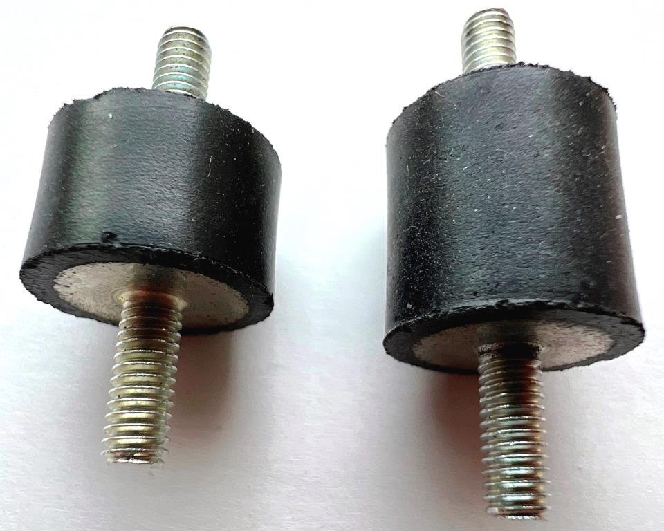

* Initially I experimented with grommets to modify the bias transformer mounting, but the most effective result came from using rubber anti-vibration studs to isolate the vibrations (Fig. 1).
Figure 1. Elesa VD1-1510M4 (left) not used, and Elesa VD1-1515M4 (right) used in this installation.

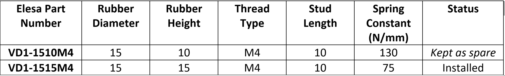

  • Two vibration dampers are required for each bias transformer, or total 4 for the pair of speakers.
  • Of the two series of vibration dampers purchased, VD1-1510M4 of rubber height 10mm and VD1-1515M4 of rubber height 15mm, I decided to first try the VD1-1515M4 as it had the softer spring constant (Table 1). In the event of insufficient clearance between the bias transformer housing and the high-voltage board with the VD1-1515M4, then I would change to the lower profile VD1-1510M4.
  • An M4 thread type was chosen as the M4 diameter was close to the diameter of the original mounting hardware, whereas the next size up M6 would require enlarging the chassis holes.
Table 1. Specifications of Elesa Type VD1 Rubber Vibration Dampers - dimensions in mm.

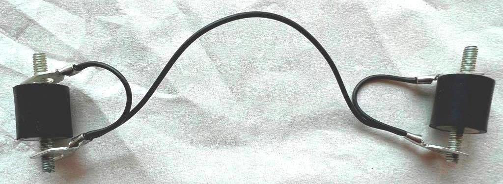

  • To re-establish the ground connection a small wiring harness was constructed (Fig. 2).
Figure 2. Pre-assembly showing wiring harness for connecting both ends of each VD1-1515M4.

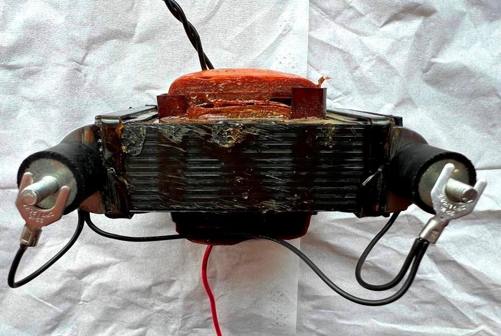

Figure 3. Partial assembly, VD1-1515M4 pair and wiring harness attached to transformer base.
  • The inside surface of the interface's chassis was lightly sanded around the mounting holes to ensure a bare metal contact with the grounding wire lugs.

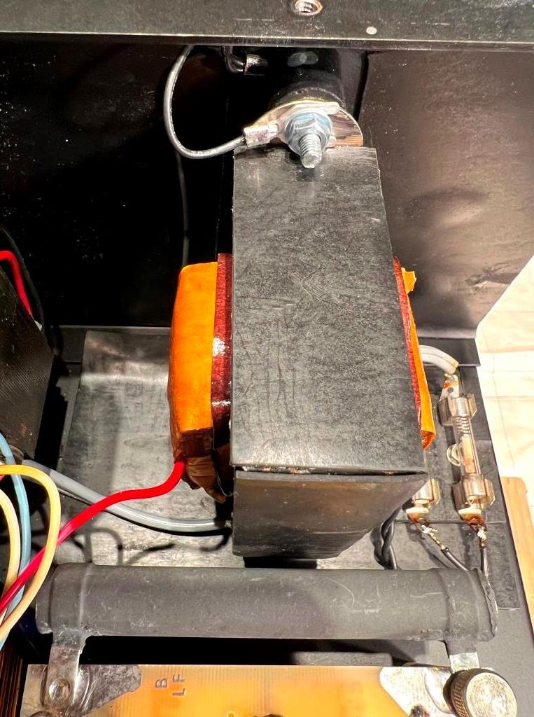

  • Finally, the bias transformer with wiring harness and anti-vibration studs was installed back in the interface using M4 fastening hardware (Fig. 4).
Figure 4. Bias transformer reinstalled with new VD1-1515M4 pair and ground wiring.
* Fortunately, this installation using the VD1-1515M4 pair allowed just enough clearance between the bias transformer housing and the large 50 K ohm resistor (Fig. 4).

  • After installing these parts and upon powering up I was pleasantly relieved all transformer hum noise is gone, both interfaces are now dead quiet. Considering the parts cost less than $5 per interface this was a worthwhile modification.
  • Previously when placing your hand on the interface chassis you could feel the vibrations, but this is greatly diminished now.
  • Regarding the initial approach of attaching synthetic rubber isolation sheets to the chassis, this was left in place as it does no harm.
