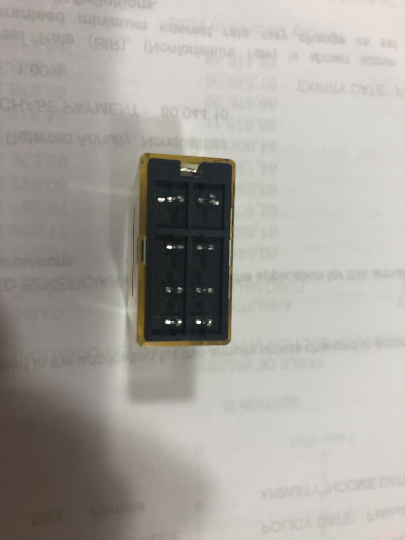

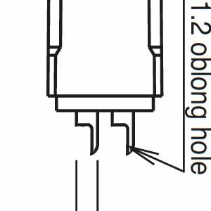

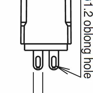

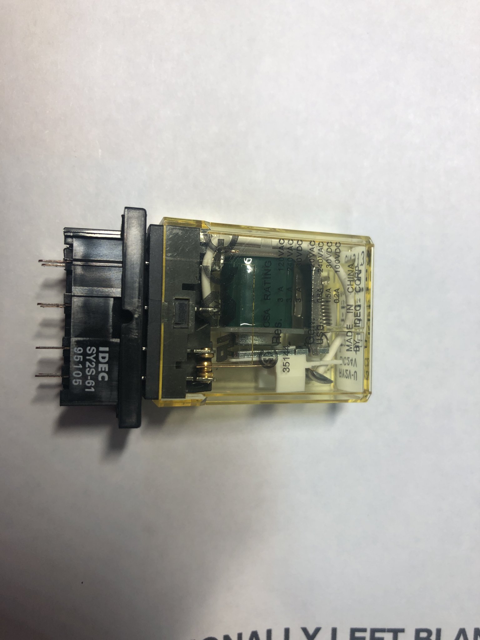

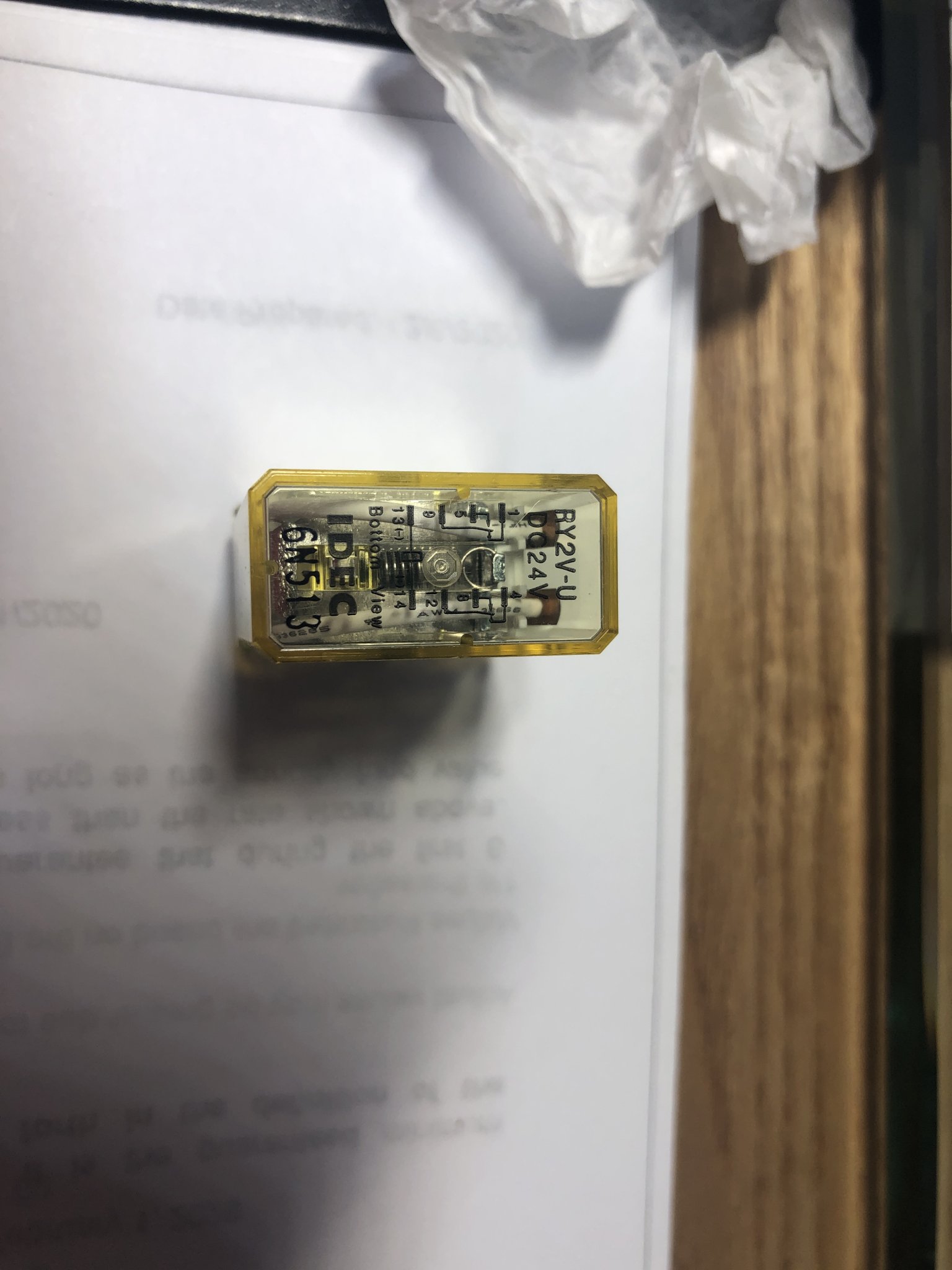

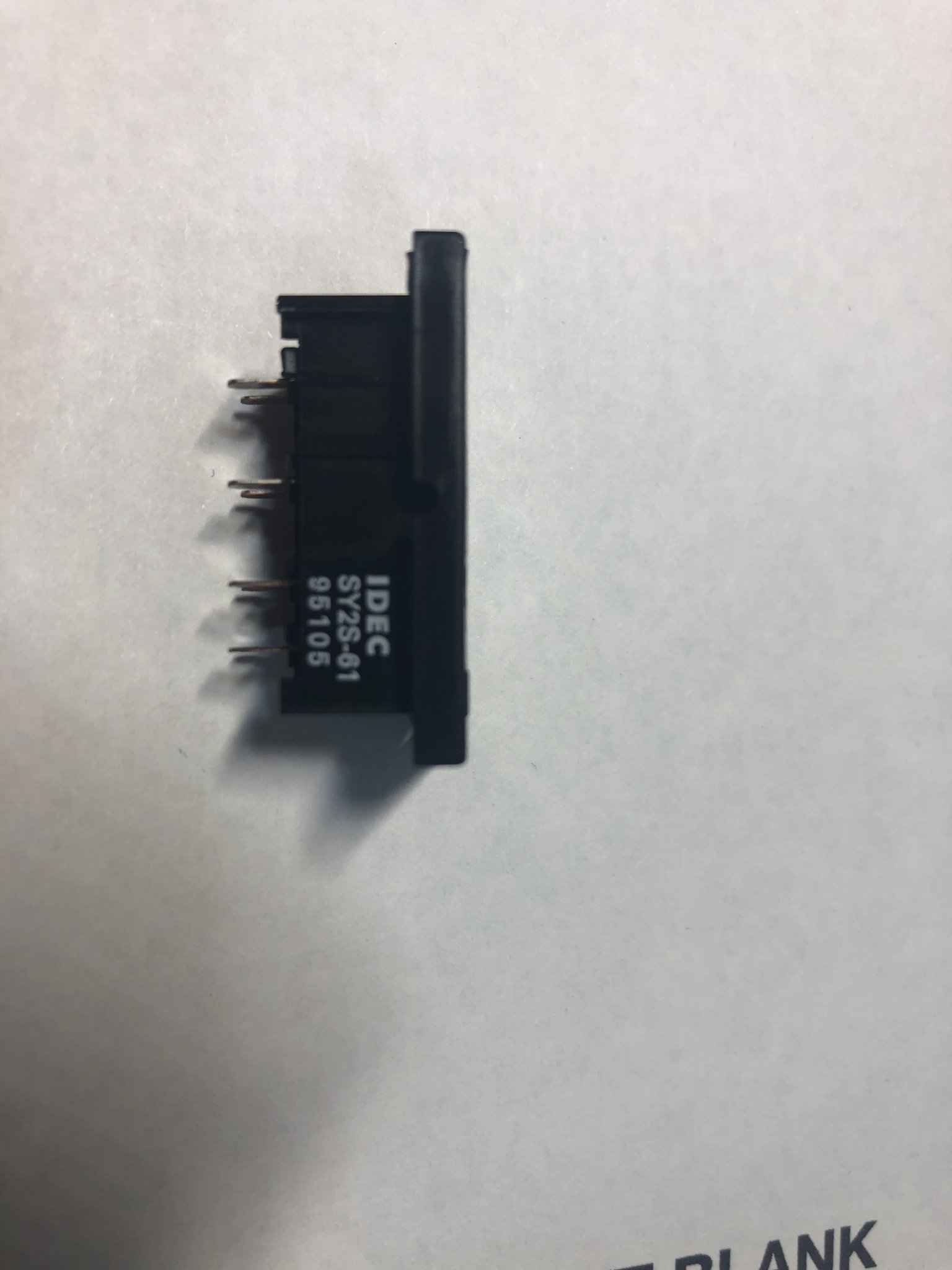

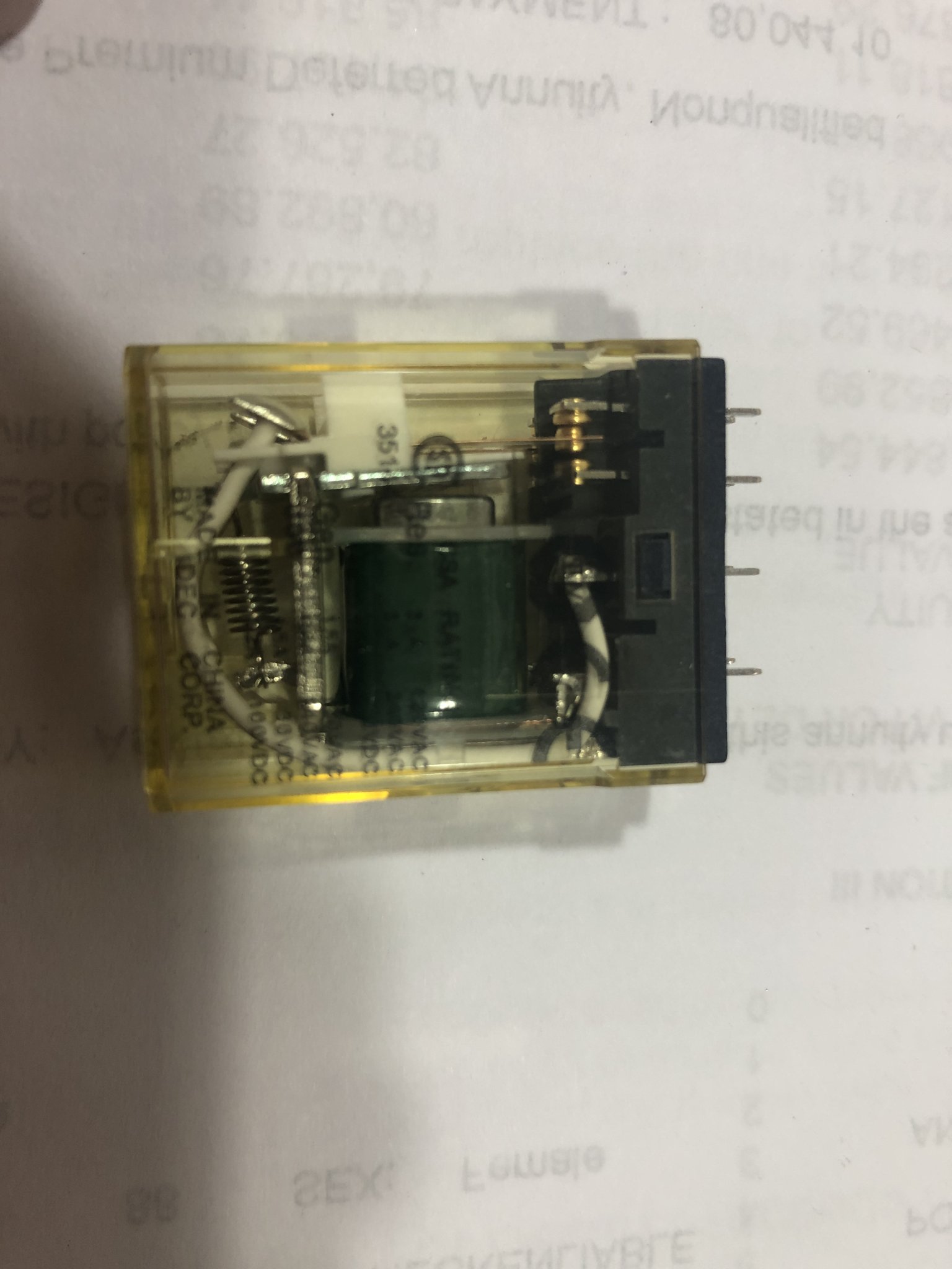

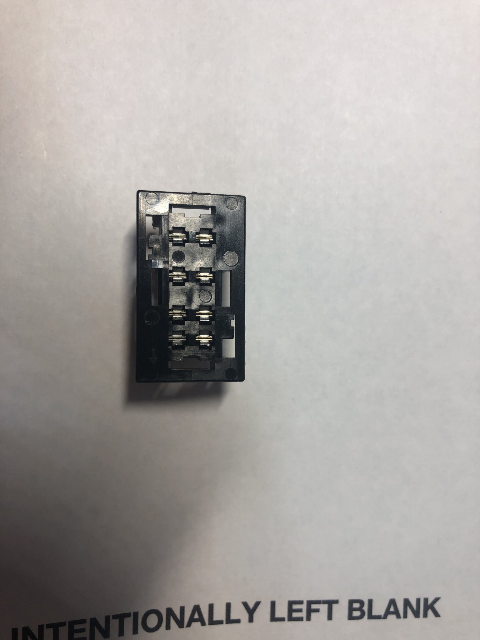

Re. the relay: While the original PCB pin IDEC RY2V-U-DC24 is pretty much unobtanium, the solder-lug version (IDEC RY2S-U-DC24) can still be found, and with judicious use of side-cutters/file/dremel etc, can be modified to drop right in to the PCB holes.
From this:
To this:
@seanc

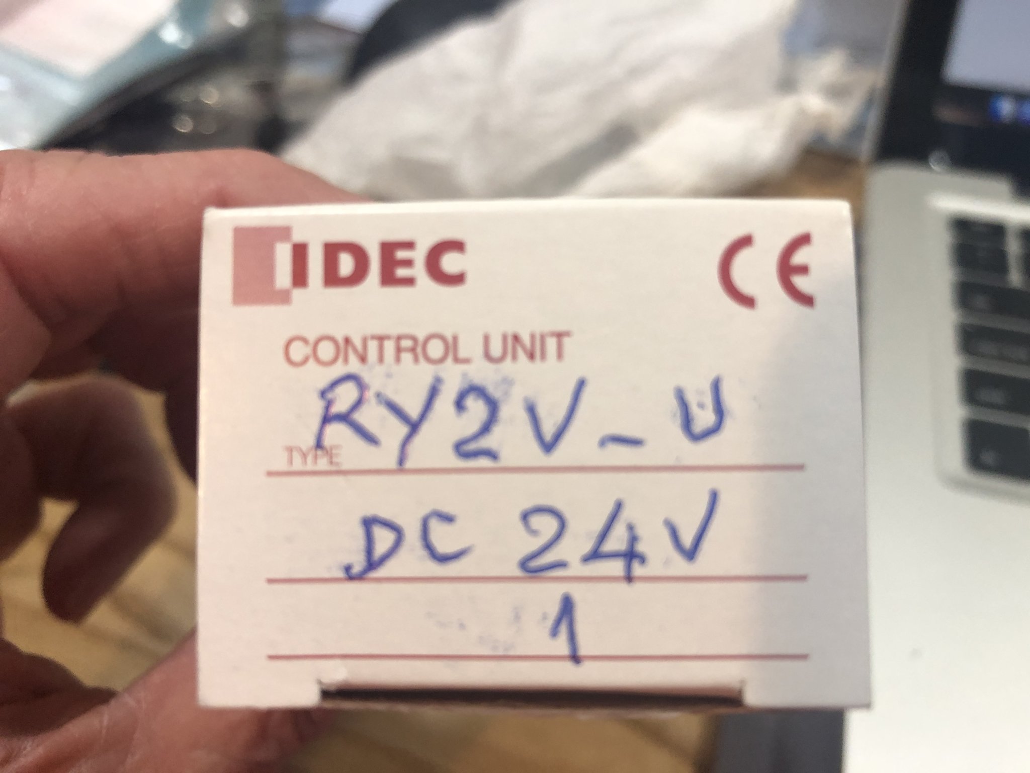

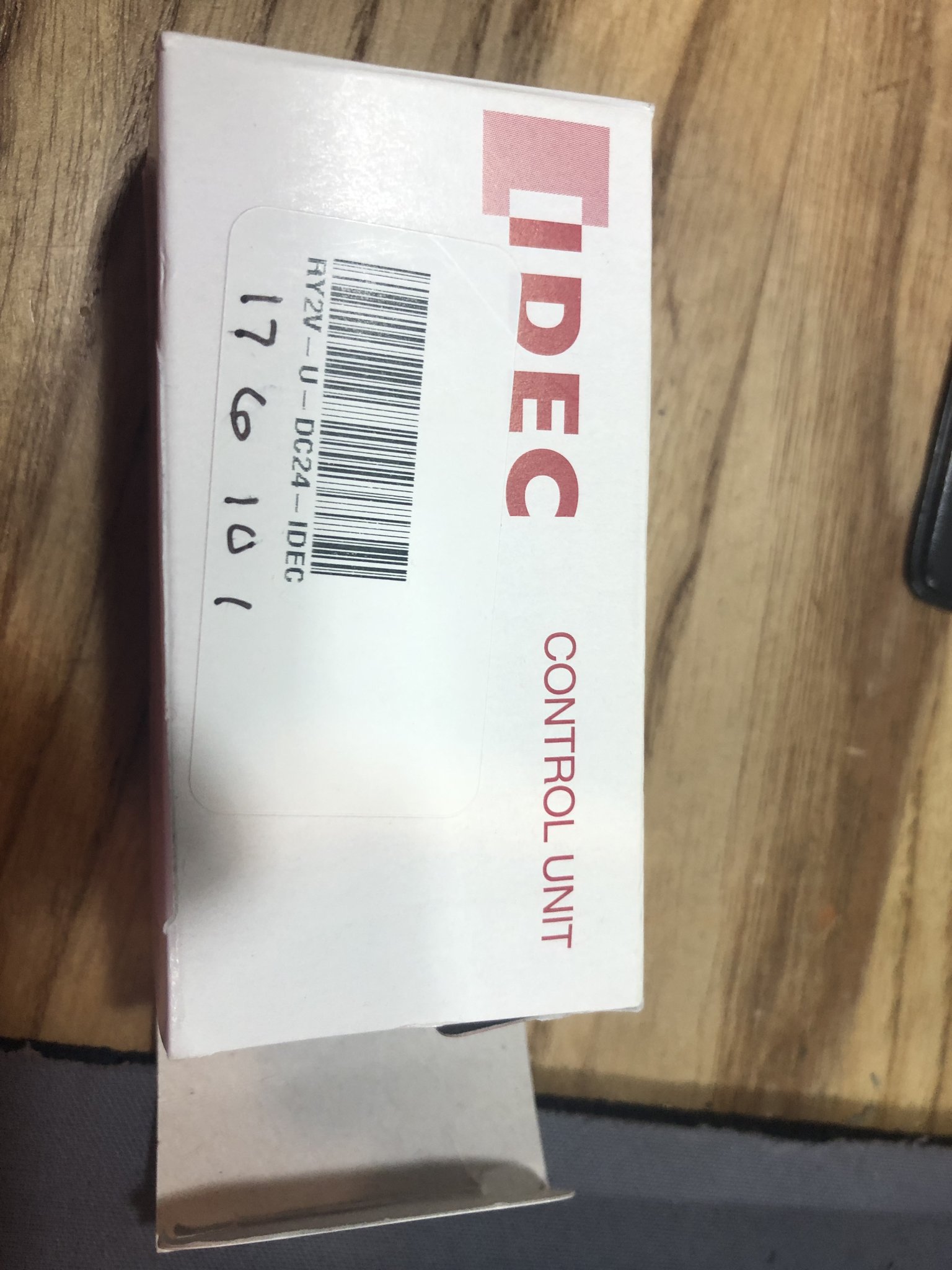

I actually ordered one of those last night from Galco, but it seems like the one I bought is actually the PCB version:
https://www.galco.com/ry2v-u-dc24-idec.html
We'll see when it shows up! I also bought another signal relay to try when I was putting together a Mouser order for the components to revert it back to the original muting circuit.

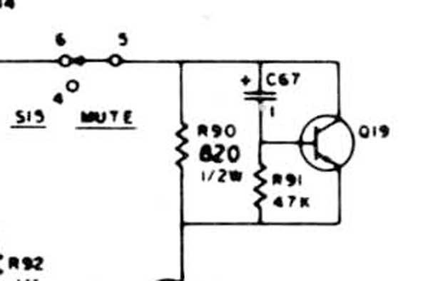

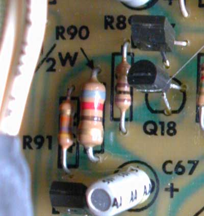

PS. beware there are inconsistencies between schematic & PCB references
Schematic says R90 is 820ohm, PCB says 1K. Schematic is correct.
Schematic says C69 is 1uF, PCB says 0.1uF. PCB is correct.
2SC1345 transistor is unobtanium. KSC1845 is best substitute, but 2n5550 and BC547C will work as well.
2n5087 is still available, 2n3906 will work as well.

Good find!I actually ordered one of those last night from Galco, but it seems like the one I bought is actually the PCB version:
My relay still works fine, figured if I had to replace it at some point, the solder-lug version mod would work.
@Marksd, it's going to depend on how successful the relay fix is.
I believe people are right that the new op amps are causing the voltage to sag. But I am hoping that the new relay from Galco along with the reversion to the original circuit will get it going again. I should get parts by the end of this week. It will certainly look better inside! If that doesn't work out I am either going to put the old op amps back (in the DIP sockets), or put in a new transformer as GKTAUDIO suggested.

Apt was know to "tweak" the circuit over time (witness the relay circuit).All, please see the mute circuit page of the service manual. Both of mine have a 1/2 watt 1k resistor in the relay drive.
The schematic clearly shows "820", but note the numerals are much larger than the rest of the schematic, which would seem to indicate it was changed from original drawing.
My unit had 820 installed. Might not make much difference, but there it is.

Oh, and about the 1k vs 820 -- I saw that the PCB doesn't match the schematic. The other Apt Holman I already overhauled and sold had the original mute circuit and had a 1k. I bought both 1k and 820 just in case the switch to 820 was intended to improve the circuit reliability.
