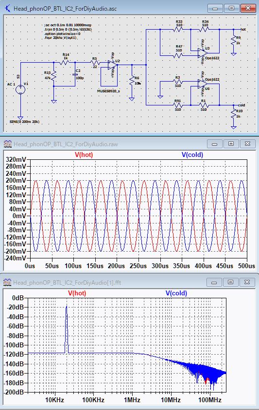

BTL for my headhone Amp
Nice to meet you. I would like to introduce the unbalanced-to-balanced conversion circuit of the headphone amplifier I created.

Dear Mr. Jan Didden,
Thank you very much for your advice! I am truly grateful.

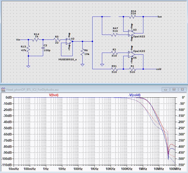

If R33 is not included, the feedback level will vary between the HOT and COLD sides, resulting in a phase shift in the high-frequency characteristics.
I am attaching the simulation results.
The purpose of this circuit design was to align the phase characteristics by maintaining the same feedback level.
As you rightly mentioned, removing R6 should not pose any issues. Thank you very much!
Yours Truly
ERI
P.S
I would like to add the following. This circuit can easily switch between an inverting amplifier and a non-inverting amplifier using terminal toggle switches, which is very convenient.”

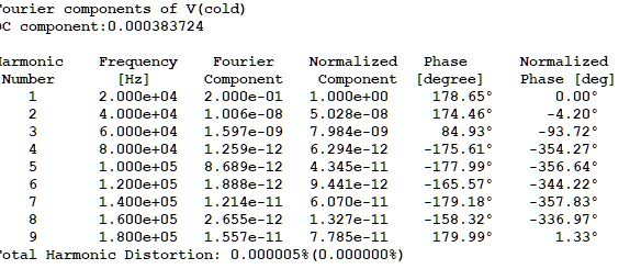

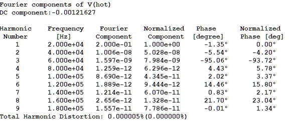

Excellent! I learned something today. Well done.
One more question: that R33 does lower loop gain, so I would expect the top circuit to have higher distortion than the bottom circuit.
What is your opinion about that? Did you measure that?
Jan
Thank you for sharing your perspective. We hadn’t considered comparing distortions, so I conducted a simple simulation. I will upload the results for your reference. It appears that Both the HOT side and the COLD side appear to have nearly identical characteristics.
Best regards.
ERI

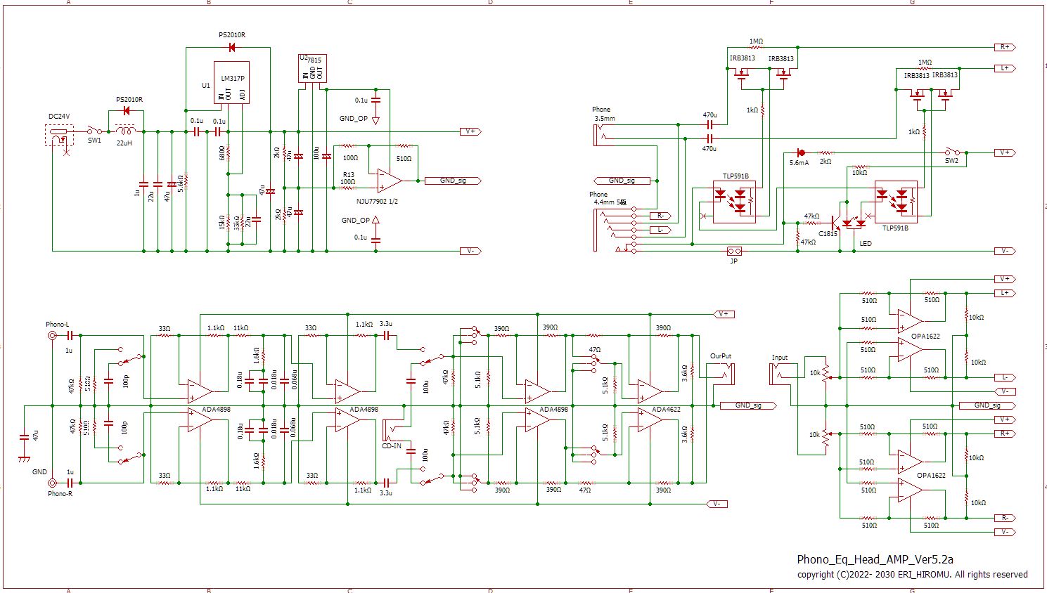

Hello everyone,
I am uploading the basic circuit diagram for this headphone amplifier. Additionally, I am planning to introduce this headphone amplifier at a gathering of enthusiasts in Tokyo later this month.
Sincerely,ERI
