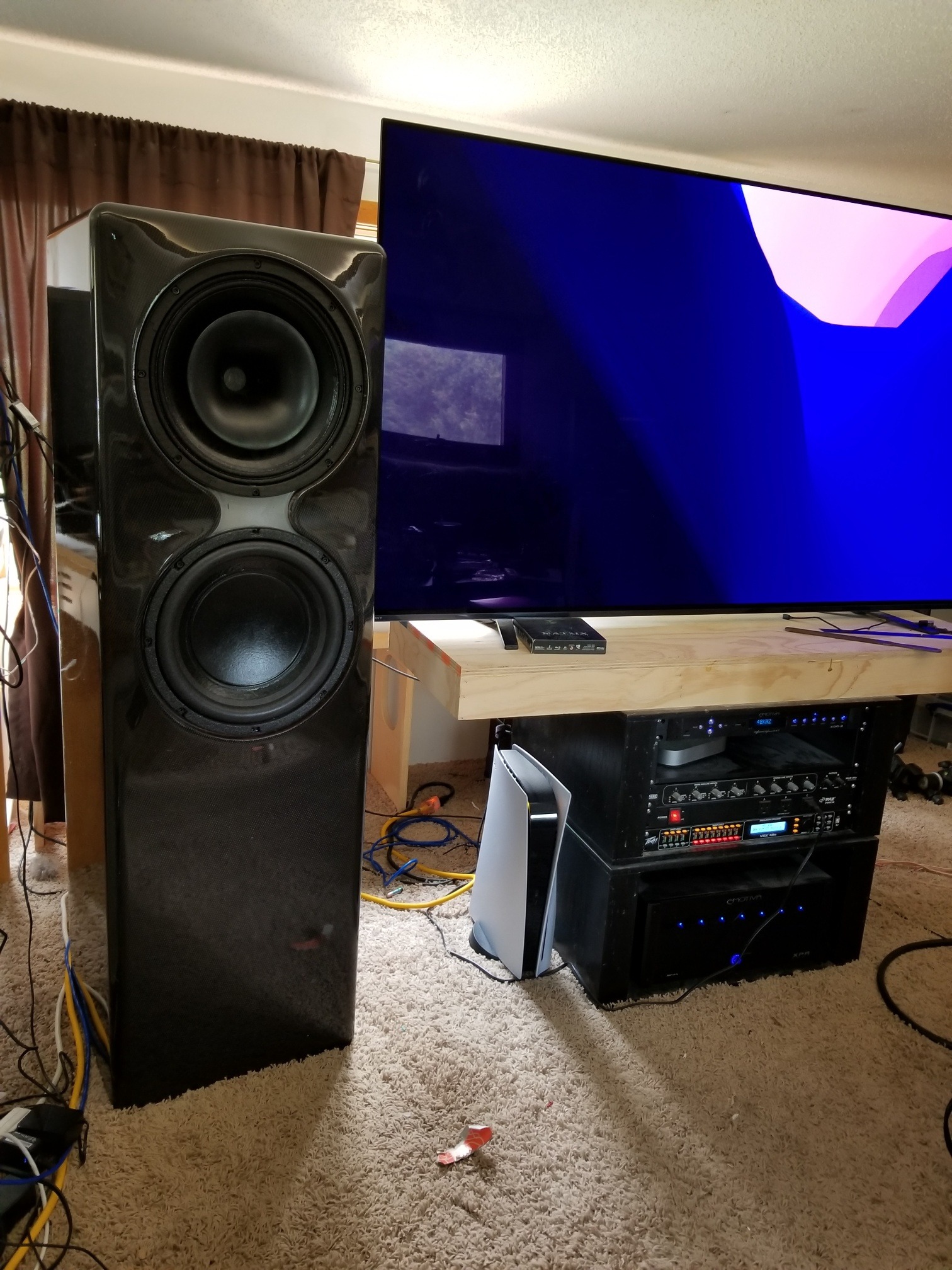

Officially introducing my new speaker build. This one is "mostly" done, but unfortunately I won't be done with the second cabinet in time to make it to the Parts Express speaker competition. But I am far enough along that I have something to show.
My goal is to introduce an idea that is attainable for DIY, and I think it has the potential to change the way we do multiple subwoofers. It is not my idea, but I haven't seen anyone else in the DIY space attempt to do an active speaker like this. The idea is multiple active subwoofers incorporated into the main speakers. (It turns out to NOT be cardiod. I pursuied that angle, but did not end up with any promising results.)
My finding so far is that I can effectively control low frequency response in my room with DSP adjustments to the 4 subwoofers. I also get incredibly clean and detailed bass. I don't know if this configuration will work as well in every listening room or home theater, but I am optimistic. I would like to see other people explore the idea and see if their results are similar. I think that it is possible to use 8" or 10" drivers to achieve the same results, but in a smaller cabinet.

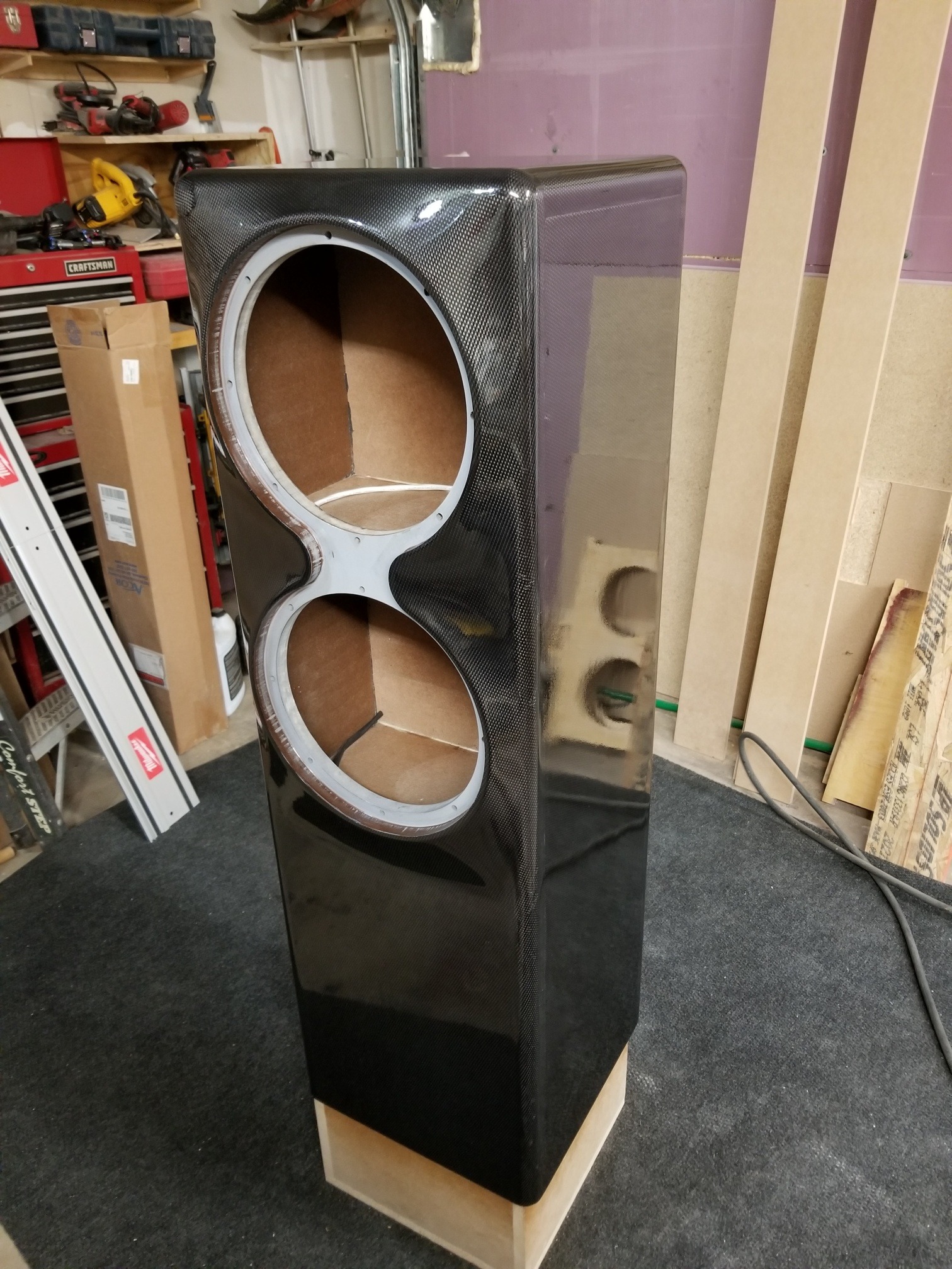

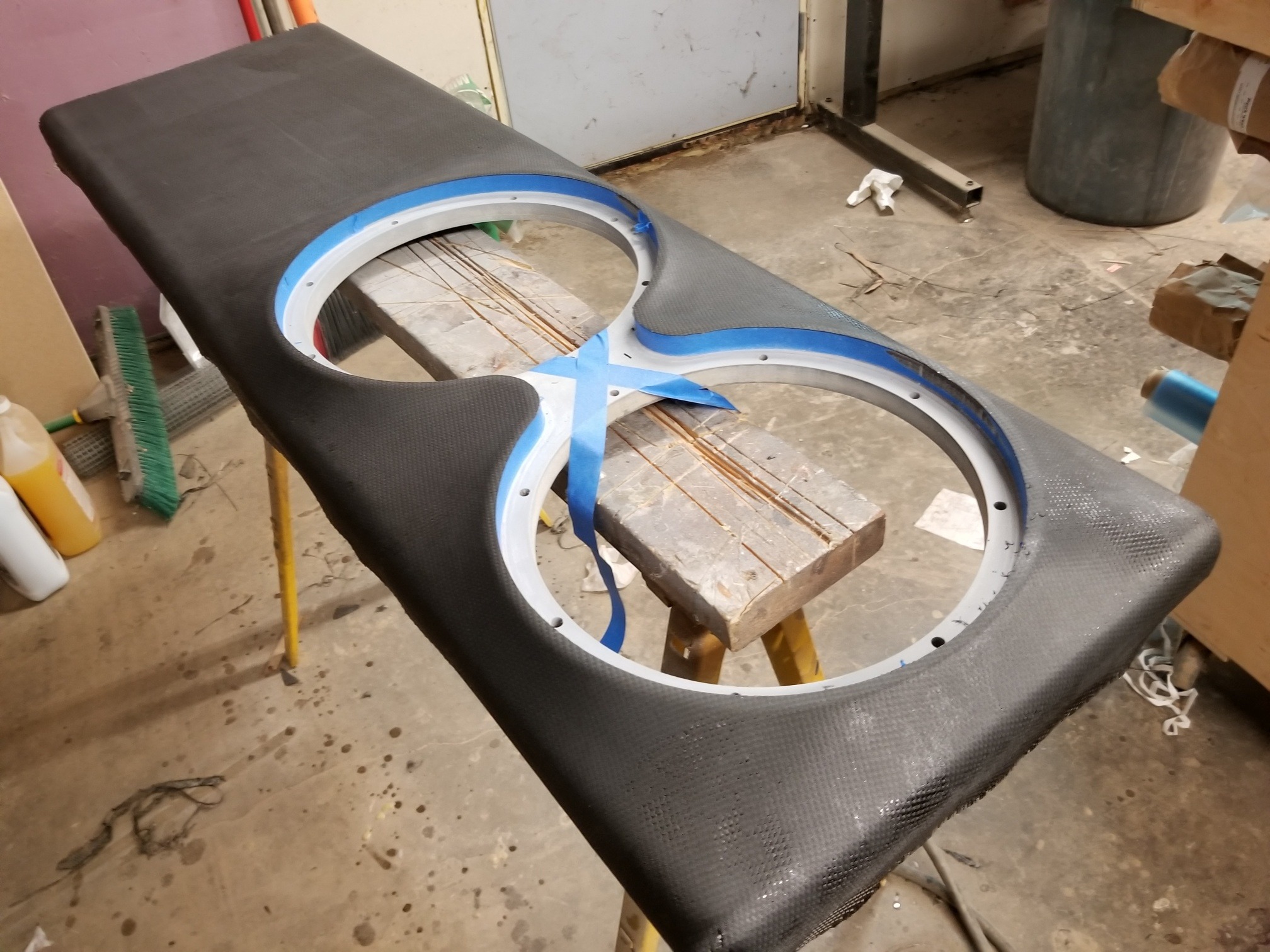

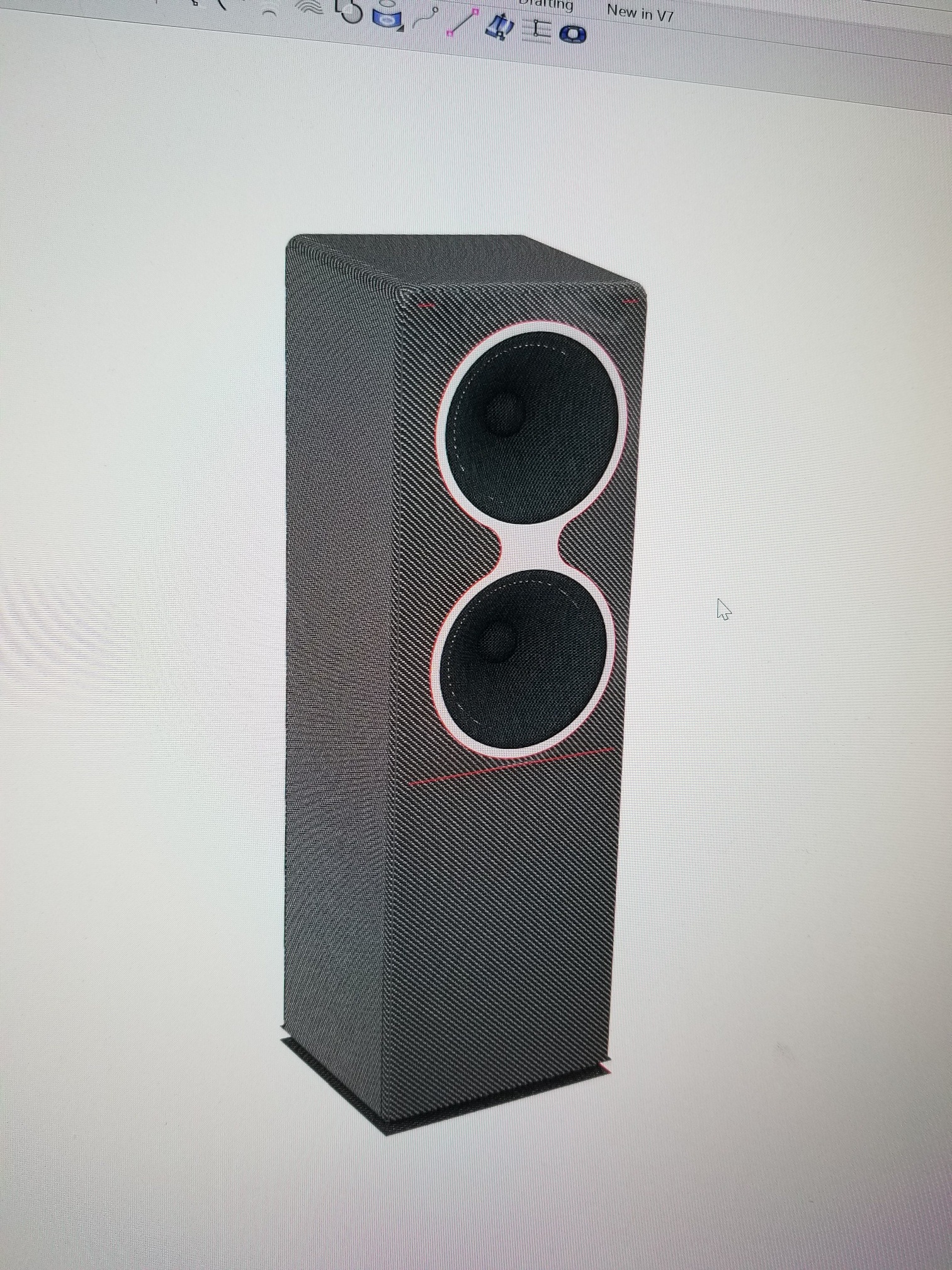

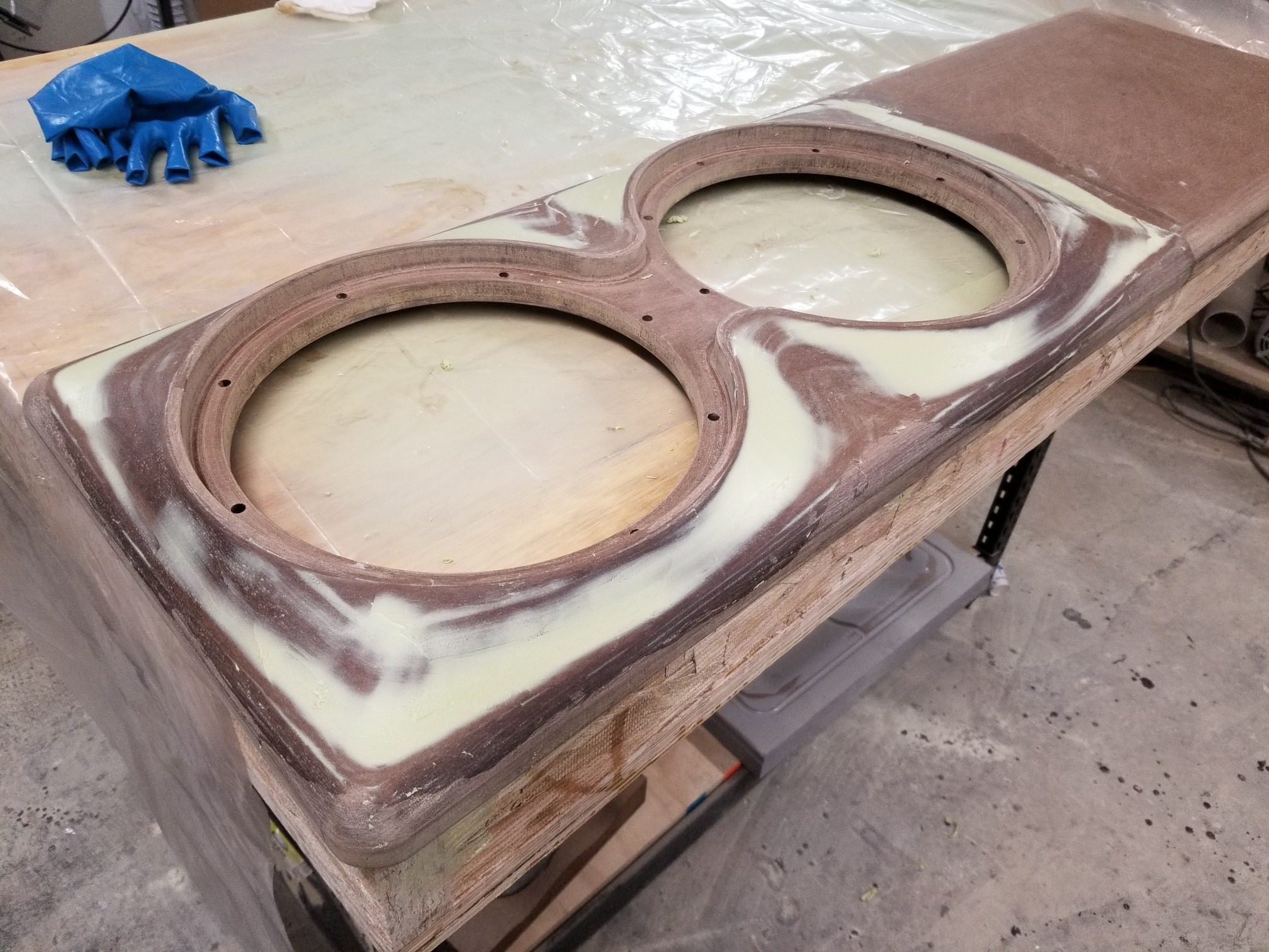

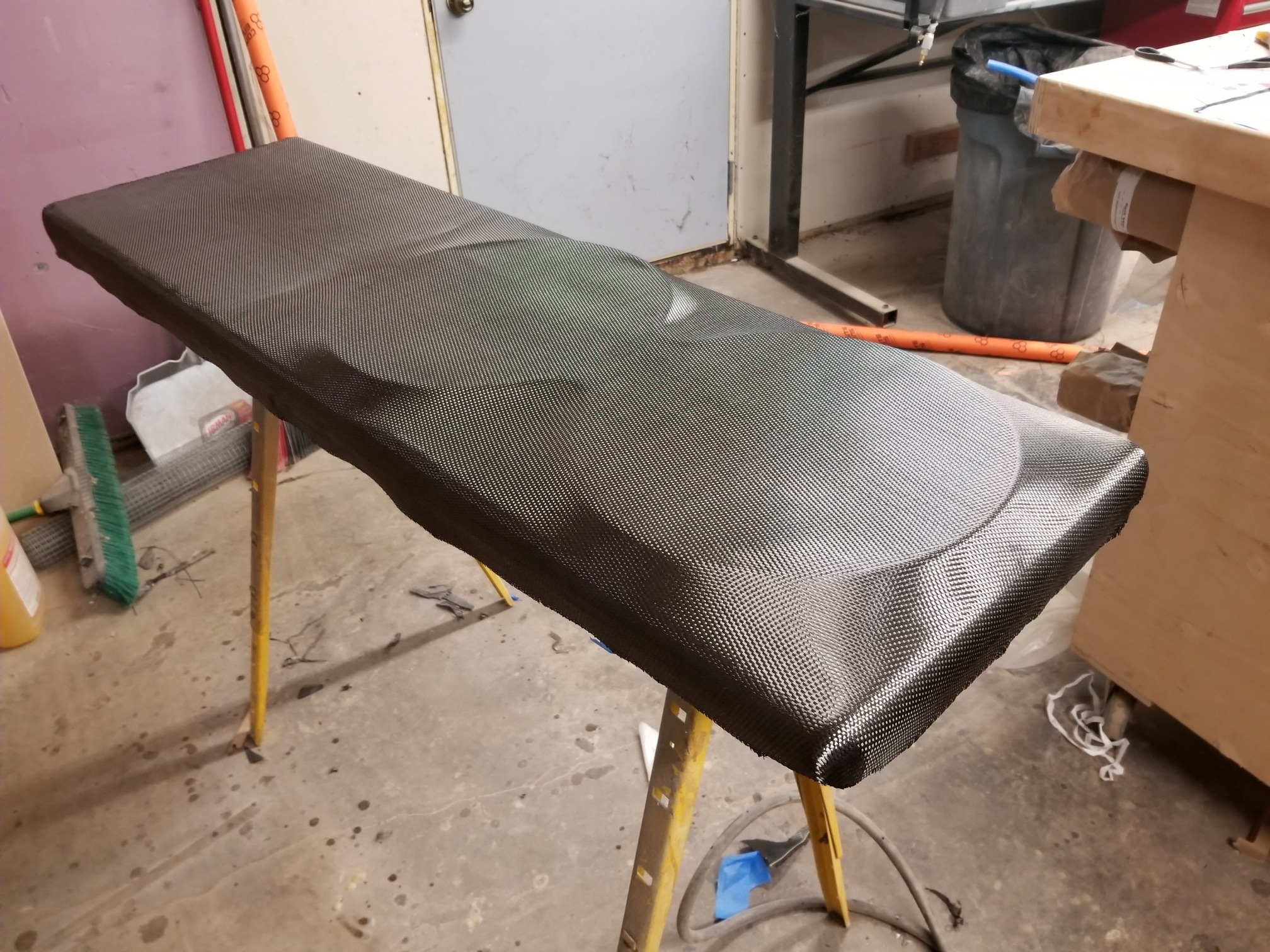

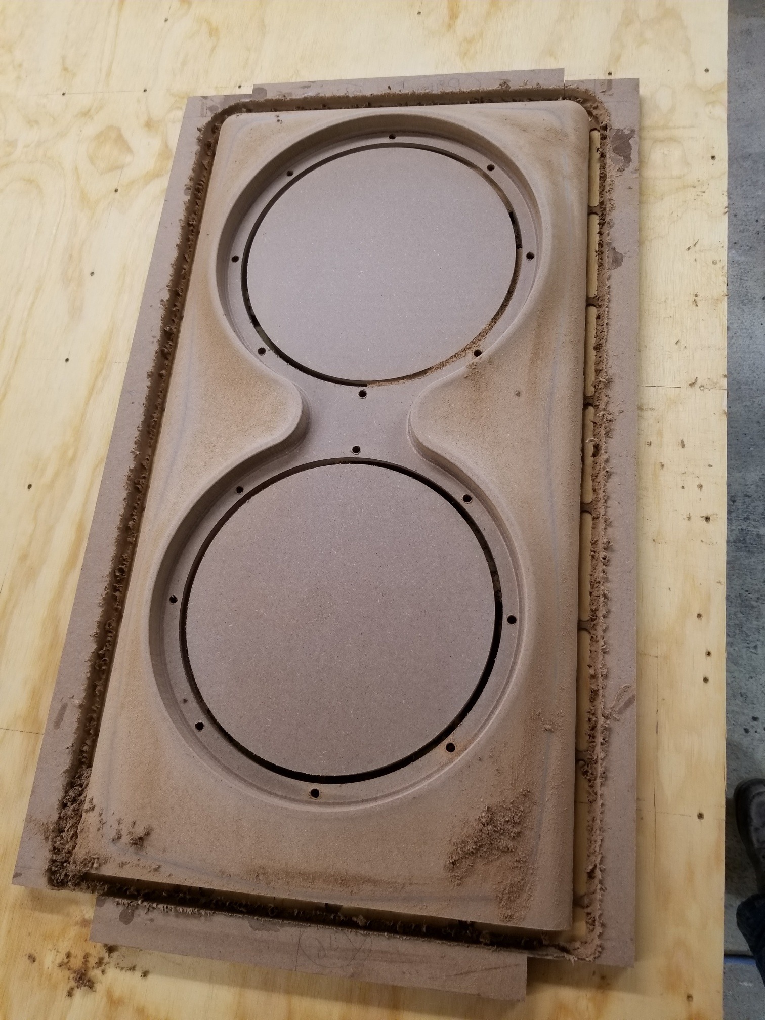

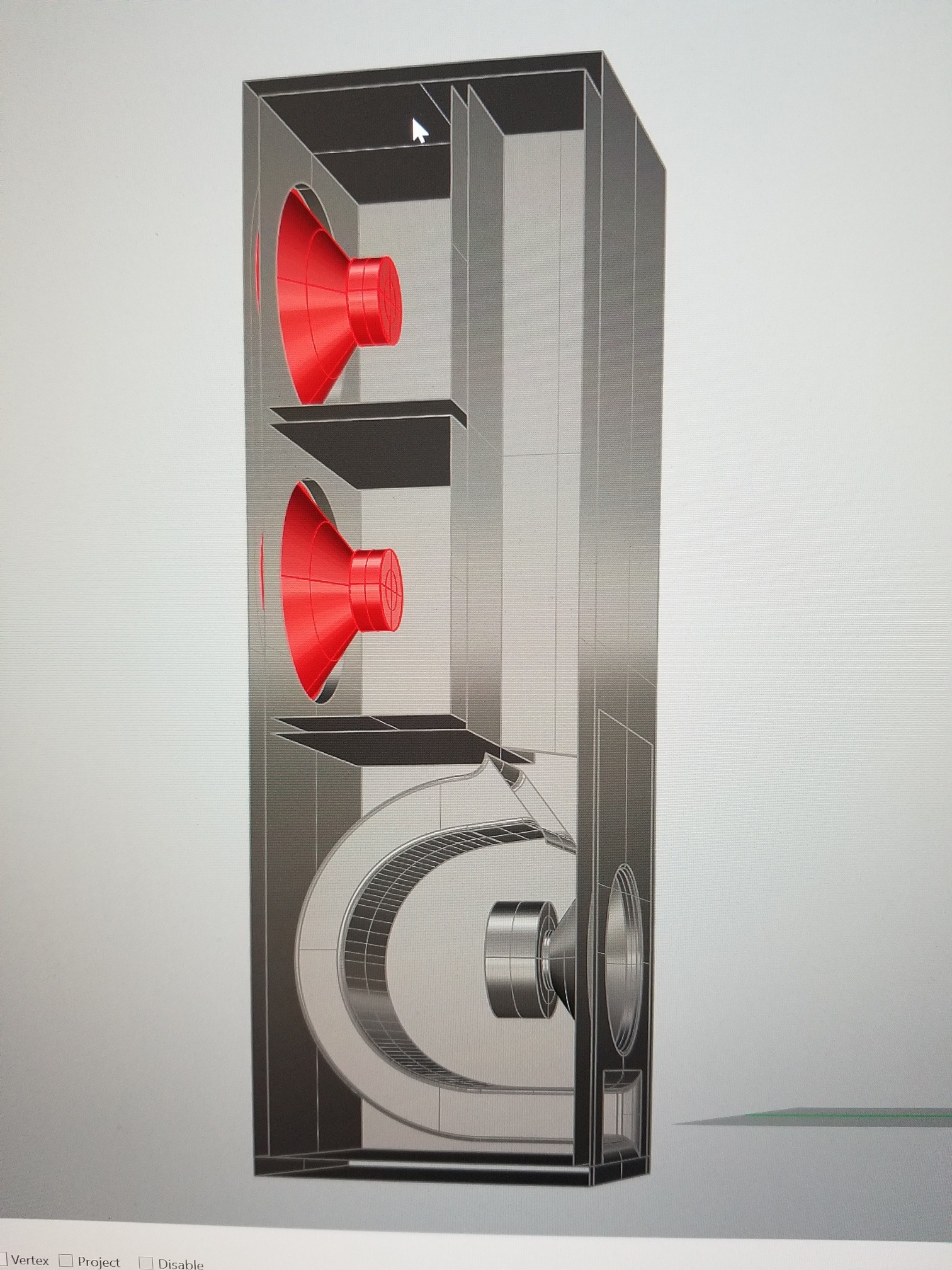

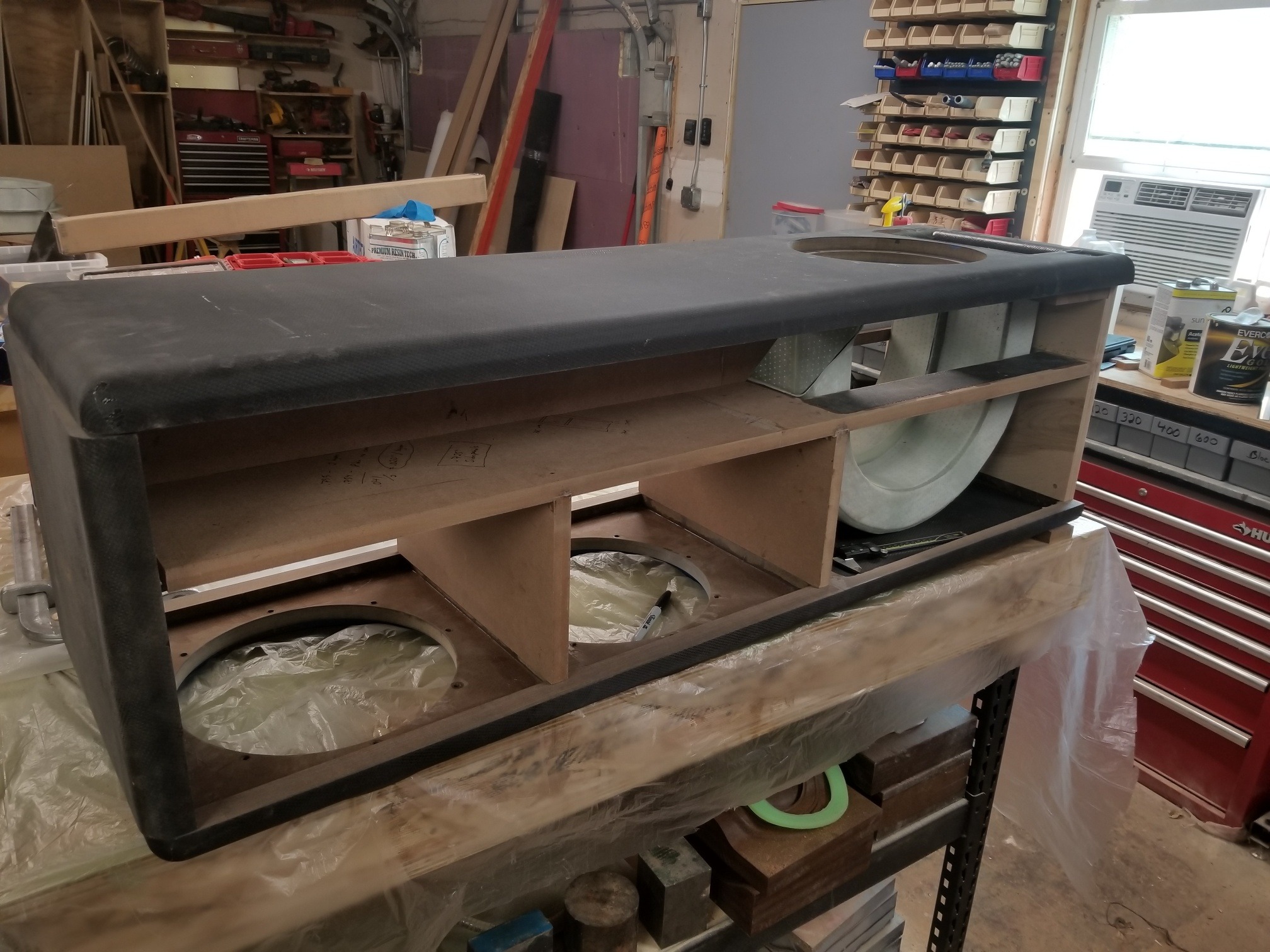

The cabinet is 16" x 16" x 52", and made of moisture resistant MDF with a skin of carbon fiber cloth (carbon is primarily for aesthetics.) The drivers I'm using are B&C 12FHX76 12" Coaxial, Lab 12 12" woofer, and RSS265-HF-4 10" subwoofer. It is powered by an Emotiva XPA 8 channel amp (6 high power channels + 1 stereo channel). The signal processor is a Peavey VSX 48E. (Cooling fan delete is a critical mod to the Peavey processor!)
The subwoofer plays down to 20hz, and the front woofer has a steep high pass at 50hz. The mid woofer crosses to the horn at 1,200hz. I keep experimenting with the crossover points for the subwoofer, woofer, and mid, so I can't specify what works best.

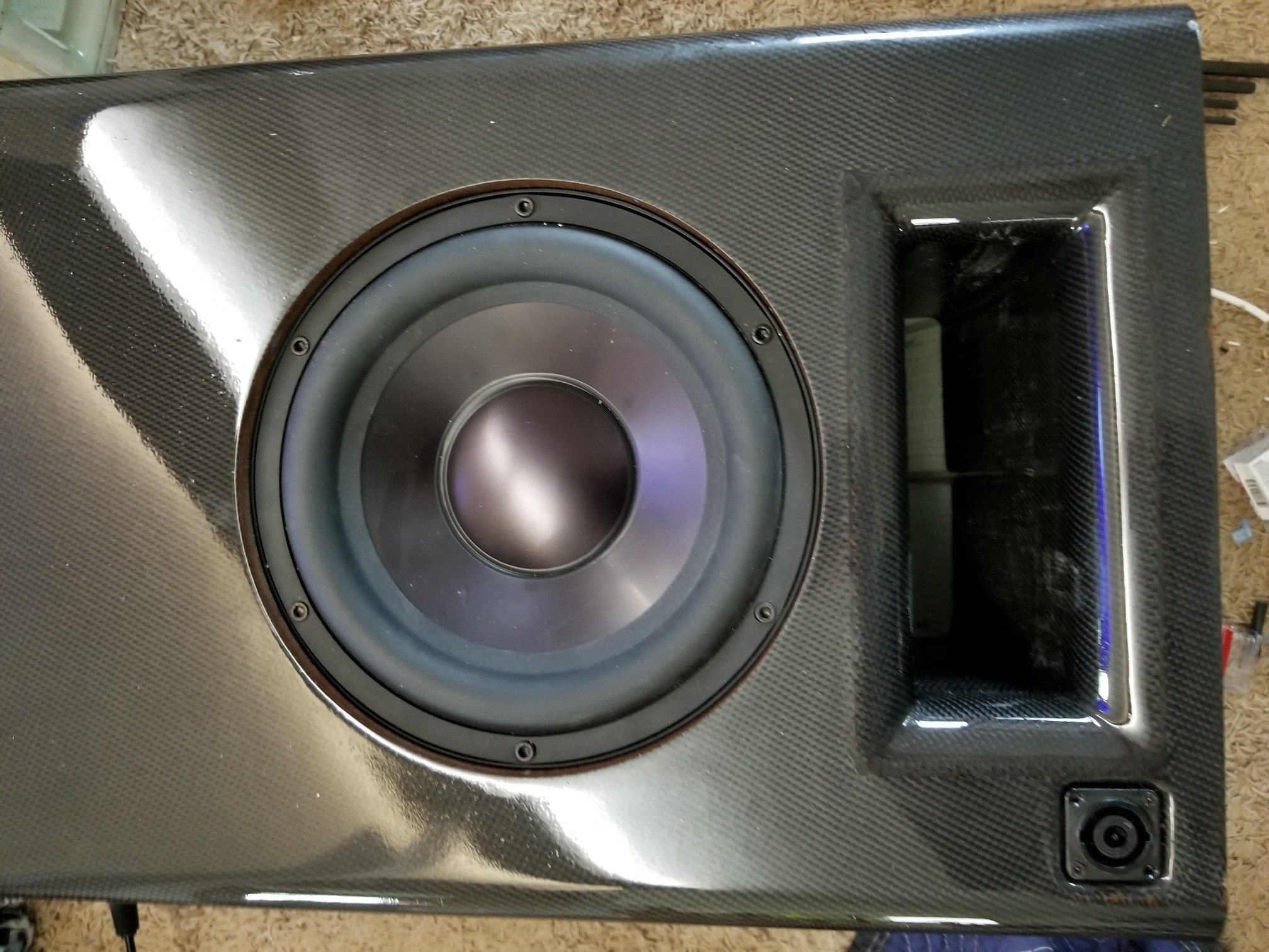

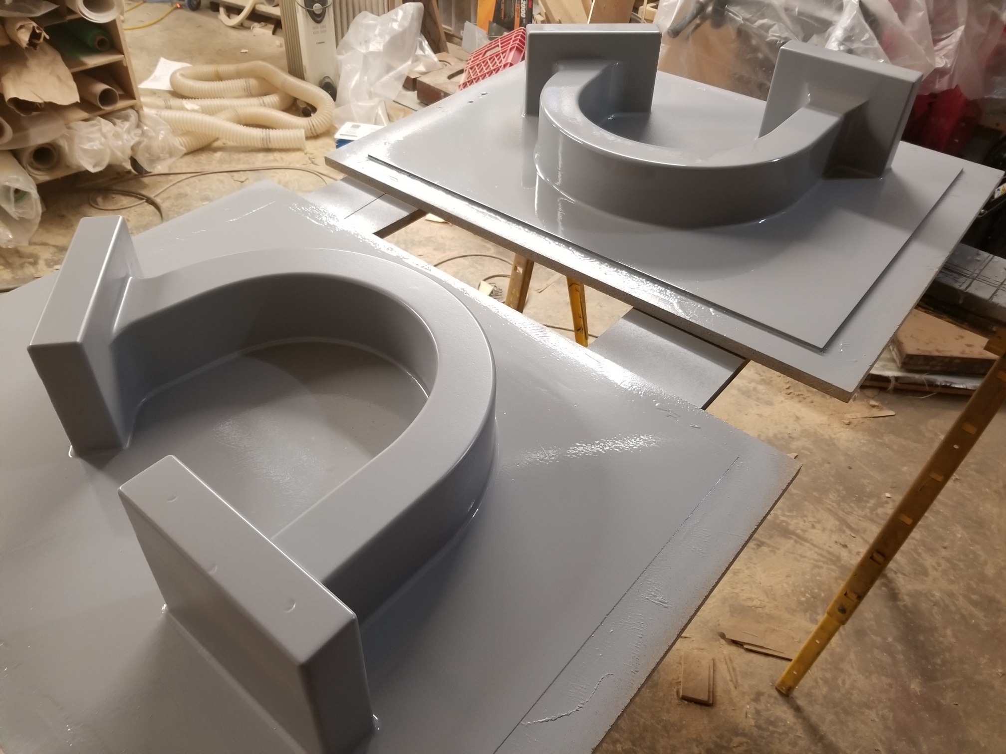

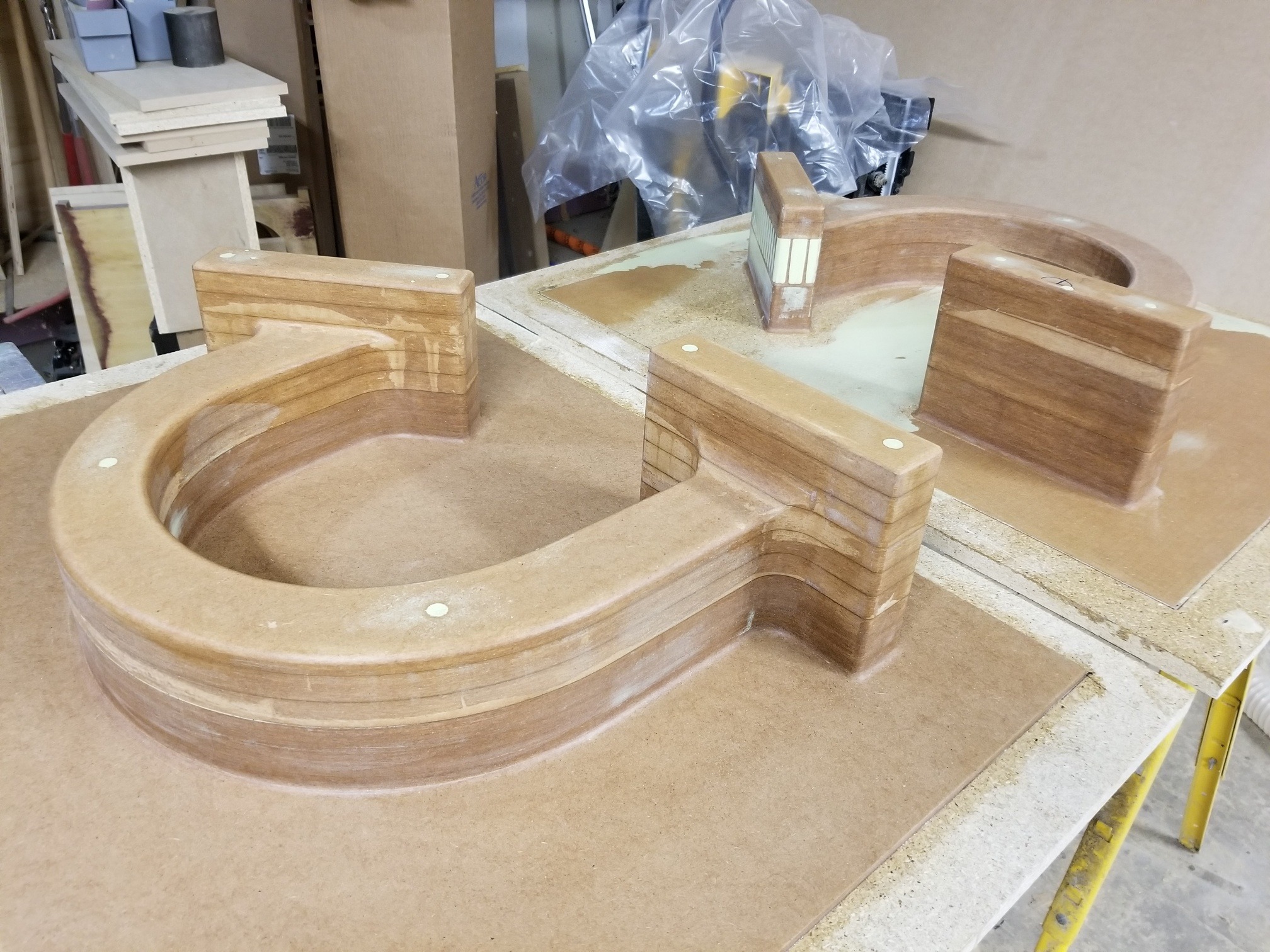

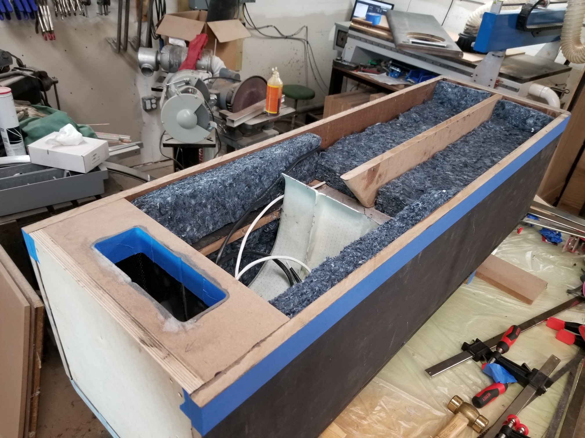

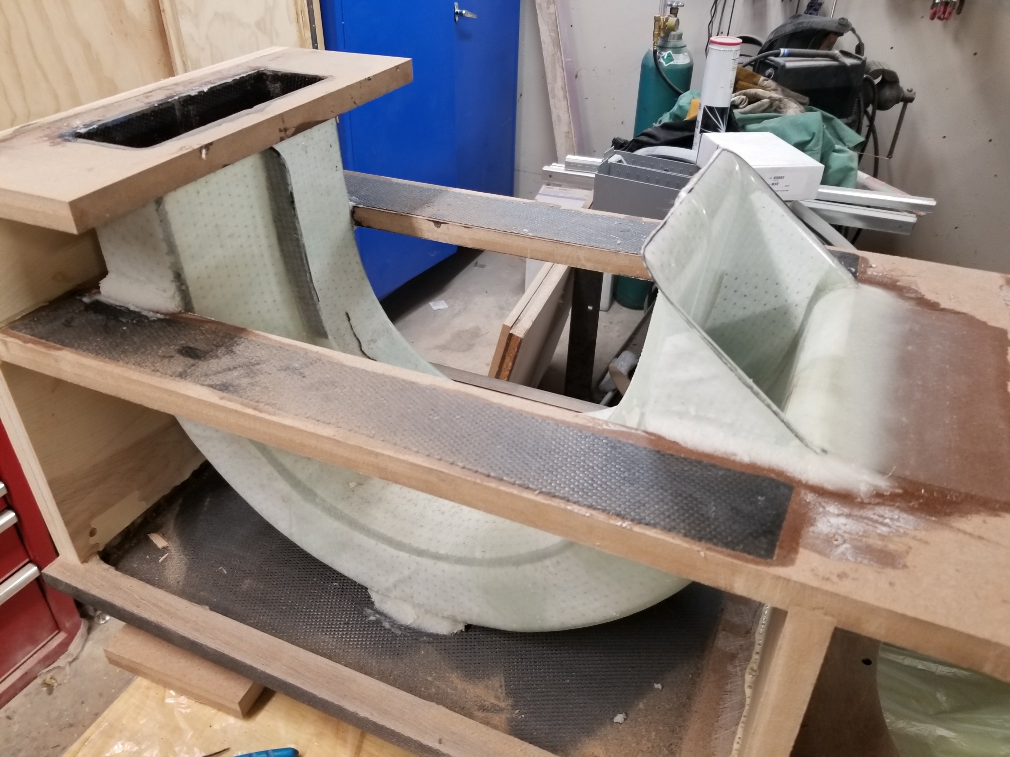

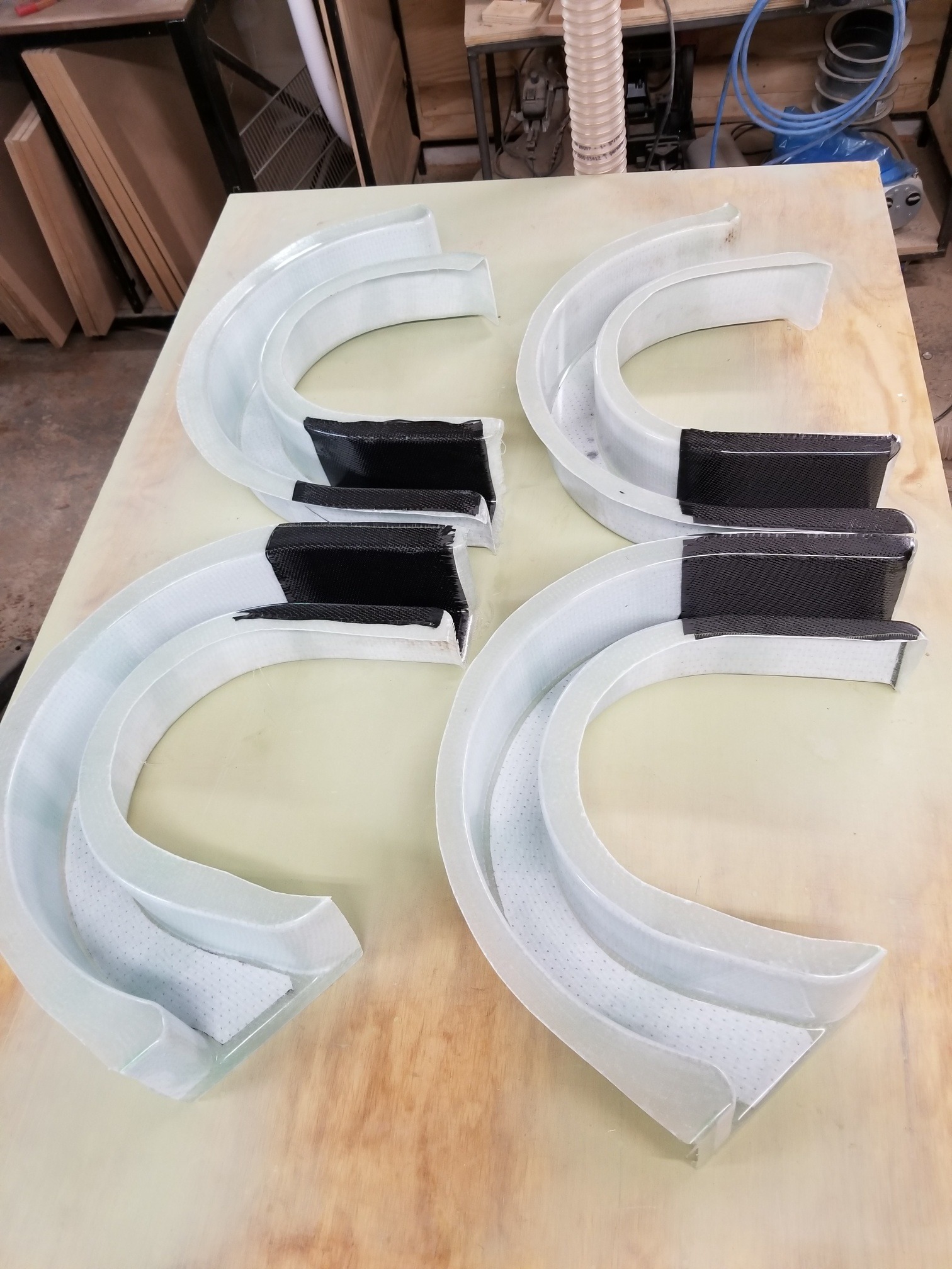

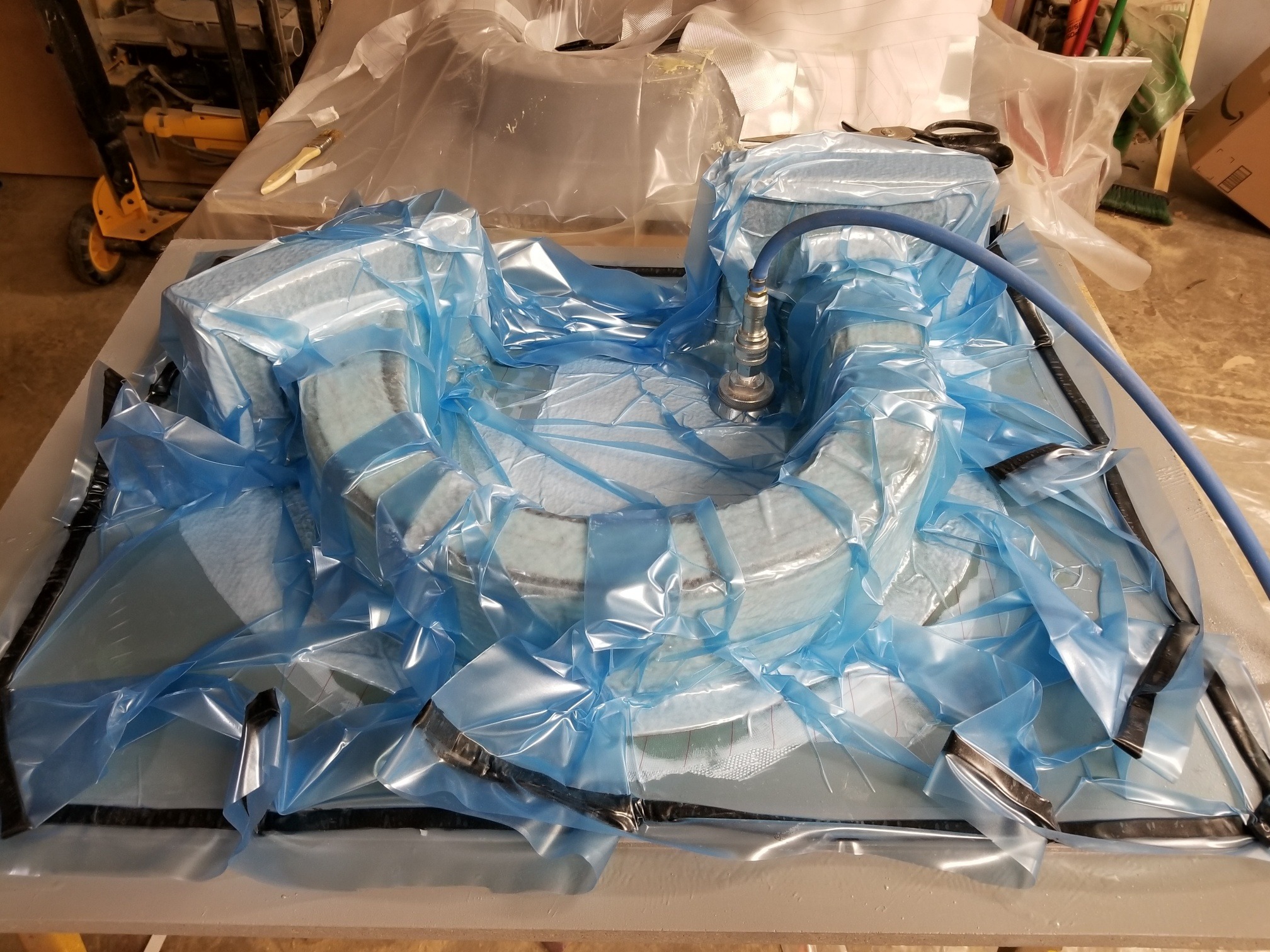

The port design is something I'm proud of. Early on I decided I wanted the speaker to be 16"x 16", so the radius port design was the only solution that seemed viable. A lot of thought and experimentation went into the port, but I'm not sure what to say about it here. In terms of port noise and resonances, it seems to be as quiet as a Genelec "laminar spiral enclosure" subwoofer. I'm not sure what else to say. Ask if you have questions.
I'm powering the speaker through Speak-On connectors. It's a super clean way to power a 4 way speaker.

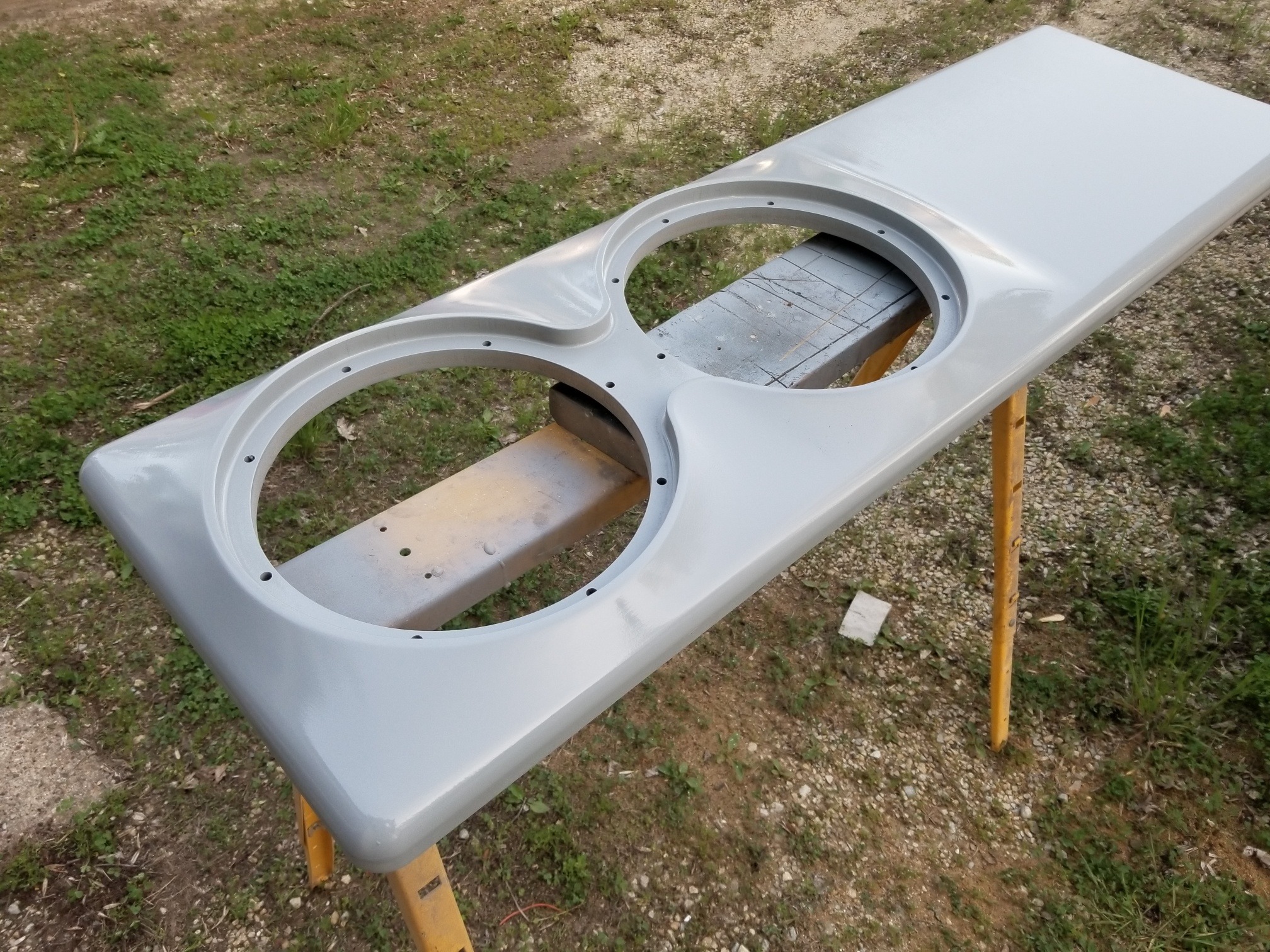

Remaining issues: The finish is OK from a distance, but needs a good polish. Maybe needs to be sprayed again to be "perfect". (Automotive 2k clear.) I still have to make the bezels to cover the edges of the drivers. Originally I was going to do aluminum, but now I'm leaning toward black. Black will give a subtle contrast to the carbon.

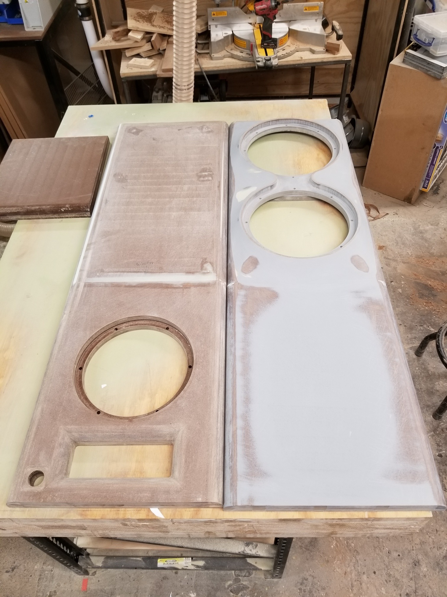

Below are some photos from the build.
20230116_181543_resized_2.jpg 20230119_184611_resized_3.jpg 20230122_140631_resized_2.jpg 20230615_191330_resized_1.jpg 20230615_202227_resized.jpg
20230520_200809_resized_2.jpg 20230526_194333_resized_2.jpg 20230523_204024_resized_1.jpg 20230529_205350_resized_2.jpg 20230620_110524_resized_2.jpg 20230620_162458_resized_1.jpg 20230627_024355_resized.jpg 20230622_140051_resized_1.jpg 20230701_112844_resized_1.jpg 20230715_192227_resized.jpg 20230716_125310_resized_1.jpg 20230716_143936_resized_1.jpg 20230716_144104_resized_1.jpg

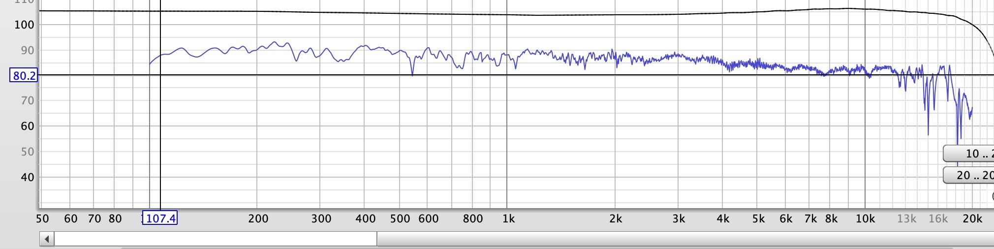

This is the coax horn and mid woofer, as configured currently. Crossed at 1200hz. Yes, there is some DSP applied to fix the response. And it is only rated up to 18khz. I know I don't even hear 18khz, so it's a mute point, literally!

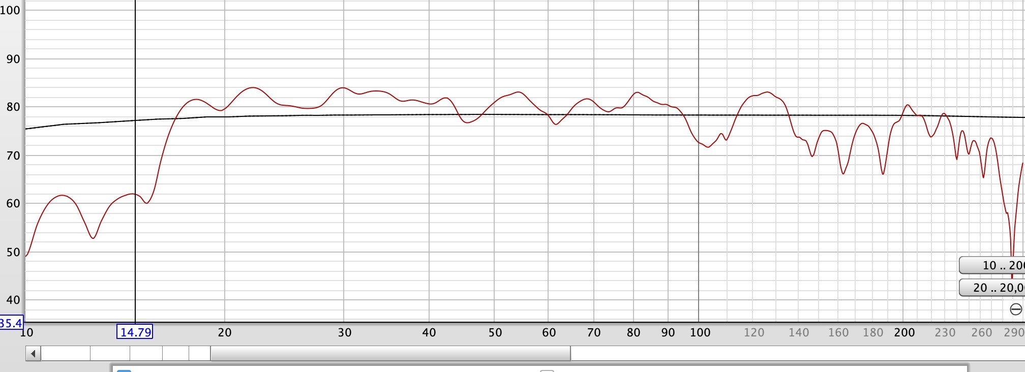

Combined low frequency response I measured most recently. This is still experimental.

How about some raw data? Attached below. I've been "fact checking" myself recently, and here I did comparisons of different configurations.
I included raw driver data used for calculating the delays, plus 3 sets of comparison measurements.
First comparison is with zero optimization; all drivers in phase. Second is with the left sub (rear facing) inverted as the only change. Third is the result of the delays I added, and none of the channels inverted. None of these use EQ to adjust frequency response.
I did the "optimization" exclusively for seating position 1. And then I measured it in 2 more spots to check uniformity.
The surprising thing for me is that the effect of inverting one subwoofer gave a similar result to the delay scheme! I don't know if this will always make a big improvement, but it is interesting.
These measurements explains why I was struggling to hear a tangible difference between the "with delays" and the "without delays". There really isn't that much difference.

Its clear you got very good/flat response so I'm tempted to try something similar - adding delayed/inverted subs next to full range mains. REW room sim gives encouraging results for my room - definitely better than simulated full range mains w/o nearby subs - but still just a simulation.
If this works, its highly preferable to scattering subs around the room. For me, that would never pass WAF. so Kudos
