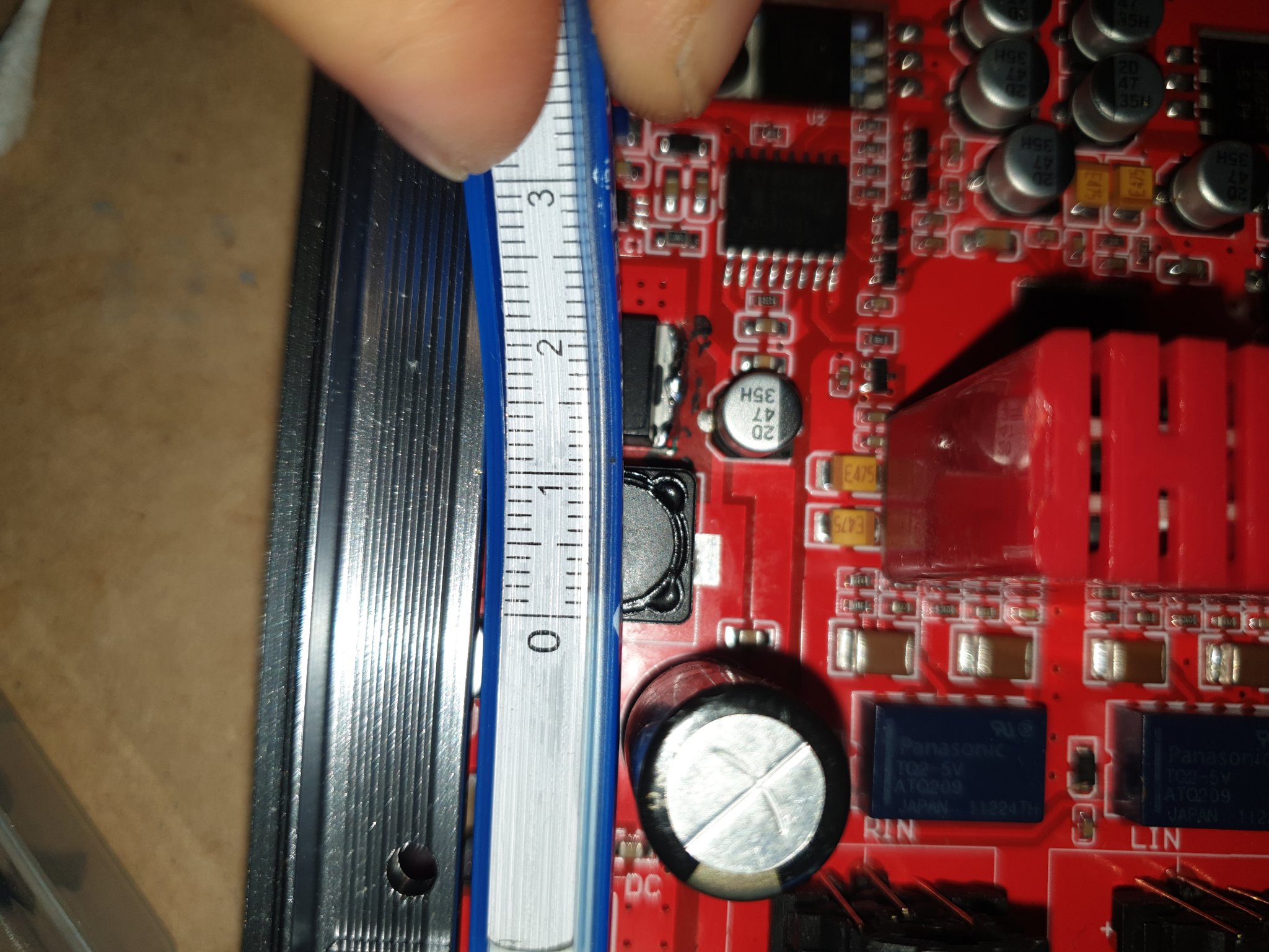

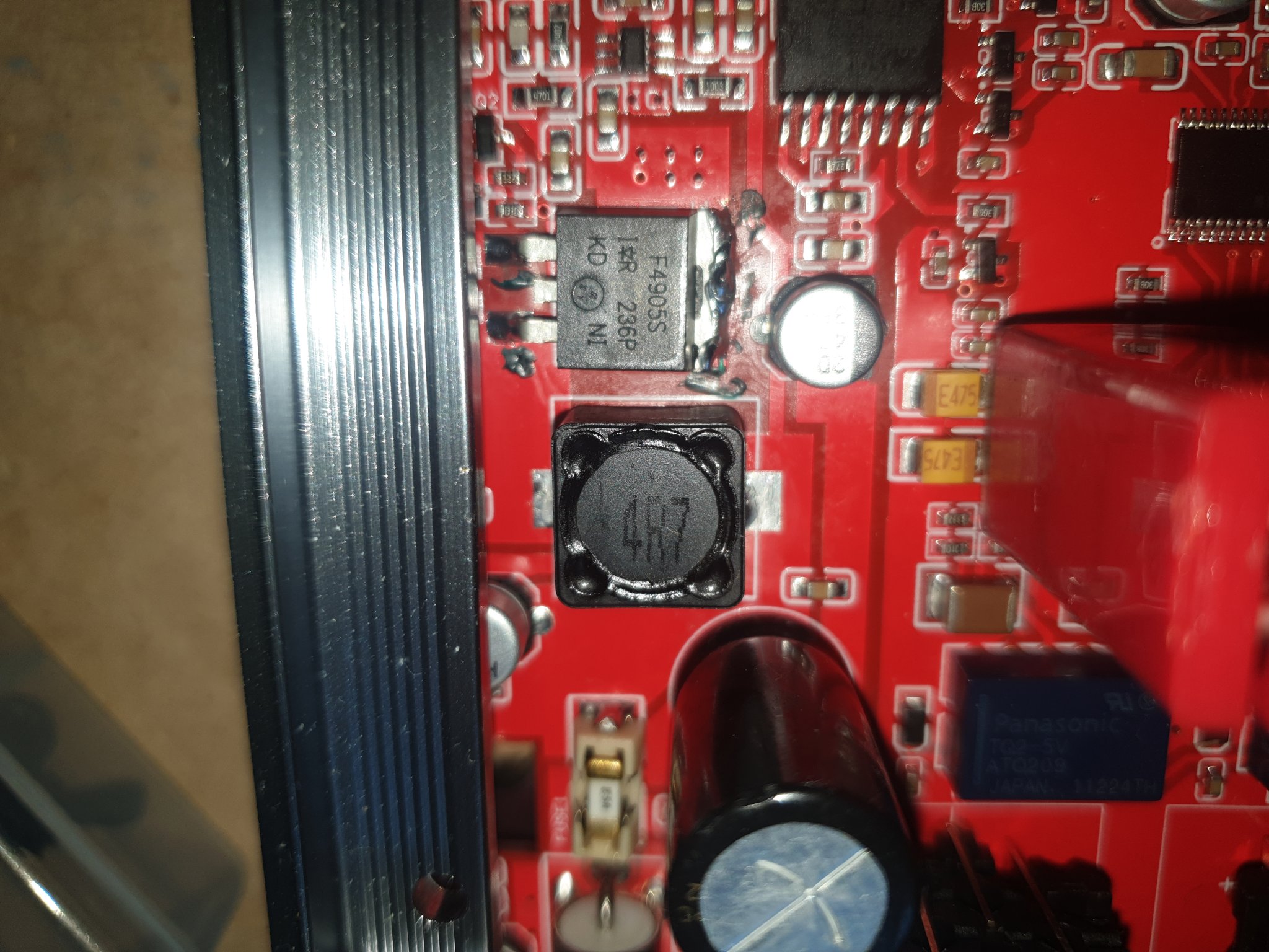

Hello,
I need to replace the inductors for the Burson Soloist 3XP. One is marked "4R7", which is 4.7 µH. And 6 are marked "100" which is 10µH, it think. They measure about 11mmx11mmx8mm. The pcb pad space they are mounted to is slighty larger about 12.5mm.
Can I replace them with ANY SMD inductors with the same 4.7 µH and 10 µH and roughly the same dimensions??? Such as Coilcraft or Bourns or Wurth Elektronik:

Why do you think the inductors need replacing?
You need to know the current rating, not just the inductance, to be sure a replacement will do, or just pick the highest spec'd devices of that inductance and size.
My multimeter did not maintain a proper voltage level when testing the inductors
No idea what you mean by this - could you elaborate how you measured and what you measured?
and left the cover off and had a cardboard box sitting over it
That could explain why it cooked - the covers are the heatsinks and require free-air convection to work, the box would prevent convection - I suspect it runs hot anyway in that small enclosure.

Ok. So, if indeed the inductors need replacing, minimum dimensions should be 11mmx11mmx8mm and the highest amp rating possible, which for now is 5.6 amps with DC Resistance (DCR) 21mOhm Max for the Wurth Elektronik and 4 amps with DC Resistance (DCR) 24.3mOhm Max for the Coilcraft. I'm unfamiliar with "DCR" numbers and need to learn more about it.

These are power inductors, not diodes, use resistance mode and check they have a low value, probably < 0.1 ohm.
Ok thanks for clarifying. That makes sense and they do appear to be testing ok.

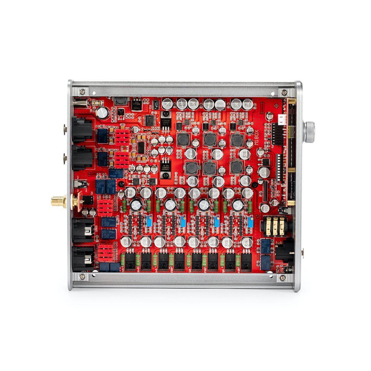

Back to power, during the testing the unit got quite warm. Those output transistors dissipate a ton of power which they push into bottom of the unit. They must run very hot in order for the top to get warm as well.

Good question. The box was actually a box cover, the kind you find in candy or chocolate boxes, about 2 or 3 inches deep. My intent was to use the box as a dust cover. So with the metal cover off, the cardboard box sat elevated above PCB on top of the rear input panel and front volume control panel. On the left and right sides there was about a 1 inch gap between the box and the PCB. So I thought there would be enough air flow. The box sat "on top of" and not "around" the device. The width of the box were slightly narrower than the Soloist.

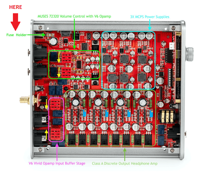

I tried but to no success. With fuses I can only see one fuse at the power input but maybe there are others on the PCB...
